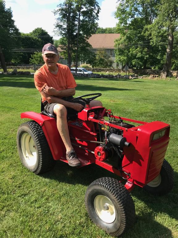

Incredible transformation!!
  • Like 2
AMC RULES
:handgestures-thumbsup: That ol' :wh:...
couldn't be in better hands.
  • Like 2
Aldon
Nice save!
  • Like 2
Tankman
Nice! Great work!
  • Like 1
ebinmaine
Absolutely fantastic !!!

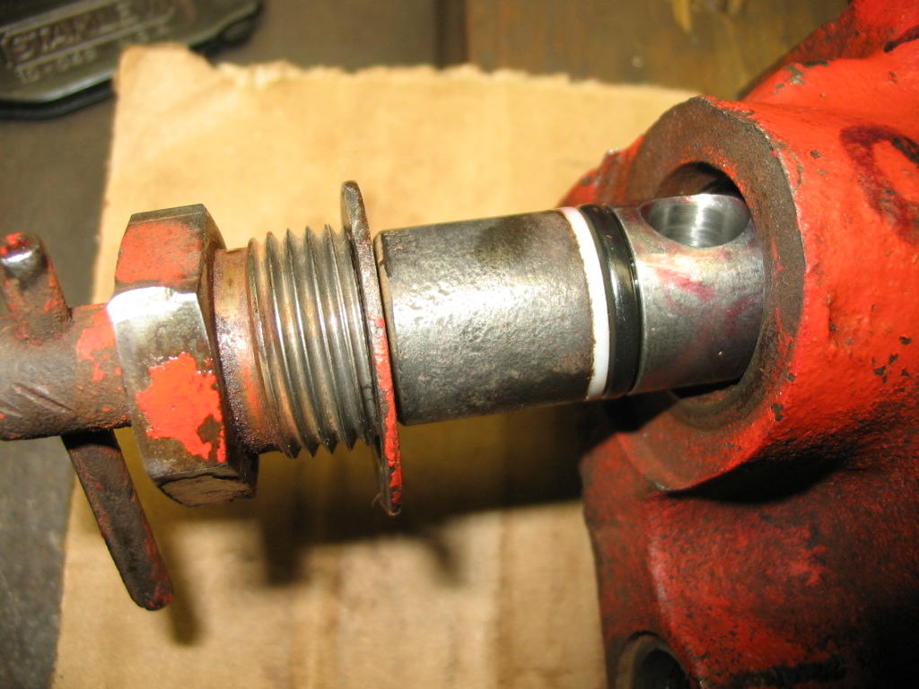

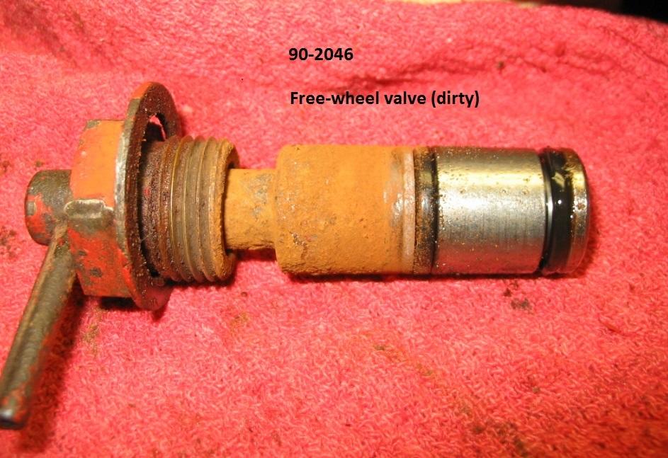

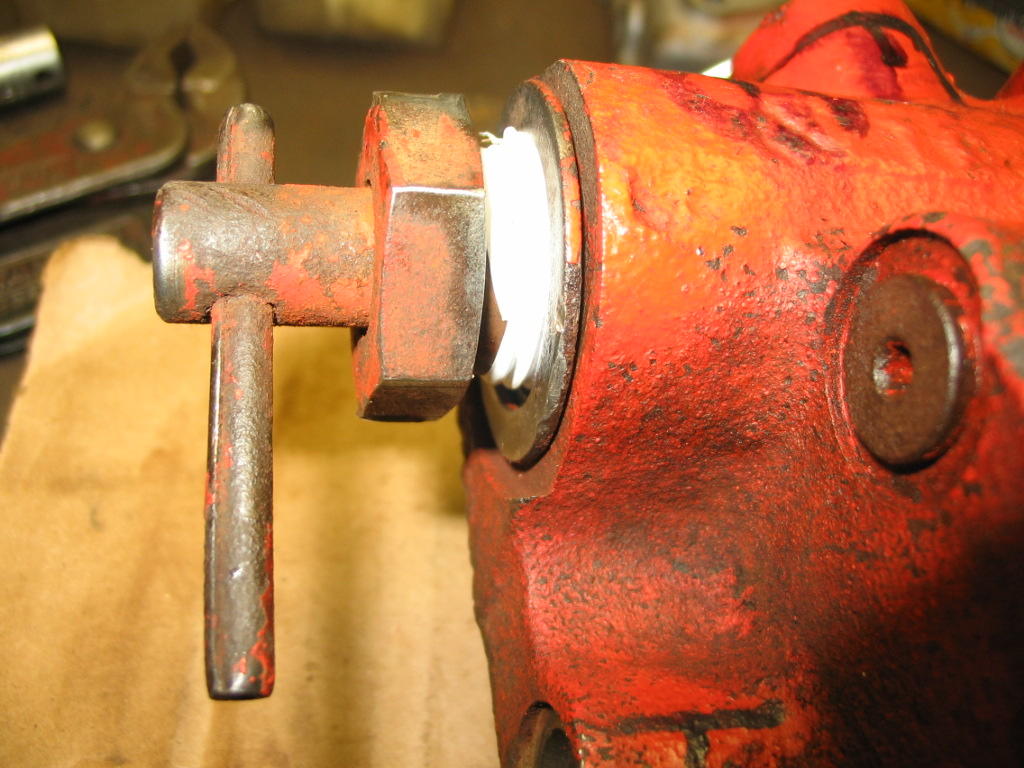

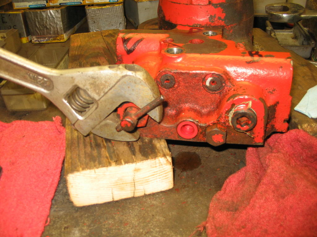

If the Freee Wheeling Valve is stuck, just take it out completely and clean it up.  pics here:

Rob R
Okay Dave will give that a try in a bit since you made it look doable..... thanks much!
Sooo I finally got back to this task inspired by Daveoman and of Course Stevebo who challenged me to bring the "Old Girl" to  his gathering this fall...… I put a 1" socket over the nut (I just had a small operation pin on the valve and I ground it down a bit to enable me to get the socket on)….. anyho after 5 mins with a impact hammer the nut finally loosened-up but the valve is still stuck at tight as King Arthurs sword...… have been soaking it with Kroll on and off all afternoon nothing yet..... afraid to put any heat to it due to the close proximity of the hydraulic hoses and of course the seals in the valve and hydro itself..... any other idea's    Thanks
