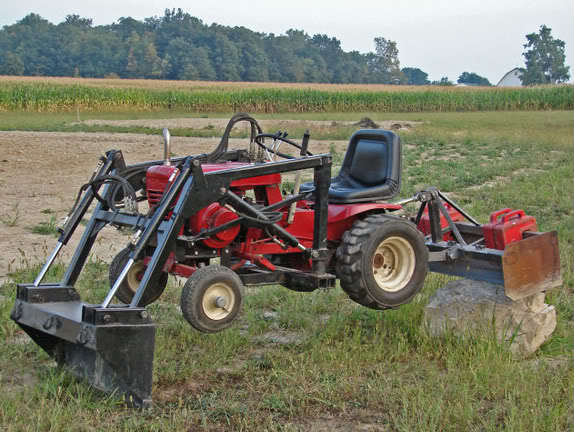

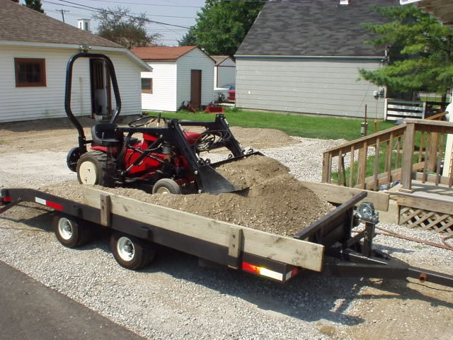

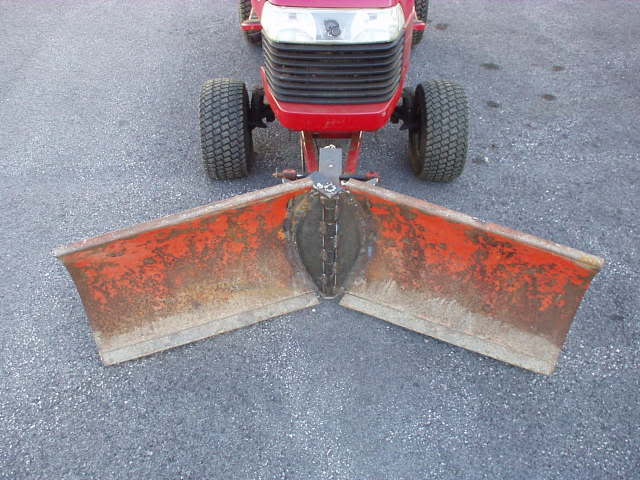

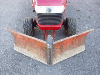

CasualObserver 3,416 #15 Posted December 16, 2016 A member in the past (way, way back) made a fully flexible v-plow that he ran off his lawn ranger... aka the Load Ranger. He hasn't been around for a long time though. Don't know if any of his pics or videos would still be accessible. I'll give a look when I have time. It would flex | straight, \ left, / right, < scoop, and > v-plow. 1 Share this post Link to post Share on other sites
CasualObserver 3,416 #16 Posted December 16, 2016 So, I can't find any of the finished product, but I found these from the preliminary stages... and I misspoke, it went on an XI model, not the Lawn Ranger. But that was built by the same guy who built this super lawn ranger that he caled the Load Ranger. 2 Share this post Link to post Share on other sites
Duramax7man7 506 #17 Posted December 16, 2016 Niiice! Have link to the thread or member name? Share this post Link to post Share on other sites
CasualObserver 3,416 #18 Posted December 16, 2016 @Nick and no, I have no idea what the thread was... or if it's even still here. Some were lost back in 2011 when we moved from the old forum that crashed. Nick hasn't been around here for about two or three years, these are just some of his pics I had saved. found some... Here are two of the threads, but they were both after the fact and no real information. Maybe he'll swing back in one day and put these pics/vids back in. more.... this was by another member @smoreau.... forgot about this one... but it showed up during searches. and the build thread. 1 Share this post Link to post Share on other sites

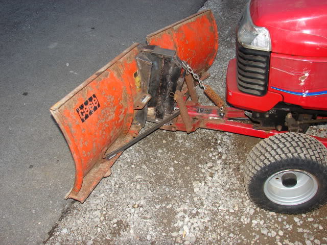

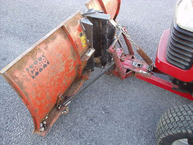

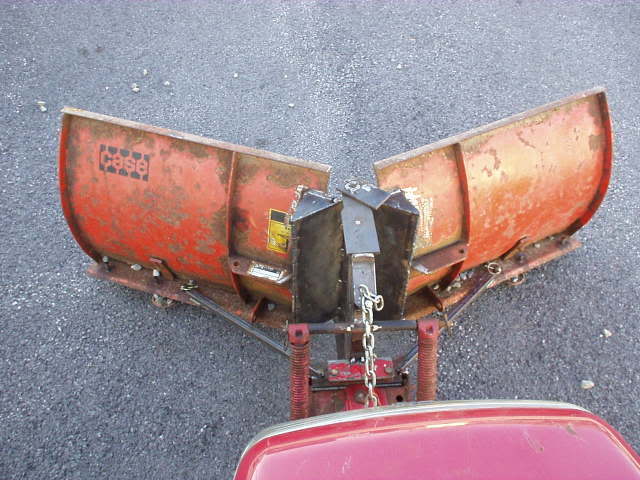

smoreau 658 #21 Posted December 18, 2016 This how I built mine and I use it all year. I have to say it still works great and is a huge time saver and very glad I built it. I still get offers for this tractor and still will notsell it. Just too useful for my needs. Been thinking on making some moods this winter to this project if time permits. My issue is the blade sticks out so far in the front that it hits the ground on small hills digging up the grass. Needs to go higher, but I'm limited to the front axle height. More to come. 1 Share this post Link to post Share on other sites
Duramax7man7 506 #22 Posted December 18, 2016 Yes, I see the only way to fix that would be to cut the A-frame and make it hydraulically lift somehow but only after the front end. OR lift the entire frame of the tractor up a few inches above the axle either permanently or by hydraulics... Like a hydraulic height adjustment. Share this post Link to post Share on other sites

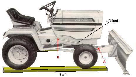

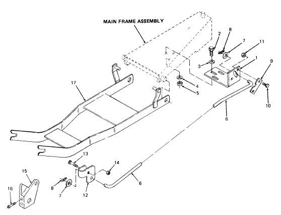

WVHillbilly520H 10,378 #23 Posted December 18, 2016 (edited) 2 hours ago, Mastiffman said: Yes, I see the only way to fix that would be to cut the A-frame and make it hydraulically lift somehow but only after the front end. OR lift the entire frame of the tractor up a few inches above the axle either permanently or by hydraulics... Like a hydraulic height adjustment. It would be more like the older CC style that pivots (up&down) where it latches in the front of the frame (our front attac-a-matic) then it braces mid frame instead of the rear axle, lifts 8-12" off the ground like a single stage thrower, then there's a a side rod from the rock shaft to the blade "A" frame for lifting and a hydraulic cylinder for angle or pinned if manual, Wheel Horse is my main brand but there are very good reasons to own others or to copy some of their attachments/styles,Jeff. Edited December 18, 2016 by WVHillbilly520H 1 Share this post Link to post Share on other sites
Duramax7man7 506 #24 Posted December 18, 2016 Exactly. That's like the image I had in mind on my first thought about it, except I was using a typical plow setup and just making the necessary cut in the frame of it towards the front. But the Hydro I was thinking would still be holding up the plow frame from underneath. But this makes way more sense. Much more strength in the design. I really like that. The Side rock from rock shaft I'm sure, could easily be replaced with another hydraulic cylinder for lifting. Just tap it in from the Main line to the original lift cylinder. Or Move the main lift cylinder al together is it has enough travel. All things that could be worked for sure. 1 Share this post Link to post Share on other sites
