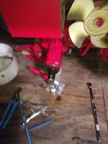

608KEB
Suggestions on removing key from axle? The Hub came off no problem.
tommyg
Sounds like you got the hard part done. I don't think you want to heat it for fear of ruining the seal. I had to drill mine out and replace it with a new keyway. It was wedged that tight.
JAinVA
The key is a standard woodruff half moon key.Some penetrating oil and carful use of a steel drift will get it loose.You can tap straight down on it at each end and then use the drift and drive it towards the trans case.If you have some heat like a propane torch then that will help as well but be careful of getting any of the trans parts to hot.You don't want to cook the seals.Don't worry about messing up the key as most home improvement stores will have some as well as Tractor Supply ,NAPA, McMaster Carr or most auto parts stores.

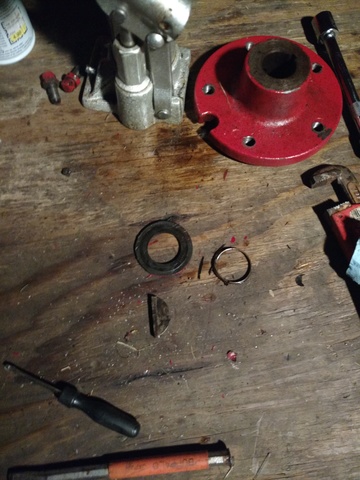

608KEB
I got it. It was worse than taking the hub off. Also why on earth do people wrap wire around the axle to slow down the leak. If your gonna go that far. Why not get a new seal?

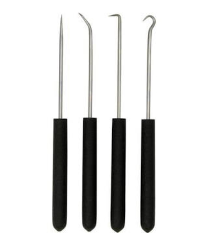

Aldon
Use a pick for easier/best results.
I usually manage with a screwdriver and locking needle nose.

608KEB
Thanks for the suggestions. I got the seal replaced. I tried the picks but they weren't strong enough. I got the seal to spin by gently tapping it with a screwdriver and a small hammer. It worked out as I tapped.

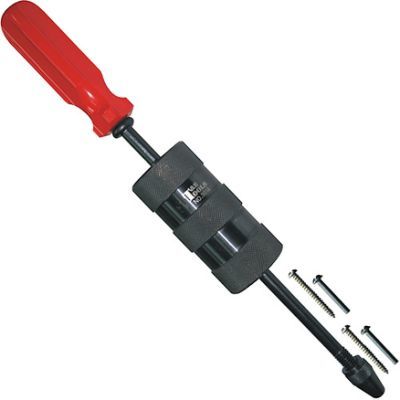

Hacksawhero123
The best seal pulling tool I have found is the small slide hammer puller. It's my go to first tool for seals.
