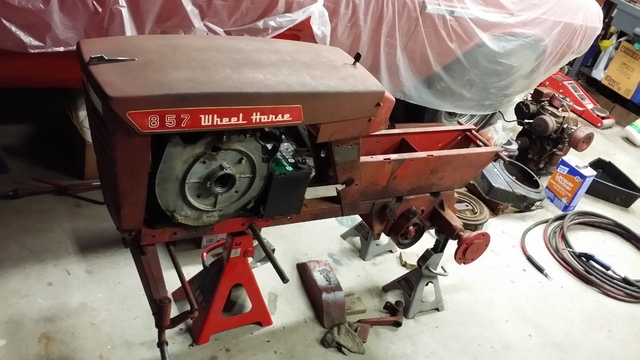

Well I learned tonight that there is no easy way to shoe horn in the M10 into this tractor. I'll be honest (not a lot of experience with big block Kohlers) I didn't expect the Magnum 10 to be as physically large as it is... its way to big for the 857. I am not willing to do major surgery in order to get it there... like notch the frame or cut the hood up. So, the original K181 will be the power plant with a full custom exhaust and a GT14 intake/filter on it.

I think you could use a K241 from a 1045,1055 or 1075. Actually you could use put a k341 under the hood if you use a narrow base engine block with a flat bottom cast iron oil pan, as used on the 1045,55 and 75 Wheel Horse models. Will need to plug the oil drain hole in the bottom and drill and tap one of the bosses on the appropriate end of the pan.
Now that is a plan, I need to find one of those oil pans...

Well after a little moc-up it does look like I will be able to get the clearance I need to not cut the frame or hood. It does look as if I will need to modify the M10 blower cover a touch and relocate the battery to under the frame but that is nothing big in my mind... I believe it will still have the 857 look with the big block motor.

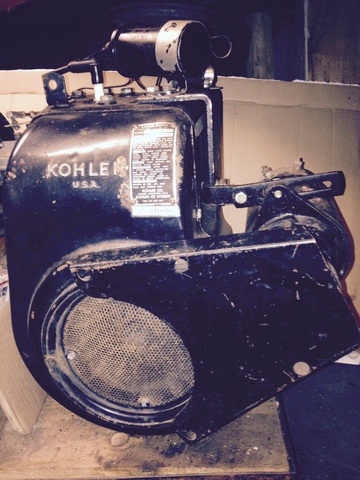

Hey Vin,
How about something like this? Got this engine quite a while ago and never used it (yet). The S/G may allow you to keep the battery in the same spot, curved top so it may fit under the hood and still has that old school look.
Trade?

Not sure if you are planning on using the starter on the Magnum or if you are going to use a starter/generator. If you want the real look, the 241 will need a smaller bearing plate and shroud, different starter generator mounting brackets. Then the battery would fit just like a 1045. The motor @wallfish has may work if it has the smaller bearing plate and shroud. Otherwise as you have stated the battery would need to be moved.

Thank you for the offer John! But I do like how the Magnum has the larger blower cover and fly wheel... I'm going to keep working on the Magnum for a little while to see how it will physically work out. I have a little more fitment I want to look at.

Spent the day fiddling around on the 875, got everything to be basically settled in. Its a tight fit. I did pick up one of those 1045 style oil pans mentioned above but it will not work on the Magnum 10, may be just this particular M10 but it will not work. I'll have a YouTube vid coming out on Thanksgiving to explain...
So to make it work I'm going to bring the original Magnum 10 oil pan to my buddy's machine shop and throw it on the Bridgeport, I'll mill the top of the oil pan down, that will shorten the over all height of the motor and then it will slide in with the hood to close without issue.
In the pic it fits but the spark plug is not in the head, its that close to fitting, LOL!

sounds like you have a wide base block if the oil pan will not fit. Sounds like you have a plan, make sure you shorten the dipper on the connecting rod. Interested to see the shorter oil pan.
The M10 came off of a 310-8 and I believe you are on point with the wide base.
