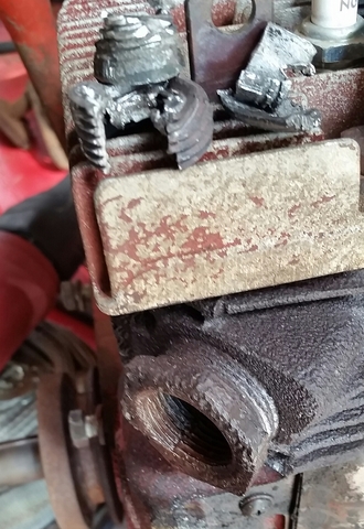

Forget the PB and cave that sucker in with a punch. There are some good posts on this forum about removing the exhaust fitting with this method and the best part is that it not only works but it is also a lot of fun...
  • Like 1
Texas Todd

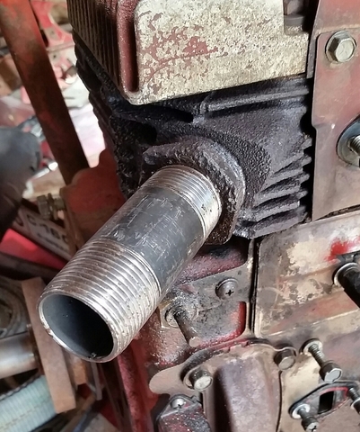

That was good advice! It wasn't pretty but it worked. Had to use  sawzall to cut a slot and it cam on out with some force. Was able to get the nipple in Almost a half inch
Thanks for the tip!
The remains are on top of the head.

Using this method, wouldn`t you get a lot of metal filings inside the engine?
oldredrider
A shop vac takes care of that issue. I recommend running a tap inside to chase the threads after removing the old pipe.
Texas Todd
Agree on the shop vac. If I had a 1" tap I would do just that. I'll just have to run this nipple in and out a few times and call it good. Maybe I will run across one though......
  • Like 1
oldlineman
sometimes you can make severial cuts with a hacksaw in the nipple and it will act somewhat like a tap, use plenty of oil on it.
  • Like 3
Texas Todd
Thanks! I will give that a try, but it is going in a half inch. Does it really need more? Seems pretty solid.
DennisThornton
Hacksaw cuts help but you can even grind a taper and cutting grooves just like a tap that will most likely be plenty good enough for a single use!
  • Like 1

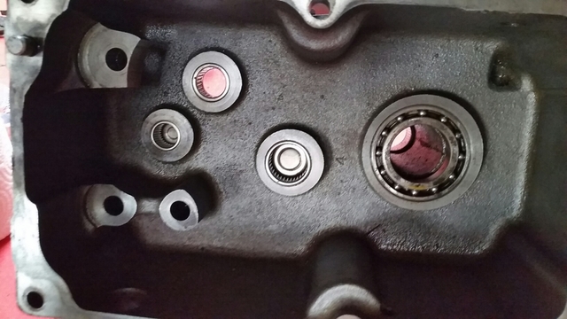

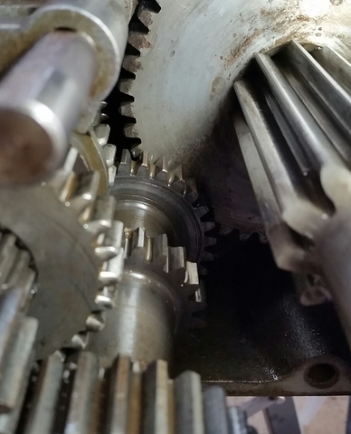

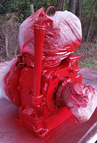

Didn't get a great deal done today, but had a great conversation with @stevasaurus and got the transmission cleaned up and ready tp reassemble once the seals and gasket are delivered (Thursday, so they say).  The inside of the transmission is pretty clean after a scrub down of diesel with a wire brush and elbow grease.
Had a little time left so I cleaned up the block and got it painted.

Since I have the block painted, I will probably jump in and blast the cover and tins and get that portion finished and ready to reinstall before attacking the next item, which will probably be the frame, or hood, or fender.....Depends on which the way the wind blows.

On metal filings in the exhaust port. It sounds goofy but....  take a can of foamy shaving cream and shoot a bit to the back of the threaded section. It will catch and hold the filings and crud. When finished, use a shop vac to suck the cream and crud out. A wise old aircraft mechanic showed me that one.
Mark
  • Like 9

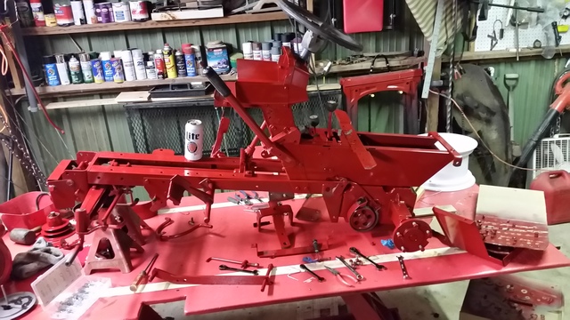

Texas Todd

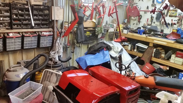

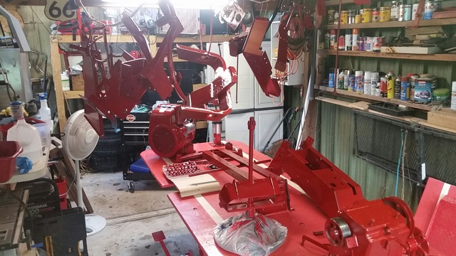

Just an update. Finally got all the pieces blasted, primed and painted. Now the real challenge sets in....Waiting for the paint to cure before starting to put it back together.
Also, any suggestions on seats is appreciated. The recipient of this tractor, my son-in-law, is about 6'4 and 240 lbs, so I need to find a seat with good suspension and one that can be mounted far enough back so he won't be too cramped.  I have a stack coming from @jimkemp so that decision is made.  I was going to add more white accents but the SIL wanted all red, except the wheels of course. It seems that the disassembly and reassembly are the fun parts. The blasting, grinding and priming is monotonous...Painting isn't bad because you know the reassembly is getting near, but then that impatience gene kicks in....
Tempted to start tearing down the 856, but wisdom says not to have two tractors torn apart at the same time.....
Oh...and...the pics. Rough count is about 200 individual pieces to blast, prime and paint, for the tractor alone......
  • Like 8

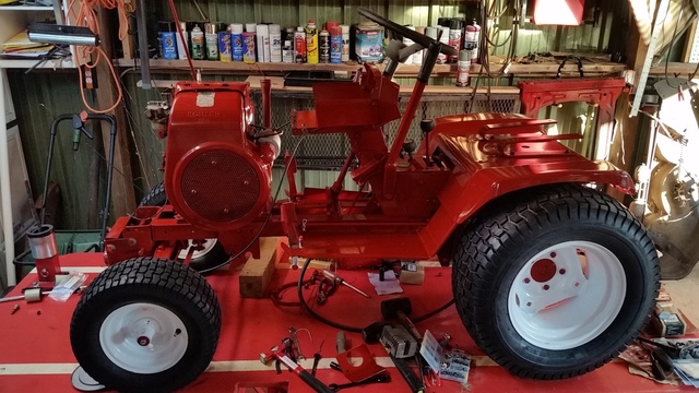

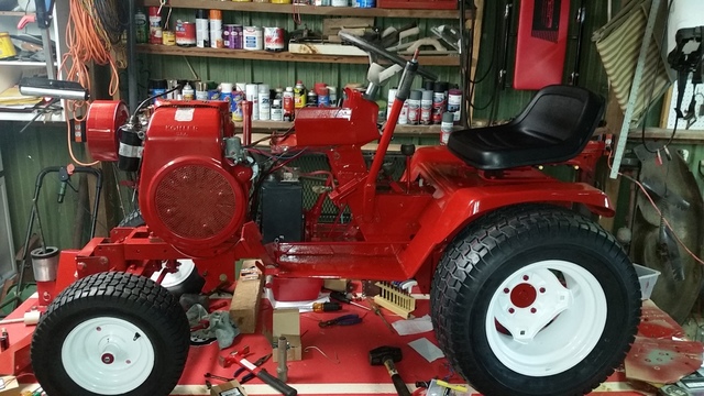

A little more progress today. Hope to wire it up and test fire20161114_171854.jpg Friday or Saturday.
  • Like 7
JERSEYHAWG /  Glenn
Todd, what color are you using please? And is that a rattle can Job? It's real purrty, and coming along great. You sure not asleep at the wheel.
Glenn

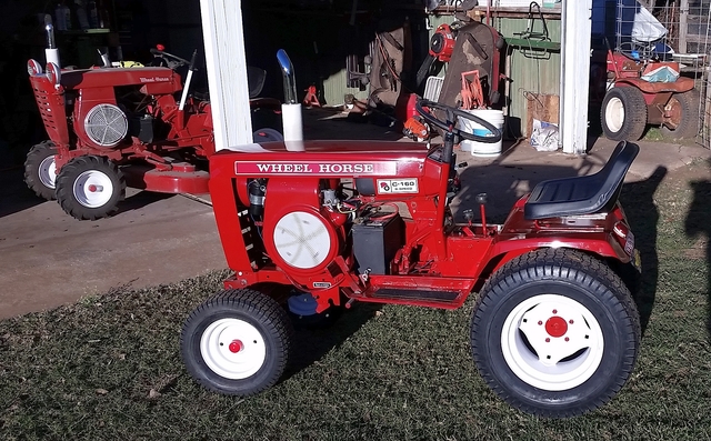

Texas Todd
Thanks Glenn. Its Rustoleum Regal Red, Acetone and Valspar hardener shot out of a Harbor Freight HVLP gun with a 1.4 tip. The hardener gives it that extra shine and it dries very hard. Primed with Rustoleum self-etching primer. Seems to be a good combination and also allows touch ups with rattle can Rusto.
I painted my mailbox with it a couple months ago to see how the paint would hold up over time.  I figure it has seen more sun than the horses will see in a year or more time and it still looks brand new.  If it still looks new this time next year, then I think the horses paint will hold up well.

TravelinJavelin
I love the white engine screen that just pops right out! ohhhhhhhh I love the 160's man!
  • Like 2
Texas Todd
I agree! I had it painted red and it just laid there. After doing the one behind it, the choice was simple.

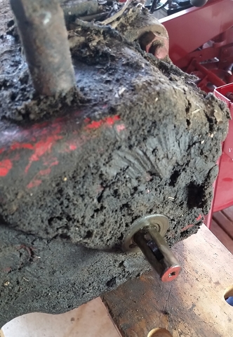

      Hi everyone,
      I bought a wheel-horse c-160 a while back, and did some work with it.
      One day the rear axle housing broke:
      I was thinking about changing the part or soldering the broken pieces.
      Does anyone know where to order this part? Or has any idea of the potential cost of a soldering job?
      Thank you in advance!
