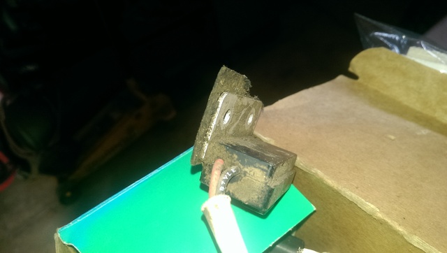

Also wanted to add that the seller is saying that it will need an Ignition Module. I looked on toros website and those are only on the 1991-1992 models. 1993 and on uses the Ignition Control, Ignition Coil and Regulator.
 So would I be looking at the similar issue? I read that I may just need to clean up the ignition module and check the gap between it and the flywheel if that's even possible. To ensure proper spark... maybe check it with a Multi-meter while it's off.
EDIT: Spoke with the seller and he's saying he thinks that this 416-8 is late 80's early 90's.... makes sense if he's talking about an ignition module.
Edited by Mastiffman
WVHillbilly520H
Those Onans have the elctronic ignition modules through 1997 as my 520 does it's behind the flywheel with the charging stator most likely the issue with run and cut off cool repeat..., and yes only the 520 after '90-'91 with the swept forward front axle can handle the 60" mowing deck therefore the 48" is the largest the 416 can use but that's all I've used since new in '98, ...below are the module and trigger which while your in there should be replaced TOGETHER, notice the front axle "bowing/sweeping" forward,Jeff.
Duramax7man7

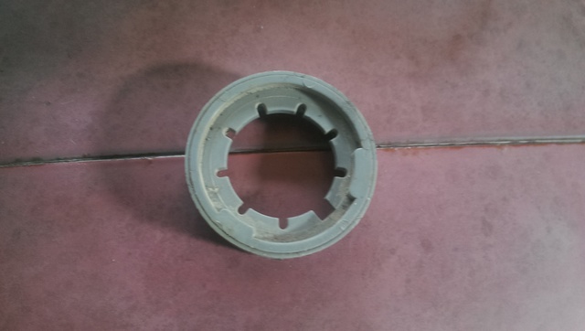

Thanks. The Toro site shows an Ignition Module on the 91' and 92' but it looks like I was seeing that under the Kohler Engine section. Not sure why this guy is saying that it needs an Ignition Module.
 Okay, so Ignition Module and Ignition Rotor (that's wnhat toros site is calling it)???
 SO I'm looking at $250- $260 to get this thing running right again? Or can these parts be found elsewhere for substantially less?
EDIT:
Onanparts.com
Ignition Module... $99
Electronic Ignition Rotor... $20 Not bad...

The parts you are referring to are specific to Onan and are priced at about $120 before shipping from Onanparts.com. Boomer may have them for less, you would have to check with him. However, these components rarely partially fail. They either work or they don't and there is a procedure whereby you can check them out with a mulit-meter. What you describe sounds more like a coil/condenser failure to me. Coils will in fact act like that (run until heated up then break down and cause the engine to quit firing). Coils used on the Onan P series engines cost about $100. One advantage to Wheelhorse as opposed to other brands that incorporate Onan's is that you can pull the flywheel without pulling the engine....................Hope this helps...............Gary

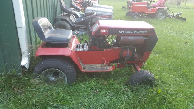

I may have found me a Majorly Sweet Deal... 2 for the same price as this one... 520h and 312-8 both with decks, blade and blower... The 520h looks a little rough but I'm getting details right now... Crossing my fingers.
Here is the 520H... Decks are 42" and 46"...
20hp Onan on 520h and 12hp Kohler on 312-8
More pics...

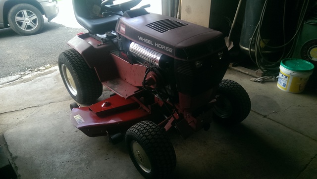

312-8 looks to be good cosmetic condition...

Oh I also need to mention that the running problem for the 416-8 could very well be related to the fuse block. That often gets corrosion and causes running problems.

I had the same problem with my 16hp Onan.  Might mow the entire lawn and go for days then it might not start at all or might start right up and run for 5 and die like the coil wire fell off or by the key.
There's a "Known good" trigger waiting for me to install.
I'm pretty sure that's your problem as well.

 YES! :D Not sure of the year on either.
I got:
1. 312-8 with 42" Deck and has 416 hours on it.... (Model Number- 73362 Serial #- 5901709)
2. 520h with 46" Deck and has over 2300 yes 2300 hours on it!? :blink: (no label under seat but can see where is was. Onan P220 label = Model P220G-I/ 10955C.... Seriel # E893552882
3. Plow
4. Snow Thrower (I think it's missing a bar on the bottom? Nothing attached to the pin on the bottom rear.
Initial Diagnosis of 312-8:
12hp Kohler runs great! No Smoke, knocking or clicking. Oil looks old, air cleaner too. Starting components work well and properly. Front right wheel bearing blown out and wheel may need replacing if not the spindle as well Depending on extent of damage. Steering seems moderately tight still with a smidge of slack but that could be due to the right wheel bearing being blown out. Ball joints still seem solid though on both sides and left spindle and wheel are tight. Body is solid. Typical grime. Needed a battery as didn't have one. Tires are turf savers and old. Two rears leaked out half of air over 2-3 days. tread not to bad though. Could use inner tubes for a while. All gears seem to work fine as well as the parking break, mule, lights and clutch/ break. Rear end doesn't seem to have any leaks and both rear wheels are nice and solid. Seat is junk but usable.
Initial Diagnosis of 520h:
20hp Onan (P220G-I), runs good. A little slow in throttle response. Smokes on initial startup and if quick throttle given and a unnoticeable (during daylight) exhaust that was noticed crossing the headlight path at night. Could be the carb needing attention as it surges when running full throttle with the deck on and blades engaged. No knocking or ticking though. So that is a good sign to me. I'm okay with honing and new rings for sure! (my 1970 Onan 6.0 CCKB generator has a weird knock that I could use help with). Starter works fine but noticed the flywheel has some grinding evidence on motor side but starts. Could have been a past bad starter or soemthing. Throttle lever doesn't stay fully open (i.e. Up!). Drops a bit after a few seconds as it's loose. Front right spindle has play horizontally (pulling outward on top of tire)... QUESTION: Does the Spindle or Axle get worn first? Frame looks solid. Mule works fine. Body panels have some surface rust but are solid. Most of surface rust is top facing sheet metal (i.e. Hood Stand plate, foot rests and a little on the fender). Ignition fell apart and I replaced it already. Wiring harness has at least one short that revealed itself when I replaced the ignition. I noticed the wire upon first getting the machine home but it wasn't affecting startup until I replaced the ignition. From disturbing it I assume. All lighting panel warning lights work. Test light good, but headlight switch is deteriorating and faulty. Also, there's a black wire coming from the ignition coil that was just floating around. Put a wire nut on it and secured it as everything is working at this point. Motion lever moves fine between forward, neutral and reverse. Motion lever doesn't hold it's position though. QUESTION: Is it supposed to? Hydraulics lever work fine. Lifts deck and plow up and down (haven't tried the Snow blower as said, it's missing a bar). Tires also leak but rear wheels are solid. Looks to be some minute leaking of the hydraulics in a place or two. Engine drips oil at a couple of drops every half a day but it looks to be coming from the oil drain pipe and plug area. All gauges but the Rpm work. Rpm gauge seems to not read correctly but does move. Only one light works on the gauges, on fuel gauge... Not really anything missing other than one rear hub. The other three are present. Not worried about that. Overall, levers are functional but seem a little loose. Not surprising seeing the 2359 hours on it. But whomever had it the longest really use it but also took moderate care of it. Seat is destroyed basically.

      *Had trouble starting, when it started, it died after 4-5 seconds. He had a portable charger and it helped. We got it running, but when I turned it down to idle, it died.
      *I didn’t get a chance to test drive it because of this.
      *One front tire goes flat fast, one rear tire has a slow leak.
      *He is going to buy a battery before I look at it again on Friday so I can test drive it.
      What do you think is the issue? Is it the battery or fuel system?
      Do you have a way to verify what year this is with the ID number and serial number? Also, the ID number of the deck. I’ll upload pictures of the stickers.
      *He says his driveway has an incline so snow and ice would pool around his door opening so he got tired of his wheels spinning. He decided to pay for plow service. (Home is big and nice with a lot of land.) He also decided to get a zero-turn mower so that’s why this 416-8 wasn’t used since after winter ‘21/‘22.
      He’s asking $500.
