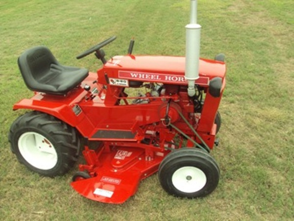

I have a wheel horse c161 Hydro, and I want to put on a stack type exhaust as the muffler that is currently on it appears to be to large and burns the paint on one side of the hood, what will I need to do this job, such as pipe size and stuff.
The picture is what I want my muffler and pipe to look like, it is not my tractor

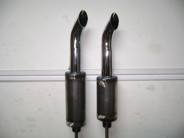

I have these for sale , 6" or 8" tall with 8" chrome stack for $50 and that includes shipping to the lower 48 states
  • Like 6

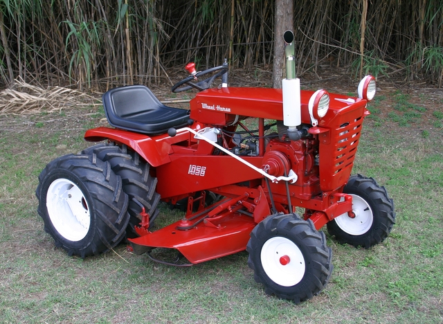

@jimkemp does a great job on stacks. I highly recommend it. Here is one he did for me for my 1056. I painted it with high heat white and it seems to be holding up well. I did use a couple of lock nuts to keep it from moving.
  • Like 3
RedRanger
So Nice!  :banana-dance:
jimkemp
That tractor needs duel stacks to go with those duel wheels , look for a manifold to mount duel stacks in your box that will be on its way Monday , That tractor looks GREAT
