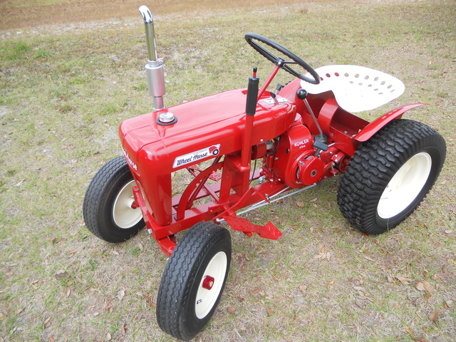

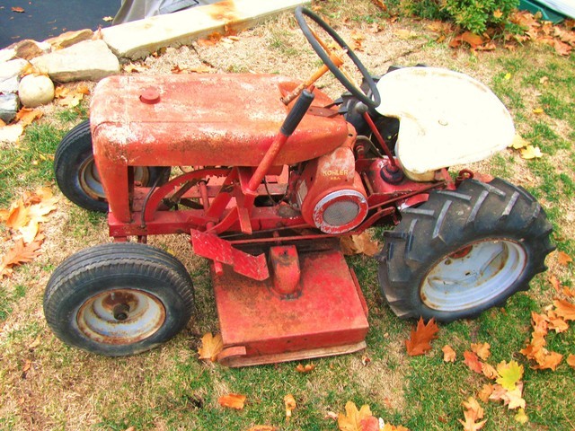

My 400...  :handgestures-thumbsup:
for comparison.
'61 401
wallfish
for comparison.
Did you mean 401? That hood is a 1961-401/551
RedRanger
I agree.
Looks like a 1961 401 with 1960 foot rests to me.
Also has the 61 hood decal.
Edited by RedRanger
Oops!  Typo, or wrong pict...
one of the two.   :dunno:
Try again...400 here.
Edited by AMC RULES

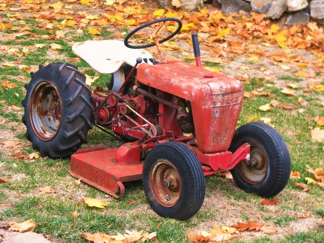

I'm confused cause this one doesn't have any decals
Racinbob
AMC Rules. The decals are just missing. Notice the throttle and choke controls. The 60's have levers, the 61's have push/pull controls. The foot rests are different too. The 60's are bent diamond plate as shown. The 61's are cast. The 61 in post #80 has 60 footrests. That's something that is easily swapped out so it's not a good indicator of the year. Here's my 60 400 with some minor changes.

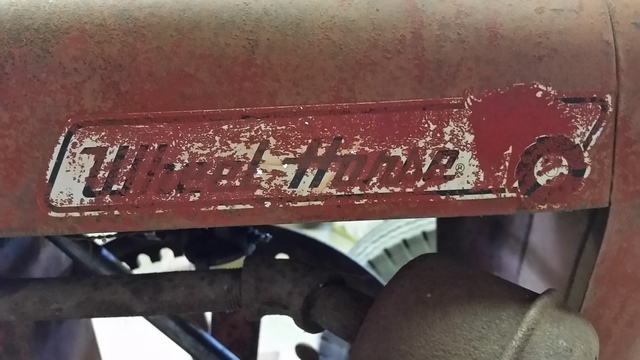

Redoyourhorse.com has the correct decals listed for the 1960 400/550 suburban tractor
WHX??
This is whats on my 400 guys ..& I can guarantee they are original
@AMC RULES dig the shower head on yer 401... I'll take a dozen!:lol:
BTW this is a very early production '60 but I would be willing to bet that on any particular day they slapped on whatever the assembly line guy had in his hand at the moment.

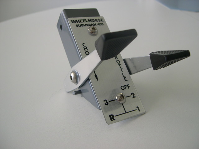

look at the above pics, controls mount in the rectangle hole and the plate covers the center
Racinbob
Here's what they look like. I had to make new levers and used a decal from Terry along with handles from Glen. Where mine says 'Suburban 400' is where the serial number should be. I talked to Terry and asked him to do this because my number was long gone.

Racinbob
I was lucky. I had the piece that goes under the hood, the top plate and one lever. The plate was badly pitted so I flipped it over and, after prepping, used the decal. I made new levers from stock I got at Lowes using the one original as a pattern. As stevasaurus would say.....boom-sha-ka-la-ka...............Did I say that right Steve? :D
