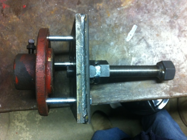

squonk 48,278 #8 Posted February 20, 2016 (edited) My Super-Whoopie hub puller. I came up with the pieces and a friend of mine welded it. This tool has a special place in my tool box. I picked it up from him when he called to say it was done. Drove home and promptly went to the E.R. Later found out I was having a heart attack all day and didn't know it! Edited February 20, 2016 by squonk 6 Share this post Link to post Share on other sites

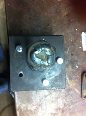

elcamino/wheelhorse 9,363 #11 Posted February 20, 2016 Squonk , what does the flat piece look like ? Give us part of a story then hospital visit and only one picture. 1 Share this post Link to post Share on other sites
squonk 48,278 #12 Posted February 20, 2016 1 hour ago, elcamino/wheelhorse said: Squonk , what does the flat piece look like ? Give us part of a story then hospital visit and only one picture. Here's another view. 2 3/8 plates welded together. Holes bored into it the same bolt pattern as the hub. One center hole for the force screw. 2 7/8" fine nuts welded together to make a large high-strength contact area for the screw. A 7/8"all-thread with another nut welded to it to put a wrench on. 2 Share this post Link to post Share on other sites

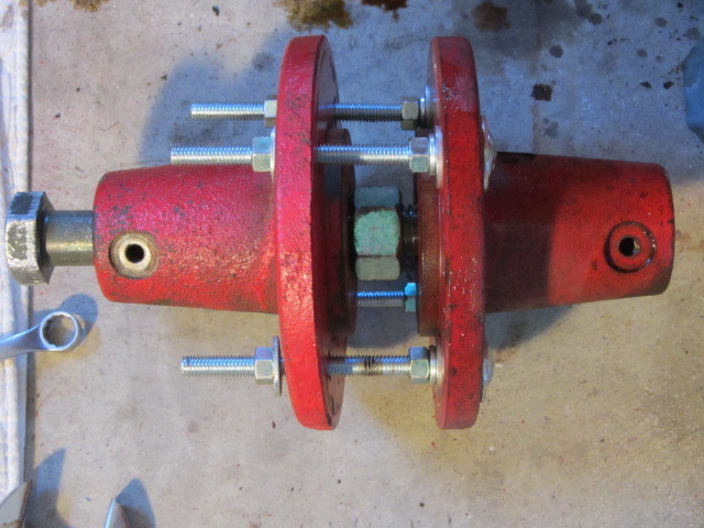

ztnoo 2,302 #16 Posted February 29, 2016 (edited) From my brief experience so far, I'd have to agree with squonk about the hub puller for the most useful, single, specialized purpose tool a guy could probably have. I got a real education pulling the hubs on my GT 14 which hadn't been removed for about 35 years. With a lot of help and suggestions from other members, I was finally able to get the job done using another GT 14 hub I bought specifically to use for this procedure. squonk's puller is more versatile because it can be adapted to multiple bolt patterns than what I came up with to get those stubborn beasts off their axles. After the fact, I learned if I had used a fine thread bolt for the "pusher", I would have spread the load over greater number of threads for a given distance, and decreased the effort required to turn the bolt. Also a bolt welded to the outside of whatever you choose to use for a puller, will allow closer placement of the two hubs to each other in the beginning of the operation, thus applying force as close to the axle as possible. It would also have allowed for more travel distance of the bolt. Edited February 29, 2016 by ztnoo 6 Share this post Link to post Share on other sites
