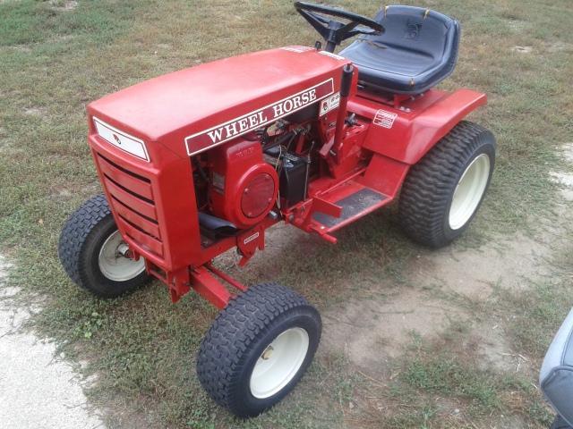

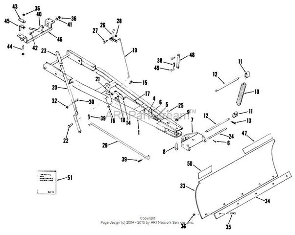

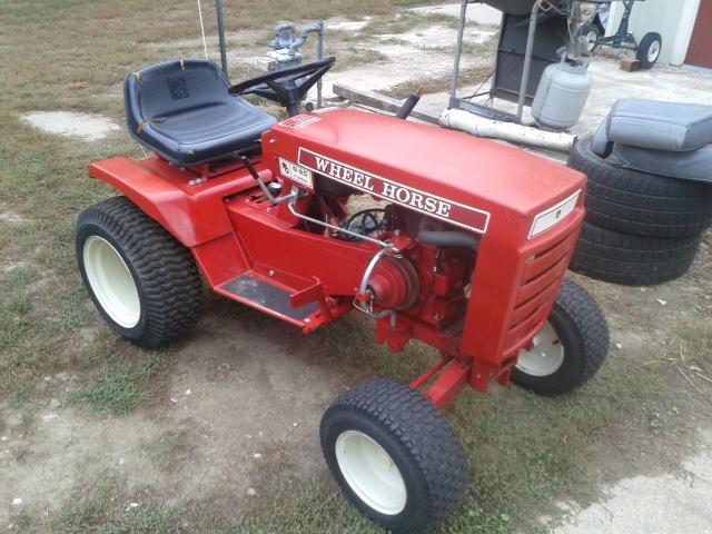

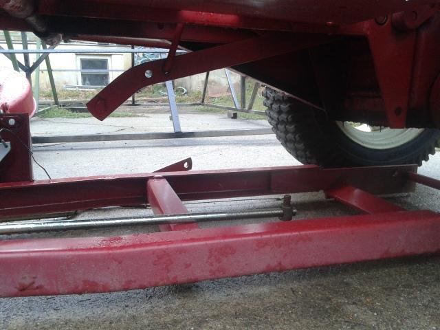

I have had the good fortune to acquire a 1977 Wheel Horse B80 recently and have already started to make needed repairs/improvements. One of which is the addition of a model 79252 plow which appeared to have everything attached with the exception of the rear axle bracket (which I have already ordered, received, and put on) a means to attach the frame of the blade to the lift mechanism on my tractor. All of the drawings I have seen call the part I am missing a "plate" with two possible numbers (105-1384-03) or (79551001).
My question is, "Does anyone have any pictures of this plow mounted on a B80?" I am just trying to ensure that this "plate" is all that I am missing before ordering it and paying $70 for it!
Any and all information would be greatly appreciated as I am pretty new to this, but am trying to keep my new found love of Wheel Horse alive.

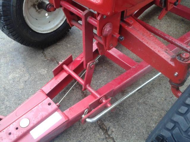

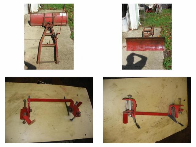

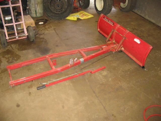

that model 79252 is NOT for the B-80.  You need a dozer blade as in these pics, or have a good weld guy on hand to prefab parts.
The correct dzoer blade does NOT hang in the front tach-o-matic hitch....it hangs from a chain or flat stock bar from the rock shaft, which is raised / lowered by the implement lift handle.  The back end of the dzoer blade locks into the rear axled hithc.

Very nice looking B-80.
When I saw the photo I realized I have never seen a plow hook up like that!

I do wonder why this plow fits so perfectly into tbe front hitch and the  rear hiutch.......i wonder if i could fabricate a bracket for the center lift to make it work.

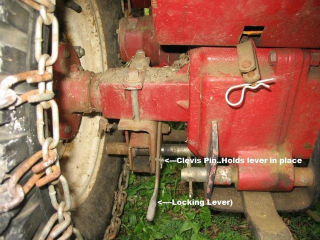

      Just wanted to show a modification I did to my 1990 310-8. I recently picked up a 36” tiller for my horse and I tried it out on my new garden area. After hitting a rock, it knocked one of the axle brackets open dropping the right side of the tiller. On a manual I viewed, it had clevis pins to hold the lever in, but my bracket did not have them. I drilled a 1/4” hole through on each lever and mounted a 1/4” clevis pin and hairpin cotter to reinforce the lever. I read on another post to just tighten the bolts on the levers, but I think this will work a little better. Hope this helps someone!
