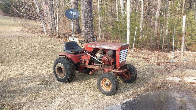

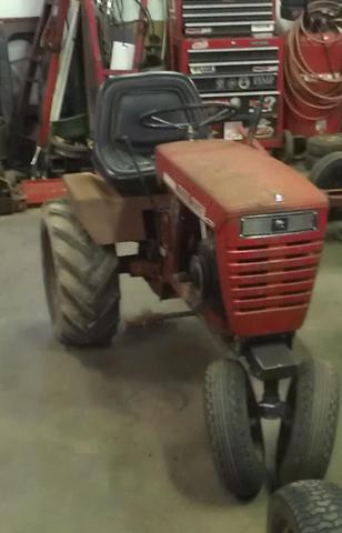

Nathanielperz 150 #1 Posted May 29, 2015 Hey guys I have an idea and I want some opinions and some advice as to how I could do it...So just try to stay with me here haha I'm trying to take my mental image and turn it into words so bare with me...what I want to do is make a second front axle for my 1276 but make it a trike front end. Sounds simple enough but here's the catch I want to be able to switch between the trike front end and the original.my plan would be to use the original front end for actual "work" and use the trike for fairs, shows, cruises etc. because I think the trike would make the tractor tippy with all the hills on the property.Feel free to ask questions and tips and ideas are greatly appreciated!Thanks in advance, NateI have attached pictures of my wheel horse with the original front end and a different wheel horse with a trike... Share this post Link to post Share on other sites
stevebo-(Moderator) 8,600 #2 Posted May 29, 2015 The tractor in the picture was built by one of our own here. He may chime in. Share this post Link to post Share on other sites
bmsgaffer 2,065 #3 Posted May 29, 2015 I believe the trike setup takes some pretty significant steering modifications to work properly. It would require some serious engineering to make it swappable... 1 Share this post Link to post Share on other sites

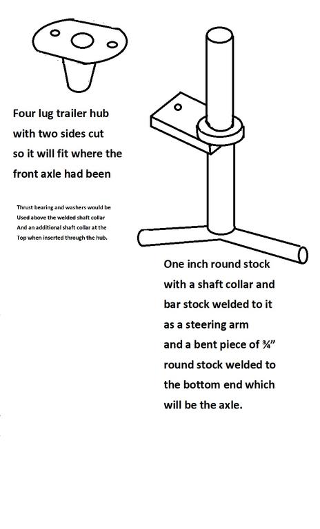

953 nut 63,075 #13 Posted July 5, 2018 Here is a drawing of the front end I was suggesting with the trailer hub as the pivot point. Share this post Link to post Share on other sites
