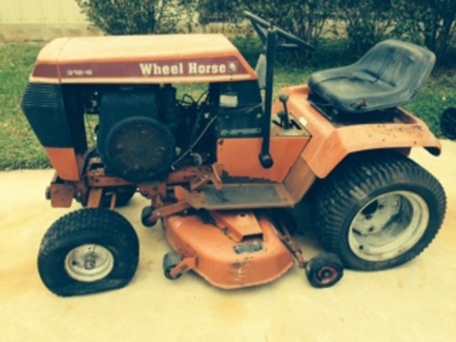

I 'm making this thread on the partial restore of my 312 that I introduced here a few weeks ago.. This will give me a place to post the many questions I'll encounter.
The current plan is to get it running and see what other bugs it has besides carb cleaning,  Then I plan to give all the sheetmetal a good paint job. Currently not sure about how far I'll go on painting the tractor chassis.
My initial thought was this was going to be by worker garden tiller tractor. My oldest son was home this past weekend and when my wife asked what he wanted for Christmas he promptly said that " old red tractor dad is working"on would be great for his new house. ......so you can see where this is headed!  He's actually a fairly good mechanic, so his hands will get dirty before this is completed

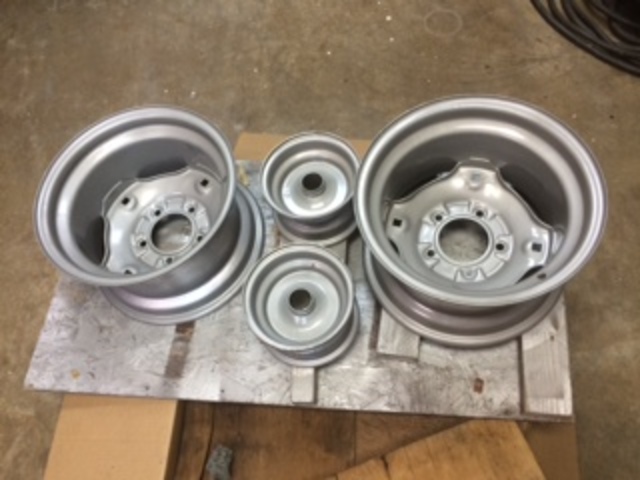

I've sand blasted and painted the rims so I can get some wheels under it. I used XO-Rust Aluminum for the first coat and it was too silver. Then I used some Rustoleum High heat engine paint for the second coat and it looked a lot closer to the original gray-silver.  The book says it came with 23x9,50-12 rear tires. The original tires were terribly dry rotted. Today I saw some 23x10.5-12 reat tires on Craigslist. Can anyone tell me if they will fit or will they be too wide? since I'm in Texas I won't need inside room for snow chains.
As i previously mentioned the engine would run when i sprayed gas into the carb, but not on it's own. The fuel system was very gunked up after sitting for a couple of years.  I've cleaned the tank, replaced tank grommet, valve, hoses and filter.  I soaked the carb for 3 days to dissolve the hard grey/black residue that was built up on the top bowl faces and everywhere. My carb parts kit came and valve cover gaskets came in today. This weekend i hope to adjust the valves and clean the breather, Then reassemble the carb. Looking forward to hear how it will run.

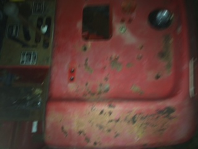

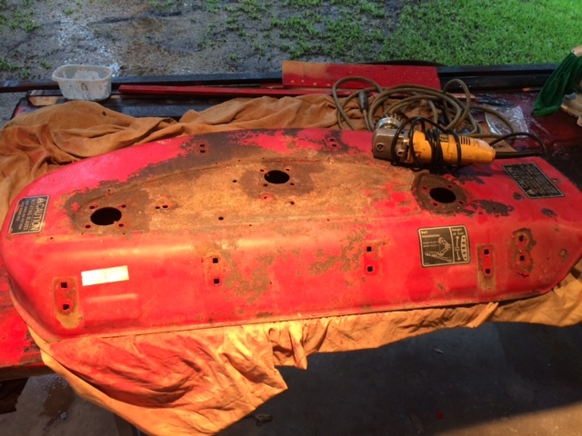

Most of the sheet metal has surface rust, but the rear fender pan has some heavy pitting.

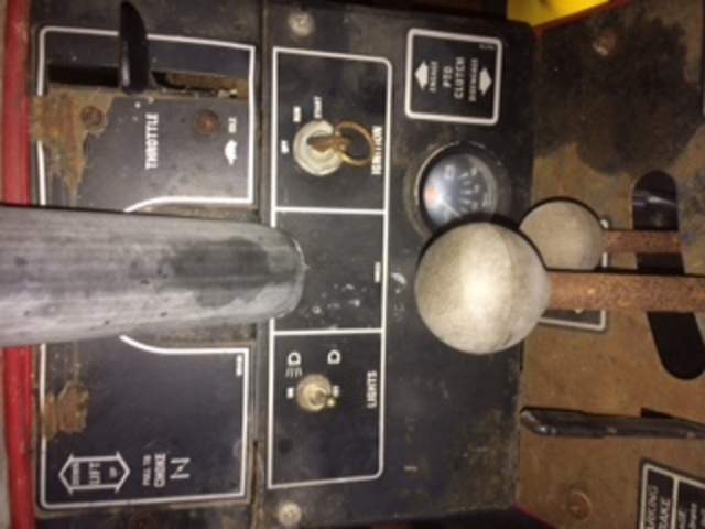

I didn't see a 1985 tractor manual for the 312-8 on the website, did I miss it?
I found the 1986 manual and noticed it listed an hour meter and alarm lights on the dash that mine doesn't have. Were these options in 86, or new in 86?

You are correct. We do not have the 1985 operator manual but do have the correct wiring diagram.

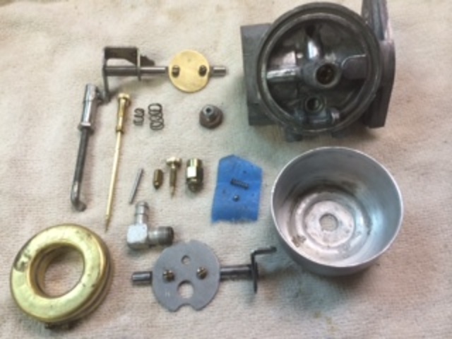

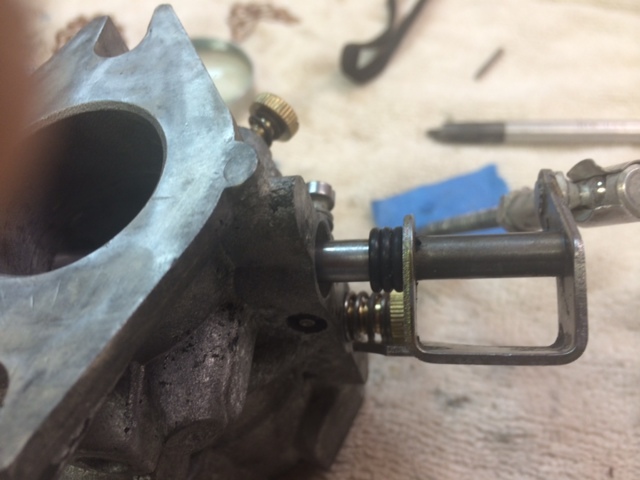

I did get the carb reassembled. Those choke and throttle plate screws sure are fun to get back together.
When I ordered my carb parts i couldn't find a throttle shaft seal, and this one was missing. I put three tight fitting 0-rings on the shaft that just filled the dept of the seal chamber and made sure the shaft still moved freely.

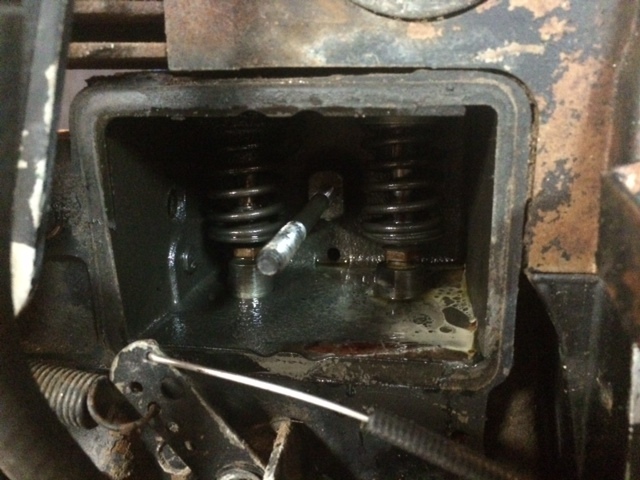

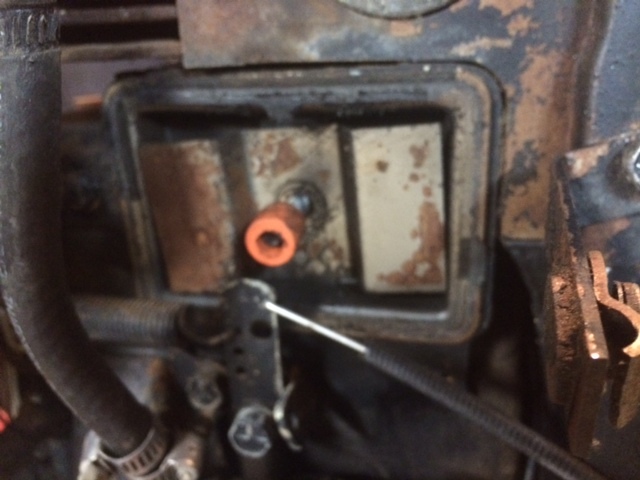

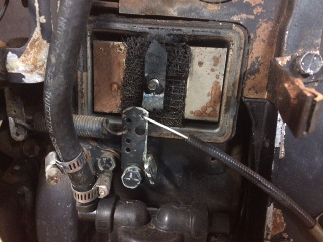

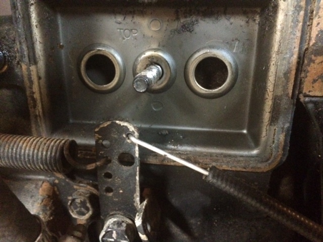

I almost passed on pulling the breather to check the valves, but glad I didn't. The breather mesh was very dirty.
 The lifters seems a little sticky in their guides so I used a tooth brush & WD40 to clean them. Once they moved freely I found the exhaust valve had .022ths and the intake valve had ,006ths clearance. I rotated the flywheel several times to recheck this measurement. This k301 has the adjustable tappets, so their adjustment is next.
The disc at the top of the exhaust valve spring has quite a bit of carbon built up on it.  Is it safe to use some spray carb cleaner in this area if I plug the oil drain hole so it doesn't drain back into the engine.

My deck has a 3" by 5" area of heavy pitting but not  It's not in a structural area. Some pits are probable have he metal thickness deep. What can i use it fill/smooth is area that will survive the mower deck vibration?
Will Bondo auto body filler work, or do I need something stronger-more vibration resistant..
You can use BJ Weld it will stay in place. It's a lot harder to sand then body filler so don't put more then necessary to fill the voids.

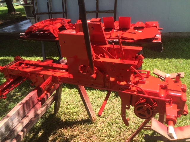

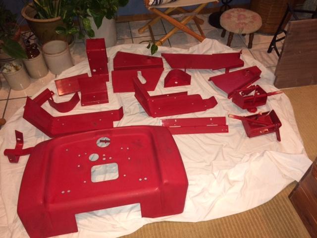

It's been awhile for an update so here goes. After getting the tractor running I used the tractor around the yard some this winter to find any problems. Then about 2 months ago I tore the tractor down to a rolling chasis  After seeing all the carbon on the valve stems back when I adjusted them I pulled the head and could see pitting on the exhaust seat. The bore looked good and only showed  0,003 wear in the worst area and was within spec so so I'm leaving it alone. So I pulled the engine and it's at a machine shop getting the valve seats and new guides installed. .

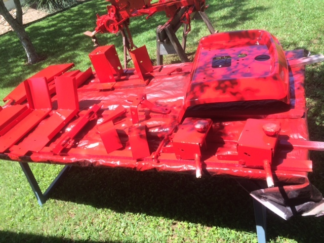

Here;s all the small sheet metal blasted, primed and painted with the 1st coat of Rustoleum Sunrise Red.with hardener. Since this is a worker, all the nuts, bolts and tiny little pieces were buffed clean with a grinder/wire brush and given 2 coast of rattle  can paint.
312-8_sheetmetal_1st_coat_red.thumb.jpg.

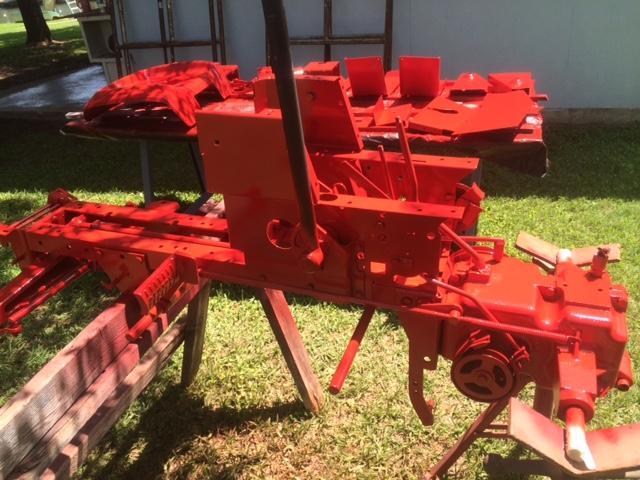

Here the chassis with the 1st coat of red.
312-8_frame_1st_coat_red.thumb.jpg.534bf
Yesterday I sanded them with 400 wet/dry paper and their ready for their 2nd coat. Due to the rainy weather we're having i have them stored on the game room floor
1st_coat_red_sanded.thumb.jpg.a8a8640b58

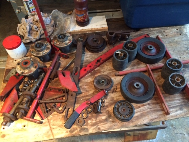

This morning i tore the mower deck down. The shell has some pitting and needs a little straightening on the front edge, but no cracks.
42_in_SD_deck.thumb.jpg.02cfa960893c7049
There sure are more parts to a deck than meets the eye when assembled. The aluminum hubs looked good with very minor corrosion.

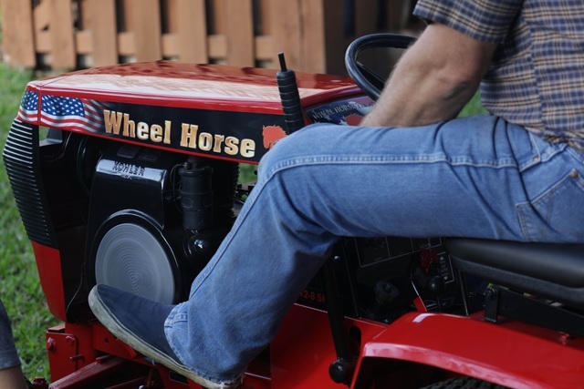

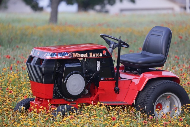

I was at my sons house recently and looked the 312 over.  He uses it for mowing which we have 8 months of in Texas.  it's been 5 years and the Rustoleum Regal Red with hardener still looks  like new.  Everything on the tractor has held up excellent.  He keeps it in his shop so that helps a lot.
  • Like 1
  • Excellent 1
DeepH2O
Truly a work of art!! It really has me 2nd guessing not taking mine all the way down to the frame!!
