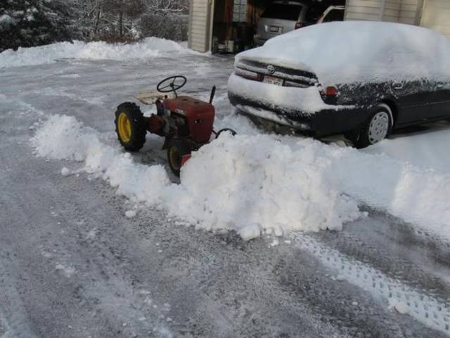

Thanks for the welcome.  Here it is plowing snow before the problem.
