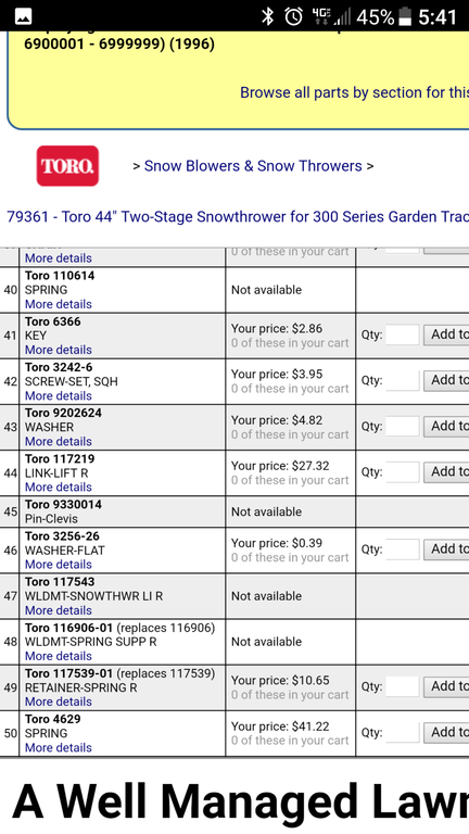

I know the helper spring Toro part# 110614 has been discontinued for the model 79361 2 stage snow blower. Mine was missing and I would like to see if I could find a match to it. Does anyone have one or could give me some idea of the specifications for it?
Thanks
Hydro, at "Pats Small Engines Plus" online they are still showing that spring available. Might check maybe they have not updated but usually they are pretty current. Also just for my curiosity you are talking about the spring on the lift rod, not big one (that is on the right side as your sitting on the tractor) that is connected to the blower frame up by the right front wheel. That spring is 4629 that is also the same assist spring as the tiller uses and is still available.
.... No the big spring I have and it is still available apparently must be existing stock is not yet depleated. The one I am referring to attaches to the flag and then the frame. It's a secondary spring I guess you'd say, not as heavy as the one up front on the right. This one is one the left roughly under the attach a matic. I have no problem with the hydro lifting it but I might as well try to get it then I have everything in the event I ever switched to a manual lift.

  Looking for Part #'s  110614 assist spring and 4629 Lift Spring,
Does anyone have any measurements/material type and Min/Max load.
Thanks
Edited by BaySide1
110614 assist spring, 4629 lift spring

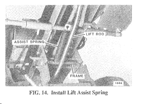

The lift assist spring 4629 is the same as the tiller/single stage spring you can get another from @wheelhorseman, the 110614 I don't have or use with the hydraulic lift and isn't available through Partstree.com anymore , from the exploded view it looks like it goes from the lift rod to a bar on the blower frame, maybe @cleat would know what size it should be, but I'm sure something at TSC could be of a acceptable replacement, Jeff.

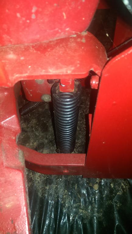

That lower helper spring on the lift actuator rod -- the one in your picture looks a good bit beefier than the one on my 2-stage blower. The one I have is thinner material but darn hard to get extended and hooked onto the flag on the rod. I'll give it another try tomorrow, but I may leave it disconnected since I've got a hydro lift. It was a pain in the neck when I took the blower off when I got the tractor home last Spring; I think I left it connected and dropped the lift link, then took it off the flag. Putting it back together that way doesn't work well because the darn spring moves around and gets in the way... :confusion-scratchheadyellow:
Noticed any ill effects leaving the spring off? The hydro lift doesn't seem to have any issues hoisting it without the spring.
