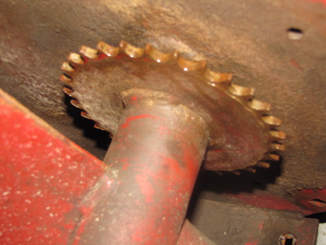

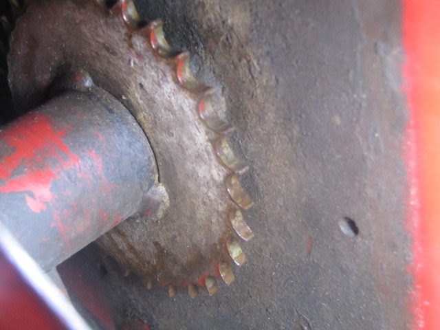

I've been reading through various chain & bearing repair posts regarding the snow thrower.  I have just acquired a 1994.  The auger, jack shaft bearings and drive sprocket are in good shape.  The blower needs idler pulleys, a chain and the inside sprockets.  The auger sprocket rotates with about a 1/4" of wobble and the teeth are getting sharp. Is it normal for the auger sprocket to be off a little when manufactured?   The auger itself runs true.  Not sure how far to go with the rebuild as I know the auger sprocket would have to be re-done at a machine shop.  Here are a couple of pictures of the sprocket teeth.  What do you think?
Thanks for your time.
