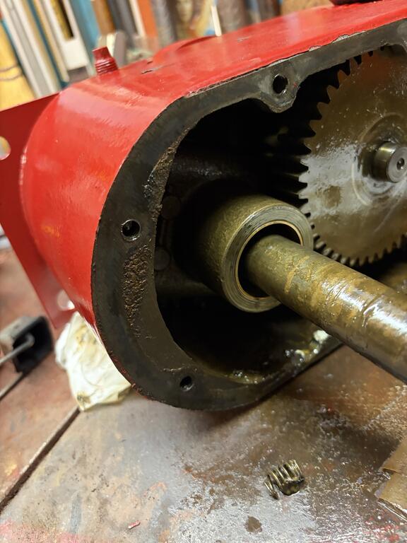

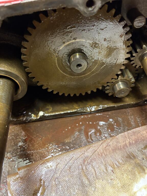

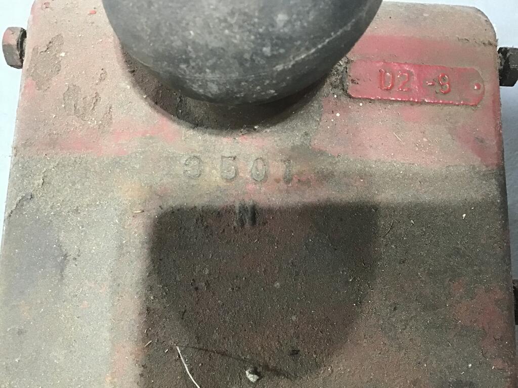

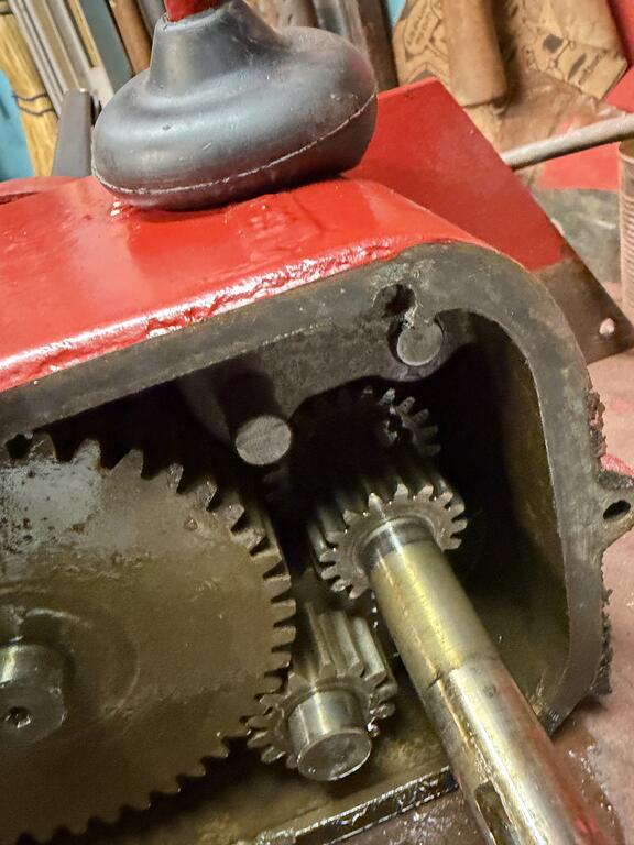

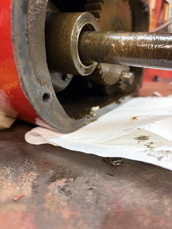

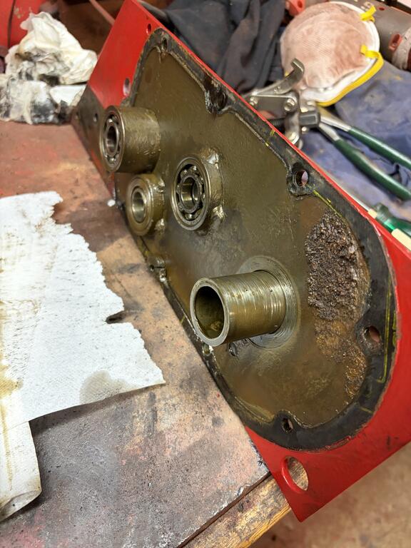

C-85 829 #1 Posted September 21 I was thinking I was wrapping up my 400 restoration project and then I decided to waste about a quart of 90w gear oil! I should have known that bad things were coming because its transmission was out of oil, so I put some in then saw leaks on its right side. I checked the cover bolts and the one on the bottom right rear was very loose. I tried tightening it and quickly realized I was stripped so I run tap through it and that didn’t grab hardly anything. Then I thought I would just tap it out to 3/8 (it was 5/16) and that didn’t really get started either. After a long process of getting the right hub off (I was surprised it finally came off w/o breaking it) I took its right side cover off and found a real mess, 3 of the bolt holes were broken off! So I’m trying to figure out how I can fix this or if any used ones exist. At first I thought I might run a threaded rod to its left side but it looks like any rods will interfere with some of the gears HELP! C-85 6 Share this post Link to post Share on other sites

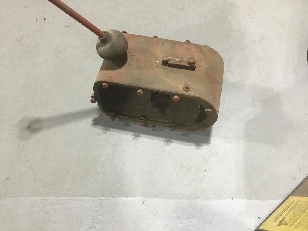

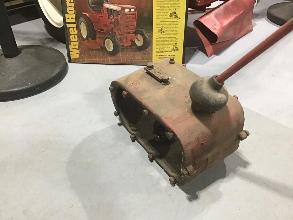

c-series don 12,651 #6 Posted September 21 (edited) Honestly I think I have one! Is this it? Edited September 21 by c-series don 3 2 Share this post Link to post Share on other sites

C-85 829 #8 Posted September 21 Thanks for the suggestions, this group is full of critical thinkers! C-Series Don, I would be very interested in that case you have! C-85 1 Share this post Link to post Share on other sites

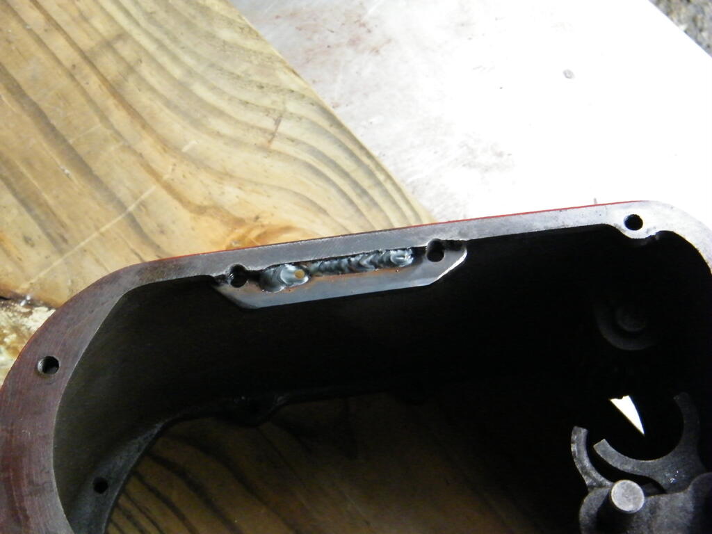

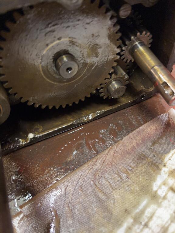

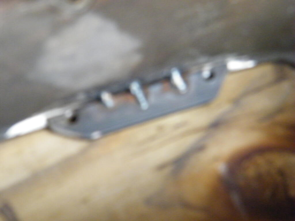

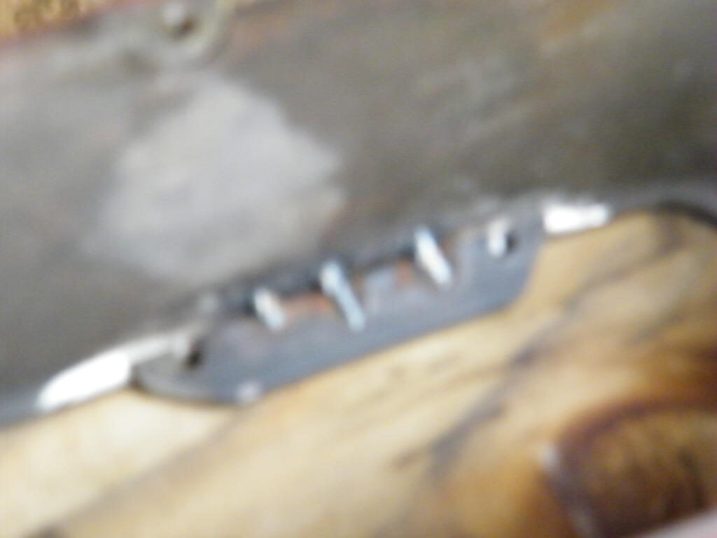

stevasaurus 23,883 #10 Posted September 22 Those tabs are real fragile, but they can be repaired. I found the right guy to weld a case I had at an old radiator shop...cost me $20. Here is a couple of pics. Personally, I would take Don up on his offer...but keep your casting. It is fixable. You do have to be very careful with welds so as not to interfere with any gears. Things are tight in there. 1 3 Share this post Link to post Share on other sites

stevasaurus 23,883 #15 Posted September 23 On that case I pictured, I had to use fiber washers to stop the leaks...they worked. Look at the 1st picture, the mistake is the welds are not even with the sealing part of the case. The fiber washers did work though. The bar (metall) I used is 3/4" x 36" available from ACE Hardware. Share this post Link to post Share on other sites
