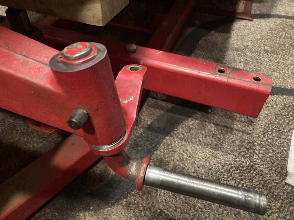

pfrederi 21,342 #7 Posted August 16 17 hours ago, sqrlgtr said: @peter lena Yeah replaced wheel brgs with some quality machined brgs. Also cleaned all the old grease out of spindle bores and spindles and put new red and tacky grease in them. I would like to install brgs under spindles like the 520H has it steers a-lot easier😃. Just have no mill to do it with. I am sure the machinists will cringe but to put flat thrust bearings and/or oilite bearings on I just grind a bit off the top of the axle enough so the e clip can go back on. I know the bottom of the axle may not be perfect but it is better than nothing and I have no way of resurfacing that side. 1 Share this post Link to post Share on other sites
sqrlgtr 4,224 #8 Posted August 16 (edited) 3 hours ago, pfrederi said: I am sure the machinists will cringe but to put flat thrust bearings and/or oilite bearings on I just grind a bit off the top of the axle enough so the e clip can go back on. I know the bottom of the axle may not be perfect but it is better than nothing and I have no way of resurfacing that side. @pfrederi I have been debating on trying this and you may have just given me the courage to do it. I have one or two axle laying around if I mess up to bad, I reckon. you know I seem to remember someone using a piloted cutter also with pretty good luck. Edited August 16 by sqrlgtr Share this post Link to post Share on other sites

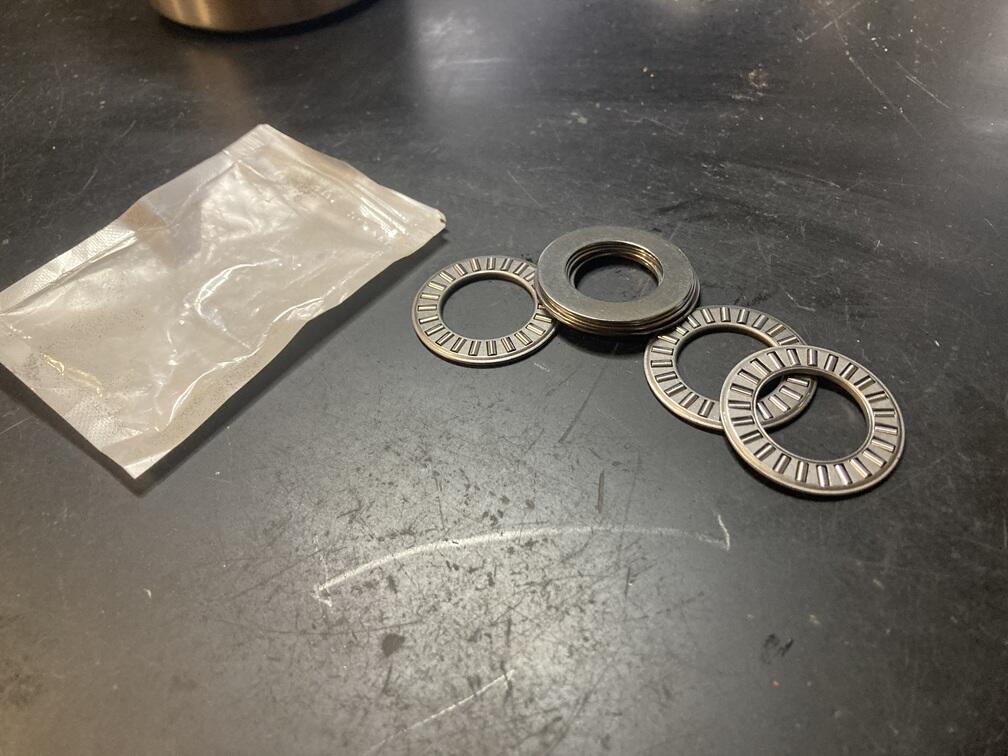

ineedanother 2,885 #9 Posted August 16 1 hour ago, sqrlgtr said: @pfrederi I have been debating on trying this and you may have just given me the courage to do it. I have one or two axle laying around if I mess up to bad, I reckon. you know I seem to remember someone using a piloted cutter also with pretty good luck. I just did this a few weeks ago on my 161 thinking it might help when I installed the FEL. I used a 60 grit flapper wheel on an angle grinder to take the top off the axle. Washers and bearing were only 1/8" and it was surprisingly easy to take that off. 1 3 Share this post Link to post Share on other sites
sqrlgtr 4,224 #10 Posted August 16 (edited) @pfrederi @ineedanother you got a link to those bearings and washers, I need to go ahead and order them. Then I want have any excuse not to try it . BTW could you tell any difference in steering? Edited August 16 by sqrlgtr Share this post Link to post Share on other sites
ineedanother 2,885 #11 Posted August 16 Lots of them in the jungle. https://www.amazon.com/dp/B0CMQDRWMD?ref=ppx_yo2ov_dt_b_fed_asin_title I put hiem joint tie rods on at the same time so I can't say what made more of a difference but it's definitely better. 1 Share this post Link to post Share on other sites
sqrlgtr 4,224 #12 Posted August 16 11 minutes ago, ineedanother said: Lots of them in the jungle. https://www.amazon.com/dp/B0CMQDRWMD?ref=ppx_yo2ov_dt_b_fed_asin_title I put hiem joint tie rods on at the same time so I can't say what made more of a difference but it's definitely better. Thanks, I had ordered some fer the 520H but couldn't remember what size I needed for the C160. Share this post Link to post Share on other sites
