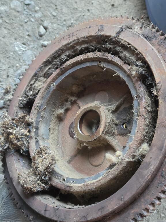

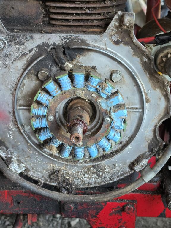

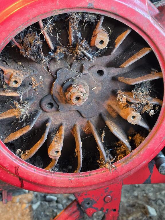

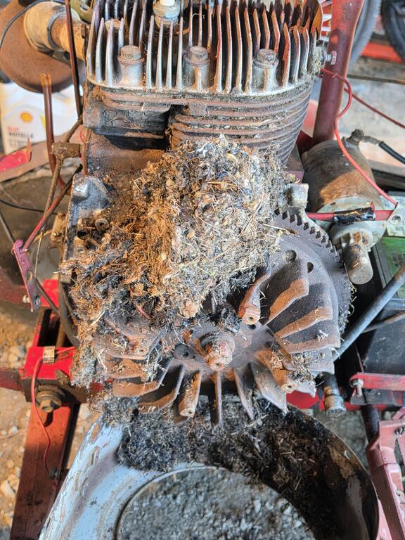

gt14rider 1,291 #5 Posted July 28 Hi all, @Bill D, @953 nut i did check stator . Checked resistance between the two wires,(should be 0.1- 0.2 ohm ) 0 ohms. Checked resistance each wire to ground, infinity 0.00 ohms. Tractor has been in a shed with a tarp over it for about 30 years. Lots of mouse house pack in fly wheel and starter. Have not run eng long enough to test rectifier when running. Thanks Tim 1 Share this post Link to post Share on other sites

Bill D 3,213 #7 Posted July 28 1 hour ago, gt14rider said: Hi all, @Bill D, @953 nut i did check stator . Checked resistance between the two wires,(should be 0.1- 0.2 ohm ) 0 ohms. Checked resistance each wire to ground, infinity 0.00 ohms. Tractor has been in a shed with a tarp over it for about 30 years. Lots of mouse house pack in fly wheel and starter. Have not run eng long enough to test rectifier when running. Thanks Tim 0 ohms is fine. That means it has continuity with no resistance. Infinity means the windings are open. If your meter has a setting where it beaps if you have continuity, I'd try that and see what happens. If it beaps, it's good. I'd get it running and see what the AC output from the stator is first before I'd change it. 5 1 Share this post Link to post Share on other sites

953 nut 70,648 #10 Posted July 29 On 7/28/2026 at 7:31 AM, gt14rider said: Tractor has been in a shed with a tarp over it for about 30 years. Lots of mouse house pack in fly wheel and starter. Mice really enjoy the privacy a tarp provides them, Hope the stator is good, hard to get a good reading on extremely low resistance like that. 1 Share this post Link to post Share on other sites
gt14rider 1,291 #11 Posted July 29 Update, took the rectifier out, sanded and cleaned contact points, ran a ground to the battery. The back of the rectifier was dark in spots, but not burned , the plug was melted, someone rapped it in electrical type. Got the engine running, checked out the stator, 30 volts AC, that was only 3200 rpm. Needs linkage adjusted, plugged in rectifier and 14.2 volts DC at 3200. 4 1 1 Share this post Link to post Share on other sites
