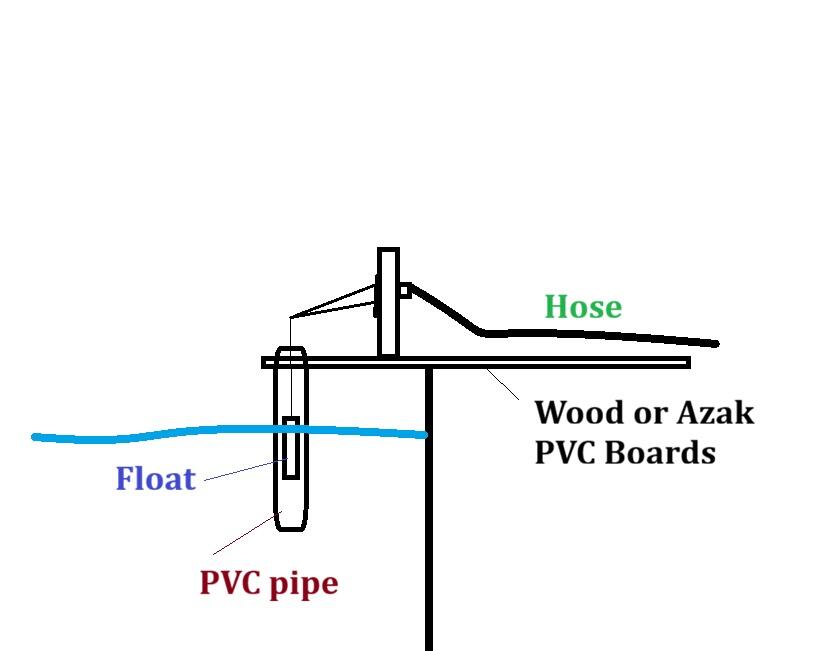

wallfish
Posted (edited)
11 hours ago, Pullstart said:
Two- Toilet fill.
I have thought about this often too.  I could easily just build a drop in system and stick the hose on it.  I have limited space in the skimmer box, and I have a feeling that when my brother in laws come over for their self proclaimed cannon ball contest, the water may have the ability to break the mechanical valve.
The valve I posted works with a cord from the valve to the float so there's no rigid connection to the valve. They can cannonball all they want and the cord will flex. Plus the float is filled with water to adjust the swing from fill to full so It doesn't just completely float on the surface. Waves and such wouldn't be an instant hard shock to the float and it will bob on the surface. If you set it up so the float hangs inside of a piece of 3" PVC pipe, it won't be affected by waves at all. :twocents-02cents:
