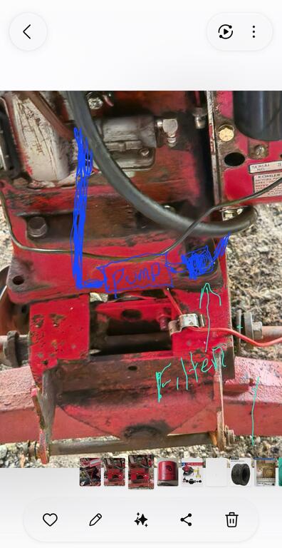

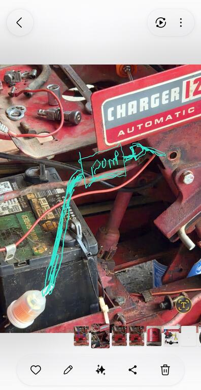

gt14rider 1,278 #10 Posted July 15 Got another question, best place you've found for the pump? Near tank( maybe under tank) or in front of engine? I'll make a bracket for mounting. Sorry for the bad artwork Share this post Link to post Share on other sites

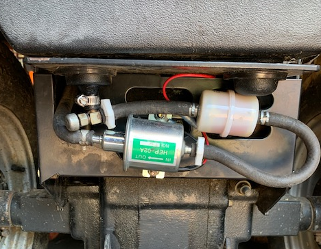

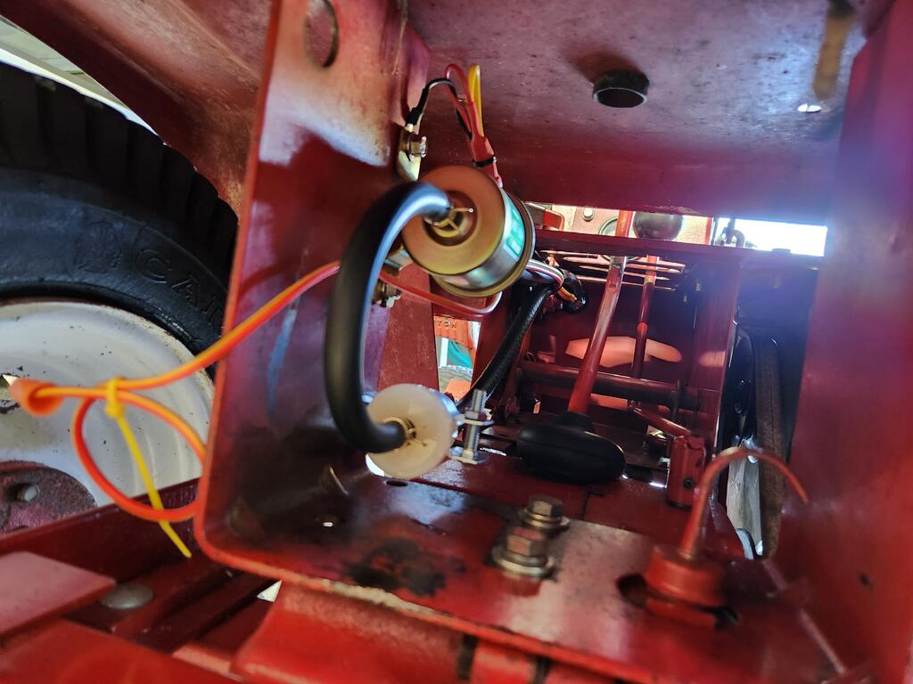

JoeM 10,155 #11 Posted July 16 Best (I think a must) if the pump is lower than the tank. It is not easy but with a little creativeness can be done On this one the filter is back near the tank and the shift plate can be taken off to change filters. I do use an automotive wix filter that has a large capacity. Rear pump mounting on an xi, not some of my best work. It was a cheap pump and worked really nice. 1 Share this post Link to post Share on other sites
gt14rider 1,278 #12 Posted July 16 @JoeM nice work, first Pic, where's the battery go?⁰ Share this post Link to post Share on other sites
JoeM 10,155 #13 Posted July 16 (edited) This one has the battery up on top and rear tank. Your doing the right thing just putting the pump in a place and seeing if it is workable. These machine sometimes are tight on space. Edited July 16 by JoeM 1 Share this post Link to post Share on other sites

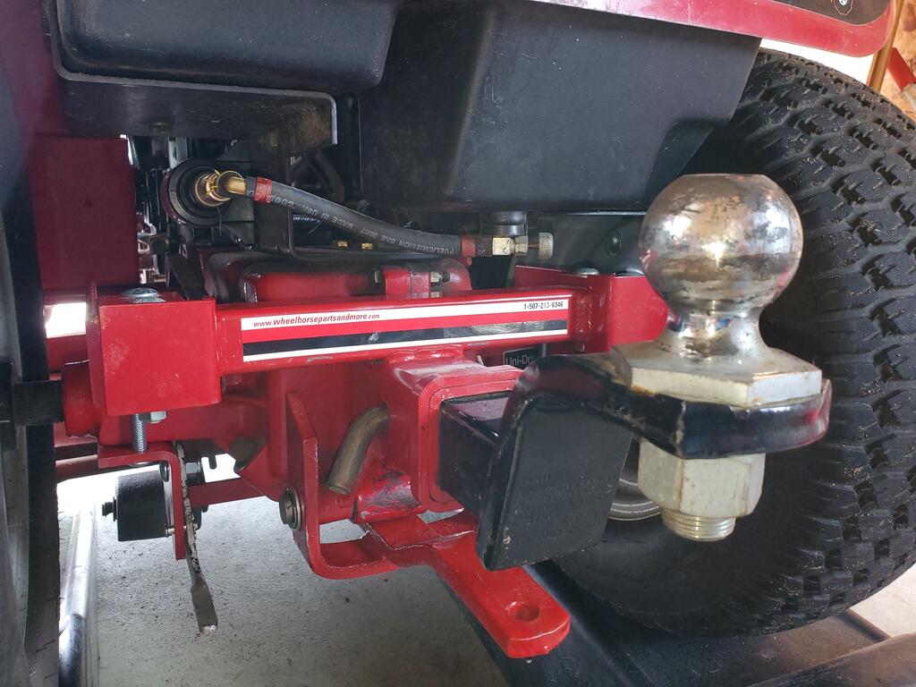

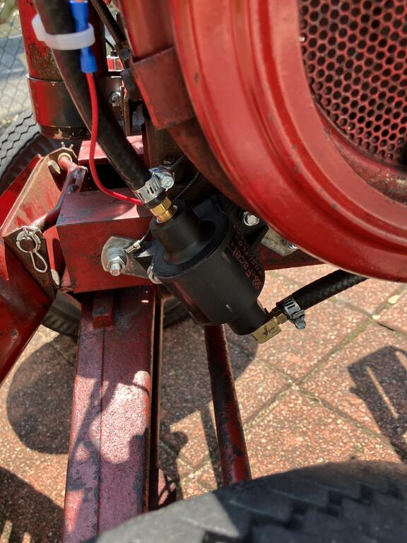

Racinbob 13,110 #14 Posted July 16 11 hours ago, gt14rider said: Got another question, best place you've found for the pump? Near tank( maybe under tank) or in front of engine? I'll make a bracket for mounting. Sorry for the bad artwork Every tractor is different. It's best to have it below the tank. On my 2005 Classic (pic above) the location was almost a no brainer. But it can't happen on a hydro. On my 76 I didn't like anything under the hood. The fuel tank and battery took up a lot of the space. I ended up mounting it under the seat and running the extra fuel line. This is the original install. That's a cheapie pump which failed about 3 football fields from the garage. A 42s has replaced it. 1 Share this post Link to post Share on other sites

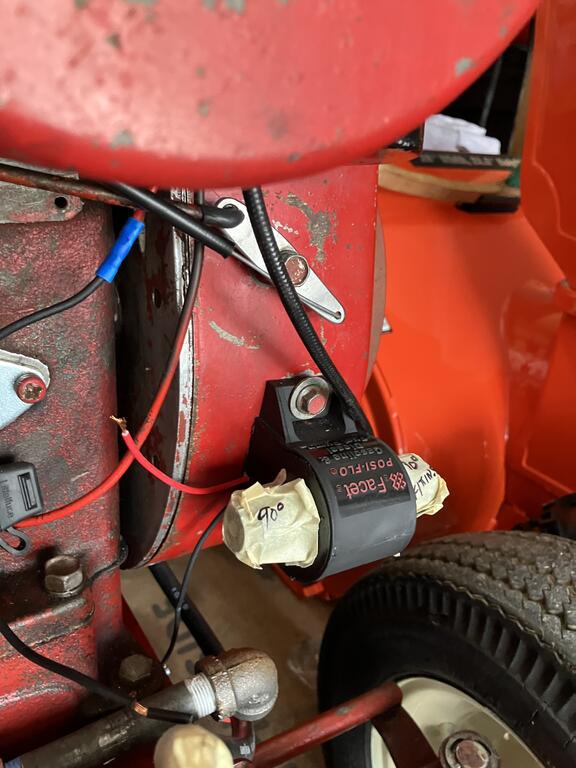

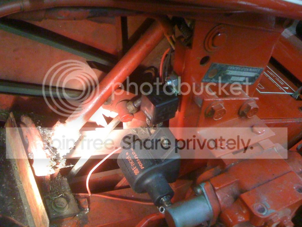

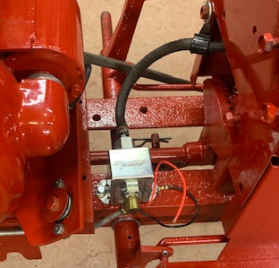

sqrlgtr 3,701 #16 Posted July 17 first pick is 520H with Facet metal pump 2nd pick is Facet plastic pump that went on 312-8 in same place as 520h, I cant find pic of 312 pump mounted but you get the idea. Both work great but believe I prefer the metal cube type better just because it takes up a little less space than the plastic pump. 1 Share this post Link to post Share on other sites
