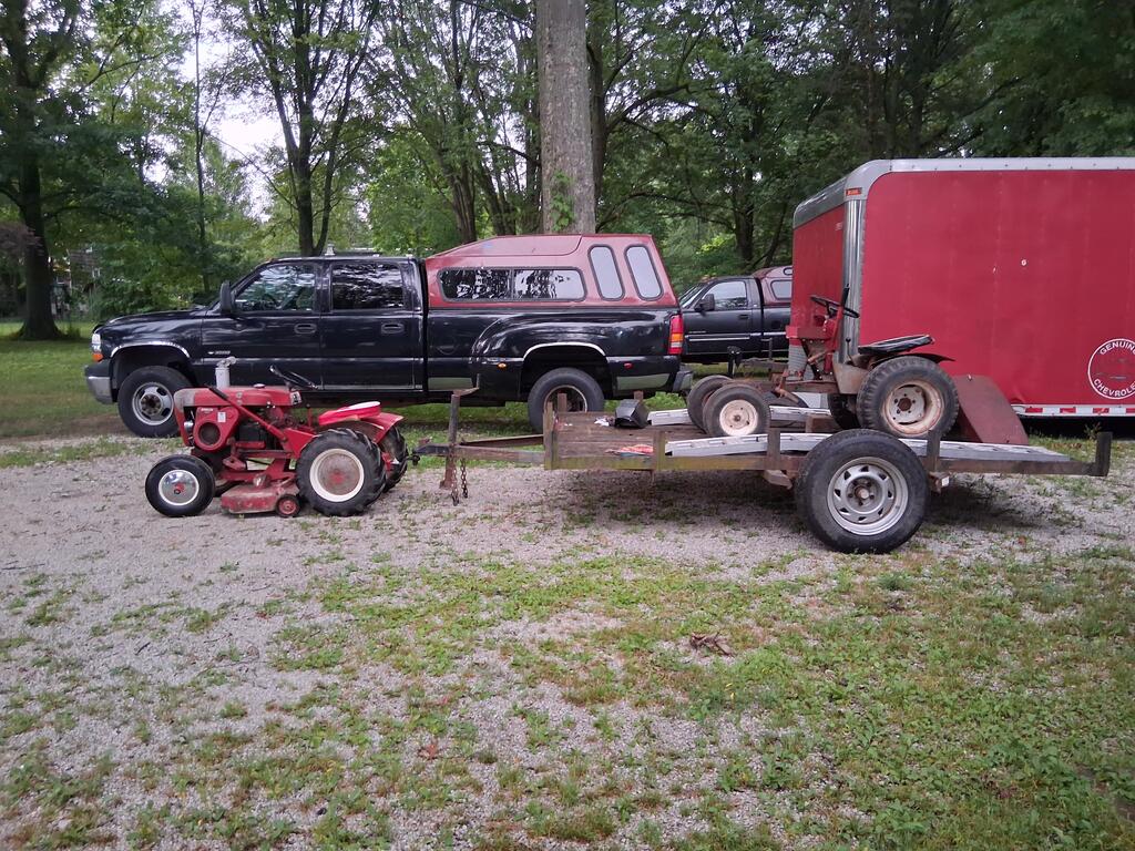

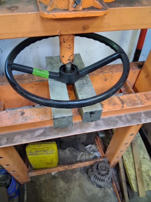

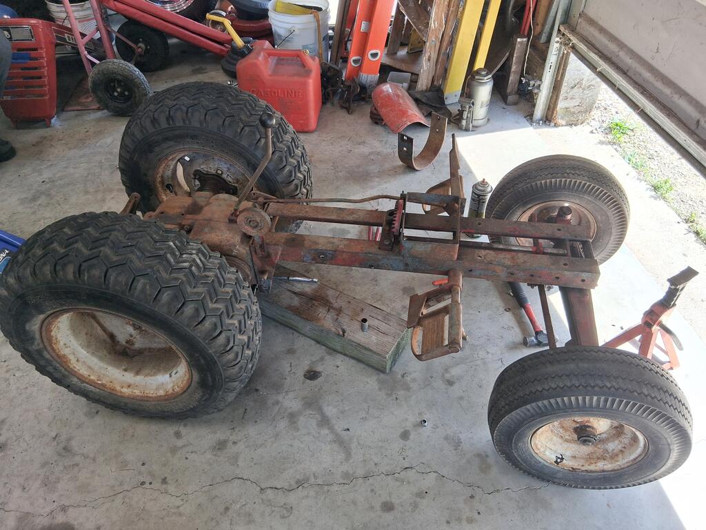

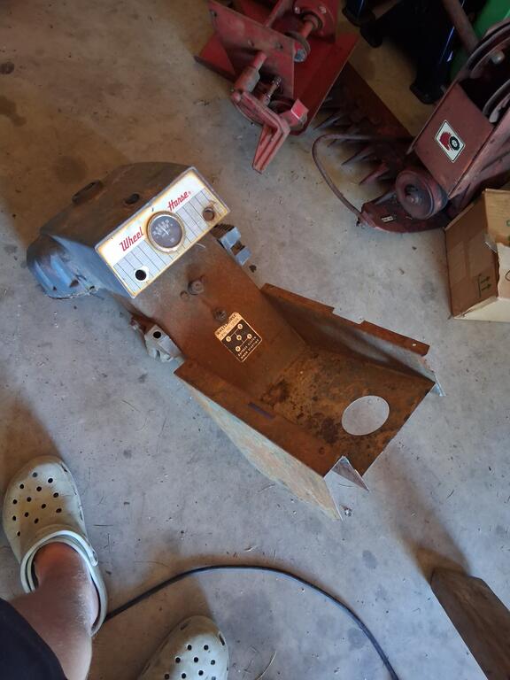

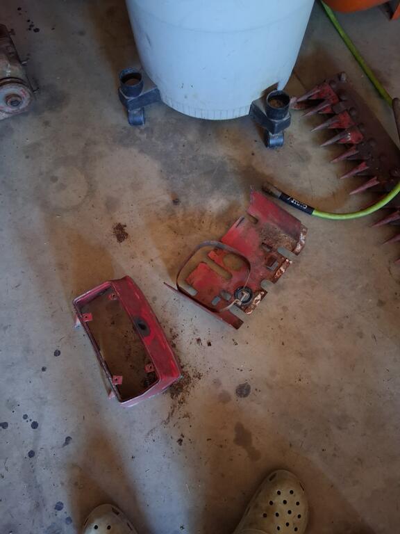

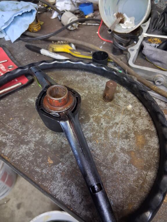

702854boy 1,069 #1 Posted July 4 (edited) At the big show I got a frame from a round hood, tranny, and dash tower from @Pullstart. I also got a short frame square hood, and the dash pieces from @Mike'sHorseBarn. I got a pullstart 8 horse from one of the guys in the barns and a steering wheel from one of the guys set up in the in field. When I got the steering wheel, it still had the roll pin and part of the cut off steerong shaft in it. I soaked it for a few days with kroil and worked on it yesterday. That was the easiet roll pin I've ever had come out once I figured out how to hold the wheel. The chunk of the steering shaft also came right out. I put it in our press and barely had any pressure on it and it moved. Today, having no power and it being hot, all I did was put the dash pieces together and set them on the tower. It's been 100 degrees and humid here since we got back from the show so I haven't really been able to work on very much. Edited July 4 by 702854boy 4 9 Share this post Link to post Share on other sites

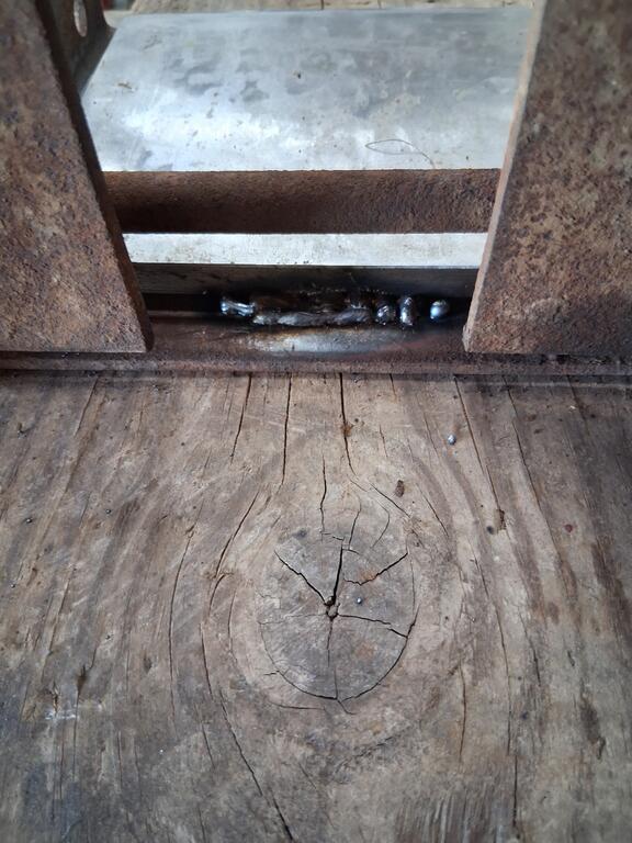

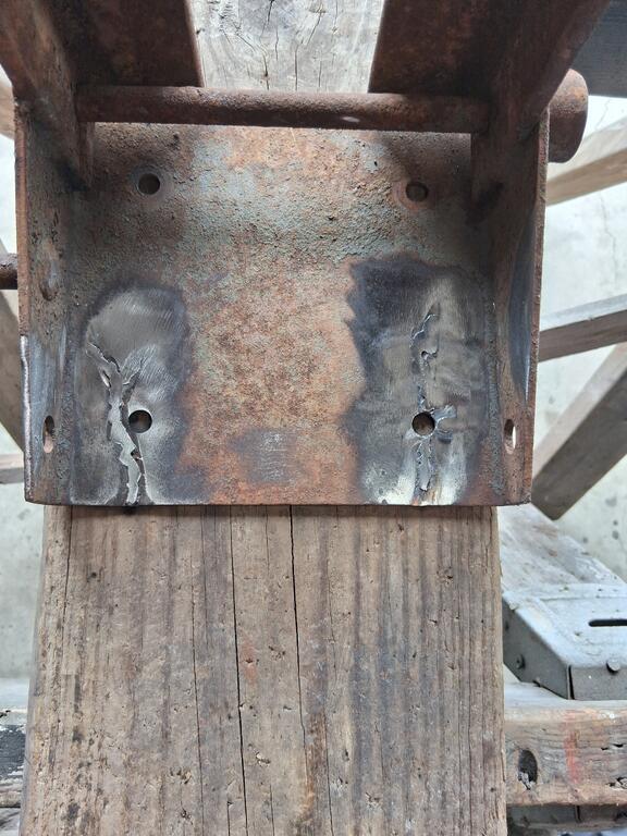

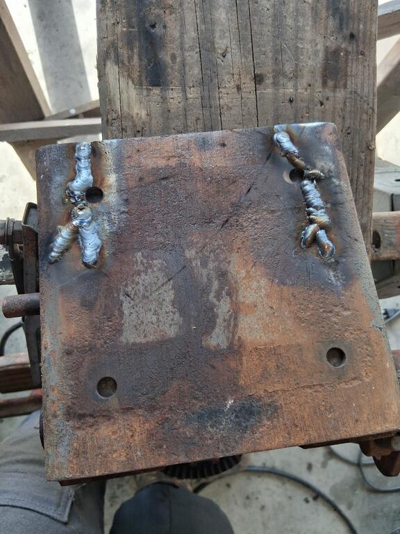

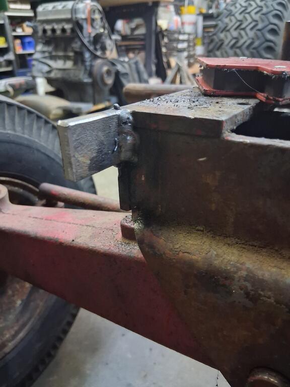

702854boy 1,069 #8 Posted July 7 (edited) I got my cracked f plate welded up today. How come you gave a frame with a cracked f plate Kevin, I want a refund. At least it gave me some welding practice. Edited July 7 by 702854boy 4 5 Share this post Link to post Share on other sites

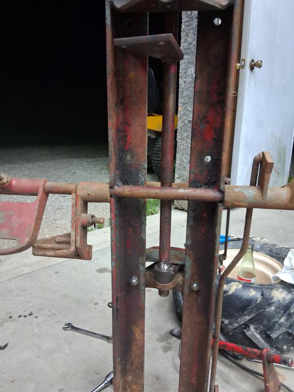

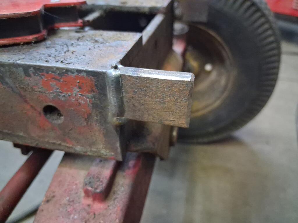

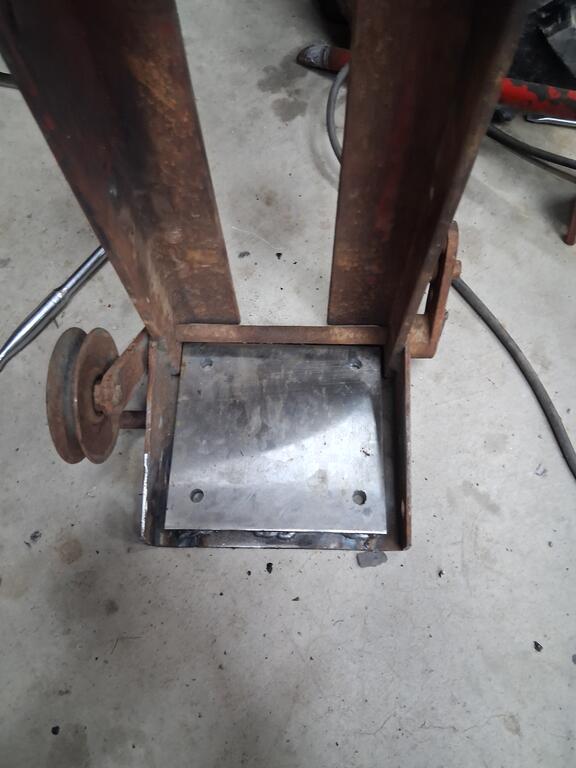

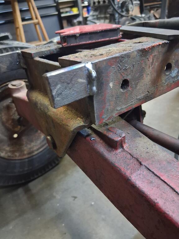

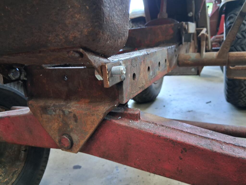

702854boy 1,069 #9 Posted July 8 Got my steering put together and drilled the holes in the f plate reinforcement plate 4 Share this post Link to post Share on other sites
sqrlgtr 3,580 #10 Posted July 8 10 hours ago, 702854boy said: the f plate reinforcement plate What size thickness is that f plate reinforcement? Looks beefy and should never have any more trouble with f plate. Share this post Link to post Share on other sites
702854boy 1,069 #11 Posted July 8 It's 1/4 and its from dad's work so we're thinking it might also be heat treated and hardened a little bit 1 1 Share this post Link to post Share on other sites

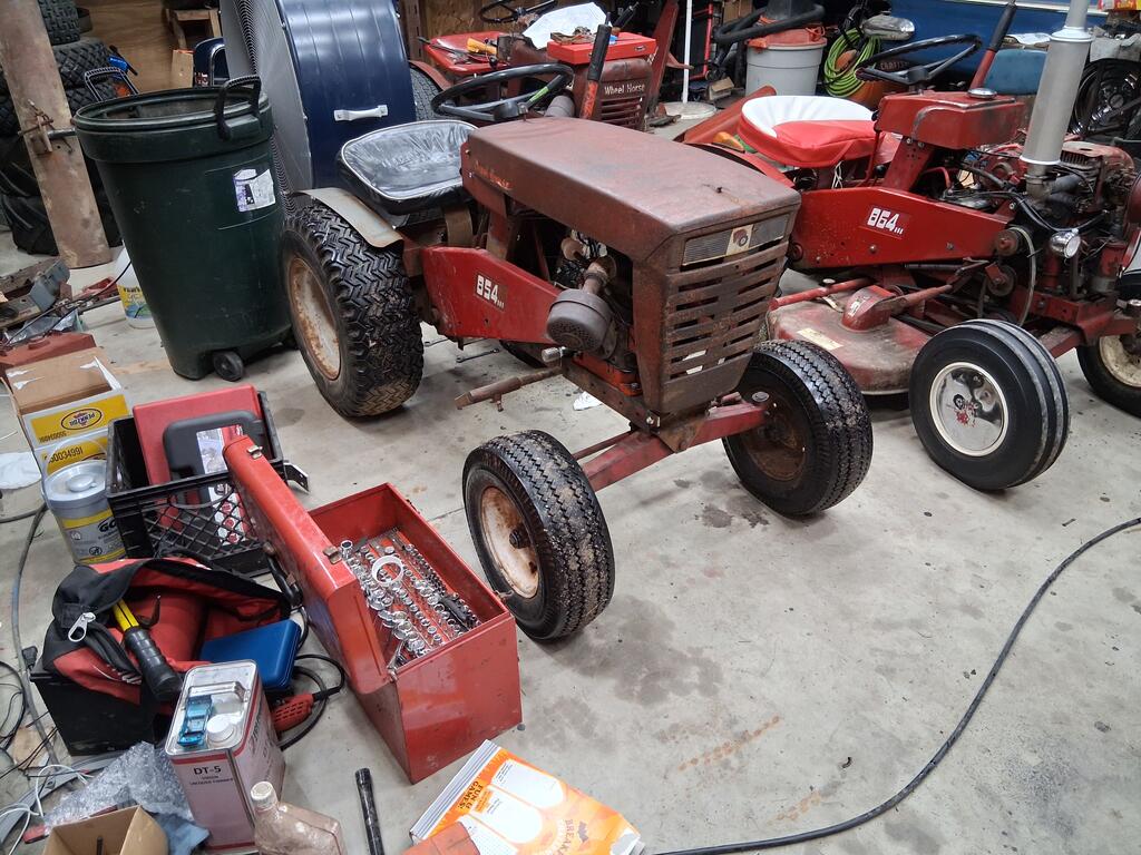

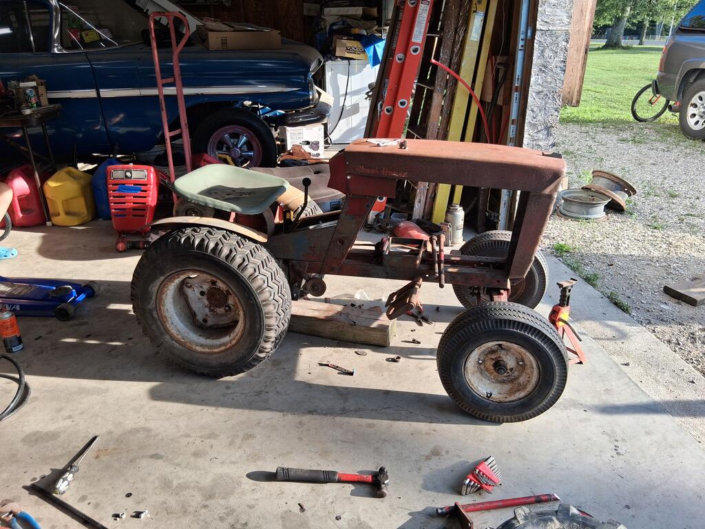

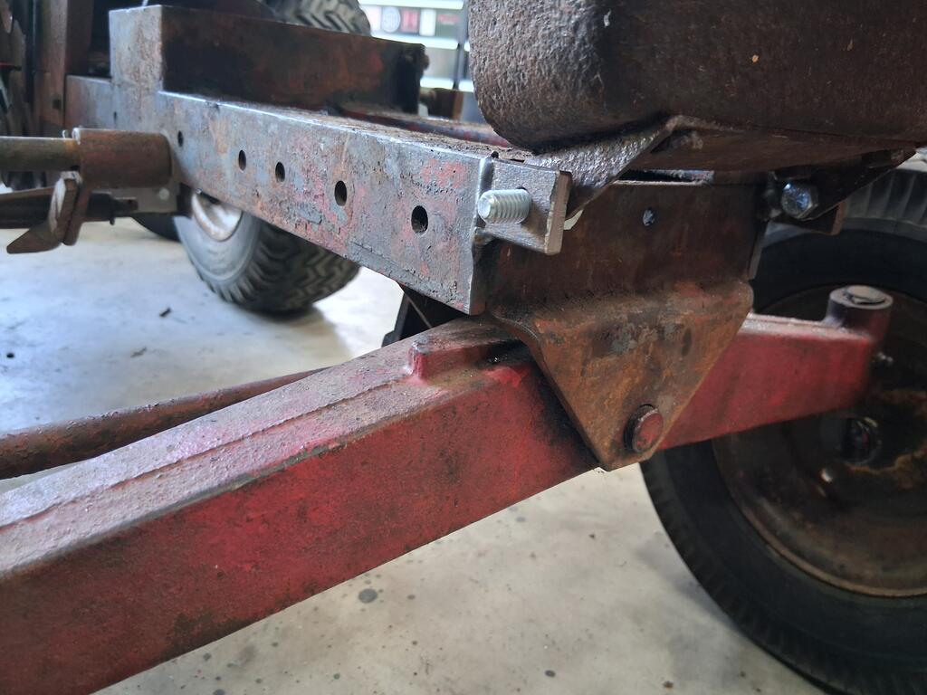

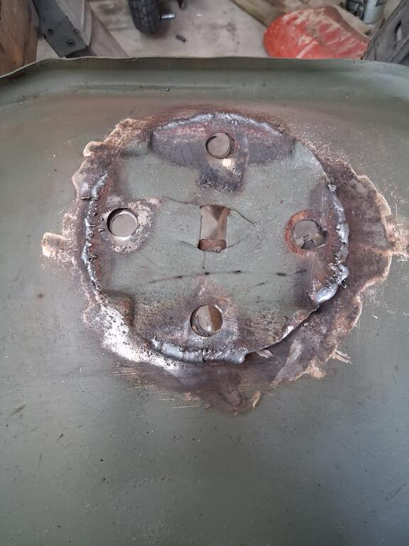

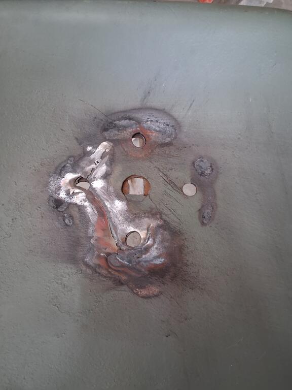

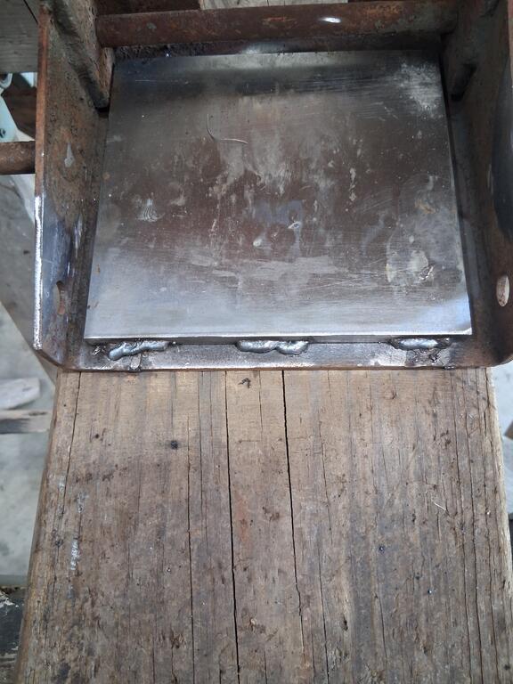

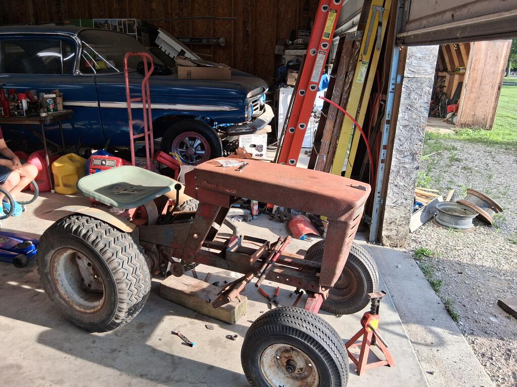

702854boy 1,069 #12 Posted July 9 Today's progress so far has been welding up a cracked seat pan, putting the tranny on, putting the front axle on, putting wheels on it, cutting the top of the tower off because it was too tall, putting the fenders together and putting them on, measuring where to cut the too long steering shaf, and setting the little bits and pieces on it for mock up. 6 4 Share this post Link to post Share on other sites

Sparky-(Admin) 26,176 #17 Posted July 9 9 hours ago, 702854boy said: That sucker has a very cool look to it with those rear fenders right on the tires! Is that the placement or are they just mocked up and sitting on the rear tires? 2 Share this post Link to post Share on other sites
702854boy 1,069 #18 Posted July 9 2 minutes ago, Sparky said: Is that the placement or are they just mocked up and sitting on the rear tires? That would be the placement but we were thinking about raising them up by like an 1/8 to a 1/4 inch, not too much that it looks stupid, just enough to have a little more tire clearance 1 1 Share this post Link to post Share on other sites
Pullstart 70,982 #19 Posted July 9 It’s looking great! Sorry about the frame, I never even inspected it when I got it, I just reached under and zipped the bolts in and out Good welding practice like you mentioned. The heat settings on the thick plate look potentially a little low. Dig that gun into the thick piece, and dip into the thinner material in your circles. Practice makes perfect, and you’re doing great! Share this post Link to post Share on other sites

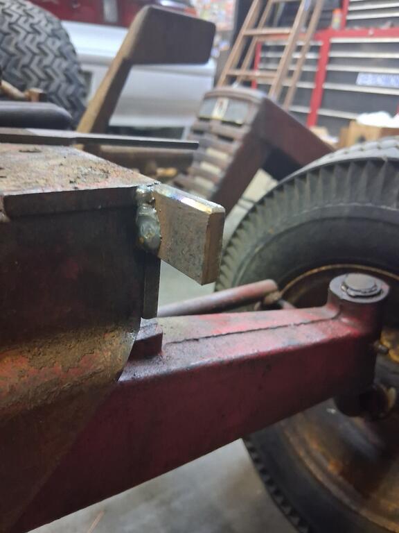

702854boy 1,069 #21 Posted July 24 The last couple of days I've done the little nitpicky jobs like welding some hood mounts on, wiring up the kill switch, installing the throttle and choke cable, putting oil in the engine, and running the fuel line. I'm close to being able to run and drive it I just need to get the carb straightened out because at the moment it only runs on a shot of brake clean and isn't getting fuel. I did pop the line if the carb to make sure I had fuel going to it but I think the main problem is that its all gummed up from old fuel because when I took the bowl off it smelled like varnish and it was very dark and cruddy. 5 2 Share this post Link to post Share on other sites

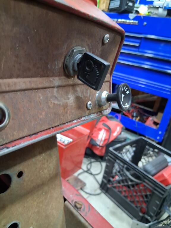

702854boy 1,069 #24 Posted July 25 I also put the key that I got from @JCM on it. 2 7 Share this post Link to post Share on other sites
