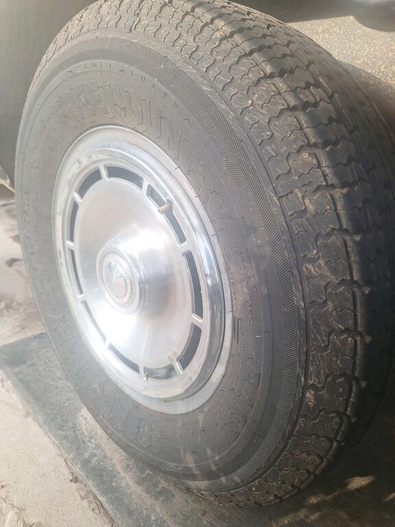

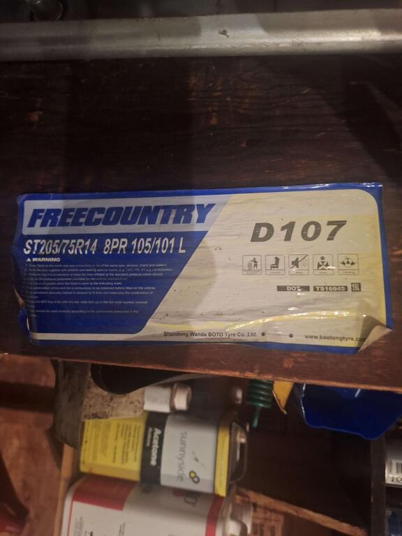

Beap52 2,496 #15 Posted July 1 I took a chance and purchased the tires (see sticker below) for our 24' camper online in 2019. They never see sunshine except when on the road and camping as I cut plywood to fit into the wheel well openings. . I run them at 65 lbs and seldom hit 65 mph going down the highway. Most trips-usually three or four a year-are 40~90 miles round trip and one or two 250 miles round trip. I usually stop about every hour of driving and feel them and the backside of the brake housing for differences in heat. At home, they are parked on a rubber mat and some of the weight taken off by use of the stabilizers. They seem to hold tire pressure well between trips. The second picture was taken for this post. The valve stem cap is off because my neighbor gave me a tire mender pressure monitor that I remove when I get home. My wife's Michelins that are newer than these have more tiny cracks than these foreign jobs. I also watch the date code on the sidewalls of tires. 2 1 Share this post Link to post Share on other sites
