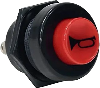

19richie66 17,935 #8 Posted June 27 (edited) I just installed a push button kill switch below the choke knob on my 417. Think it was a dash mounted horn switch off of something. Just like this but without the horn logo. Edited June 27 by 19richie66 Share this post Link to post Share on other sites
adsm08 5,139 #9 Posted June 27 59 minutes ago, 19richie66 said: I just installed a push button kill switch below the choke knob on my 417. Think it was a dash mounted horn switch off of something. Just like this but without the horn logo. Last time I had to re-wire a magneto system I used a toggle switch for the kill. That way there was very little change of releasing it too soon and allowing the engine to restart while it was still spinning down. Share this post Link to post Share on other sites
19richie66 17,935 #10 Posted June 27 49 minutes ago, adsm08 said: Last time I had to re-wire a magneto system I used a toggle switch for the kill. That way there was very little change of releasing it too soon and allowing the engine to restart while it was still spinning down. Yeah but this way I won’t forget to turn it back on Share this post Link to post Share on other sites
