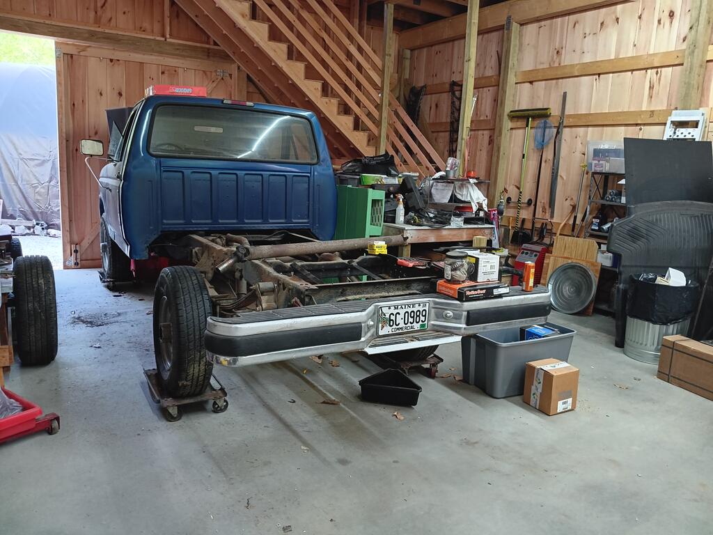

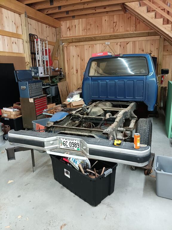

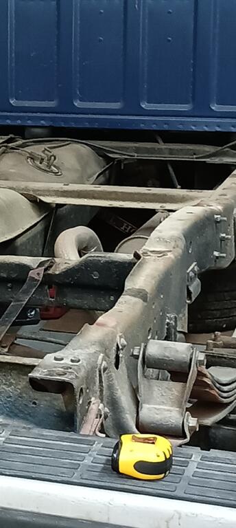

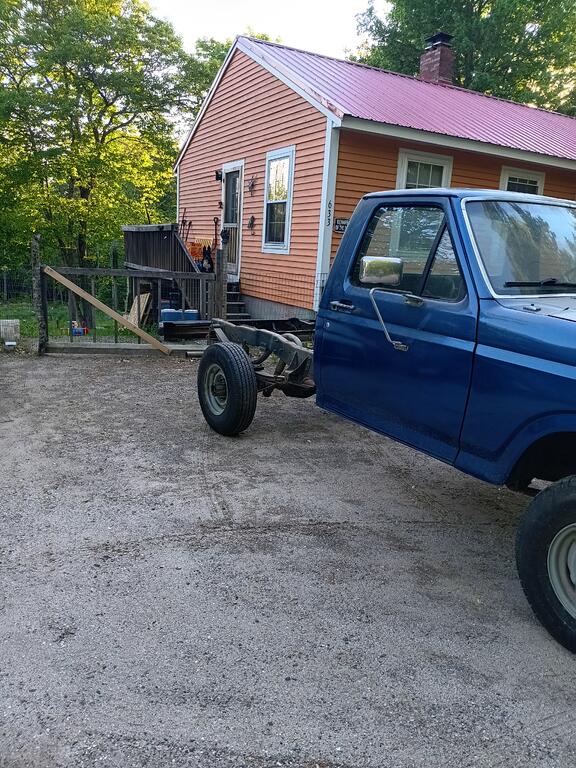

ri702bill 13,391 #3 Posted June 7 Rear bumper with integrated hitch receiver?? What about fuel fill access? Fixed illuminated rear licence plate? Pictures of the truck as is would be helpful. 1 Share this post Link to post Share on other sites

ebinmaine 81,281 #6 Posted June 7 19 minutes ago, ri702bill said: Rear bumper with integrated hitch receiver?? Not sure what I'm doing there yet. Depends on laws. 19 minutes ago, ri702bill said: What about fuel fill access? Easy. Side fill. 19 minutes ago, ri702bill said: Fixed illuminated rear licence plate? Also easy. I have a pair of Peterbilt cab & chassis rear lamps. 19 minutes ago, ri702bill said: Pictures of the truck as is would be helpful. Share this post Link to post Share on other sites

ri702bill 13,391 #9 Posted June 8 And Collosus takes a trip to the back burner - again! Truck frame looks excellent for its age.... 3 Share this post Link to post Share on other sites

ebinmaine 81,281 #11 Posted June 8 13 minutes ago, ri702bill said: And Collosus takes a trip to the back burner - again! Colossus is doing just fine. Being patient. 13 minutes ago, ri702bill said: Truck frame looks excellent for its age.... This was restored between the early 2000s and 2015. 1 Share this post Link to post Share on other sites

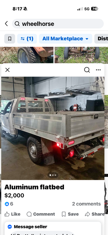

Sparky-(Admin) 26,898 #19 Posted June 8 Personally I would opt for a manufactured aluminum or steel flatbed. Just bolt it on and go after it gets back from having the rear axle done. This way you can start using it, as opposed to having it still outa commission for weeks/months/years etc. This is just an example, plenty of less expensive steel ones for sale. 8 Share this post Link to post Share on other sites

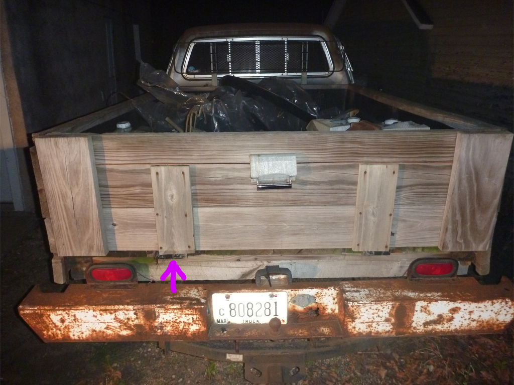

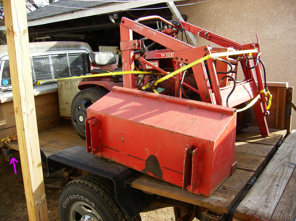

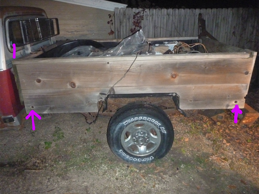

dodge78 149 #23 Posted June 8 Here is a bed I built some years ago. The sides would come off by loosening 2 bolts. In had a pin at the top with 2 clamps at the bottom and was as solid as a stock box. Solid enough I used the stock hardware to make a functioning tailgate. I cut the end of a box off that had the catches and straps to hold the tailgate. I used strap hinges so I could remove the tailgate and put a solid rod into to lock in the ramps. I put metal over the tires to keep the height lower and were removable so I could put in a flat piece if needed. But I do not think I ever needed to. This was built the size of a bed liner so it was smaller. 3 1 Share this post Link to post Share on other sites

ebinmaine 81,281 #25 Posted June 8 7 hours ago, Sparky said: Personally I would opt for a manufactured aluminum or steel flatbed. Not into steel but aluminum looks ok. Pricewise though .. it's just not happening. Note the size I want. That's not a standard. Specially built beds are several thousand dollars. 7 hours ago, Sparky said: Just bolt it on and go after it gets back from having the rear axle done. There's no simple installation here. In order to install a 7 x 9 bed I need a pair of rear frame extensions. Those will be custom pieces. 7 hours ago, Sparky said: This way you can start using it, as opposed to having it still outa commission for weeks/months/years etc. Not having a bed doesn't matter for towing or test driving. I can drive it legally as soon as I get proper rear lamps and splash guards installed. Share this post Link to post Share on other sites
