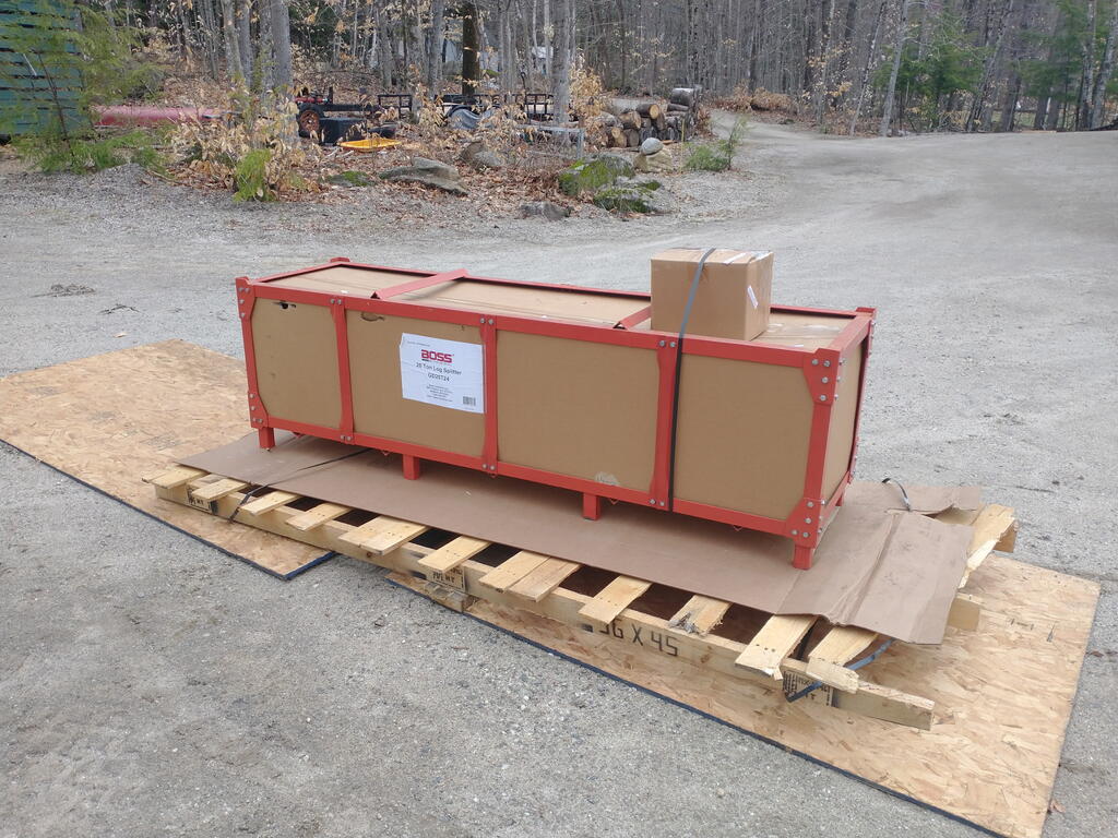

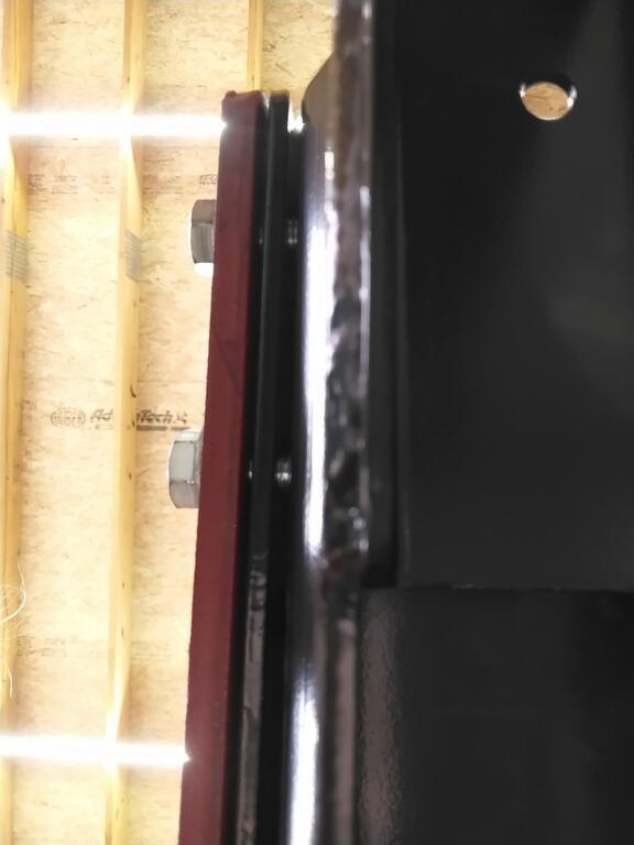

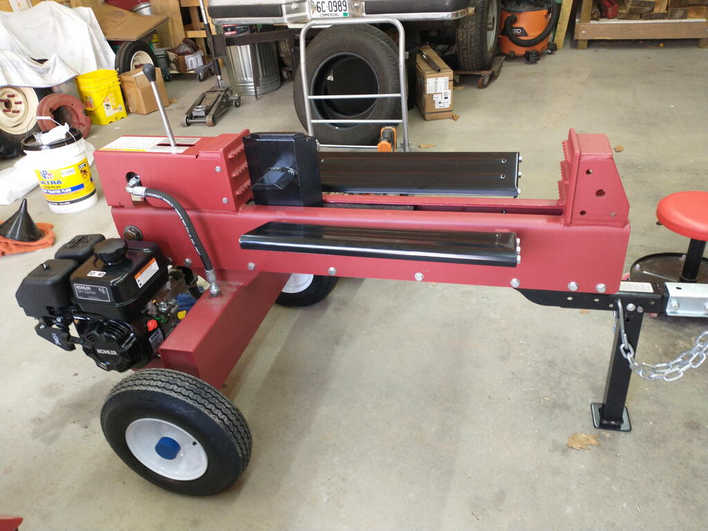

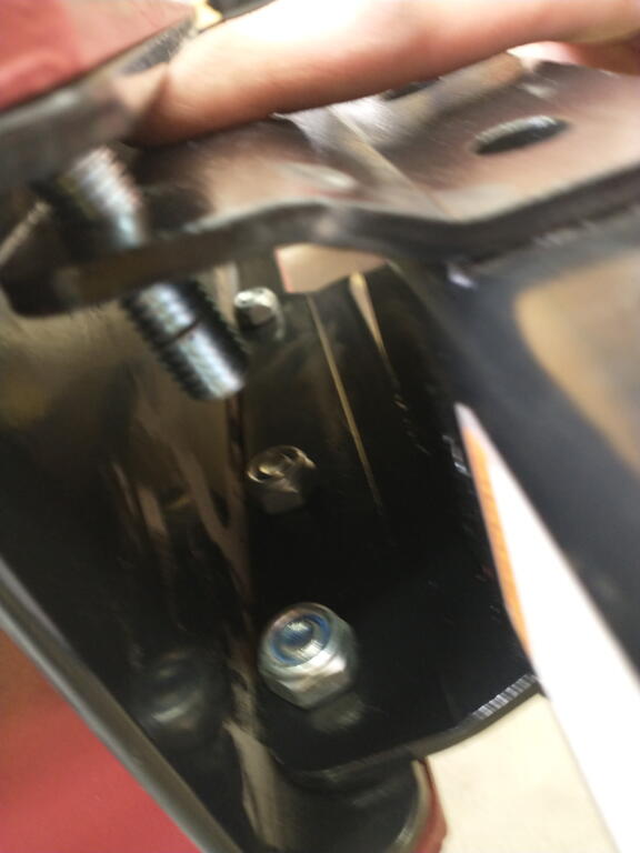

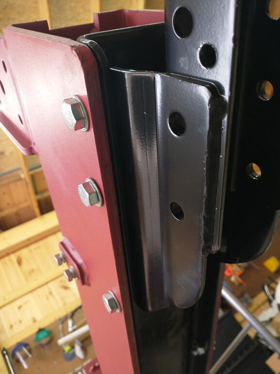

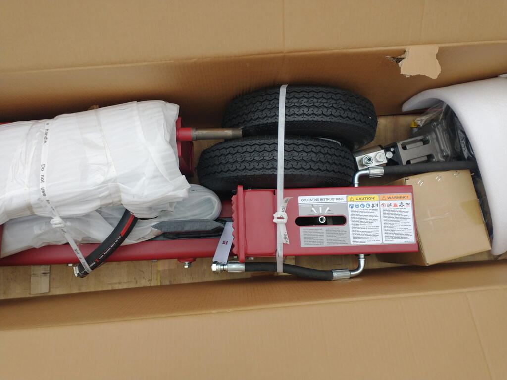

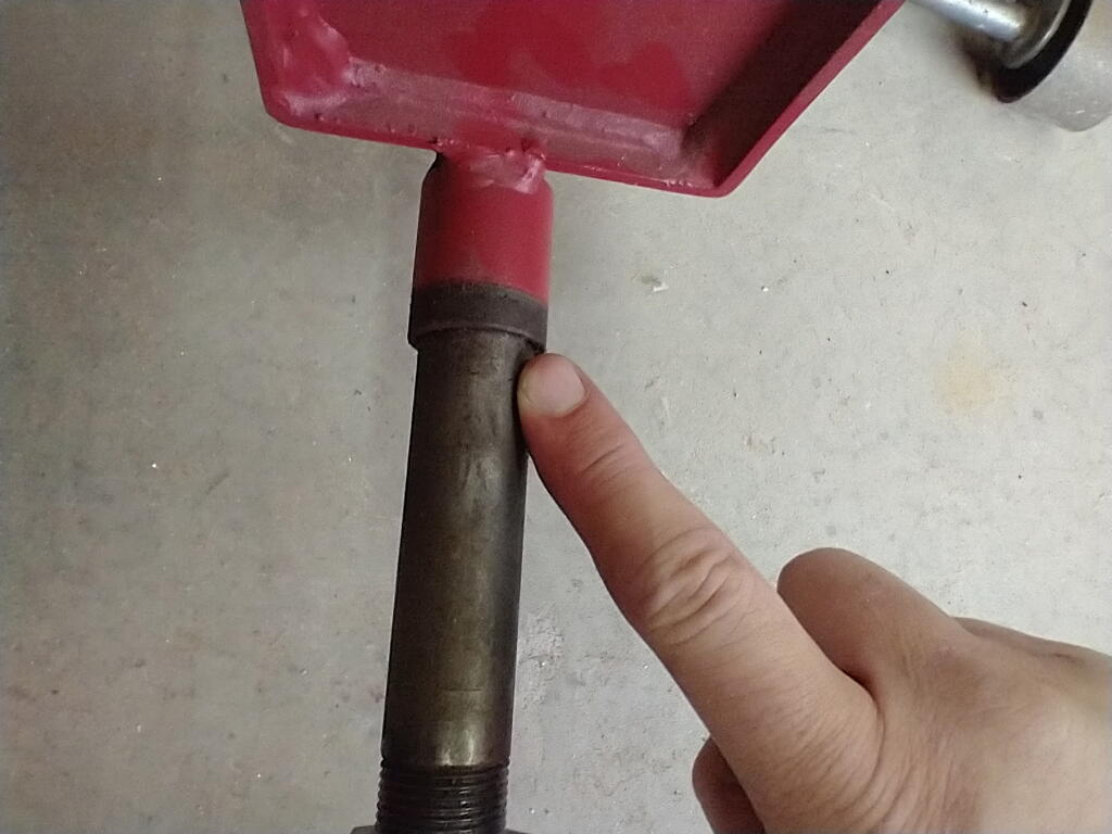

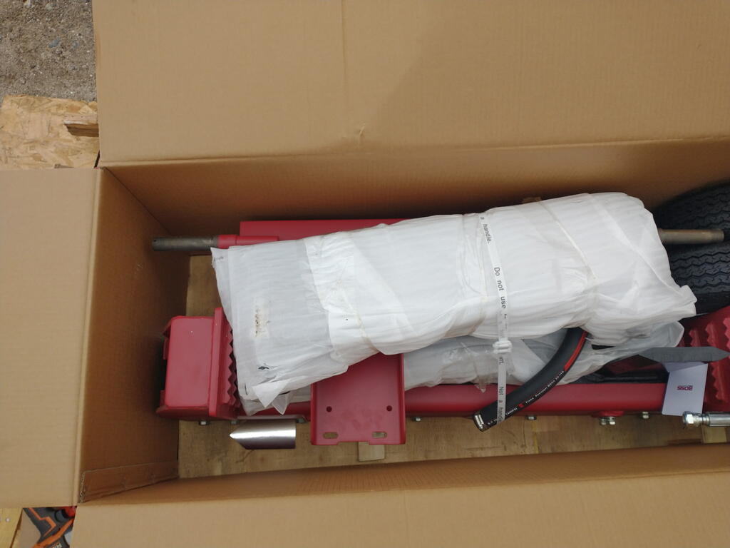

ebinmaine 79,710 #1 Posted April 19 Looonng first post.... LOTS to write.... For several years we've been considering an upgrade to our old wood splitter. It's a very well (re)built decades old unit that was home shop rebuilt in 2012 by a local logger. After 14 seasons of splitting it's understandably getting tired. We started a thread here, got some great info. We researched on other sites and spoke to our favorite small engine repair place. We decided that it would need the entire hydraulic system replaced and a new larger engine to meet the goals. Not at all opposed to this but it would easily cost $2,000 +. While doing research online we found a couple dual action splitters. Very intriguing. We started a thread on that here: ..... And again learned some great information along with creating some additional thought processes. We decided to get the Boss model over the HF model because of several factors. 1. Kohler engine on the Boss. 2. Too many pivot/ wear points on the HF. 3. Hydraulic control lever is centered on the Boss vs one sided operation in the HF. This is a very convenient feature for Trina in particular because she's prone to jumping around wherever the workload can be accomplished the best. 4. Overall frame strength and build quality appears better on the Boss than the HF according to multiple online sources. 5. The Boss is certified for road towing. The HF is not. (We'll visit that below) The new Boss splitter arrived this week. Overall it looks good. I agree with #4 above. The welds are solid. The frame is good thick steel. The cylinder is encapsulated in a square slider tube which is encapsulated in the frame. Purely a flat surface sliding design with no bearings. @Ed Kennell Grease will be applied. Often. @peter lena North American design but made in china. Build quality is reasonable except for a few things. The trailer tongue mount is too narrow for the main frame. We had to use washers to set the tongue to one side and add longer bolts to the other side. I WOULD NOT tow this unit on the road the way it's sent. IMHO it was not safe. That - quite frankly - pi$$ed me off. This side is flush. This side is not. See the space difference... Now imagine trying to "tighten" that enough to close the space using low quality hardware... or even great quality hardware. Not happening buster. The entire hardware package is the unfortunate cheap trash we see all too often on cheap items. Nut & bolt head sizes are inconsistent (WTH??) and lacking quality. I upgraded several bolts, added washers, and replaced the disgustingly lightweight axle castle nuts with better quality pieces. We were unable to drive the steel press fit axle dust caps in so we popped the plastic ones back on. This is fine unless/until we ever need to road tow it. The axle inner seal surface isn't even properly machined. If this was going to be towed often or long distance it would eat seals. Fast. After using it for only a few minutes it's developed an issue already. Like many splitters, It has a two stage hydraulic system. When the pressure reaches a certain level the system changes from high speed low pressure to low speed high pressure. This one WAS working like that. Now it starts high speed. Goes low speed and stays there. Shut it off and move the lever to release system pressure. Restart and repeat. I'm hoping it's an adjustment, not a defective part. We've run some decent sized beech wood through it. That went well. Power level seems good. We're thinking it should be faster though. That may be related to the above issue or possibly because it's new and needs to break in. Or.... it's just slower than we hoped. Again, overall I believe it'll be a good addition once the bugs are worked out. The work habits obviously are very different from a single action to this dual action. The fact that one can use both directions is very nice. Very weird at first too. Once a different and properly adjusted set of habits is developed we can see a new kind of usefulness. We did get the additional cross piece to split horizontally. It has its place but also has its challenges. The second split is nice IF the pieces of wood separate correctly. Because we use a lot of beech wood, that isn't practical much of the time. I'll document repairs and changes in this thread. Some changes we figured on making even before purchase, no matter what splitter we got. 1. Wheel size, tongue height & length increase. The OE tires are 4.00/4.80 x 8. Seems most splitters are standard at that. I'd likely add a set of 5 lug hubs and increase to a full size tire like we did on the other splitter. Tongue height and length will be adjusted to level and to compensate for the additional table length..(Next comment) 2. Larger flat work table. As you can see in the last picture above there are small catch shelves on the sides. The principal is good. The upward angle is actually a bit of a challenge to work with. The wood pieces want to fall back into the work area. Remember gravity? We're thinking about adding a much larger, flat work table to catch the pieces on both sides. Start the split. Set one half aside. Work with the other. Have plenty of space to move the shrinking pieces around and off the table. 8 3 1 1 Share this post Link to post Share on other sites
peter lena 9,944 #2 Posted April 19 @ebinmaine think I would just go over / after any part / area of it , that seams to struggle , not as smooth as you expect , obviousely the slide track area , a synthetic h/d fifth wheel grease , would probably enhance track slide , sure you already have plans , with your insight , pete 1 Share this post Link to post Share on other sites
ebinmaine 79,710 #3 Posted April 19 2 minutes ago, peter lena said: sure you already have plans Yessir. We have some red spray grease already coating the whole inside area. Watching for new wear patterns as the new red paint wears off. Those areas will be well coated in the future. 2 Share this post Link to post Share on other sites
