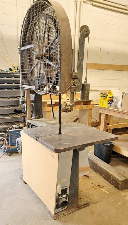

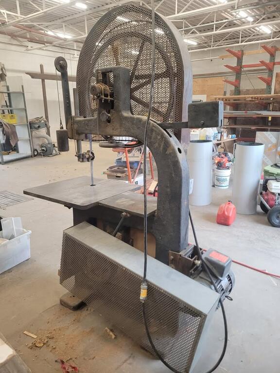

bc_gold 214 #1 Posted April 8 (edited) Early model Crescent, modernized from overhead line shaft operation to electric with safety features. Built late eighteen hundreds, runs on Babbitt can accommodate blades up to two inches wide, currently fitted with 1.250" Crescent Machine Company was founded in Leetonia, Ohio in 1893. It manufactured a line of industrial woodworking machinery, particularly band saws. In 1940, it was bought by Pittsburgh Equitable Meter and Manufacturing Company, which became the Rockwell Manufacturing Company in 1946. Leaving in the morning to bring her home. Edited April 9 by bc_gold 11 4 1 Share this post Link to post Share on other sites
Ed Kennell 47,320 #2 Posted April 9 (edited) Is that hanging weight just to balance the weight of the upper guide and is the cantilevered weight a balance or is it used to apply a constant tension to the band? Edited April 9 by Ed Kennell 2 1 Share this post Link to post Share on other sites
bc_gold 214 #3 Posted April 9 (edited) 18 minutes ago, Ed Kennell said: Is that weight just to balance the weight of the upper guide? Near as I can figure the weight assists in repositioning the height of the blade guide making the change a single handed operation. Once the guide is unlocked it will remain in it current location until its been physically relocated into a new position. I'm thinking this saw was used in a furniture or casket shop, working with expensive wood you would not want the blade guide slamming down onto the surface of the wood being cut. Sash window weights are essential, hidden counterbalances—typically made of lead, iron, or steel—that allow double-hung windows to operate smoothly and stay open at any height. They are connected to the sash via cords or chains running over pulleys. Proper balancing requires matching the weight to the sash Edited April 9 by bc_gold 3 Share this post Link to post Share on other sites
Handy Don 17,474 #4 Posted April 9 49 minutes ago, bc_gold said: the weight assists in repositioning the height of the blade guide Makes sense to me to make that operation easy and controlled to encourage frequent use since, of course, having the upper guide close to the workpiece makes for more precise cuts. The throat depth of that saw tells me it was used on very large items, too, where a messed up cut could be quite costly. It also looks like it has a small drive wheel and and idler to keep the table height low. Good luck with it! 2 Share this post Link to post Share on other sites

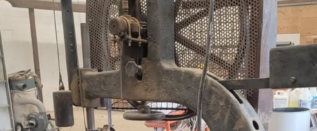

gwest_ca-(File Mod) 12,488 #6 Posted April 9 2 hours ago, Ed Kennell said: Is that hanging weight just to balance the weight of the upper guide and is the cantilevered weight a balance or is it used to apply a constant tension to the band? I also have a 30" saw that is old. Goldie & McCulloch went out of business in 1911. Do not have a weight on the upper guides but have the cantilevered weight at the rear. I think it is there to lift the upper wheel so when changing a blade it would apply minimal tension to the blade to keep it on the wheel. The horizontal wheel below the upper wheel is what tensions the band. 3 1 Share this post Link to post Share on other sites
Ed Kennell 47,320 #7 Posted April 9 5 minutes ago, gwest_ca said: The horizontal wheel Yep, I missed that tensioner. 2 Share this post Link to post Share on other sites
bc_gold 214 #8 Posted April 10 (edited) 23 hours ago, Ed Kennell said: Yep, I missed that tensioner. The small horizontal wheel used to adjust blade tracking. Edited April 10 by bc_gold 1 Share this post Link to post Share on other sites
bc_gold 214 #9 Posted April 10 On 4/9/2026 at 8:53 AM, Ed Kennell said: Is that hanging weight just to balance the weight of the upper guide and is the cantilevered weight a balance or is it used to apply a constant tension to the band? The with a blade removed the upper band wheel has freedom to move up or down that cantilevered weight performs an amazing balancing act, very similar to the sash weight used on the blade guide. The upper band wheel image below once the blade has been removed, what ever position the wheel has remains fixed, whereas the saw I've purchased is allowed to float. I knew nothing of these oddity's. to me it was just a large band saw, due to it's size and footprint struggled with making the decision to purchase. 2 Share this post Link to post Share on other sites

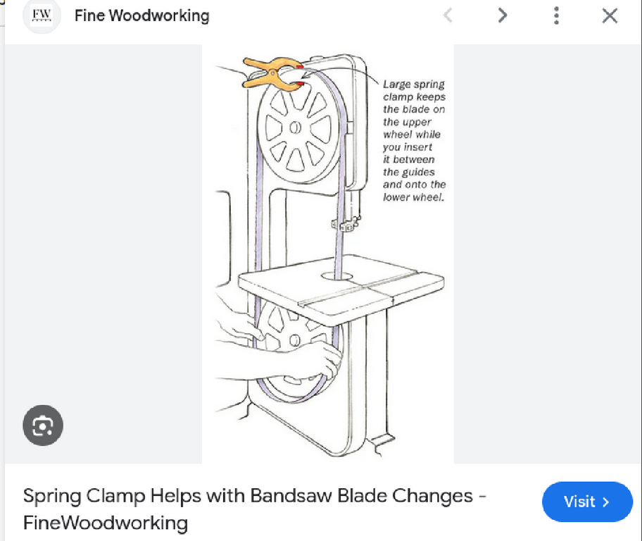

Handy Don 17,474 #10 Posted April 10 I was shown the spring clamp trick years ago and it has helped keep me sane during blade changes! 😉 Hoping the new-to-you tool will serve you well and give you lots of satisfaction. 1 1 Share this post Link to post Share on other sites
bc_gold 214 #11 Posted April 10 (edited) 24 minutes ago, Handy Don said: I was shown the spring clamp trick years ago and it has helped keep me sane during blade changes! 😉 Hoping the new-to-you tool will serve you well and give you lots of satisfaction. Finally got over my gold fever and my desire to travel. Planning to use recycled wood on all my projects which well display in natural colors, water glass finish has many benefits, none toxic cures from carbon dioxide in atmospheric air or via gas injection. Best part I'm able to make my own from ball milled glass. if you were cutting an expensive exotic wood, Using water glass (sodium silicate) to bind sawdust creates a rigid, eco-friendly, and cost-effective material suitable for woodturning, similar to dense particle board or firebrick. It works best when combined with high pressure, as sodium silicate binds by filling voids and setting as it dries, rather than curing chemically like epoxy. Water glass (sodium silicate) wood finish is a durable, penetrating sealer that acts as a fire-resistant, water-repellent coating . It works by curing deep within the wood grain, creating a natural bond without a plastic surface film. Often used on softwoods, it can be applied in 2-3 coats, with fully cured surfaces being highly resistant to moisture, such as on wooden bowls. Edited April 10 by bc_gold 2 Share this post Link to post Share on other sites

bc_gold 214 #13 Posted April 20 (edited) No manufacture or casting numbers for identification, definitely not a Crescent Band saw, I have identified the purpose of the cantilevered weight. In addition the saw is fitted with the Wright blade guides. A dynamic damper on a wood band saw—often referred to in the context of high-performance or industrial saws (like the Behringer HBE Dynamic series) or in specialized DIY modifications—is a mechanism designed to reduce blade vibration and stabilize the saw blade directly at the point of cutting. While standard wood band saws use simple guides, a system with a dynamic damper offers superior stability, particularly for high-speed cutting or when using thinner blades for heavy resawing tasks, resulting in higher precision and reduced blade breakage Perhaps the weight hanging by the cable also has something to do with absorbing vibrations. Edited April 20 by bc_gold 3 1 Share this post Link to post Share on other sites

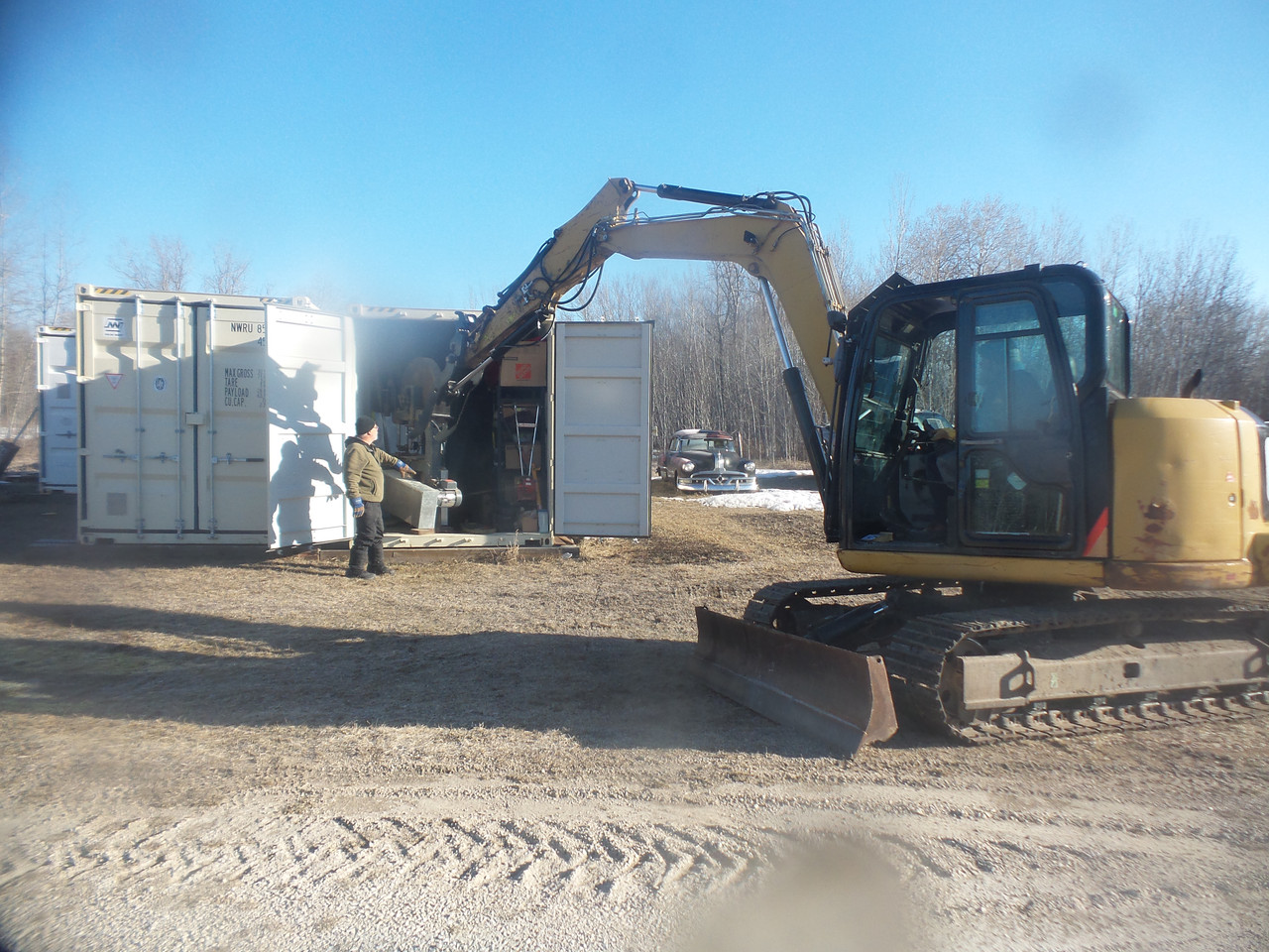

bc_gold 214 #14 Posted April 20 (edited) Five hour drive to the band saw location for an 8:00 am load, my poor Ranger. Edited April 20 by bc_gold 4 1 Share this post Link to post Share on other sites
Handy Don 17,474 #15 Posted April 20 8 minutes ago, bc_gold said: BC you are now in @Pullstart’s realm! 🫡 I’m guessing that is at least 150 kilos over the Ranger’s recommended max load. 1 4 Share this post Link to post Share on other sites
wallfish 20,612 #16 Posted April 20 Was the excavator guy laughing when you pulled up in the Ranger? 1 Share this post Link to post Share on other sites
bc_gold 214 #17 Posted April 20 4 minutes ago, wallfish said: Was the excavator guy laughing when you pulled up in the Ranger? No, but he did offer to waive the charge for loading. 2 Share this post Link to post Share on other sites
bc_gold 214 #18 Posted April 22 On 4/20/2026 at 11:51 AM, Handy Don said: BC you are now in @Pullstart’s realm! 🫡 I’m guessing that is at least 150 kilos over the Ranger’s recommended max load. Loaded truck on a farm platform scale, my Ranger's curb weight 3030 lbs, add 500 pounds for lost 10 mm sockets - 6382 lbs gross, minus 3500 for truck , band saw weighs 2892 pounds 2 Share this post Link to post Share on other sites
Handy Don 17,474 #19 Posted April 22 So for a one-ton truck rating (?) you were only 892 pounds (almost 400 kilos) over. Yikes. Good thing the local constabulary didn’t notice. Inquiring minds want to know how you got it OFF the truck and where it’s gonna live now. Share this post Link to post Share on other sites
bc_gold 214 #20 Posted April 22 (edited) 1 hour ago, Handy Don said: So for a one-ton truck rating (?) you were only 892 pounds (almost 400 kilos) over. Yikes. Good thing the local constabulary didn’t notice. Inquiring minds want to know how you got it OFF the truck and where it’s gonna live now. Leg has a charlie horse in calf for the past three days, getting some preparation done in increments. Man door and frame along with the header have to be removed for height, half inch plywood x two for one inch placed on ground, one inch pipe used for rollers 2 x 12" planks placed on rollers with a few feet onto the concrete floor with more pipe rollers. Forklift from local Coop for lift and placement onto the planks. Hoping the fork lift has enough traction to roll the loaded planks into the shop. Once inside I had thought of spreading sand on the floor to make skidding easier. The base of the band saw does not run parallel but has enough room under the lower casting to insert a 2x4 which would allow me to lift and move a few inches each lift. I'm sure Pullstart could get that heavy load off the truck without the aid of a forklift, Edited April 22 by bc_gold 1 1 Share this post Link to post Share on other sites
