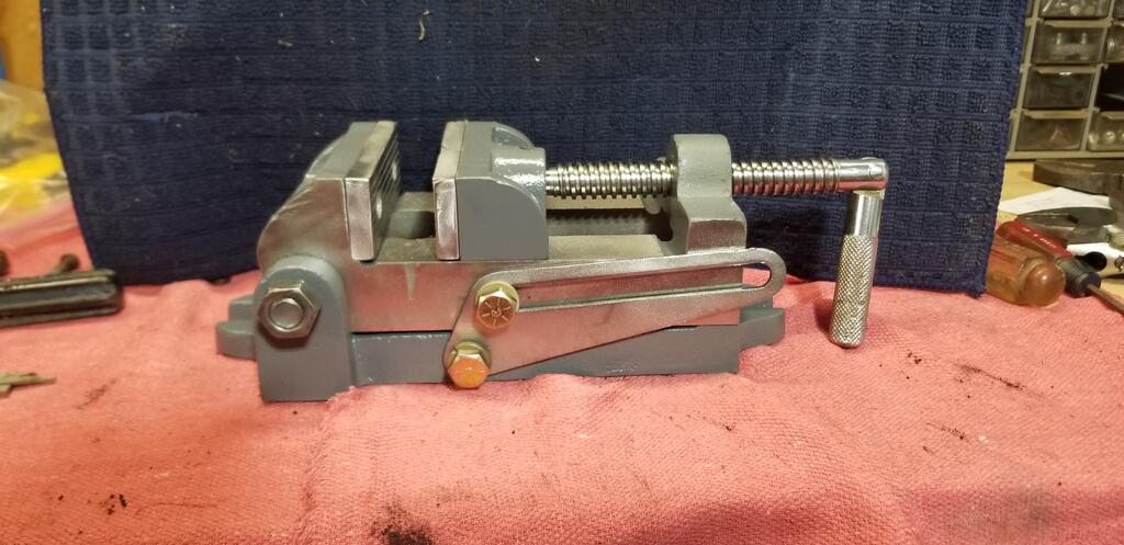

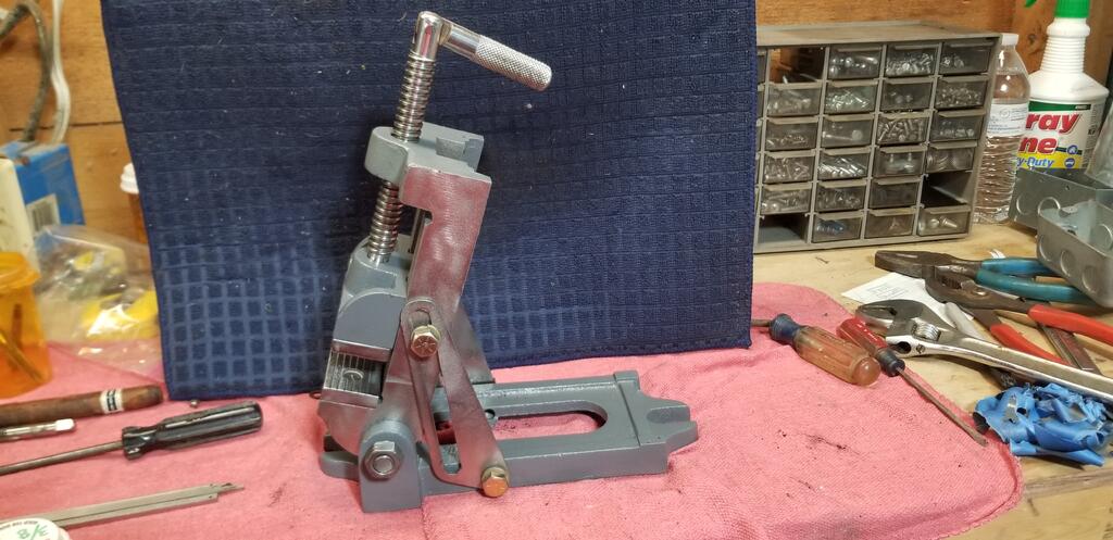

WHX?? 58,388 #2 Posted January 7 Here ya go EB ... I ain't gonna tell ya some bozo threw this one on the scrap pile at my old shop... 14 Share this post Link to post Share on other sites
ri702bill 13,392 #3 Posted January 8 Eric I almost bought one of those recently..... until.... I took a good look at the locking mechanism. Note the handle lock on one side and the pre-determined pin-goes-into-the -closest-hole gizmo on the other side. Do I really trust that 30 degrees is actually and honestly 30 degrees when you are holding a casting with raw edges id trying to follow an existing hole??? Nope!! What if you are in between pin hole positions?? I have zero confidence in using just the handle lock on one side for drilling in an off-center fashion... I bought something different to do just that task, let me download some pictures first.... 1 Share this post Link to post Share on other sites

lynnmor 9,081 #5 Posted January 8 Palmgren and Wilton always made products that were at least usable, I don't know if they degraded in recent years. Another option is to buy a cross slide table where you can bolt on the vise of your choice and mount it at any angle. Most everything that is budget priced likely will be imported from you know where and quality will vary widely. Good quality machine shop equipment will be priced at way more than a hobbyist is willing to pay. Update: That Palmgren shown above makes no sense if the pin is the only lock for the tilt, I guess they are now off the list. 2 Share this post Link to post Share on other sites

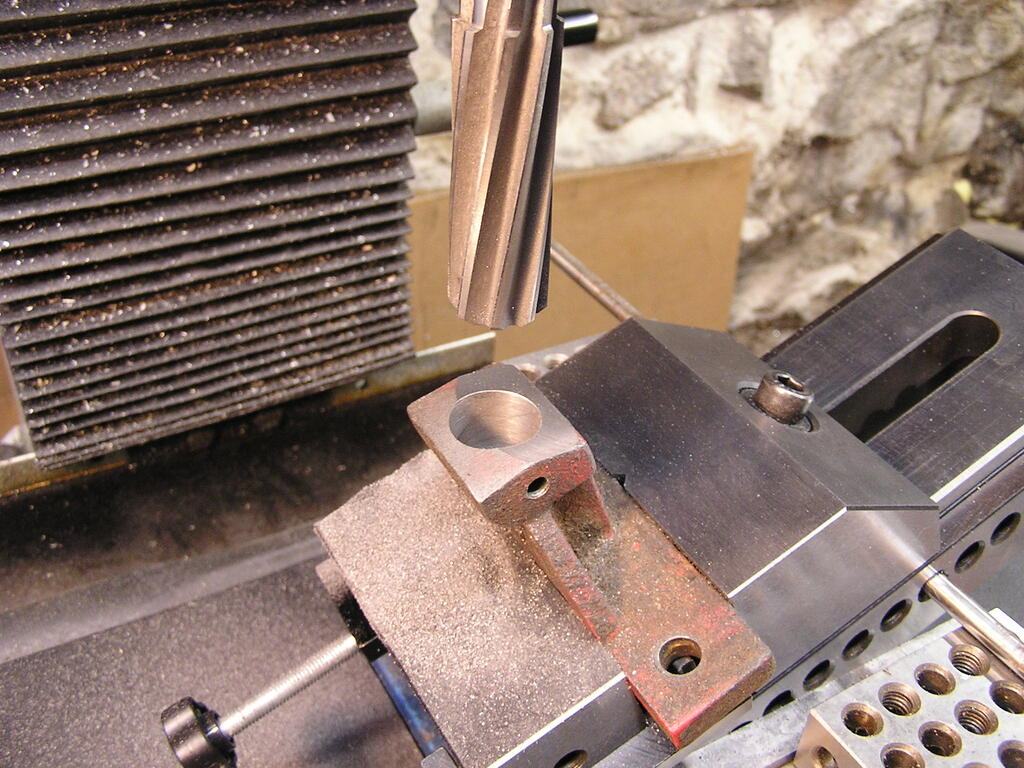

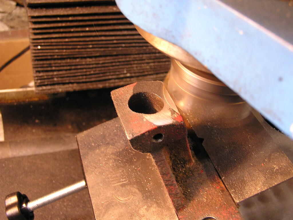

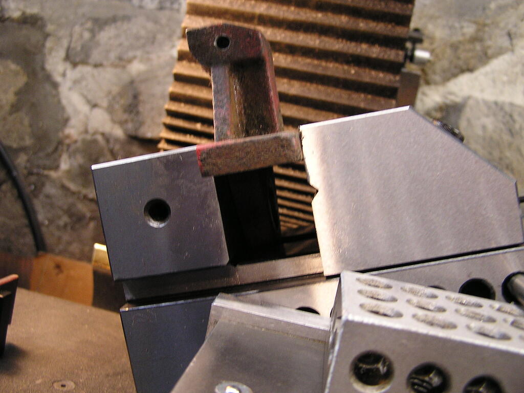

ri702bill 13,392 #6 Posted January 8 OK. I bought a 4" Screwless Toolmaker's Vise - finish ground on all surfaces. I mount this vise at an angle in the 5" Milling Machine vise. There ate thru-holes down the entire side - used a 3/8 rod to help set the angle, along with a 3/4" diameter steel dowel in the quill to line up the hole. Narrow C clamps hold the lower part of the casting firmly up against the non-movable back jaw. Vise comes with vertical and horizontal V grooves for round stock work too. Fly cut the top to clean, bored & reamed for the bushing. Drilled thru the bushing wall at the grease fitting. Last step, not shown, I drill & tap the lower bushing hole for a grease fitting too. 3 Share this post Link to post Share on other sites
ri702bill 13,392 #7 Posted January 8 (edited) 6 minutes ago, lynnmor said: Update: That Palmgren shown above makes no sense if the pin is the only lock for the tilt, I guess they are now off the list. Remember that the upper casting hole is not a full diameter all the way down - an interrupted cut tends to make the drill grab. Edited January 8 by ri702bill 1 Share this post Link to post Share on other sites

WHX?? 58,388 #10 Posted January 8 1 minute ago, lynnmor said: pin is the only lock for the tilt, It's not ... the pin only locks it flat. The handle on the backside locks it at angle. Works fine We workin on the lunar rover or a garden tractor Bill? 4 1 2 Share this post Link to post Share on other sites

WHX?? 58,388 #15 Posted January 10 (edited) You won't be sorry then EB ... It's got a v groove cut in the front jaw for holding round stock. Could be a little deeper but works ok. Edit: Just visited their site EB and oh la la ... If I was a machinist in a past life, working on the lunar rover and had Bill's deep pockets ...Check out their bench vices ... Edited January 10 by WHX?? 1 Share this post Link to post Share on other sites
ebinmaine 81,281 #16 Posted January 10 4 minutes ago, WHX?? said: You won't be sorry then EB ... It's got a v groove cut in the front jaw for holding round stock. Could be a little deeper but works ok. I've ordered two new vises. The other one is a Palmgren 6" Cross slide. It has the grooves as well. I'm leaning towards leaving the cross slide on the drill press most of the time and swapping to the angle type specifically for the steering blocks. But.... because my skill level and tool set is often changing - plans do to. Either way I believe both vises should offer a good quality long term set up for us. 2 Share this post Link to post Share on other sites

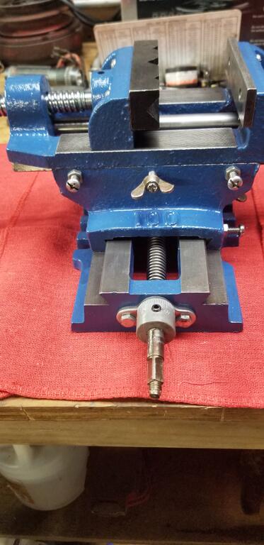

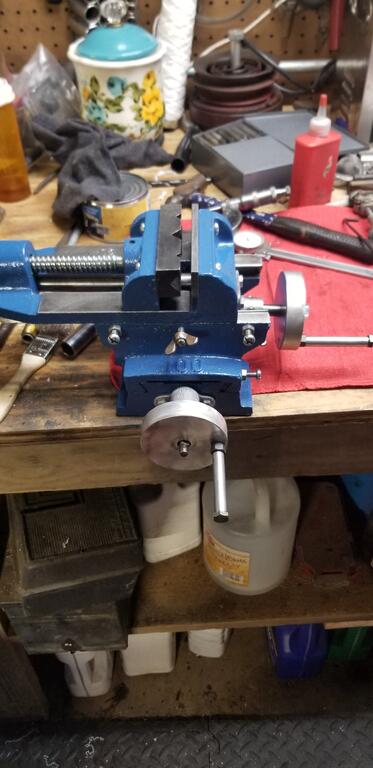

gt14rider 1,291 #23 Posted January 15 Picked these vices up at a flee market, thay are cheap but they work. First one was $15 and second one $10, they were pretty dirty and banged up. I made the crank handles 2 1 Share this post Link to post Share on other sites
ebinmaine 81,281 #24 Posted January 15 7 hours ago, gt14rider said: these vices The black jaw face on the blue vise. Something you made or come with it? Share this post Link to post Share on other sites
gt14rider 1,291 #25 Posted January 15 Came with. I cleaned it up and painted it, had to make the handles. 1 Share this post Link to post Share on other sites
