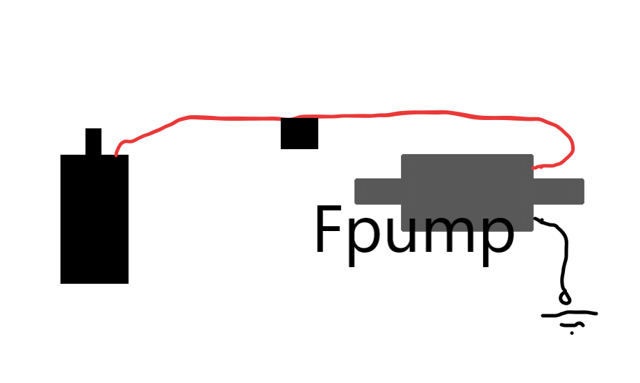

ri702bill 13,052 #5 Posted January 7 22 minutes ago, Bill D said: Recommended tapping on to the positive side of the coil feed. But... do add in inline fuse between the coil feed and the pump. 6 Share this post Link to post Share on other sites

pfrederi 21,150 #8 Posted January 12 (edited) The Facet pumps have an internal circuit breaker None of the pumps draw more than 4-5 amps most less. Fuse size should be based on wire gauge. If you use 16ga i would use 10 amp fuse make your connection to the "+" terminal on the coil Edited January 12 by pfrederi 8 1 1 Share this post Link to post Share on other sites

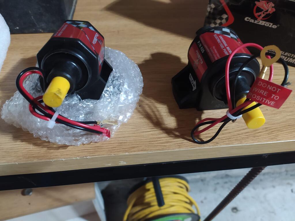

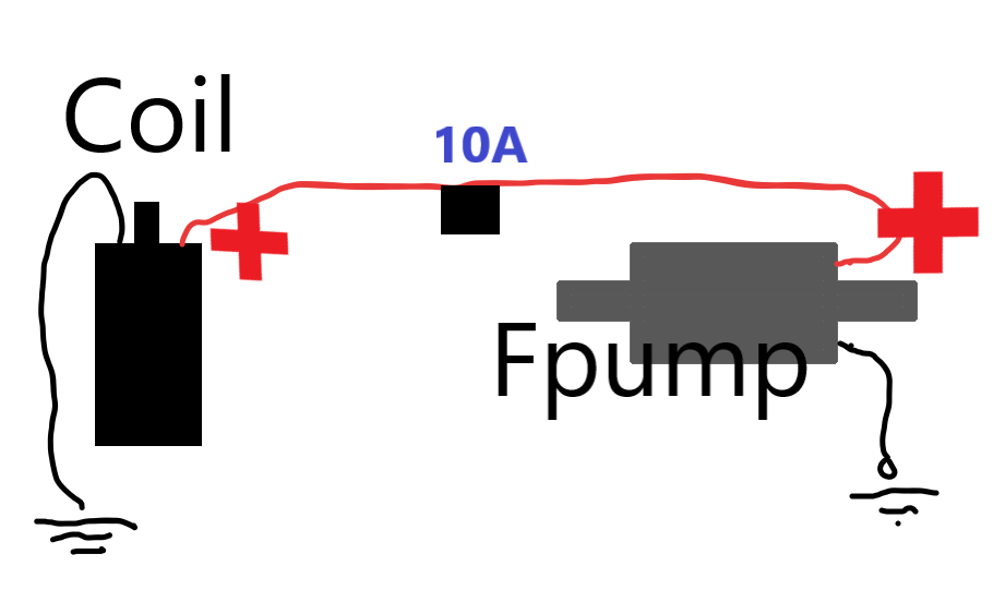

Stan50 231 #10 Posted May 10 1. Ok guys, so correct diagram would be like this? 2. I noticed that many of you placed electric fuel pumps near carburator in the front,but others recommend placing pump just under the fuel tank,where electric pump has short suction line. 3. I've got w carBole fuel pumps, one (on the right) off of Ama...com, and other ("squarish" one) from Chinese website ( official CarBole store). Both almost identical, except main body shape. Very interesting 2 Share this post Link to post Share on other sites
pfrederi 21,150 #11 Posted May 10 Wiring is correct. For under seat gas tanks I always mount the pump low and near the tank.. If yo are putting the pump on a WH with gas tank under the hood mount where ever you can. Gravity will fill the pump most the time. 3 1 Share this post Link to post Share on other sites
Stan50 231 #12 Posted May 11 @pfrederi separate ground wire will be necessary from coil? I mean that there is already ground wire ,goes from coil tru condenser? Sorry but my electrical knowledge isn't so great 1 Share this post Link to post Share on other sites
953 nut 69,295 #13 Posted May 11 1 hour ago, Stan50 said: @pfrederi separate ground wire will be necessary from coil? I mean that there is already ground wire ,goes from coil tru condenser? Sorry but my electrical knowledge isn't so great You are over thinking this situation. The condenser is on the negative side of the coil and has nothing to do with power to the fuel pump. You are just using the positive side wire at the coil as a convenient source of power that will be turned on and off with the keyswitch. 4 Share this post Link to post Share on other sites
sqrlgtr 3,929 #14 Posted May 11 (edited) On 1/7/2026 at 10:29 AM, rmaynard said: This will be my first venture into the world of electric fuel pumps. I just received my Facet pump and want to wire it into my 1996 416-H (Onan). For those of you who have done this on similar engines, where are you tapping into for 12 volts? @rmaynard just installed Facet fuel pump on my 520H and I tapped into the hot side of coil (redwire on pump) and just grounded (black wire on pump) under pump mounting bolt and it worked great. Key on pump runs key off pumps is off. also put a 10amp fuse in red wire going to pump from coil... Edited May 11 by sqrlgtr 3 Share this post Link to post Share on other sites
