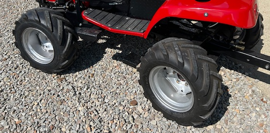

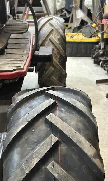

AlexR 3,113 #3 Posted December 11, 2025 It's all about price Cheapest option Deestone D405 they run smallest on width 10.5 size is more like 8.5 in actual width however other then that they really are a good tire. I have had one on my tractor 5 years and used a brinly plowed with them did great BKT TR315 here is a comparison with the Deestone which are on the tractor however the BKT's aren't on rims so so that will cut the width down a bit but i would say it's about 1/2" wider then the deestones both of these are 10.5 width size Otr lawn trac and Carlisle tru powers I believe both of those run close to true size from what I have heard. But to be honest if you want to do plowing you might actually do better with the narrower tire or you can get the Lawn Trac and Carlisle in the 8.5 width as well. 3 2 Share this post Link to post Share on other sites

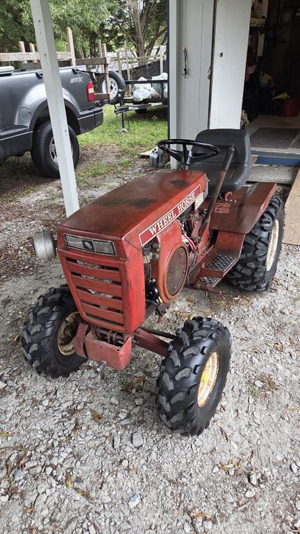

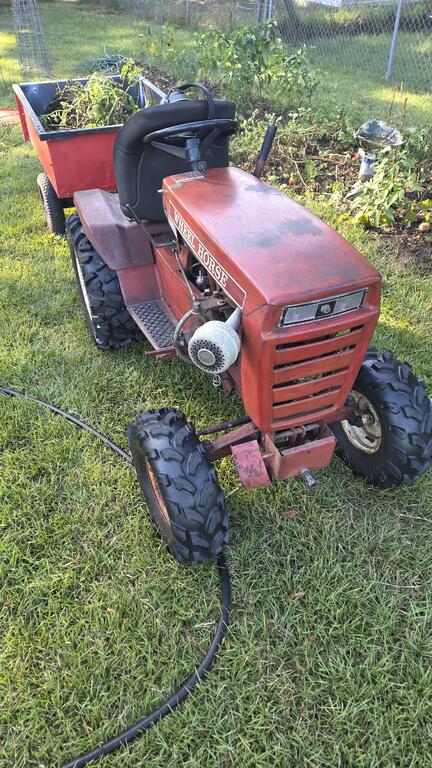

Treepep 1,151 #4 Posted December 11, 2025 @Lee1977 recommended my tires and I have been really happy with them. No fluid however I put tubes in. Great tires. Should last my lifetime. 2 2 Share this post Link to post Share on other sites

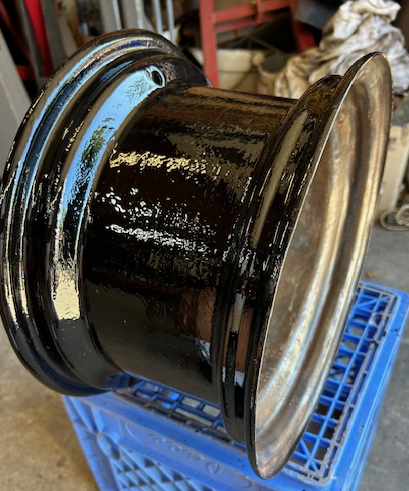

JoeM 10,268 #5 Posted December 11, 2025 One tip I can share, if you might or know that your going to fluid fill the tires, I coat the inside with POR or equivalent to reduce rusting of the rim. If time permits. Fronts are Super Extra Grip 23 10.50 12 Rears Destone 23 10.50 12 The destone set good on the 7 inch rims. The "on size" 23 10.50 12 tires, ie Carlisle, tend to balloon the side walls a bit and set much nicer on 8 1/2" wide rims. On 7 inch rims. 3 2 Share this post Link to post Share on other sites

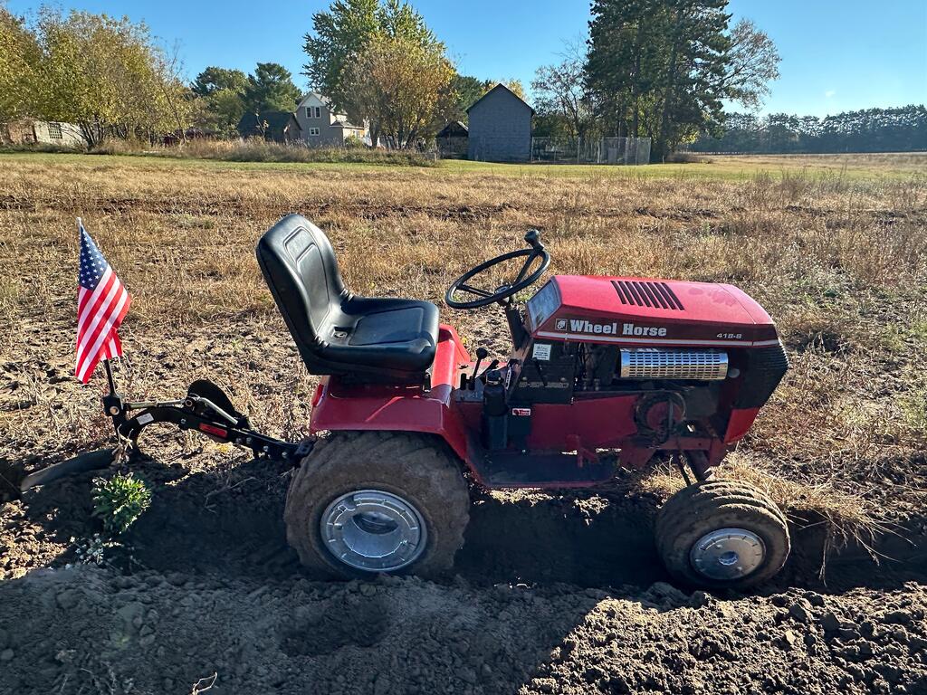

Pullstart 71,255 #11 Posted December 11, 2025 @PeacemakerJack has an amazing build or rebuild or re-re-rebuild was it? on his family’s 875. It has a wealth of knowledge in it, and all kinds of timeless photos of working that tractor in its new years in the 60’s and 70’s I think. One photo that really hit home to me, is his father plowing the garden with turfs and chains. It seems today that we as a society need the newest, the best, the innovation to accomplish a simple task. Remember that our grandfather’s best camouflage was a red flannel and sitting still. With all that said, turfs and chains do pretty alright in the dirt! I’d run them, if needed and have plenty in the past. 3 Share this post Link to post Share on other sites
