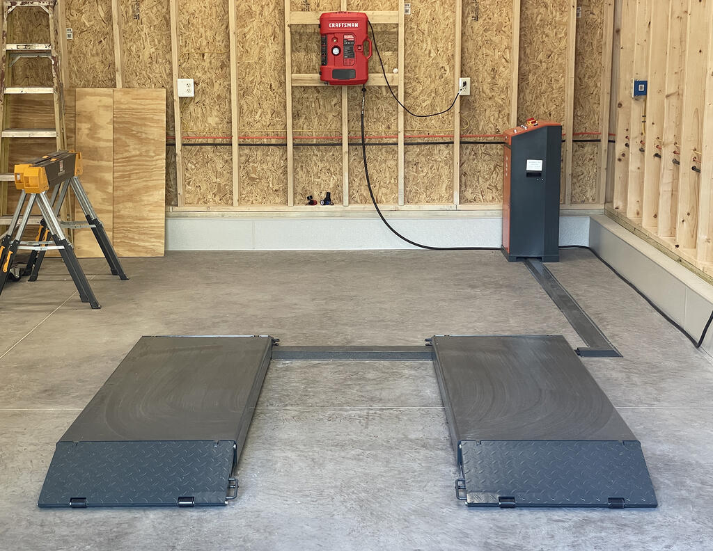

Blue Chips 647 #1 Posted October 26, 2025 I have a full-rise automotive scissor lift, and I was just thinking today how handy it would be to have an adapter for garden tractors or other types of equipment that have a narrower track width than the average car or truck. I haven't even started the design phase yet, but I figured it wouldn't hurt to get some suggestions to kick-start the design process. Ideally, here are some basic characteristics that I have in mind: Safe, solid, and stable. Easy to install and remove by myself (not some massive contraption that weighs a ton). Easily and quickly adjustable (if adjustments are needed). Simple drive-on, lift, lower, drive-off operation (e.g., no extra jacking required). Fairly compact when not in use and stored. Allows good access to the tractor chassis (i.e., doesn't get in the way too much when working on or under a tractor). Still allows me to drive over the lift to park a car or truck when it's installed. This might be a little tricky. You folks might think of some other desirable features. I can fabricate parts as needed, but I'd still like to keep it relatively simple, as I have other projects to work on. Ideas? 2 Share this post Link to post Share on other sites

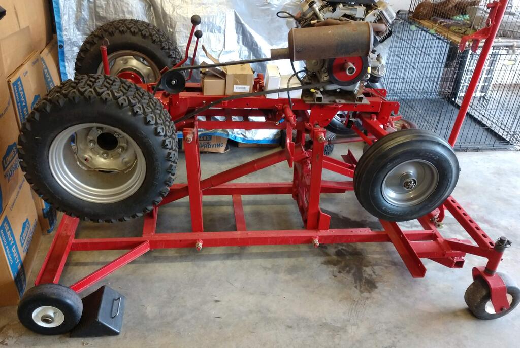

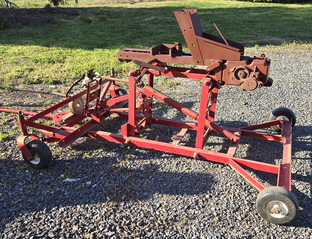

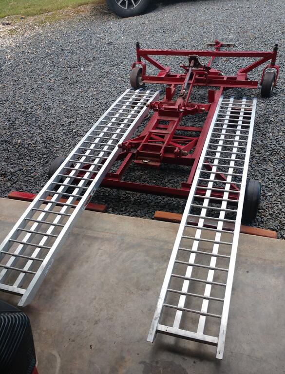

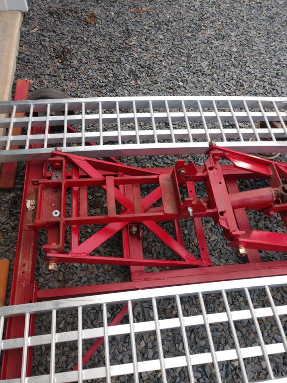

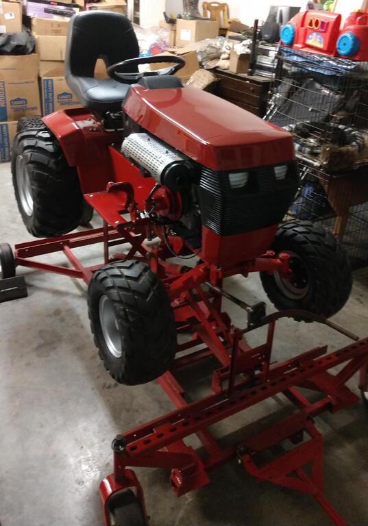

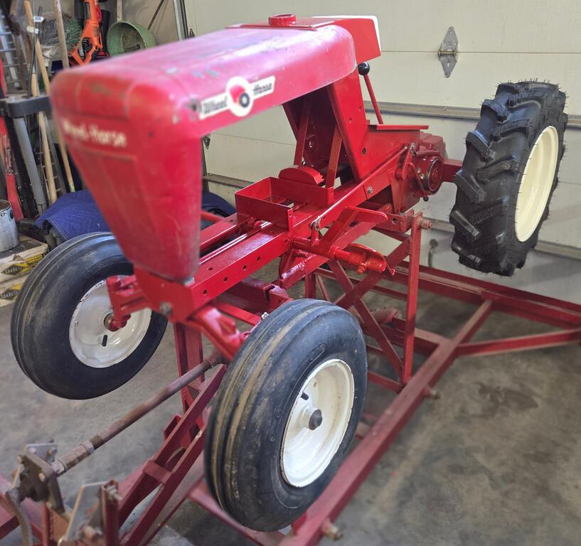

kpinnc 17,018 #5 Posted October 26, 2025 (edited) Not sure what the primary purpose you'd be using would be, but I'll tell you how mine works: I built my lift so it would fit nearly any standard tractor. It locks onto the frame crossbar and has a plate that catches under the transmission mount. The part that catches the crossbar is a modified belly hitch so it locks and the tractor can't fall off. The lift only raises about 30 inches, but that puts it at the perfect height to work on. My 701, 523-H, Bronco 14, 310-8, Charger, and 867 all fit. The distance between the footpeg crossbar and tranny plate is fairly common on most Wheel Horses. Long or short frame makes no difference. Of course GT14, 953, 1054, and any D series is different. I don't have any of those machines to test. Of course if you want to be able to leave a mower deck on this isn't what you need. I made my lift to be able to start with a bare frame and build from there or tear down to a bare frame if needed. Edited October 26, 2025 by kpinnc 2 11 Share this post Link to post Share on other sites

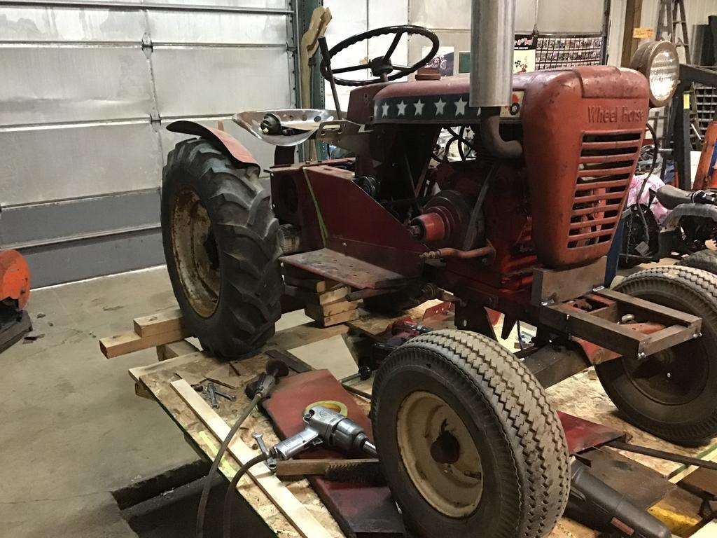

Pullstart 68,768 #8 Posted October 26, 2025 Is that lift adequate to lift two project tractors next to each other? Twinning! I have a single post lift in one bay of my shop. I used a simple pallet and OSB to adapt a tractor lift out of it. 6 Share this post Link to post Share on other sites
kpinnc 17,018 #9 Posted October 26, 2025 3 hours ago, Blue Chips said: Here are a couple of photos of the lift, That is a very nice lift! 1 1 Share this post Link to post Share on other sites

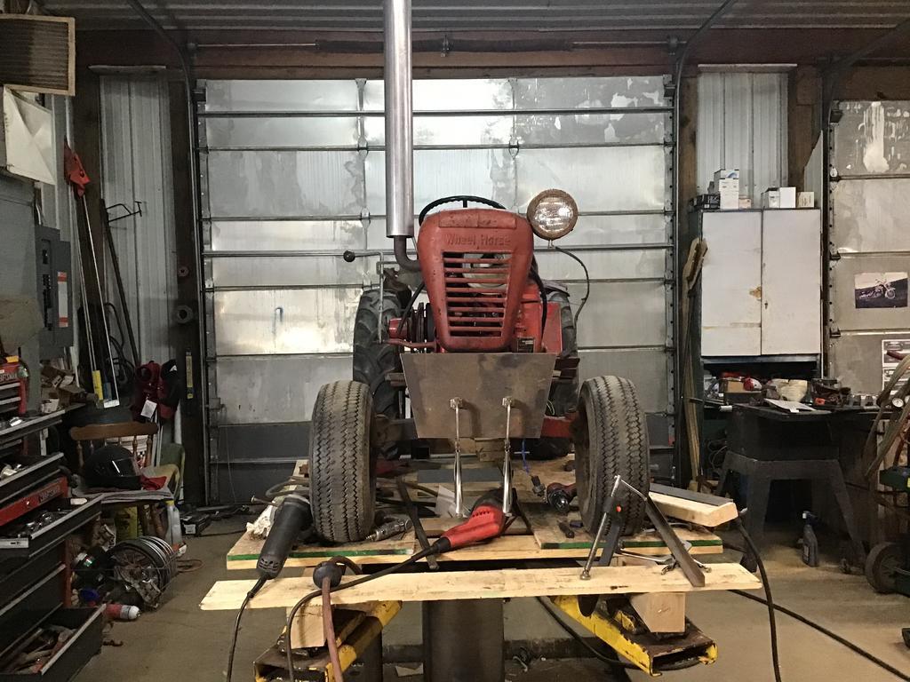

Handy Don 15,755 #10 Posted October 26, 2025 (edited) @kpinnc, @c-series don, and @Pullstart all have great responses. I needed something safe, sturdy, and easy to make. Mainly for tractors on their wheels but adaptable to wheel-less. Short frame and long frame. Something I didn’t have to reach over to get at the tractor, i.e. footprint only a couple inches bigger than the tractor itself. I also wanted good access to the underside for working on steering, frame, or under-mounted implements like a mower or grader. My stand is two 2x12 planks with a gusseted 2x4 frame and legs to support them at about 24” off the ground. The large components bolt together so that I can disassemble for storage (where it is buried just now!). I use ramps and a come-along to get the tractor on or off. I also have a 1000 lb. HF wheeled lift table/cart that fits under the stand so that I can reposition the stand within the work area while the tractor is on it. I also use the table/cart alone with a custom frame block pad when changing wheels or mounting tire chains. With the two-post lift, for wheels-on tractors, I’d consider: a) securing sufficiently strong ramps spanning between the post’s lift platforms. You’ll still have to reach around the platforms to work, or b) securing the ramps atop ONE of the posts. For wheels-off, I’d go with a secured cradle atop only one post. Edited October 26, 2025 by Handy Don 2 Share this post Link to post Share on other sites

clueless 3,347 #13 Posted October 26, 2025 6 hours ago, Blue Chips said: Very interesting idea! I'll have to give that some thought. I'll check the wheelbase of my 522xi and GT18 tomorrow (working on getting our dock out of the water today) and compare it to the lift platform spacing to see what might be involved. That's a very impressive lift, and I can see where it would be great for your collection. If I had more time (and storage space) I'd consider building a specialized lift. Don't be misled by the apparently empty garage; it will soon be filled to bursting with tools and 'stuff.' Here are a couple of photos of the lift, which I recently installed in our new garage, and my current restoration project vehicle, a 1954 Dodge M37 (shown with most of the body parts removed). The concrete blocks on the end of the chassis are to adjust the center of gravity so that it's centered over the lift pivots for stability. how wide is the gap between the two ramps? 1 1 Share this post Link to post Share on other sites
Blue Chips 647 #14 Posted October 26, 2025 (edited) 2 hours ago, clueless said: how wide is the gap between the two ramps? The gap between the ramps/platforms is about 30 inches. For my 5xi-type tractors, if I drove them onto the ramp in the normal way as if they were a car, the tires would be about halfway on and halfway off, plus I prefer to center the load over the platforms as much as possible for stability. I don't know how their track width compares with other Wheel Horse tractors. Edited October 26, 2025 by Blue Chips Share this post Link to post Share on other sites
