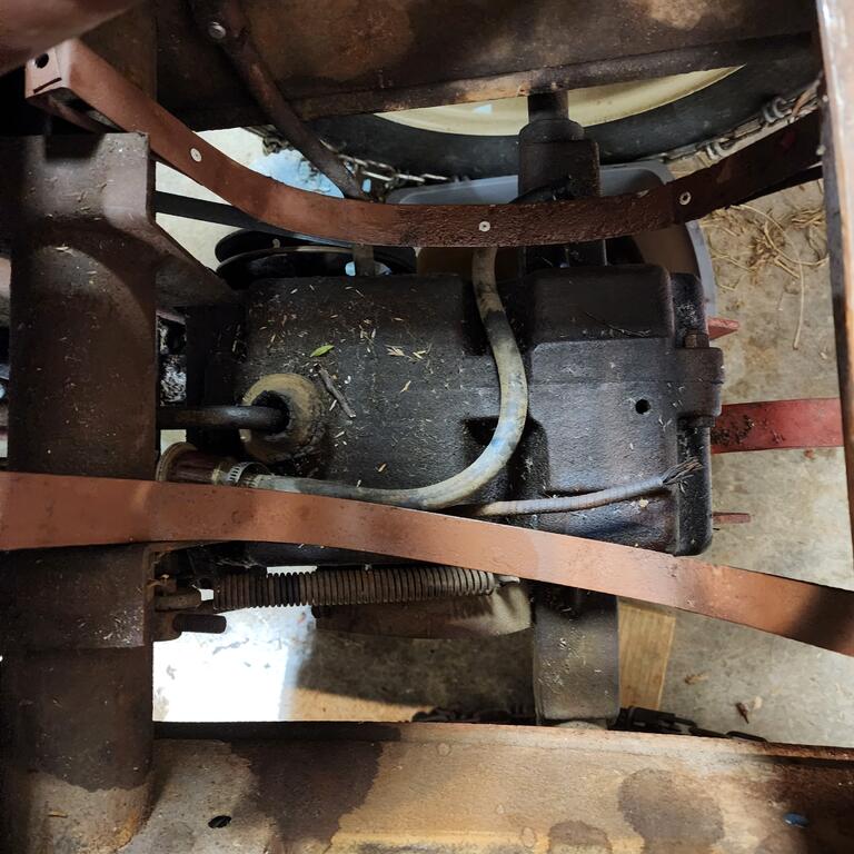

Ed Kennell 46,202 #4 Posted October 25, 2025 Chuck, I'm not sure if will help, but I cut a hole on the seat pan so I could remove the fuel tank from the top. The plate covering the hole is bolted on. These 953s were made with a totally welded frame and seat pan assembly. I assume the frame was then turned upside down to install the fuel tank and the transmission. 2 2 Share this post Link to post Share on other sites

Ed Kennell 46,202 #7 Posted October 26, 2025 (edited) 9 minutes ago, stevasaurus said: I had no idea the 953's were made like that. Is there a rubber boot you could pull up to just be able to look at the shifter?? I don't think so Steve. The entire fuel tank and transaxle is trapped in the weldment of the frame, seat pan and fenders. I was shocked by this arrangement when I attempted to remove the tank. Chuck, I removed the tank to repair a leak that I soldered and I also reenforced some deeply pitted areas with JB Weld. You may be able to cut away a front section of the pan to access the shifter lock screw. Edited October 26, 2025 by Ed Kennell 3 1 Share this post Link to post Share on other sites

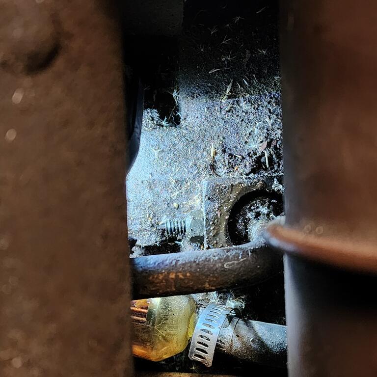

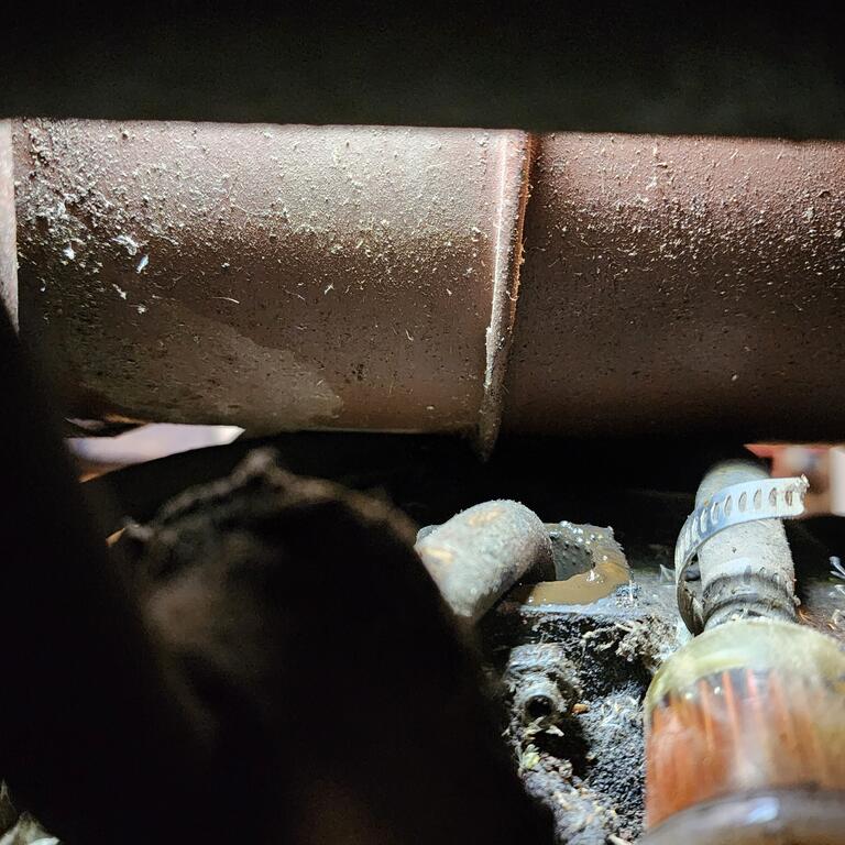

cafoose 3,736 #12 Posted October 27, 2025 On 10/25/2025 at 7:17 PM, Ed Kennell said: Chuck, I'm not sure if will help, but I cut a hole on the seat pan so I could remove the fuel tank from the top. The plate covering the hole is bolted on. These 953s were made with a totally welded frame and seat pan assembly. I assume the frame was then turned upside down to install the fuel tank and the transmission. @Ed Kennell, I was able to replace the dog point screw without dropping the transaxle I tried rethreading the screw but it broke in two I found the new screws I got at the big show several years ago so I put one of those in. Now the shifter works great However, I noticed the gas tank is leaking again How can I seal it? Maybe someone has a good used tank? @953 nut? By the way, how did you get the screws in the plate holding the straps? I can't get my hands in there to lift the straps to start the screws. 1 1 Share this post Link to post Share on other sites
oliver2-44 11,526 #13 Posted October 27, 2025 Eastman sells a kit to clean the tank and seal it from the inside. Their are some good YouTube videos on cleaning and sealing motorcycle tanks. 1 Share this post Link to post Share on other sites
Ed Kennell 46,202 #14 Posted October 27, 2025 1 hour ago, cafoose said: how did you get the screws in Can you fasten the tank, blocks, and straps to the tank and then drop the unit in the hole? Jims idea of sealing the tank from the inside may work. 1 Share this post Link to post Share on other sites
953 nut 66,570 #15 Posted October 27, 2025 10 hours ago, cafoose said: Maybe someone has a good used tank? @953 nut? PM on the way. 1 Share this post Link to post Share on other sites
cafoose 3,736 #16 Posted October 27, 2025 10 hours ago, Ed Kennell said: Can you fasten the tank, blocks, and straps to the tank and then drop the unit in the hole? I can try that. I'm getting another tank from @953 nut so I don't think I'm going to mess with that one. It may be up for sale in the future "as is" if anyone is interested Share this post Link to post Share on other sites
