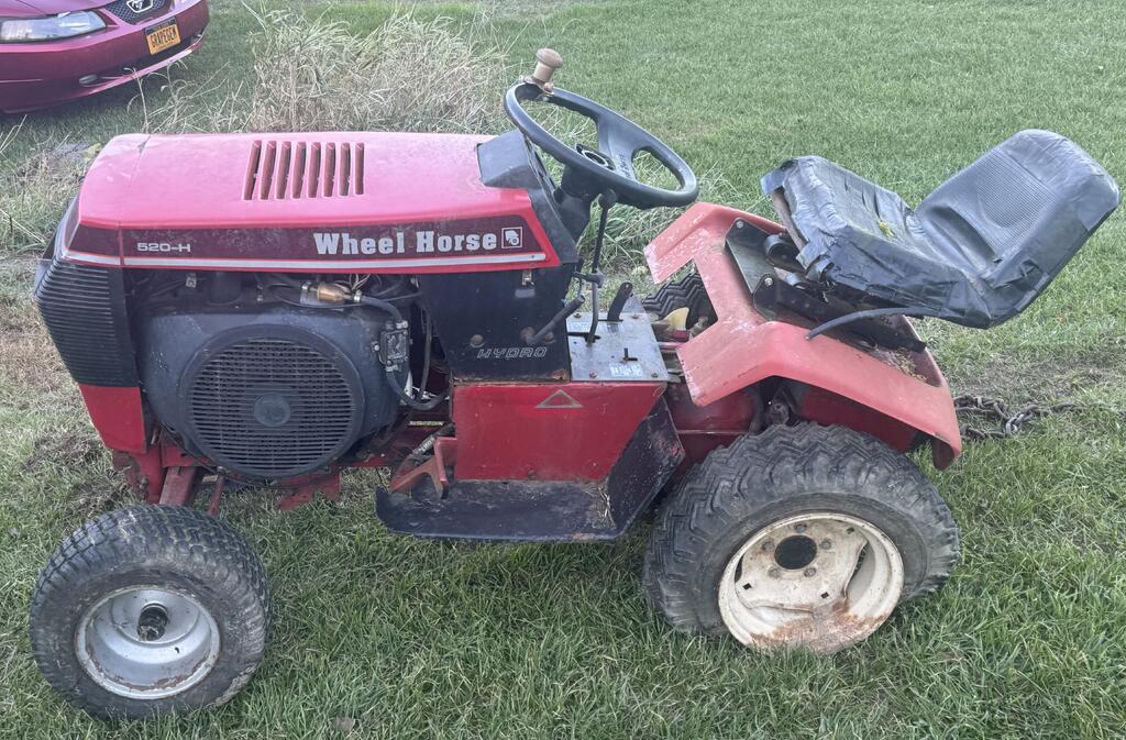

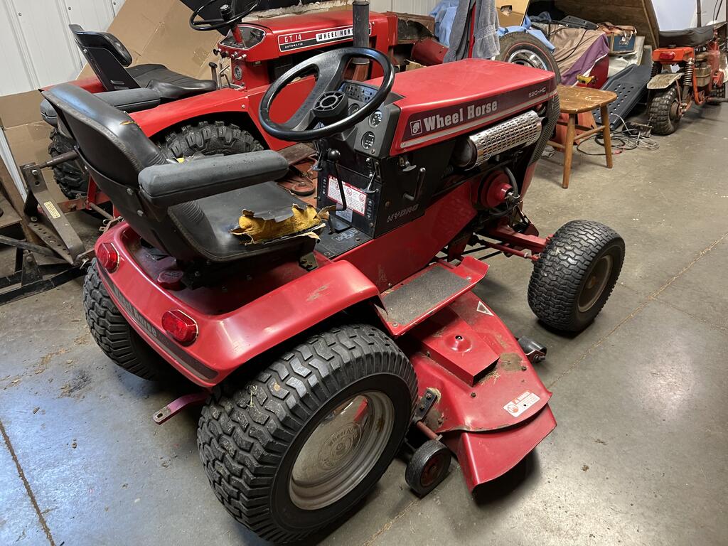

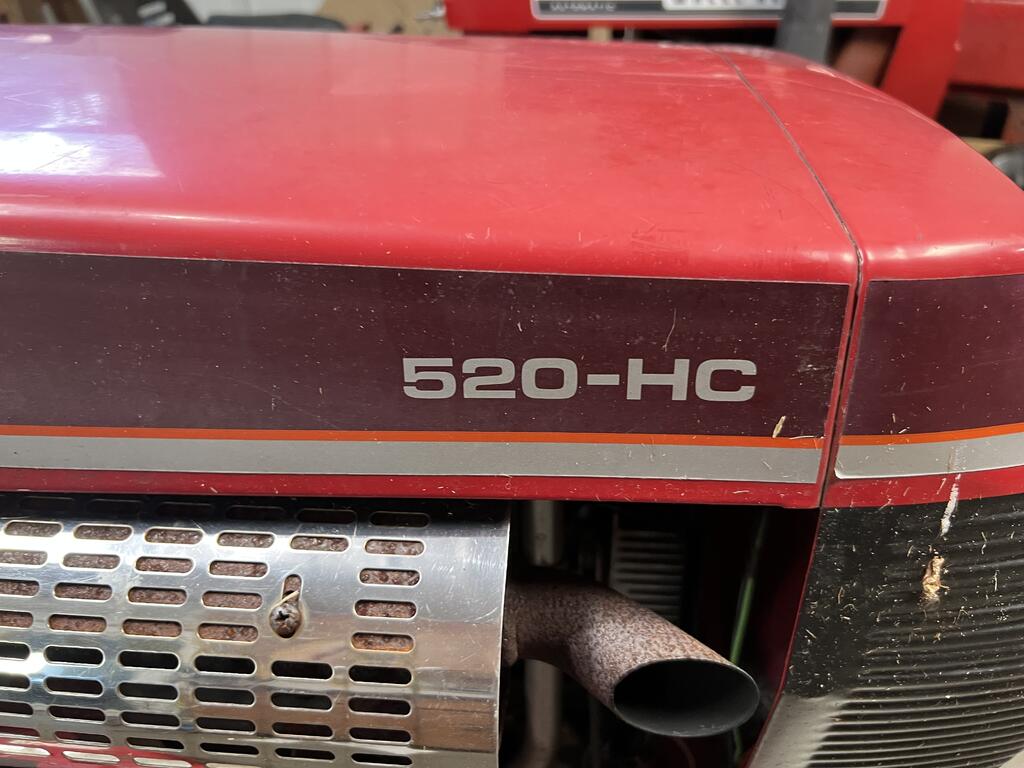

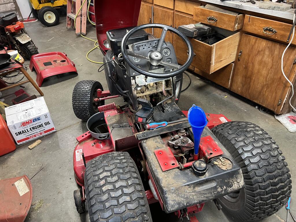

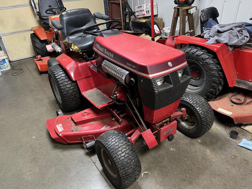

PeacemakerJack 11,061 #1 Posted October 17, 2025 I’ve been looking for a 520HC for about a decade and haven’t found the right fit (price, distance, condition) until recently. My son @Coulter Caleb is purchasing his first house and it has an acre and a half of land in addition to a 125’ driveway. He needed a solid tractor for mowing and blowing. Then this one popped up on the local marketplace. It was owned by one man most of his life until his passing and then was inherited with an estate purchase. It is amazingly clean and original. The wiring is in fairly as produced condition. It ran great when we picked it up but it had several details that needed attention. finding a staple instead of a fuse was more than a little disturbing. this idler pulley was too big and the drive belt too worn and so it slapped on the frame rail making an annoying sound. I also noticed that none of the gauges were working on the dash (long story short, someone installed the wrong key switch). The tach and the rectifier were both toast and after finding some suitable used pieces with the correct key switch we were in business. Tractor was running good, charging good, and driving good 👍. then I pulled the fender pan, changed the rear end fluid/filter installed the rear hitch and cable (he may want to plow with it 🤔) and added the brackets for his bagger. Started the tractor several times to circulate the fluid while raising and lowering the deck. I was getting excited now! beefy looking horse💪🏻 I have never owned one of these (I still don’t technically—it’s Caleb’s) and I am amazed at how heavy duty certain items are! The last thing on my list was changing the oil and filter, then it was time to cut the grass. After the oil was changed, I started the tractor, went to grab something and came back just in time to hear it die😡. It sounded like it ran out of fuel. I checked the petcock and it was on. I started it again, and it ran for three or four seconds and died, then it wouldn’t start. After sitting overnight, I got it to start again but it only ran for about 10 seconds, then died again. Any thoughts on what to check first guys??? I don’t want to go on a wild goose chase. I’ve checked and lubed the 9 pin connector. I have the replacement key switch with good connections and lube. I’m wondering if it is the trigger module but I don’t know how to test that and I don’t want to take the flywheel off unless I have to… 7 2 Share this post Link to post Share on other sites

cafoose 3,845 #3 Posted October 17, 2025 1 hour ago, PeacemakerJack said: I’m wondering if it is the trigger module but I don’t know how to test that and I don’t want to take the flywheel off unless I have to… Mine was the module. It ran fine when cold but died and wouldn't start when hot. 1 1 Share this post Link to post Share on other sites

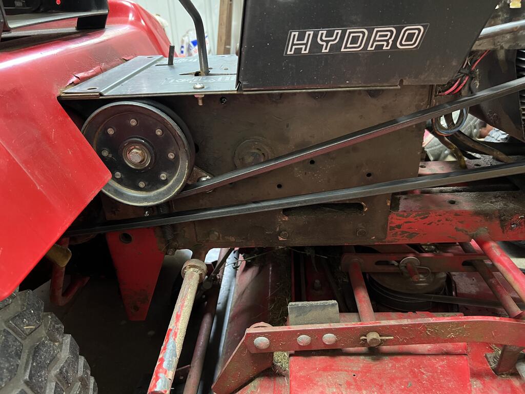

peter lena 10,065 #4 Posted October 17, 2025 @PeacemakerJack noting your reference to that drive belt IDLER PULLEY , known for lubrication failure , referral to belt bounce is typically incremental bearing lube hang up . causing stop / start bounce , have made a point of enhancing all of my idler pulleys , with similar / yet different pulley , allowing a wide grease shield bearing , hi temp polyurea grease , eliminates belt bounce , might also consider , adding some vent slotting on your drive belt guard , local , metal shop , can easily punch in what ever set up you want , bring over the guard , and ask , pete 1 1 Share this post Link to post Share on other sites

953 nut 69,313 #6 Posted October 18, 2025 23 hours ago, PeacemakerJack said: It sounded like it ran out of fuel. I checked the petcock and it was on. I started it again, and it ran for three or four seconds and died, then it wouldn’t start. After sitting overnight, I got it to start again but it only ran for about 10 seconds, then died again. Any thoughts on what to check first guys??? I agree that it sounds like a fuel system problem. To confirm that I would suggest mounting a temporary tank above the engine so it will gravity feed gas to the carburetor. If it runs well then probably just needs a new fuel hose 5 Share this post Link to post Share on other sites
c-series don 12,447 #7 Posted October 18, 2025 You probably already ready did this but I’ll say it anyway. Did you make sure the gas cap is venting? Or try running it with the cap loose? 3 Share this post Link to post Share on other sites

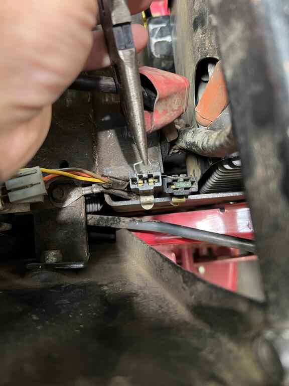

PeacemakerJack 11,061 #8 Posted December 2, 2025 Well guys…this is a head scratcher! Thank you for all your input thus far… I went through and replaced all the fuel line, drained the fuel, checked the fuel pump—everything is working good. Checked the coil—well within spec. Then noticed that I had no power at the yellow wire to the + terminal on the coil. So, I went back through and checked connections. Took some apart and put them back together after cleaning a couple and squirting in some dielectric grease. I turned the key to check something, pushed a bit far, hit the start circuit and it jumped to life😱👏🏻. I turned it off after running it for a couple of minutes and then started it again! I don’t know if I have solved the problem because I didn’t definitely find anything. However, it sure runs good and goes like crazy now that I have everything cleaned and lubed in the hydro system. So…since we are getting a bunch of snow here and I need to get this thing working to clean out Caleb’s driveway…next up—install the Ber-Vac! I need some information that I can’t find and I’m hoping that one of you can help me out. I don’t have the lift arm (push arm), belt size, crank rod and support bracket. Can someone post some sizes for the belt and lift arm? Also any pictures of the lift arm and chute crank would be helpful. 7 Share this post Link to post Share on other sites

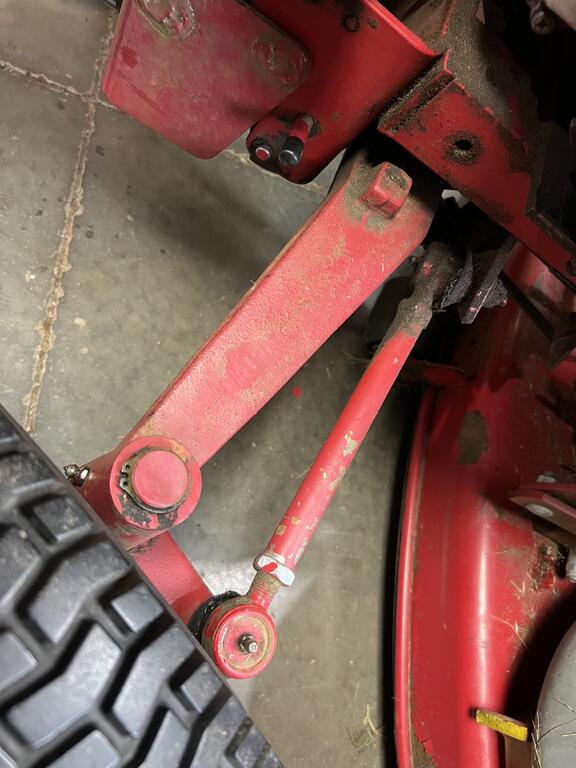

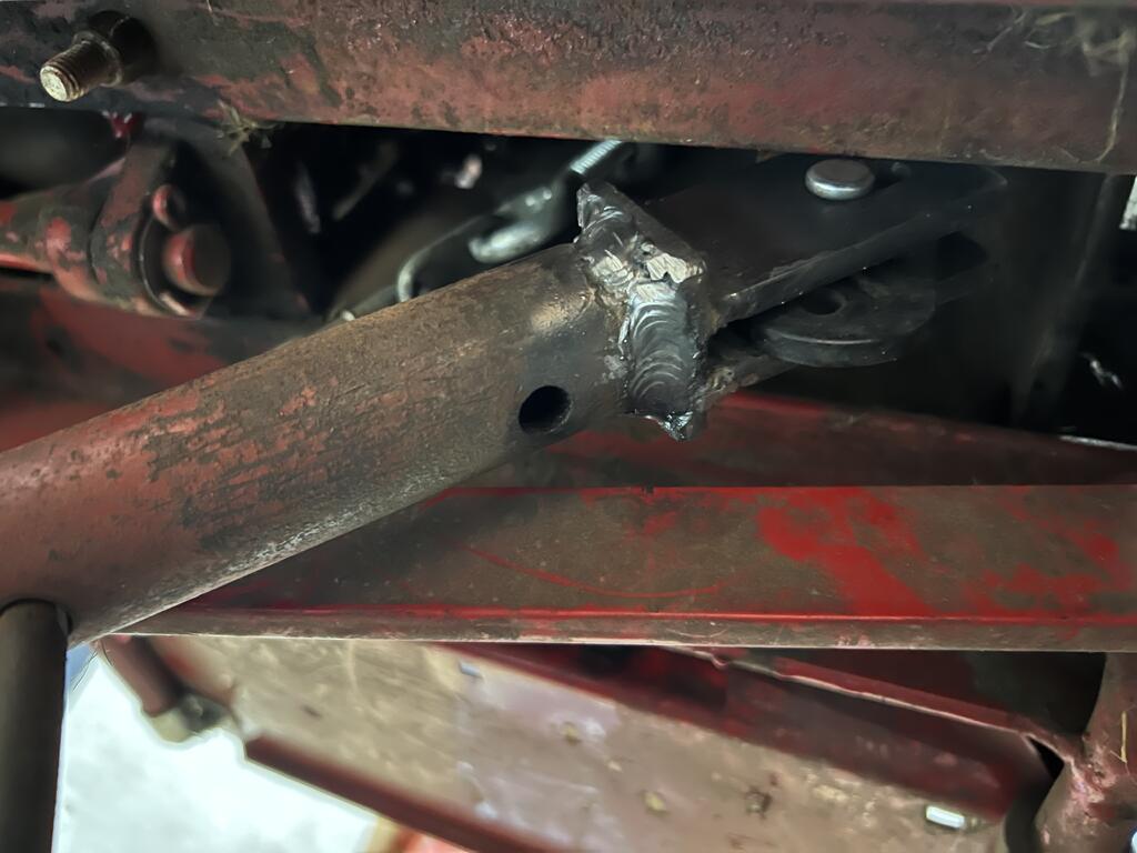

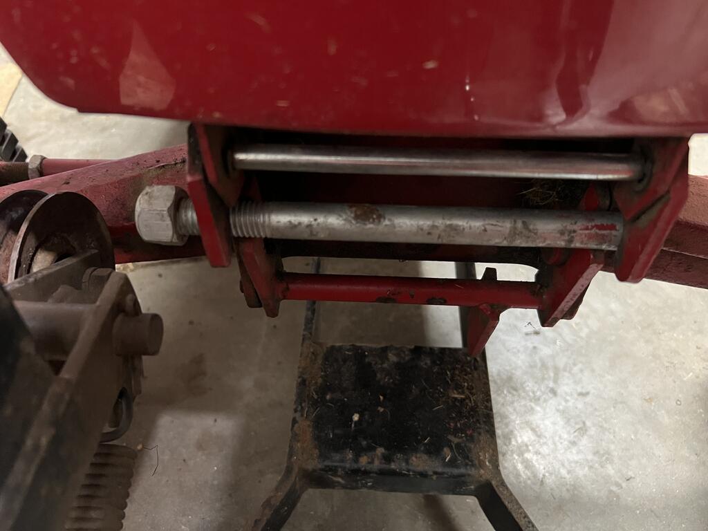

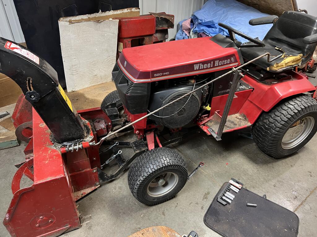

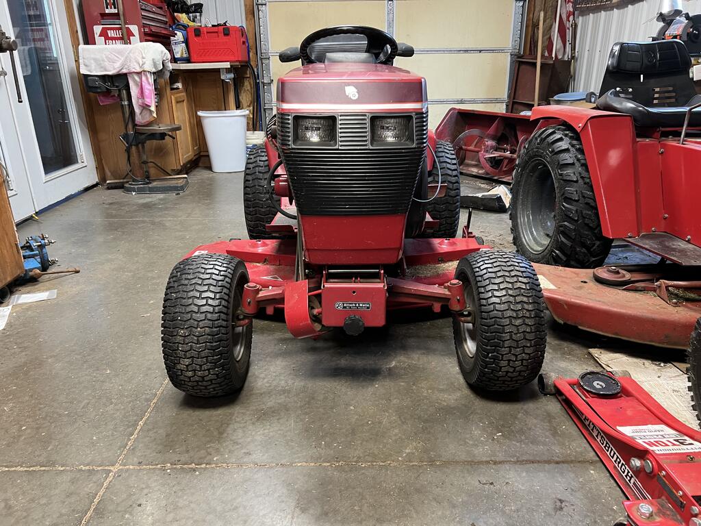

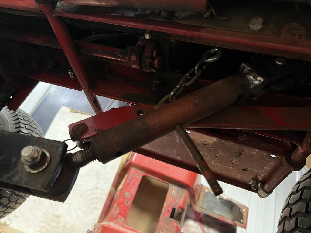

PeacemakerJack 11,061 #12 Posted December 3, 2025 A quick update… dad came over yesterday and we assessed the situation. I suggested using this old spare third arm that I had acquired years ago with a parts tractor. Dad skillfully fabricated the upper “ears” and welded them on to the lift arm—works great! he even cut a slot in them for a little bit of float like the factory arm has. next up: we took and old spare crank rod and fabricated a bracket and welded a hook on the end. It works like a should! Today, I’m going to pick up a belt (gonna try a 5/8x65 as I saw that suggested somewhere on here). I also need to get two helper springs. I have the bolt for the front attach-a-matic and I purchased a set of turnbuckles but realized that the sheet metal where the turnbuckles attach is pretty thin. So, I cut and drilled a piece of flat bar stock to reinforce the area behind it. We are getting close to delivering this to Caleb’s house for winter snow removal duties! 3 5 Share this post Link to post Share on other sites
Ed Kennell 47,343 #13 Posted December 3, 2025 5 hours ago, PeacemakerJack said: Dad skillfully fabricated the upper “ears” and welded them on to the lift arm—works great! Looks better than factory. 5 Share this post Link to post Share on other sites
Handy Don 17,474 #14 Posted December 3, 2025 8 hours ago, PeacemakerJack said: I Jack I applaud all of the mods you’ve made except using a bolt in the front hitch. Under load and use, both the bolt threads and the parts of the hitch touching them will have premature wear. A piece of plain rod or a bolt with a longer shoulder would work better. 6 Share this post Link to post Share on other sites

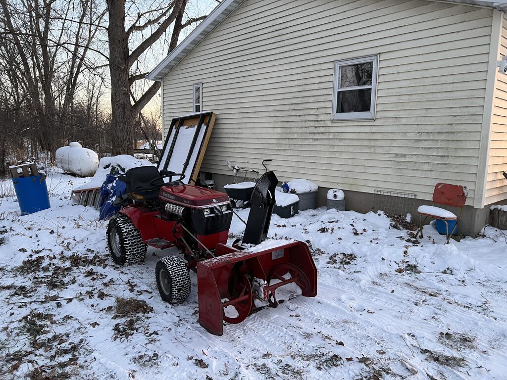

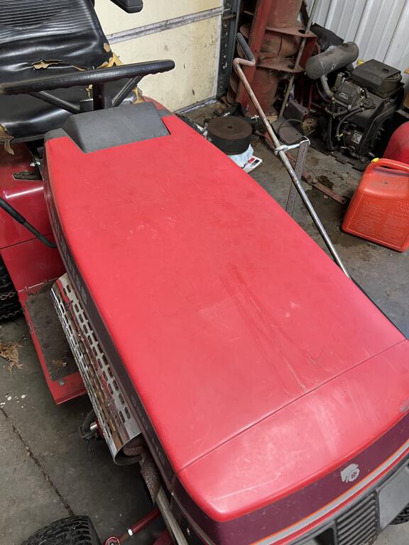

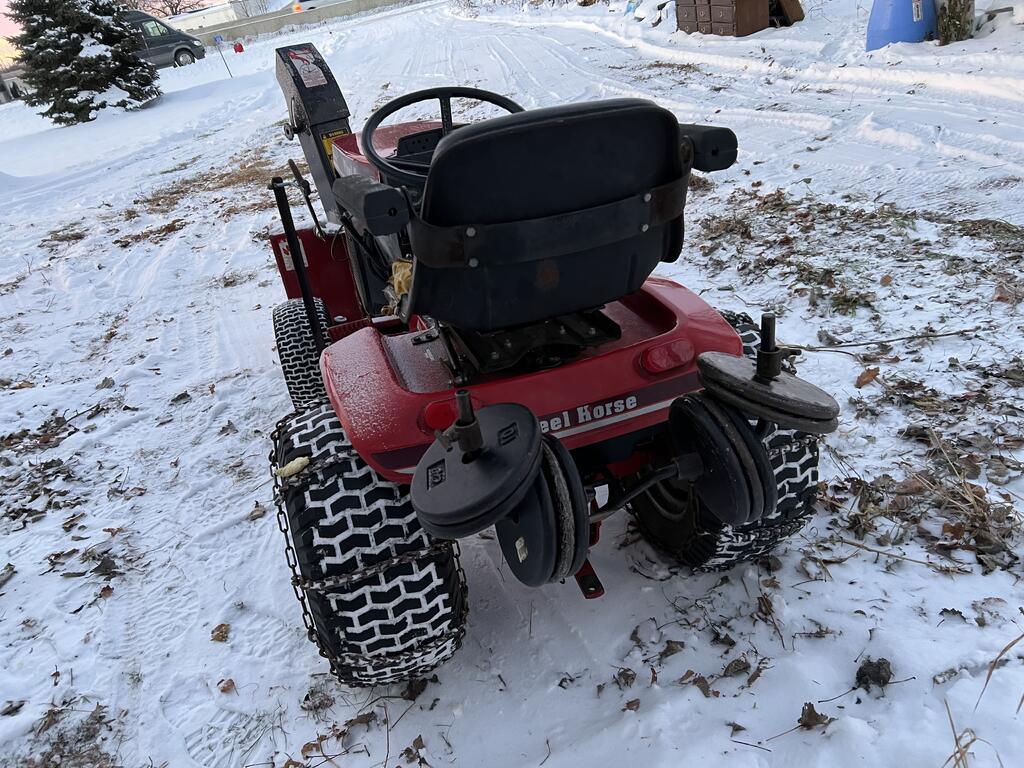

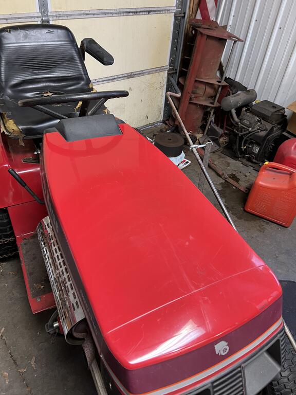

PeacemakerJack 11,061 #17 Posted December 5, 2025 Thanks Don for the thoughts on the bolt. It was handy (like your avatar) and I’m on a time constraint (I leave for Israel on Monday). This upcoming summer, I’ll get a custom rod made up. Today’s project was to clean up the hood and fender pan, then load the tractor, and head to Caleb’s house. This tractor is in such good shape (the seat notwithstanding) and so I felt that the chalky hood would shine up nicely… I wasn’t wrong…I only spent about 20 minutes on it for now but was excited with the results! Not bad for 37 year old paint! my little 5’x8’ trailer was “just big enough” to fit the tractor with blower attached. Caleb got off work about an hour early so that he could be the one to clear his own driveway for the first time! For those of you that have known him for a decade—can you believe that he is now a first time homeowner??? unfortunately the throttle cable is not functioning well. We are going to need to outsource a good used one or find something better. however, even at about half throttle, that Ber-Vac was handling the snow with ease and the torque of that Onan is impressive! For those of you that enjoyed reading the Iron Horse thread, this picture is also there. This is my dad in 1975 clearing the snow at his first house with his 1965 875. 50 years later, his grandson is clearing his driveway at his first house with a 1988 520HC! Wheel Horse—a generational experience for the Stertz household (like it is for many of you!) Job well done for the old machine! using the bagger frame to hold some weight (about 100 pounds) may not be the prettiest situation, however it works just fine. Caleb has a full rack of suitcase weights but no bracket. I suppose that next spring/summer we can fabricate something to hold those. At least, he can now clear any accumulative snow moving forward this winter… 3 5 4 Share this post Link to post Share on other sites
kpinnc 18,965 #18 Posted December 5, 2025 40 minutes ago, PeacemakerJack said: 50 years later, his grandson is clearing his driveway at his first house with a 1988 520HC! Wheel Horse—a generational experience for the Stertz household Great thread for modifications as well as the family and generations points! Definitely some of the things here that drew many of us to these machines and this hobby! 2 3 Share this post Link to post Share on other sites

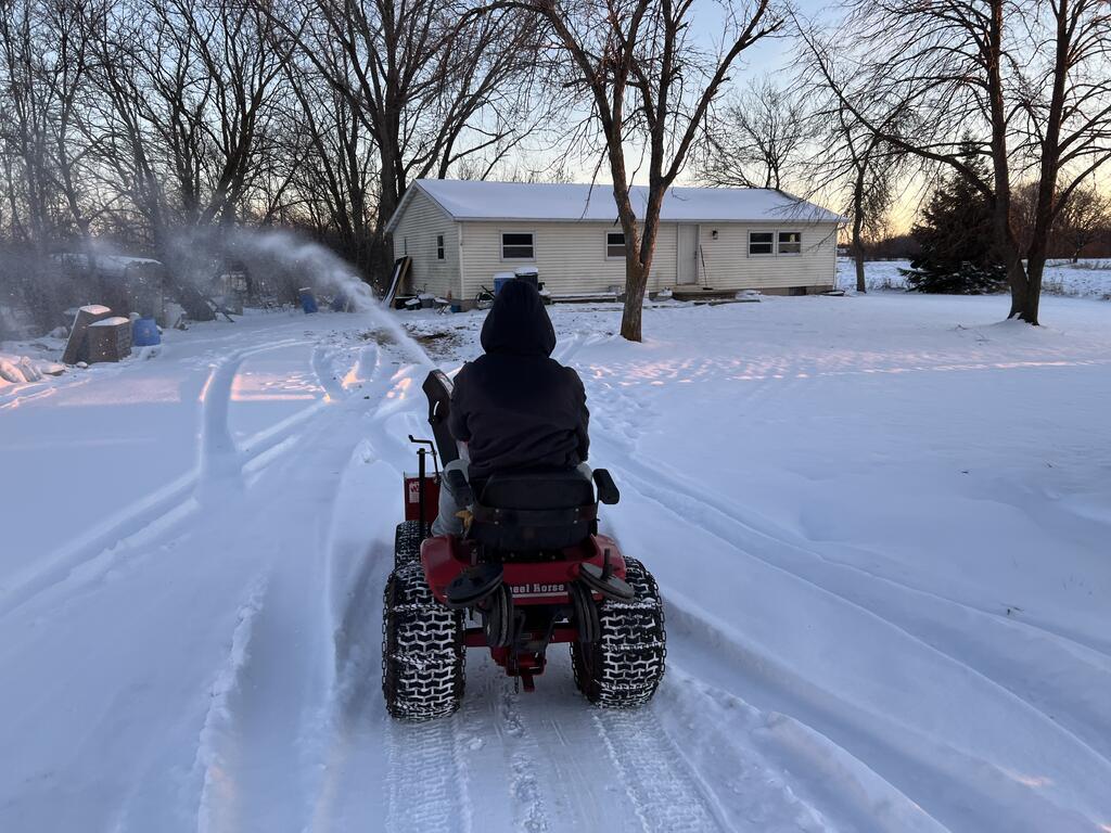

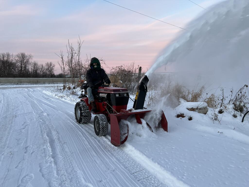

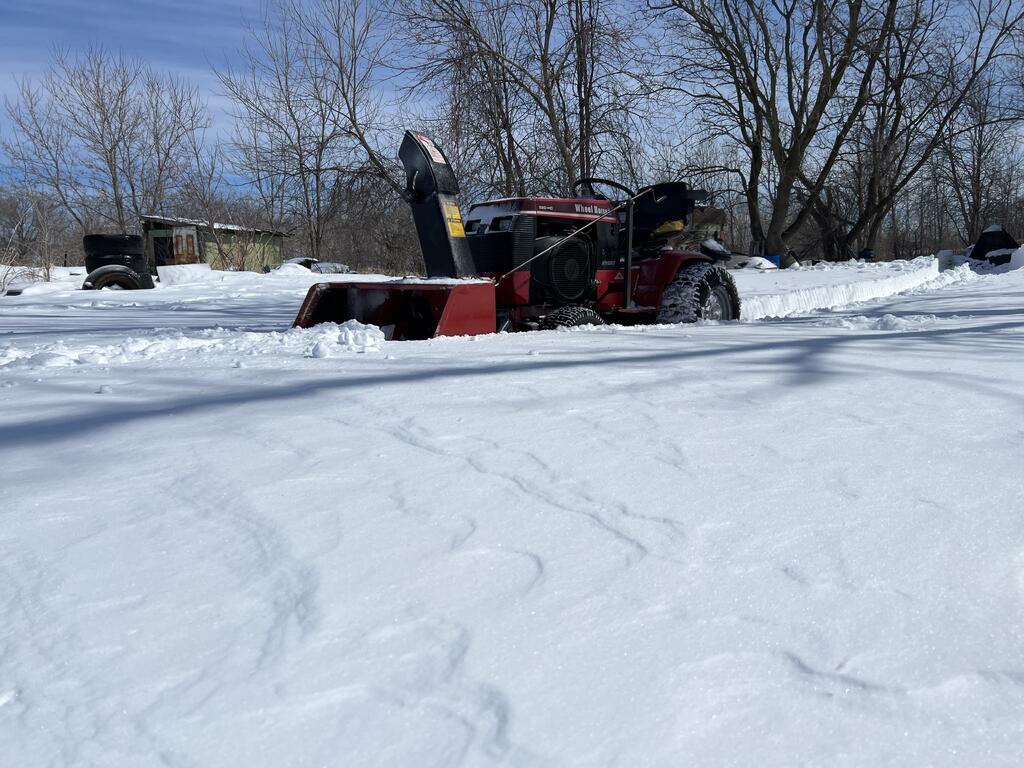

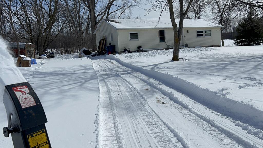

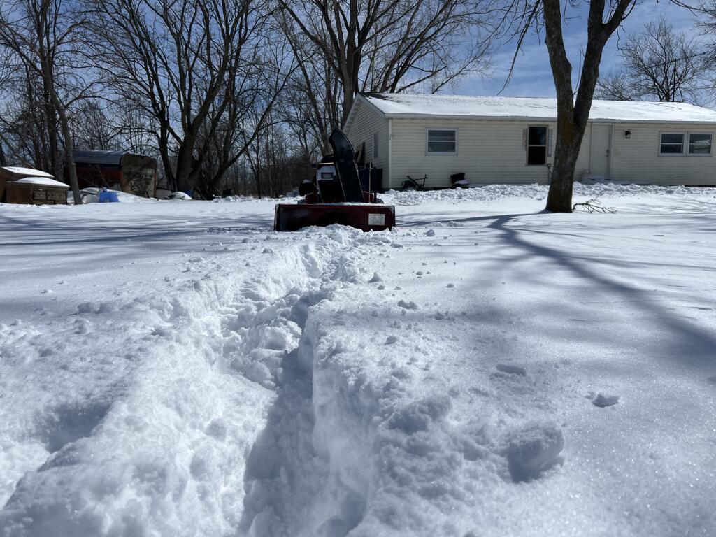

PeacemakerJack 11,061 #22 Posted March 18 Well…winter storm “Elsa” is over in east central WisCo and she left a mess to clean up. Caleb is busy working and so I went to his house yesterday afternoon and surveyed the “damage”. Easily 12” on the level and several drifts that were in excess of 16”. However, the 520HC and two stage Ber-Vac were up to the task… The driveway looks pretty decent in this picture but as I trudged through the snow up to the house I walked through several drifts up to my knees! Hidalgo started without incident and even though the snow was heavy, and I had to drive slow but steady, the blower was handling the white stuff capably. I stopped midpoint down the driveway to grab this shot to give some perspective of depth. Nothing compared to northeast Wisconsin but the deepest level snowfall I’ve had to clear in a long time. I’m really thankful for this setup for Caleb. It will definitely handle whatever gets thrown at him in the upcoming years. I hope you guys affected by the storm all had “fun” on your tractors and stayed safe! 1 12 Share this post Link to post Share on other sites
JCM 11,415 #23 Posted March 18 Love the sound of an ONAN blowing snow on a 520 for sure. Have had good luck with them. Nice job. 6 Share this post Link to post Share on other sites
PeacemakerJack 11,061 #24 Posted March 19 @JCM—i think the same thing every time that I work that Onan—such a pleasing sound like a muscular sewing machine steady at the work of moving tons of snow! That’s why I have one on the shelf—intending someday to install it on my Cub Plow tractor…😀 1 1 Share this post Link to post Share on other sites
Handy Don 17,474 #25 Posted March 19 22 hours ago, PeacemakerJack said: I’m really thankful for this setup for Caleb. It will definitely handle whatever gets thrown at him in the upcoming years. You do realize, I hope, that you could be moving at twice that speed. That Onan is wondering when you’ll ask it to actually work! 2 2 Share this post Link to post Share on other sites
