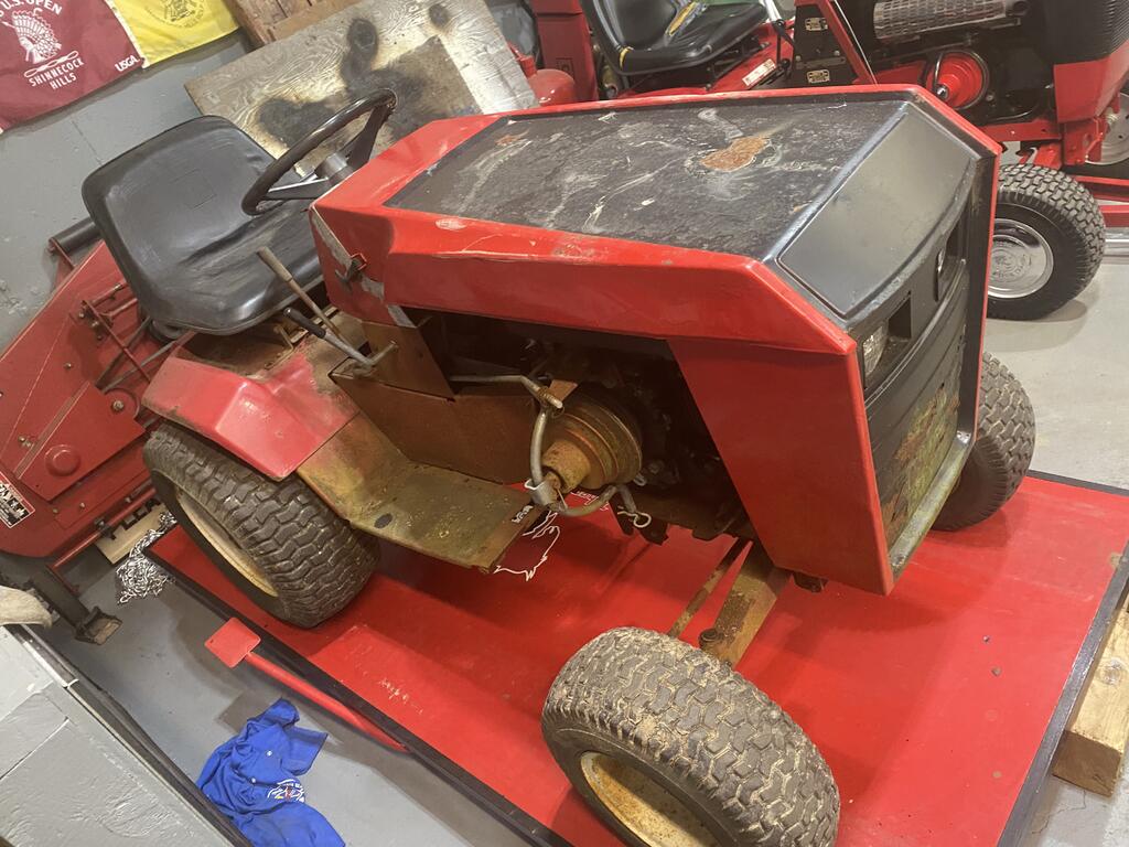

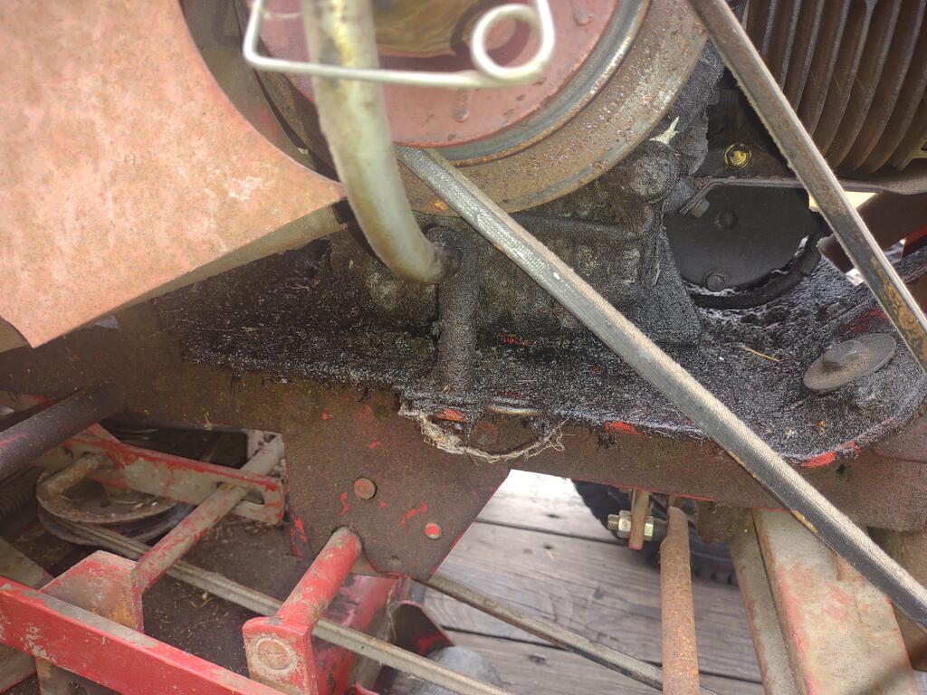

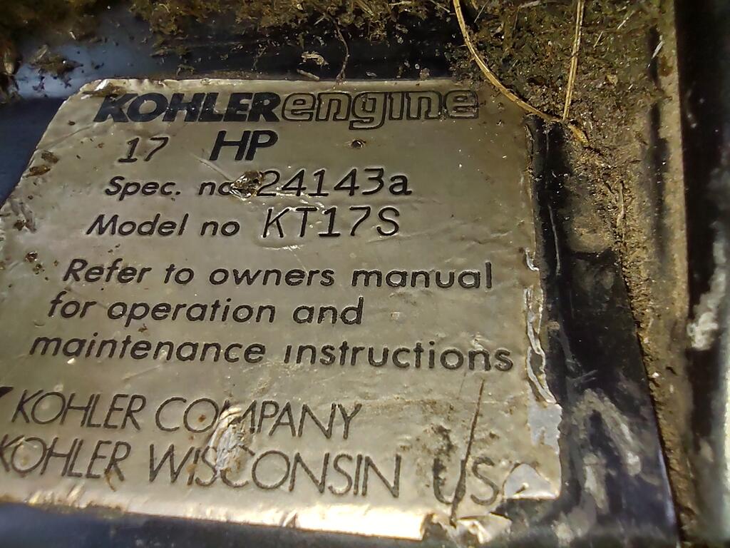

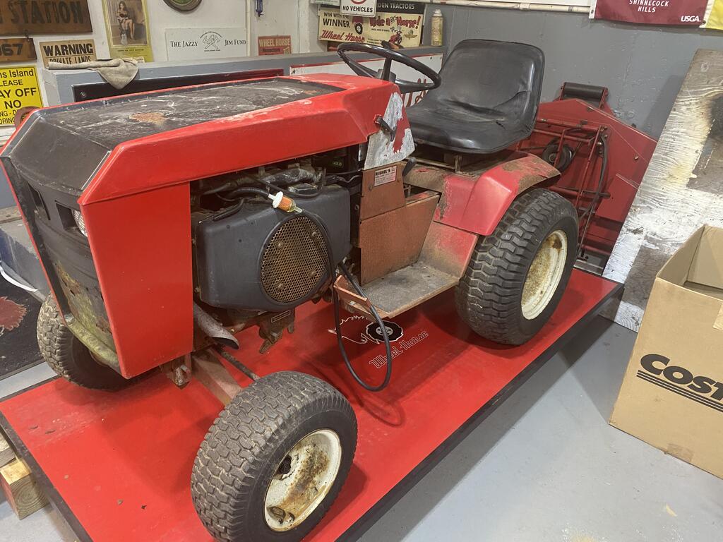

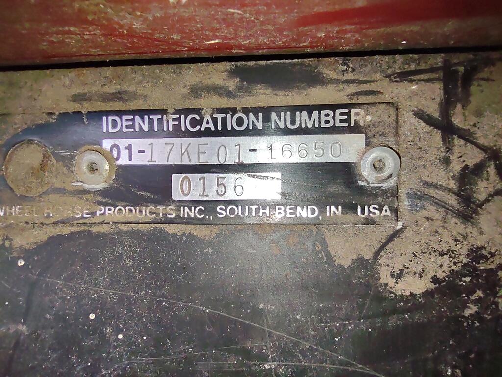

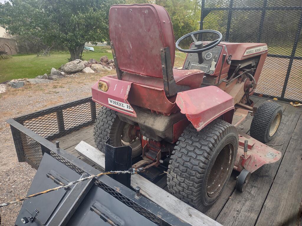

tmix61 95 #1 Posted October 12, 2025 Well look what came home with me. Now I have a lot of questions. Thanks to you guys I figured out what transmission it had in it and it was the pushable type LOL hasn't ran since 2019 so I have my work cut out for me had a massive oil leak as you can see below the clutch not sure where that's coming from yet. Here is the tag off the wheel horse maybe someone could decipher what year it is and what all them numbers mean? In one picture there's a little mechanism on the left side above the floorboard not sure what that's for it says up and down? Another picture shows the cracked and missing rear fender part not sure if you call that the fender pan or what where would one go about getting a new one of them okay a used one I know you like the boat seat lol it also came with a snowblower that looks like it had very few hours on it not that I'm going to use it because I have a gravel driveway them rocks can fly very very far and doesn't like vinyl siding on a house don't ask me how I know I own a D200 LOL. I did take a picture of the tag on the motor it's a 17 horse Kohler not sure what carburetor is on it I would like to rebuild it seen it has been sitting since 2019 anybody know where I can get a Kohler rebuild kit and what carburetor might be on it? 1 Share this post Link to post Share on other sites
ebinmaine 80,709 #4 Posted October 13, 2025 2 hours ago, tmix61 said: Kohler rebuild kit That should be a Kohler kit number 2575702S The fender pan can be replaced with a metal one. 1 Share this post Link to post Share on other sites
953 nut 69,319 #5 Posted October 13, 2025 It is a 1980 model. Take it to the car wash while it is on the trailer. Get all that gunk off first then when you get it running you can tell where the oil came from. Could be the previous owner just spilled a lot of oil. 2 1 1 Share this post Link to post Share on other sites

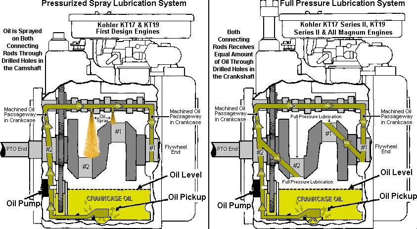

oliver2-44 11,751 #6 Posted October 13, 2025 (edited) Nice score. Enjoy cleaning it up and bring it back to life. Kohler changed from Series 1 to series 2 engine pressurized rod oiling design at spec 23400. So that is a Series 1 engine. Series 1 engine are good engines if used on flat land and oil kept a little over full. On hilly ground the series 1 engine some parts got starved of oil. 1st order of maintenance might be to jump the starter for a compression test and to listen for any rod knock. Since it has been setting a lond time make sure the carb intake is clean (no mice nest etc) Maybe spray some light oil in the cylinders since they are dry from setting so long. Then spin it over with plugs still out. Of course check crankcase has proper oil level. Others more familiarize with the KT 17 engine can help you if you have more detailed questions. Then give poor oily horse a bath. Edited October 13, 2025 by oliver2-44 2 1 Share this post Link to post Share on other sites
c-series don 12,447 #7 Posted October 13, 2025 I’d do like @oliver2-44 said. Pull the spark plugs and shoot some Marvel Mystery Oil in cylinders, then let it sit for a day or two. Looks like it also might need an axle seal, which shouldn’t be a big deal because the hub should come off relatively easily if it has been leaking oil on the axle for a while. Tractor is a 1981. My C-175 was in worse shape before I brought it back to life. 7 Share this post Link to post Share on other sites
tmix61 95 #8 Posted October 13, 2025 56 minutes ago, oliver2-44 said: Nice score. Enjoy cleaning it up and bring it back to life. Kohler changed from Series 1 to series 2 engine pressurized rod oiling design at spec 23400. So that is a Series 1 engine. Series 1 engine are good engines if used on flat land and oil kept a little over full. On hilly ground the series 1 engine some parts got starved of oil. 1st order of maintenance might be to jump the starter for a compression test and to listen for any rod knock. Since it has been setting a lond time make sure the carb intake is clean (no mice nest etc) Maybe spray some light oil in the cylinders since they are dry from setting so long. Then spin it over with plugs still out. Of course check crankcase has proper oil level. Others more familiarize with the KT 17 engine can help you if you have more detailed questions. Then give poor oily horse a bath. That's not a really good thing having a series one. Because I planned on plowing with it and I have hills both sides of my driveway Share this post Link to post Share on other sites
gwest_ca-(File Mod) 12,488 #9 Posted October 13, 2025 1980 was the year Wheel Horse switched from Sundstrand to Eaton hydro's. It happened between April 17 and June 4. 16650 is a 1980 serial number. The 01-17KE01 model number used in 1980 model year carried on in 1981 model year. All other hydro models got a new model number for the 1981 model year. 2 1 Share this post Link to post Share on other sites

JoeM 10,267 #11 Posted October 13, 2025 8 hours ago, gwest_ca said: 1980 was the year Wheel Horse switched from Sundstrand to Eaton hydro's I got tricked on one of those thinking it had the eaton. The guy said it was a 79 but it had the square hood. It was an early eighty model. Of course the Kohler was vented. 1 Share this post Link to post Share on other sites
953 nut 69,319 #12 Posted October 13, 2025 9 hours ago, tmix61 said: not a really good thing having a series one. Because I planned on plowing with it and I have hills both sides of my driveway That depends on how long and how steep the hills are. The rod bearings on the series one K-Twins didn't have a pressurized lubrication flow, a nozzle from the cam shaft oil flow directs a spray of oil onto the connecting rod bearings. If you are on a steep incline gravity will allow some of the spray to miss the rod journal while on the incline. Over filling the crank case on a K-Twin will allow the crankshaft to splash some oil around but will also lead to oil burning. All you can do is use good common sense and try to avoid long duration operation on steep hills. 1 Share this post Link to post Share on other sites

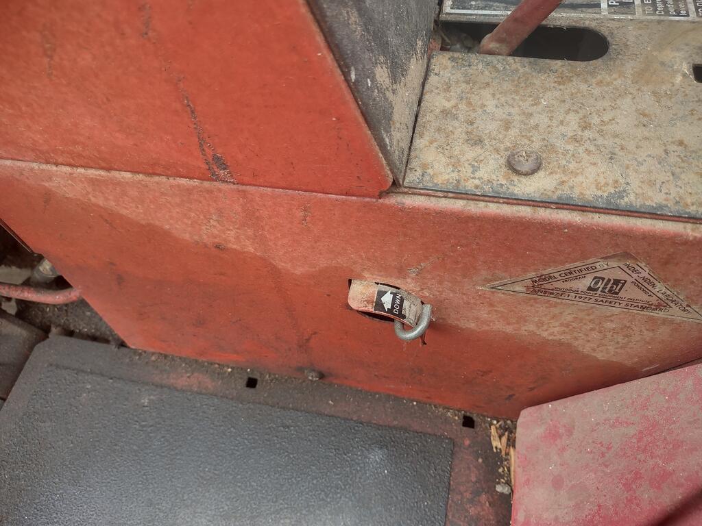

peter lena 10,065 #14 Posted October 13, 2025 @tmix61 terrific job on that ! glairing to me . 3rd photo down, pto swing clip ? round circle at corner ? add a light / medium extension spring to that , attach to HITCH PIN CLIP ON FRAME , circular end ? that simple tension , eliminates related linkage noise / bounce , also like SUPER LUBE hydraulic oil on movement / vibration areas . pete Share this post Link to post Share on other sites

tmix61 95 #16 Posted October 13, 2025 12 hours ago, c-series don said: I’d do like @oliver2-44 said. Pull the spark plugs and shoot some Marvel Mystery Oil in cylinders, then let it sit for a day or two. Looks like it also might need an axle seal, which shouldn’t be a big deal because the hub should come off relatively easily if it has been leaking oil on the axle for a while. Tractor is a 1981. My C-175 was in worse shape before I brought it back to life. Can the axle seal be removed and replaced without splitting the transmission? Share this post Link to post Share on other sites
Gasaholic 390 #17 Posted October 13, 2025 15 minutes ago, tmix61 said: Can the axle seal be removed and replaced without splitting the transmission? Yep! Hardest part is getting the hub off. Then it is just details like making sure the axle shaft is clean and smooth (file down the keyway ridges that build up on sides of keyway so the sharp ridges don't cut the new seal) and things like that, but other than getting the hubs off which can be a struggle (without breaking them that is) it's a fairly simple job - all the transmission gearcase seals can be replaced without splitting transmission. 1 1 Share this post Link to post Share on other sites

tmix61 95 #19 Posted October 13, 2025 12 minutes ago, Gasaholic said: Yep! Hardest part is getting the hub off. Then it is just details like making sure the axle shaft is clean and smooth (file down the keyway ridges that build up on sides of keyway so the sharp ridges don't cut the new seal) and things like that, but other than getting the hubs off which can be a struggle (without breaking them that is) it's a fairly simple job - all the transmission gearcase seals can be replaced without splitting transmission. Where would I find information on getting the right size oil seal for that axle? Share this post Link to post Share on other sites
gwest_ca-(File Mod) 12,488 #20 Posted October 13, 2025 Go to the Wheel Horse illustrated parts list to find the original WH part number - 6449 item #9 https://www.partstree.com/models/01-17ke01-c-175-toro-garden-tractor-1980/transaxle-24/ Then go to the top of our transmission section where you will find some pined posts. Look through them for an alternate SKF/Chicago Rawhide part number which you can get from any auto jobber and Napa. There are other seal makers like National that will have a replacement for the 6449. 1 1 Share this post Link to post Share on other sites
