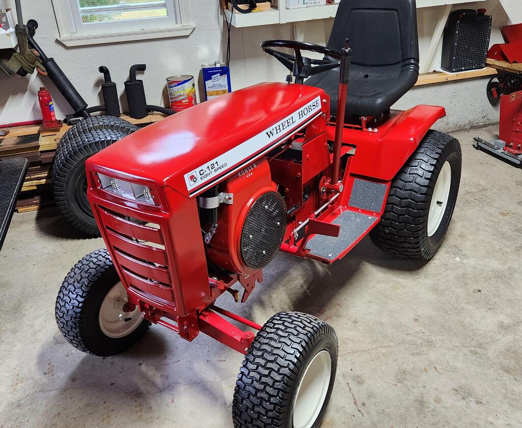

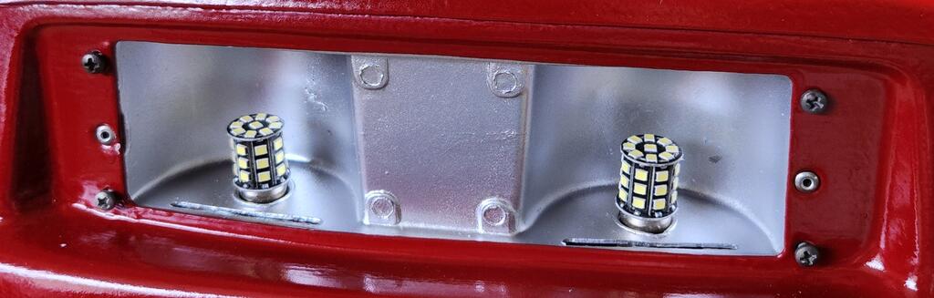

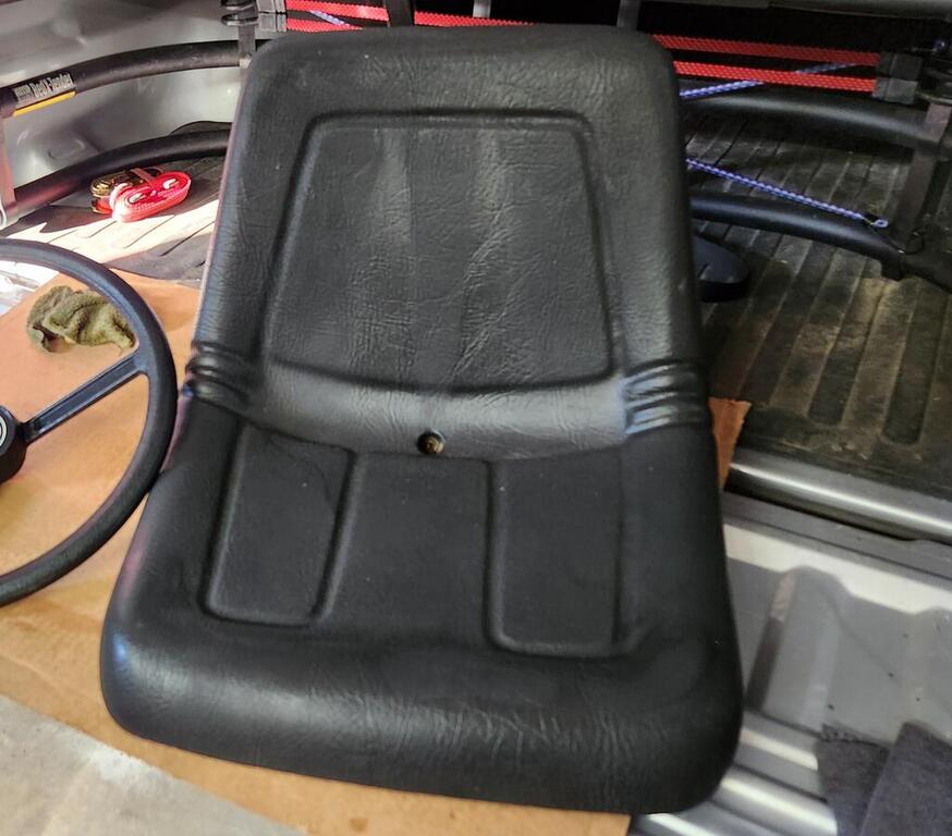

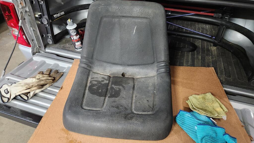

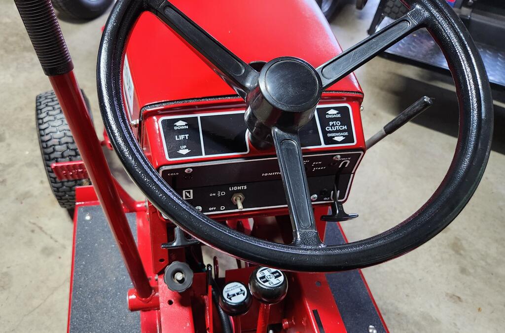

Racinbob 13,192 #1 Posted September 22, 2025 I'm past due for an update. The paint is cured enough and it was decal time. I've been anxious for this. I decided to go with stock decals from Terry. As any of you that have used his decals knows they are idiot proof. Soooooo easy to apply with no bubbles. I still have a couple minor decals to put on. The headlight tub got a quick coat of silver and pop riveted in place. 5000k led bulbs. I don't need taillights so reflectors covered the holes. I got this seat with no tears but it needed a good cleaning. I'd say it cleaned up pretty good. The electric fuel pump is installed under the seat. About all I need to do is the electrical, throttle and choke controls and the usual odds and ends. In the background of the first picture you'll see some mufflers sitting there. Big block and a small block Nelsons and a stack with a flipper cap thingy. I'm not a big stack person but for some reason it's calling me. I've been pondering what chore this tractor will have and I've pretty well decided on getting rid of the 314H and slapping the 42"sd deck on this one. This had a 42"rd but it needs work. I'm thinking that will be a project for this winter. 3 9 2 Share this post Link to post Share on other sites
ebinmaine 80,709 #2 Posted September 22, 2025 1 hour ago, Racinbob said: idiot proof That may be but they ain't me Bear idiot proof. 1 hour ago, Racinbob said: 5000k led bulbs. I have some of those in use. They work great. 3 Share this post Link to post Share on other sites
peter lena 10,065 #3 Posted September 22, 2025 @Racinbob been using MOTHERS , BACK TO BLACK , walmart , for black trim and seat recovery , anything I have tried it on just comes back from the grave . looks good .pete 3 Share this post Link to post Share on other sites

Racinbob 13,192 #5 Posted September 22, 2025 2 hours ago, peter lena said: @Racinbob been using MOTHERS , BACK TO BLACK , walmart , for black trim and seat recovery , anything I have tried it on just comes back from the grave . looks good .pete I always have some Back to Black on the shelf. It does a great job but it's not really a cleaner. I used VRP vinyl cleaner and conditioner. 1 Share this post Link to post Share on other sites
stevasaurus 23,856 #6 Posted September 22, 2025 Dang Bob that horse is SWEET !!! Thank you for saving that Mate. 2 1 1 Share this post Link to post Share on other sites

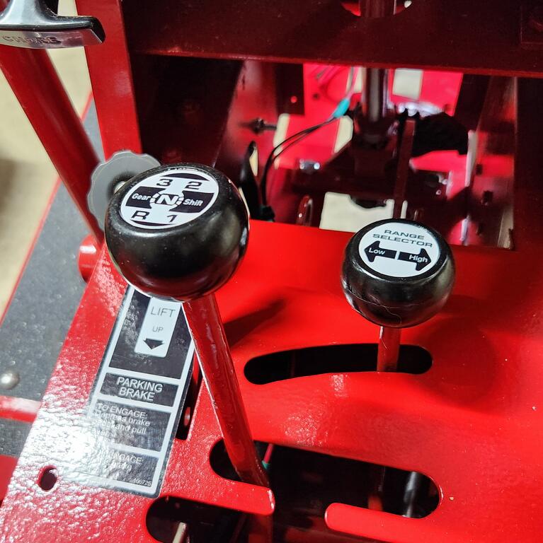

ri702bill 13,067 #7 Posted September 22, 2025 The flat top shifter knobs look great - what did you use on the black?? I have had good longterm success with Duplicolor Black Interior Dye Paint. 1 Share this post Link to post Share on other sites
Racinbob 13,192 #8 Posted September 22, 2025 Nothing fancy. I chucked them up in a drill press and hit them with 400 grit. Then I wiped on a couple coats of Flood Penetrol. I was experimenting more than anything and they actually came out pretty nice. 3 4 2 Share this post Link to post Share on other sites

Racinbob 13,192 #10 Posted September 23, 2025 18 hours ago, stevasaurus said: Dang Bob that horse is SWEET !!! Thank you for saving that Mate. It's been a fun project. As I've said before, this started out being just a quick refurb. The more I went the further I wanted to take it. Now I kinda regret doing a proper priming job instead of the way I did it through the winter. It definitely had an effect on the final finish. OK, that and maybe my first attempt with a HVLP gun. But it looks like it's destined to become a mowing machine again and it's fine for that. I haven't got the lift arm underneath yet and I think I'll do that today. Maybe even put the deck on it. I'm a little concerned that the rear 10.50's may hit the deck wheels. 1 1 Share this post Link to post Share on other sites
kpinnc 18,965 #11 Posted September 23, 2025 On 9/22/2025 at 9:31 AM, Racinbob said: I'd say it cleaned up pretty good. Beautiful restore! Well done! 1 1 Share this post Link to post Share on other sites
953 nut 69,315 #12 Posted September 25, 2025 I am a bit late to the party but glad to see the @stevasaurus Dino tractor looking so good. 2 Share this post Link to post Share on other sites
