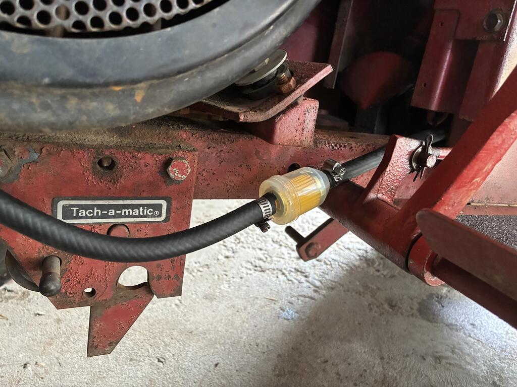

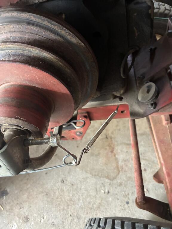

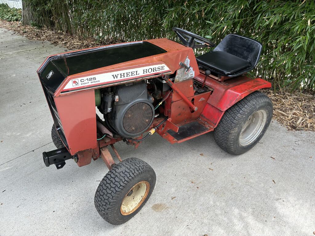

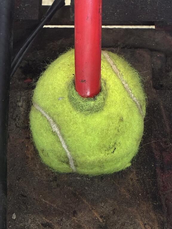

SylvanLakeWH 32,921 #26 Posted August 24, 2025 Today's progress: 1. New fuel line and filter. @WHX?? please inspect for correct installation... 2. Added spring to pto rattler per @peter lena's suggestion. Works like a charm!!! And... NO grease involved!!! Thanks Greasy Springy Pete! 3. Added my own "love" to the shifter boot. Might be the wrong color but it actually works perfectly and it cost nothing - I borrowed it from Denali. He was not amused... 4. Second and final coat of penetrol. Other than the wheels, which I'll tackle next, it looks like it's gonna look... All for now! 3 2 Share this post Link to post Share on other sites
peter lena 10,125 #27 Posted August 24, 2025 @SylvanLakeWH glad you tried that ! put my spring on that hitch pin clip loop , right there , but same result ! been oiling my horse paint for years , think the retention of an oiled patina look is the perfect fit , and it retains paint . the paint that shows a deeper shine , I buff out with a 6" electric palm buffer and cleaner wax , like this. only thing I use on them now is a light oil rub down , good talking , pete 1 Share this post Link to post Share on other sites

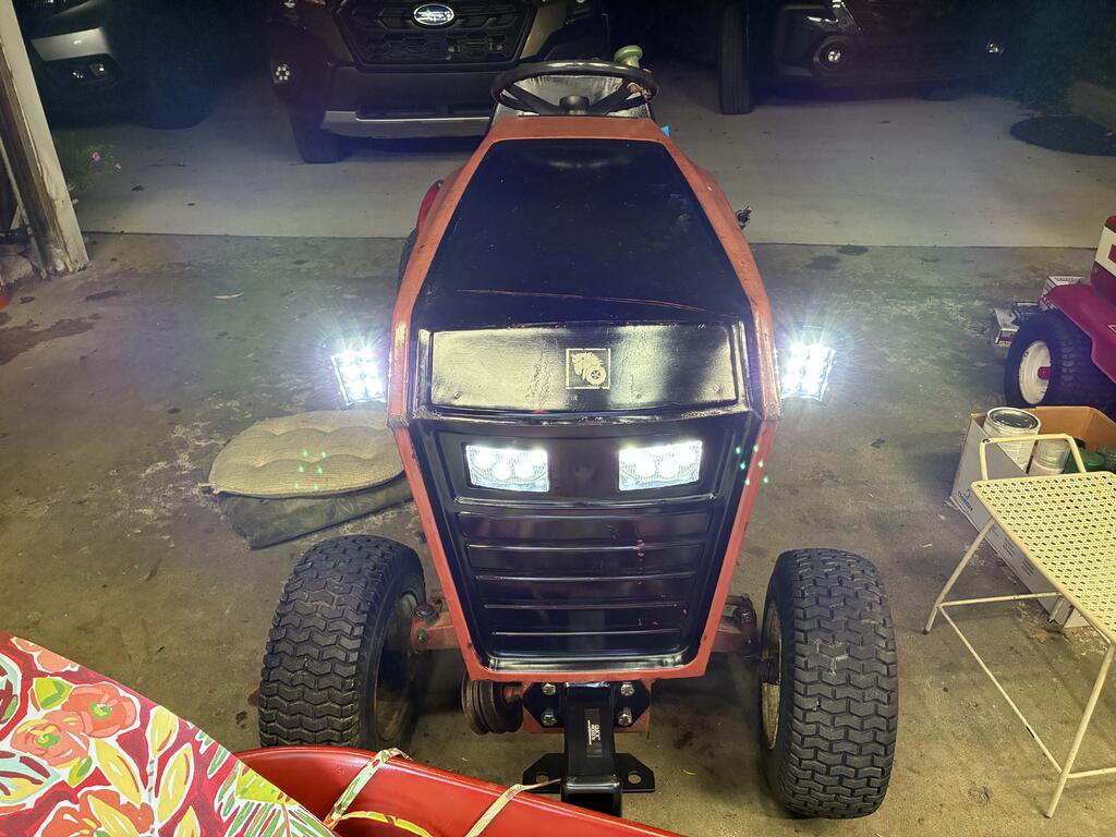

SylvanLakeWH 32,921 #28 Posted August 27, 2025 Tonight's episode: Added spots to the front. This will be my back up snow unit, so I'm going to make it very bright. Ran into the old black hood hinge ground problem. Took an old battery cable and grounded the whole hood. Works like a charm. Amber led strobes for side and red led tail lights are next. 4 Share this post Link to post Share on other sites

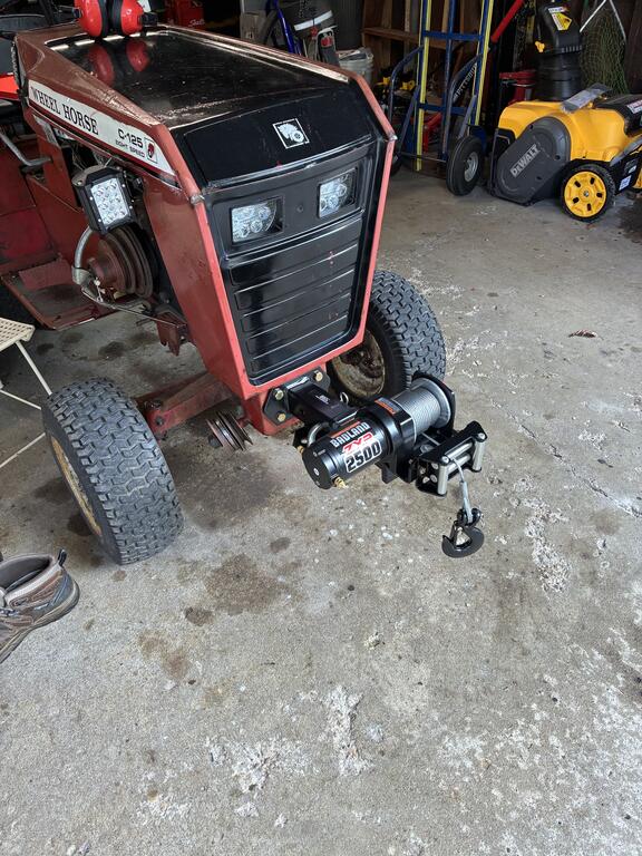

SylvanLakeWH 32,921 #31 Posted September 1, 2025 (edited) Today's progress: Added HF winch to the front end. Has both wireless and wired controls. I'm thinking wired with quick disconnect for this tractor and using the wireless controller as a remote safety "kill switch" for the A-60 when the Littles are driving... Thoughts? Edited September 1, 2025 by SylvanLakeWH 4 1 Share this post Link to post Share on other sites

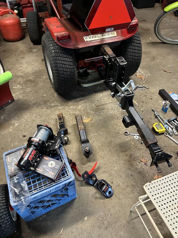

SylvanLakeWH 32,921 #33 Posted September 19, 2025 So I'm thinking... I want to add or have ability to add: Single bottom plow york rake back blade I'm looking at a sleeve hitch adapter for the 2" hitch that pivots, allowing adjustment up and down. Would utilize the winch mounted above to move implement up/down. Thoughts? 3 Share this post Link to post Share on other sites

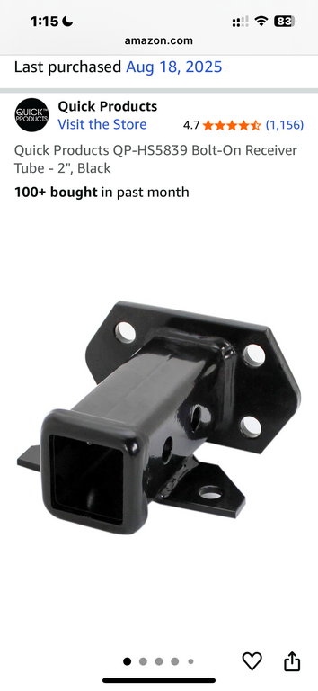

WHX?? 58,388 #34 Posted September 20, 2025 (edited) 1 hour ago, SylvanLakeWH said: I want to add or have ability to hitch a ride with The Pullstart and come to WHX's plow day and give er hell. There ... fixed that ... What was your source on that receiver that mounted to the muley? That winch is t's on a ritz too. Did it come on the receiver mount? I could use one of those for a sxs ... ?? HF?? Edited September 20, 2025 by WHX?? 2 1 1 Share this post Link to post Share on other sites
kpinnc 19,107 #35 Posted September 20, 2025 2 hours ago, SylvanLakeWH said: Thoughts? We like any fabrication project! Take care to keep the "pull point" just below the rear axle. This will help keep the front wheels on the ground under load. There is a reason the hitch pin is so low on the transmission. Any higher would make the front jump anytime you pull more static load than the weight of the tractor. 2 1 Share this post Link to post Share on other sites
SylvanLakeWH 32,921 #36 Posted September 20, 2025 5 hours ago, WHX?? said: There ... fixed that ... What was your source on that receiver that mounted to the muley? That winch is t's on a ritz too. Did it come on the receiver mount? I could use one of those for a sxs ... ?? HF?? Amazon for the front mount. HF for both winch and plate. 1 1 Share this post Link to post Share on other sites
SylvanLakeWH 32,921 #37 Posted September 20, 2025 3 hours ago, kpinnc said: We like any fabrication project! Take care to keep the "pull point" just below the rear axle. This will help keep the front wheels on the ground under load. There is a reason the hitch pin is so low on the transmission. Any higher would make the front jump anytime you pull more static load than the weight of the tractor. Thx! Yes if I pull this off I will need to drop the tow point several inches... appreciate the advice!!! 3 Share this post Link to post Share on other sites

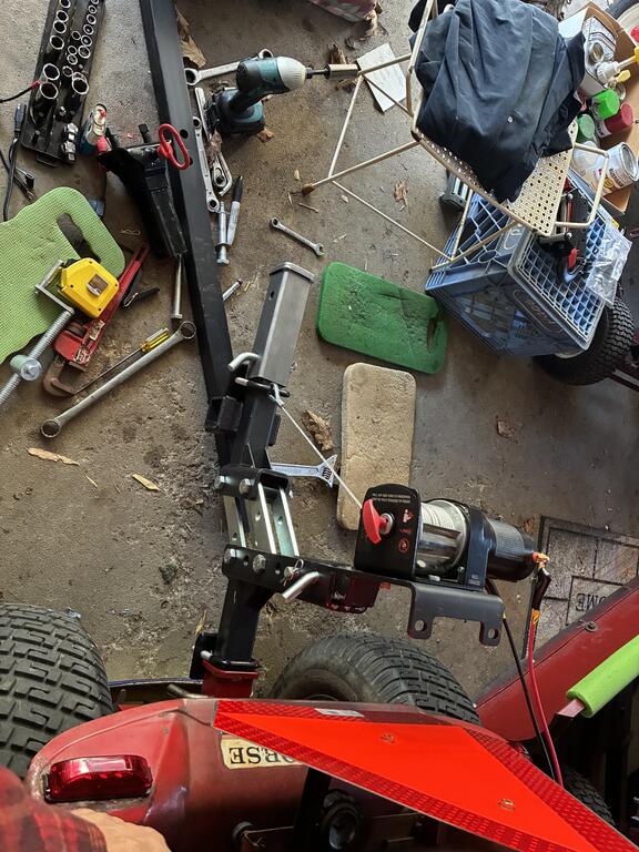

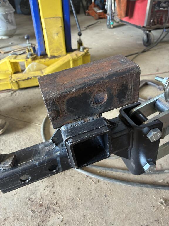

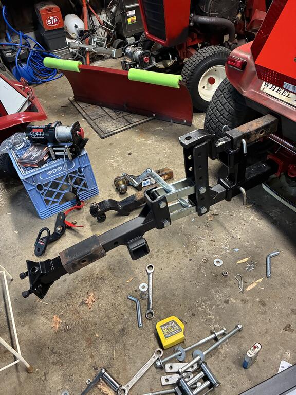

SylvanLakeWH 32,921 #38 Posted October 3, 2025 Progress on rear lift hitch to accommodate back blade, York rake and single bottom plow... winch will replace the screw handle lift... 2 2 1 Share this post Link to post Share on other sites

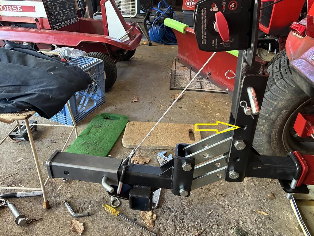

SylvanLakeWH 32,921 #39 Posted October 10, 2025 (edited) More work on the rear lift today. Proof of concept works. Need a dead stop at bottom and top. Any thoughts welcome. @Pullstart @Achto @WHX?? @ebinmaine @kpinnc Idea is to accommodate back blade, York rake, dethatcher and single bottom plow. Oh, and have winch available for other uses... Pins on / off easy peasy... IMG_3616.mov IMG_3616.mov Edited October 10, 2025 by SylvanLakeWH Share this post Link to post Share on other sites
Pullstart 71,561 #40 Posted October 10, 2025 Ope! We got a bind! 27 minutes ago, SylvanLakeWH said: Need a dead stop at bottom The plow geometry should do that for you. No need to add one. 2 1 Share this post Link to post Share on other sites
SylvanLakeWH 32,921 #41 Posted October 10, 2025 22 minutes ago, Pullstart said: The plow geometry should do that for you. No need to add one. Ok Kinda stopped now until I get the implements... I'll work on wire and controller routing... So, with each implement there is likely to be a different dead bottom... I'll just need to determine that with each implement and set it up... May bring the tractor with me when I pick up my goodies in a couple weeks... utilize your expertise in setting things up... 3 Share this post Link to post Share on other sites
Achto 32,963 #42 Posted October 10, 2025 1 hour ago, SylvanLakeWH said: Need a dead stop at bottom and top. No need for a bottom stop. A pin through this hole would make a top stop. 1 1 Share this post Link to post Share on other sites

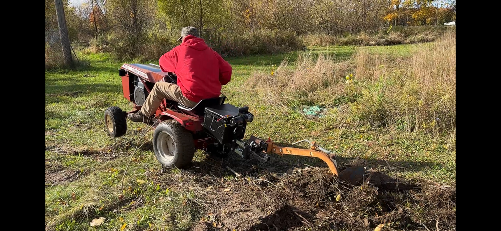

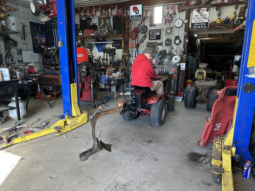

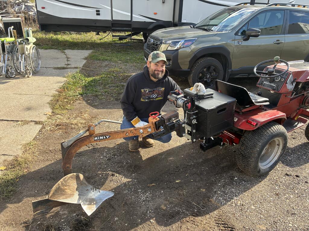

SylvanLakeWH 32,921 #43 Posted October 24, 2025 (edited) Spent a few hours at @Pullstart acres getting some needed plow advice, fitment and other worldly advice... New to me Brinly plow, imported by Pullstart from @WHX??'s Wisconsin compound (thx Jim!). Hitch customized by me initially, with welding assist by Kevin... Hitch now functions for a back blade, York rake and the Brinly. Some fine tuning remains, and gonna need a bunch of weight up front , but I'm very pleased with how it turned out... Great Mexican place in town for lunch!!! IMG_3631.mov Edited October 24, 2025 by SylvanLakeWH 2 1 1 Share this post Link to post Share on other sites
Pullstart 71,561 #44 Posted October 25, 2025 You didn’t capture the moment that the weld slag got in my ear hole?!?!? Sylvia learned how fast I can move if I need to! 2 Share this post Link to post Share on other sites
SylvanLakeWH 32,921 #45 Posted October 25, 2025 7 hours ago, Pullstart said: You didn’t capture the moment that the weld slag got in my ear hole?!?!? Sylvia learned how fast I can move if I need to! Sorry, I was too busy looking for a fire extinguisher small enough to fit in your ear... You can move fast!!! 3 Share this post Link to post Share on other sites
953 nut 70,652 #46 Posted October 25, 2025 9 hours ago, Pullstart said: didn’t capture the moment that the weld slag got in my ear hole?!?!? That's the @Pullstart signature move, he can move even faster if the slag gets into his boot. 1 2 Share this post Link to post Share on other sites
SylvanLakeWH 32,921 #47 Posted October 25, 2025 2 minutes ago, 953 nut said: That's the @Pullstart signature move, he can move even faster if the slag gets into his OSHA Approved steel toed welding sandals... There, fixed it for ya... 1 1 1 Share this post Link to post Share on other sites
Pullstart 71,561 #48 Posted October 25, 2025 4 hours ago, 953 nut said: That's the @Pullstart signature move, he can move even faster if the slag gets into his boot. My feet are used to that, but my right ear has been a slag magnet lately! Maybe the plate in my head shifted or something! It’s quite a sensation to hear the singes of ear hairs running down the chute! 1 Share this post Link to post Share on other sites
