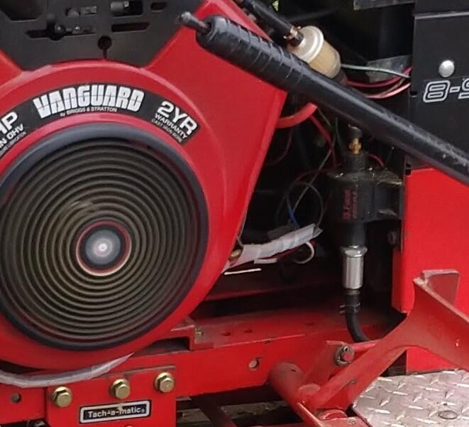

oldlineman 1,758 #4 Posted July 20, 2025 Not a twin but this is where I put mine holes already there! 6 Share this post Link to post Share on other sites
oldlineman 1,758 #5 Posted July 20, 2025 Have since replaced the fuse holder with a weather tight one, as recommended by members here. Bob 5 Share this post Link to post Share on other sites

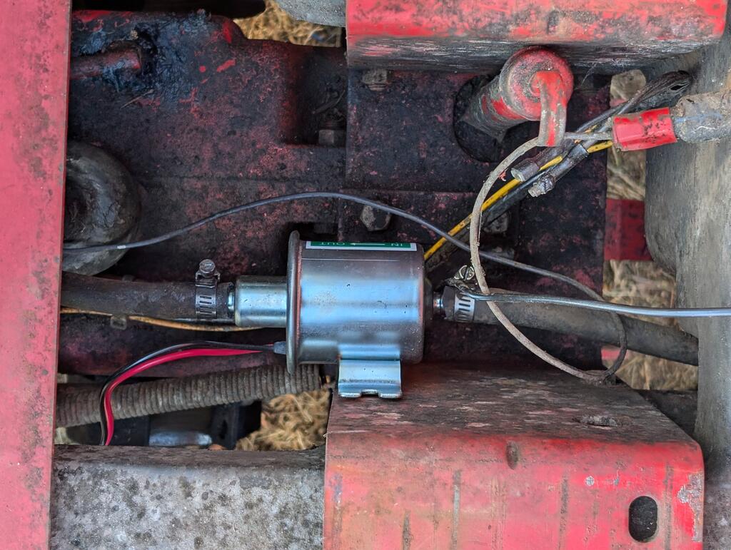

midpack 1,147 #10 Posted July 20, 2025 The last one I put in right under the seat pan, not sure if took a pic but I'll look 1 Share this post Link to post Share on other sites

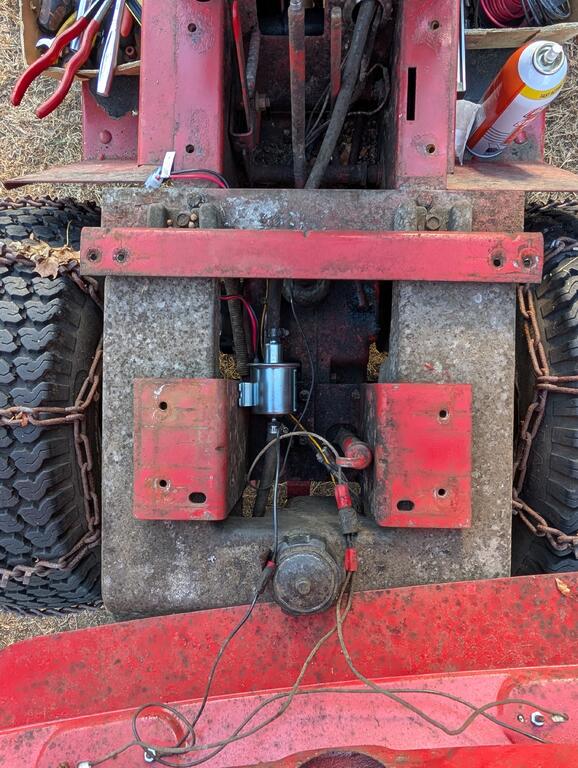

midpack 1,147 #11 Posted July 20, 2025 This is where I put it (excuse the mess, it's a worker) 4 Share this post Link to post Share on other sites
AHS 1,695 #12 Posted July 20, 2025 @midpack that’s alright! Aren’t Wheelhorses supposed to be workers? 1 1 Share this post Link to post Share on other sites
lynnmor 8,914 #13 Posted July 20, 2025 5 hours ago, midpack said: This is where I put it (excuse the mess, it's a worker) But that is where the rear lift goes. 1 Share this post Link to post Share on other sites
pfrederi 20,874 #14 Posted July 20, 2025 If you want a rock shaft that location will not work... But only 2 out of my 18-20 horses use the rock shaft...so that is where i put my pumps. 1 Share this post Link to post Share on other sites

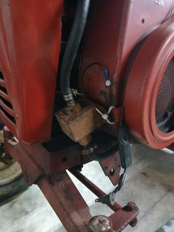

kpinnc 18,754 #16 Posted July 21, 2025 Both mine are like this: 1 Share this post Link to post Share on other sites
