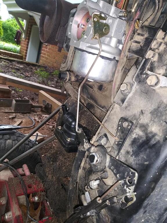

1517386815_ChokeAssembly.jpg.94ad6c87256cae094180832f46fae038.jpgI have a WH 300 series with a Kohler Magnum 10 engine and I cannot for the life of me figure out how to get the choke cable and linkage set so it will work. The numbers on the engine label  are worn off the, so I cannot give anyone that information. Does anyone have a picture or can you head me in the right direction.
My arm for the linkage assembly is set at 3 o'clock and 9 o'clock if that helps. There seems to be several different linkage rods for this engine.

Gcw804
Here you go. I had to replace the choke bar that the linkage attaches to, with a different one, as the air filter plate will hit the one on the new carburetor.

@ebinmaine it looks pretty close. With the exception being the linkage that goes from the cantilever to the choke being bent. both M12’s I have are straight. Maybe the M10’s are different.

That's the old K series carb style. The Magnum would have a back facing arm.

I'm thinking your K Series carb has a reversed pull on the choke arm in comparison to the later model Magnum engines.
The K pulls down from the front on that short arm vs the Magnum pulling down from the side closer to the engine block.
The Magnum also has a longer arm which of course would change the geometry.
wallfish
Yes the Magnum orientation for the choke is opposite of a K series.
Magnum have an additional lever in between which reverses the direction of the link connected to the choke lever.
Did that new carb come with an additional choke rod to swap out on the carb?
If that link from the lever to the carb is straightened then connected to the top hole in the choke it will work BUT opposite. As in the the choke will be on when the control lever is UP. And then in the open / run position when the control lever is down. But that type of choke lever on the carb may hit the air cleaner.
