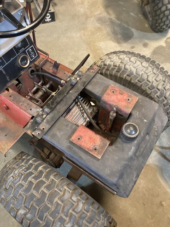

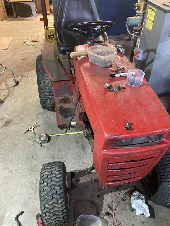

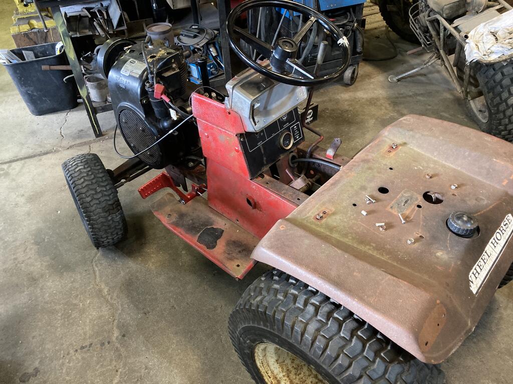

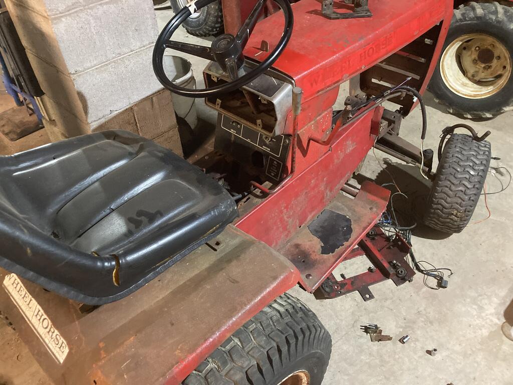

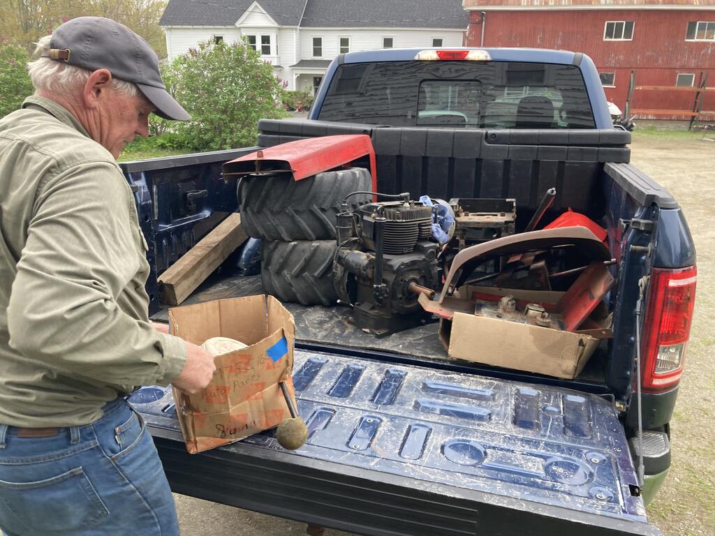

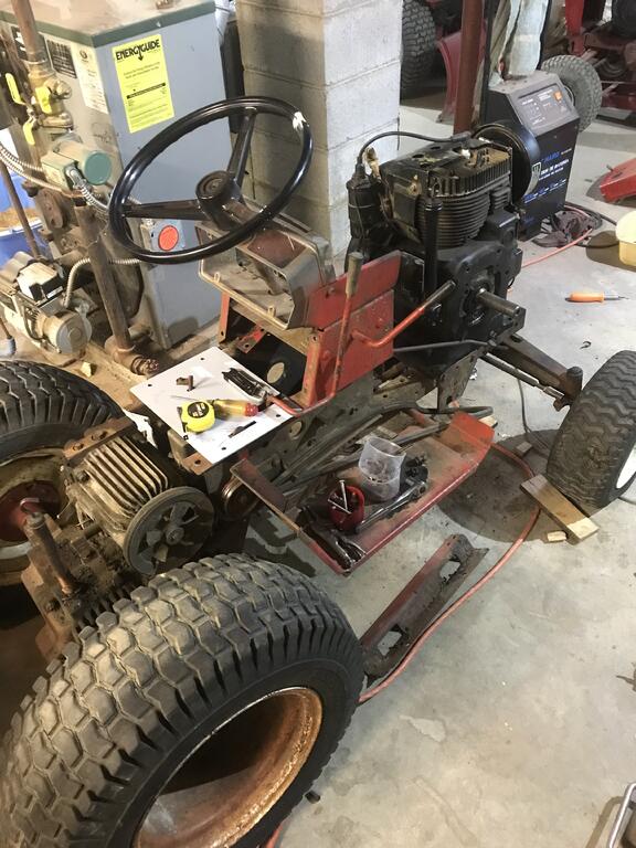

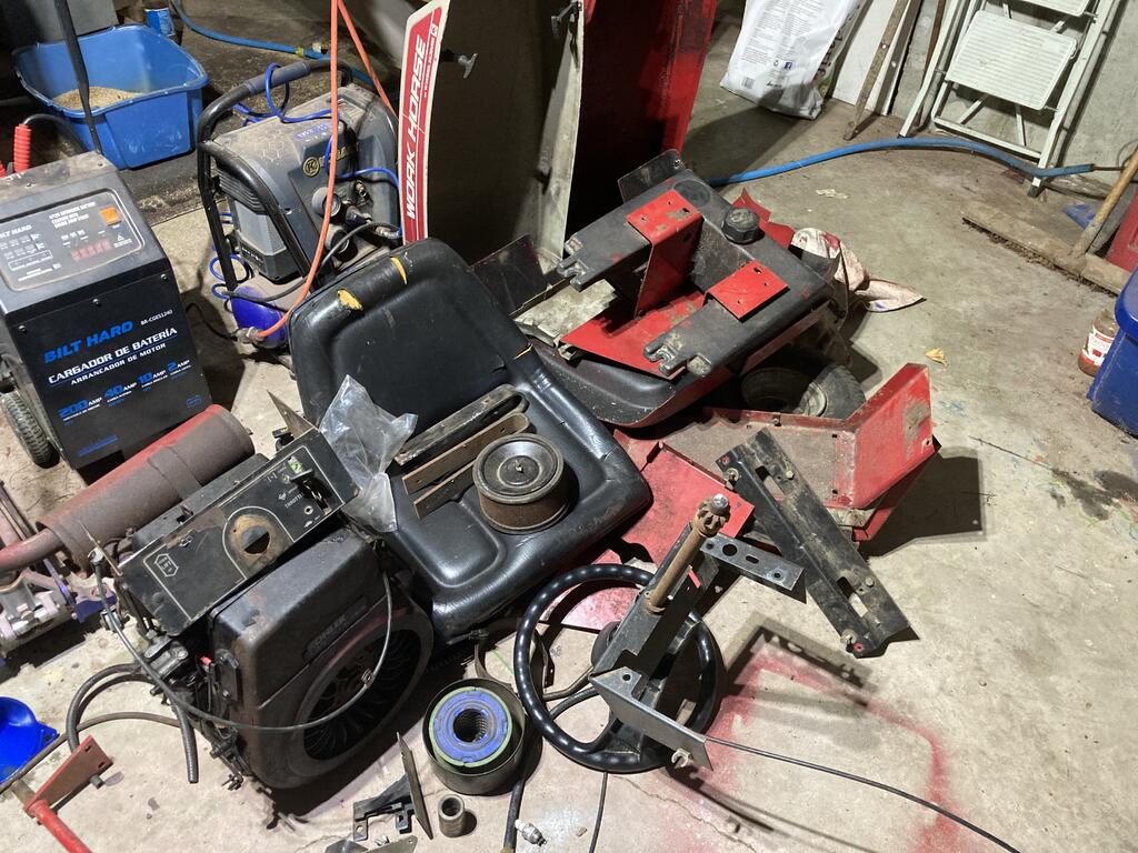

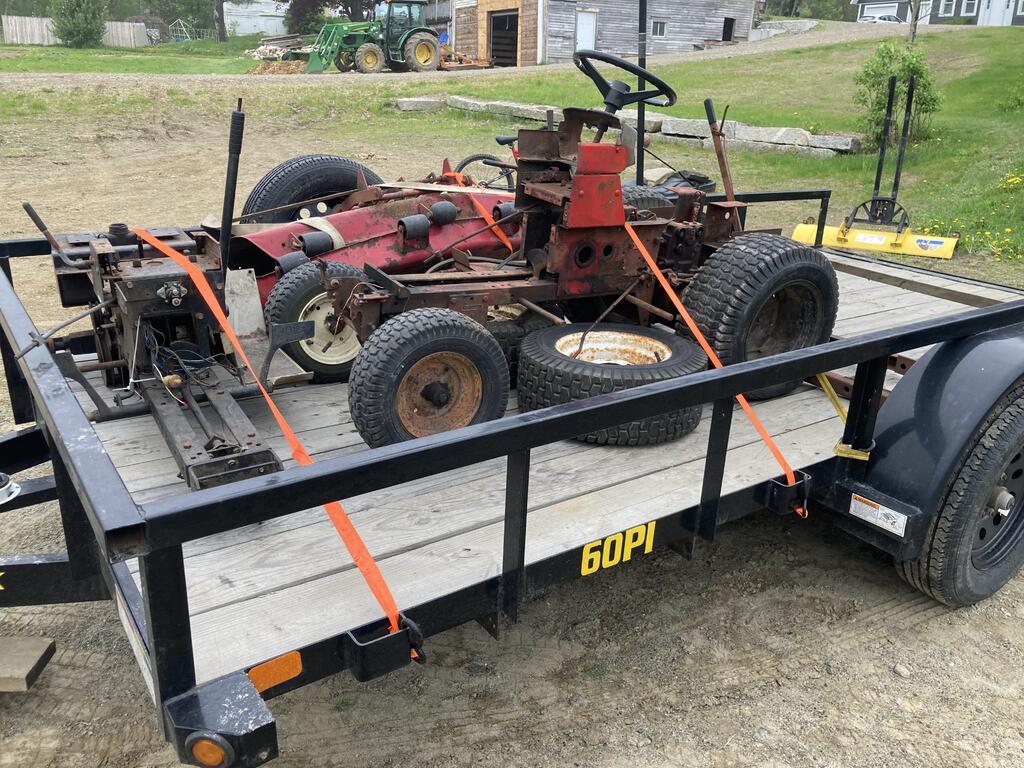

MainelyWheelhorse 2,796 #1 Posted June 11, 2025 (edited) Last November/ December I was talking to @ebinmaine about a hood and rear end for my 312. The rear end is making noises and sounded a bit like a train. The original hood on the 312 was mangled pretty good after rolling backwards down a pit wall. Apparently the story was the PO let a neighbor borrow it. then the accident happened. Anyway, we made a deal and I met up with EB in January. I took some smaller stuff home as we only had my Father’s truck. I had to come back later for the bigger stuff. This May, I borrowed my brother’s trailer, and my Father and I went to get the rest of the bigger parts. The parts haul ended up being, a 94/95 312-8 and a 80/90’s Workhorse parts machines, two mowing decks, a 14hp engine, two sets of rear tires, a plow, a few rear fender, and a bunch of miscellaneous parts. The biggest was a 1978 C141 Automatic parts tractor. I figured I’d try hydrostatic as all my other tractors are 8 speeds. Since the middle of May I’ve been tinkering here and there on the C141. I’m not done yet but I figured I’d document it. The first run. Home from @ebinmaine with the second run haul. Mocking it up. Edited June 19, 2025 by MainelyWheelhorse 7 Share this post Link to post Share on other sites

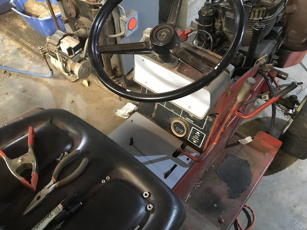

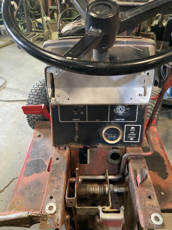

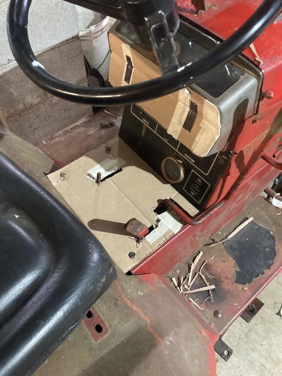

MainelyWheelhorse 2,796 #10 Posted June 19, 2025 Still putting things together and figuring out what I am going to do. C.A.D. (Cardboard Aided Design) at work. 1 Share this post Link to post Share on other sites

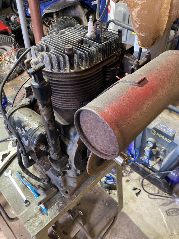

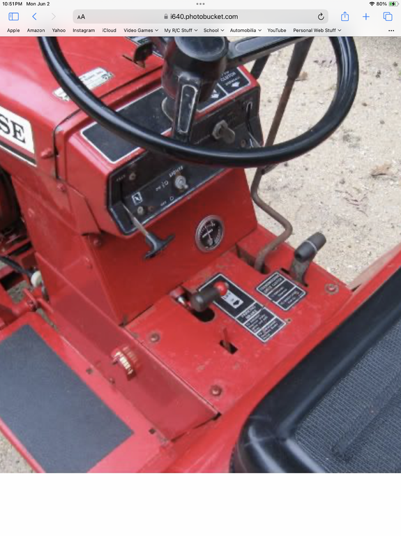

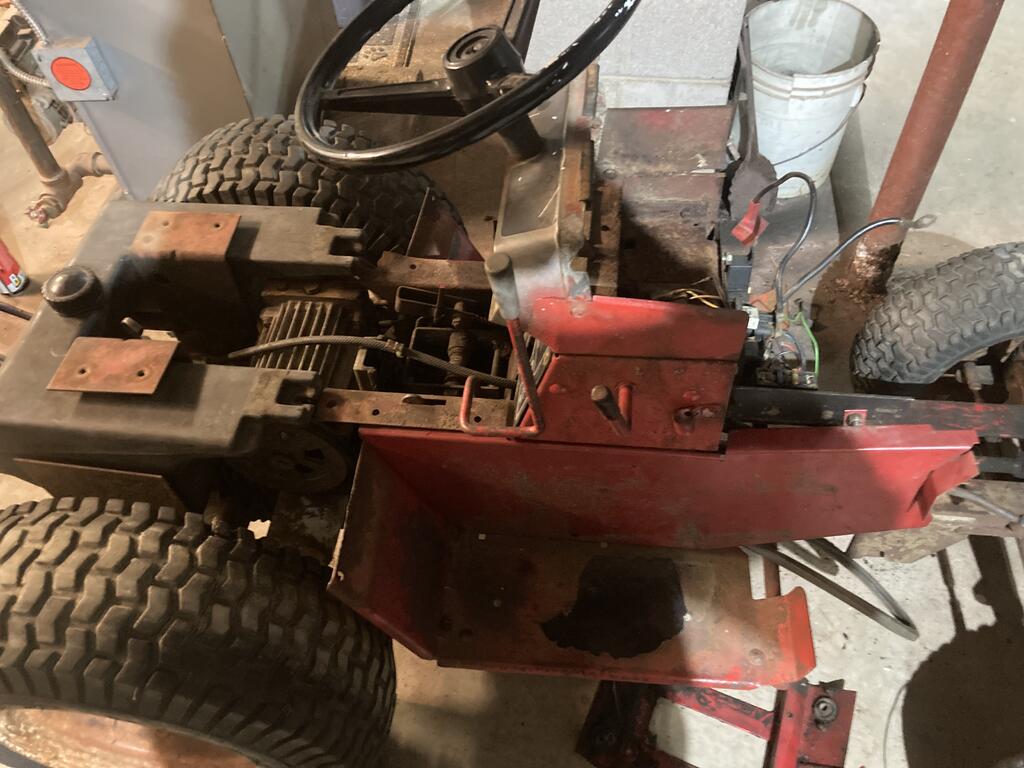

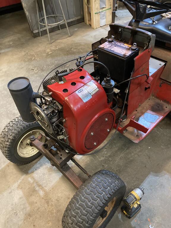

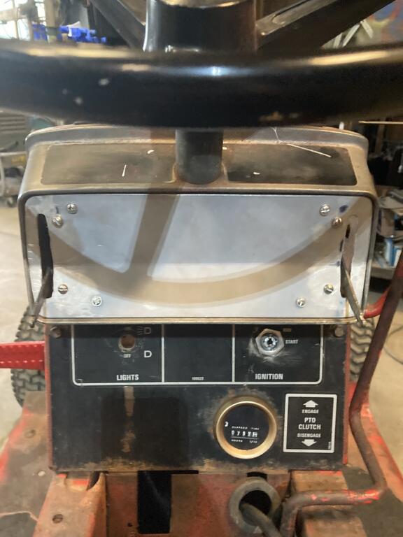

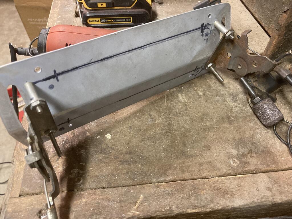

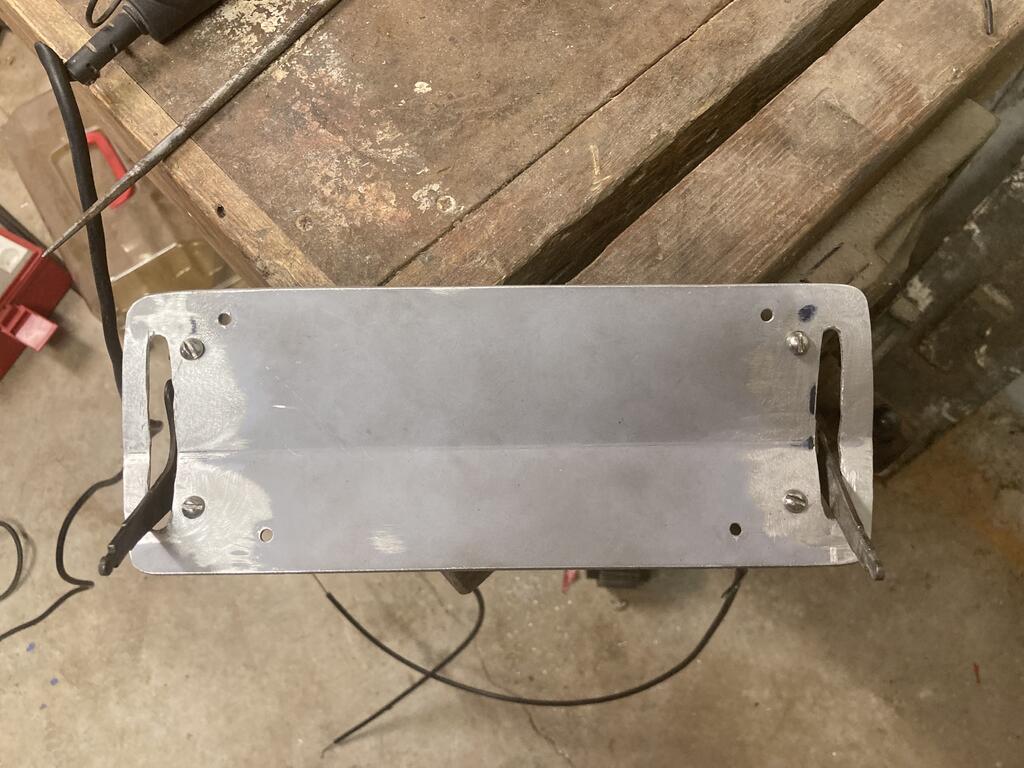

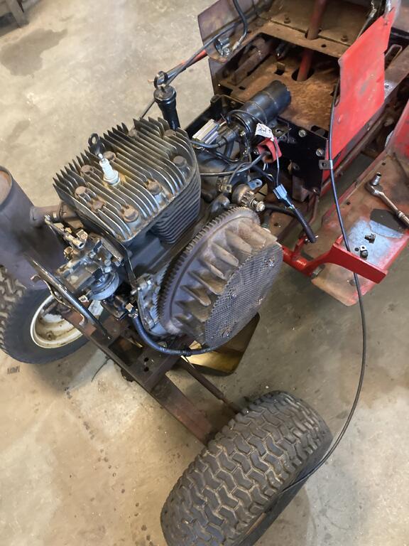

MainelyWheelhorse 2,796 #11 Posted June 19, 2025 (edited) Cutting and fitting. What I’m patterning my shift plate after. Progress…. with Aluminum... I also started to figure out wiring. I also secured the K321 engine down with two bolts through the frame like my 308 and 312. That took longer than expected. Edited June 19, 2025 by MainelyWheelhorse 1 Share this post Link to post Share on other sites

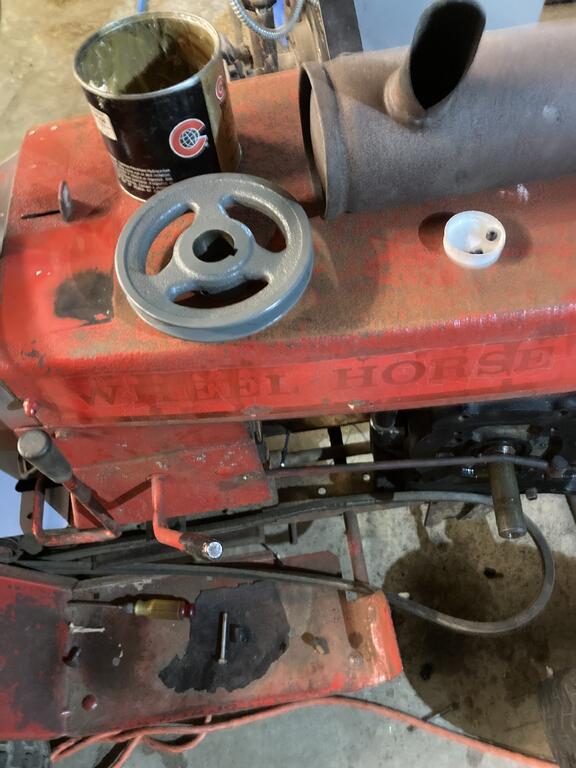

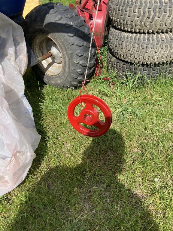

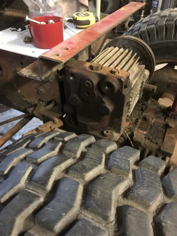

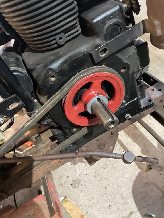

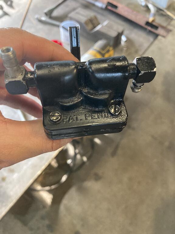

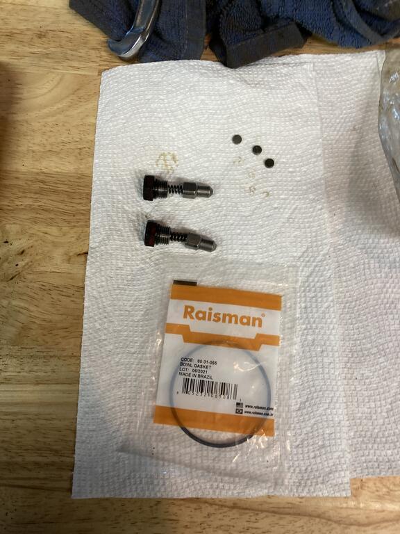

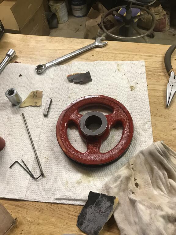

MainelyWheelhorse 2,796 #12 Posted June 19, 2025 (edited) As a bit of something different and while I was figuring out wiring, The Sundstrand pump needed plugs, springs. and cones These are it. @ebinmaine had them. As another small thing to do, I also had the correct size pulley bored out, then painted, and installed. Edited June 19, 2025 by MainelyWheelhorse 1 Share this post Link to post Share on other sites

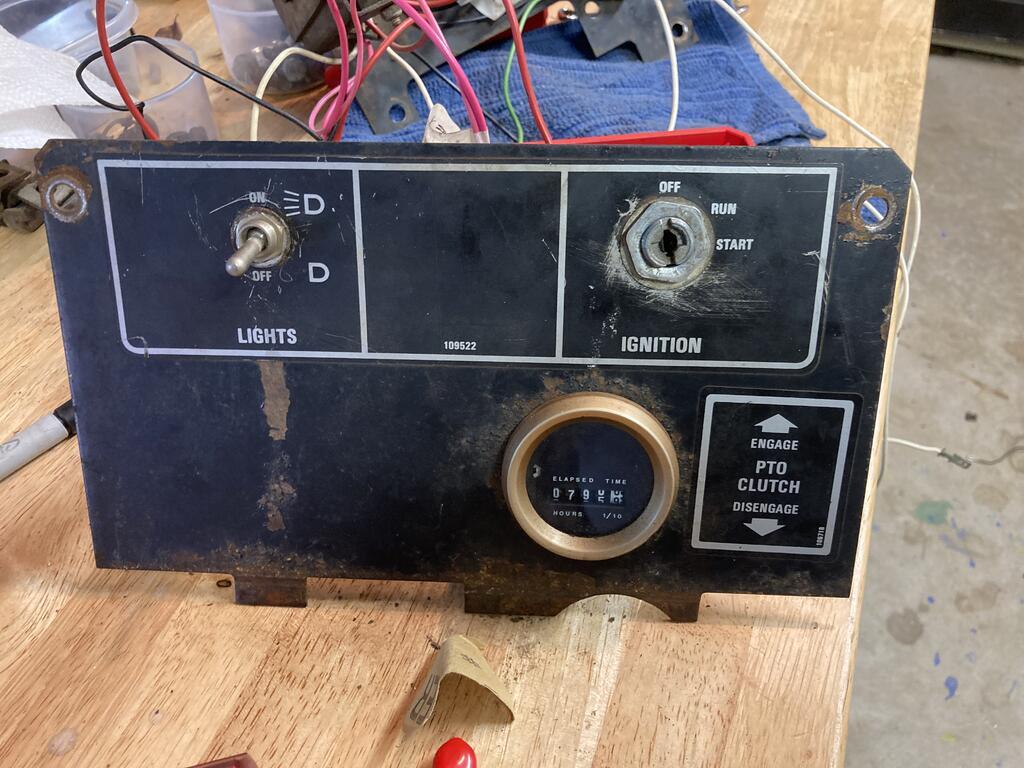

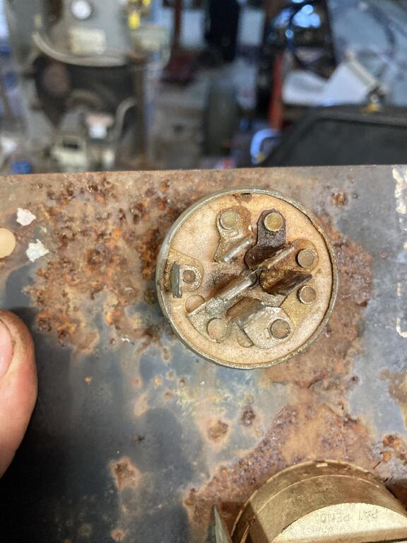

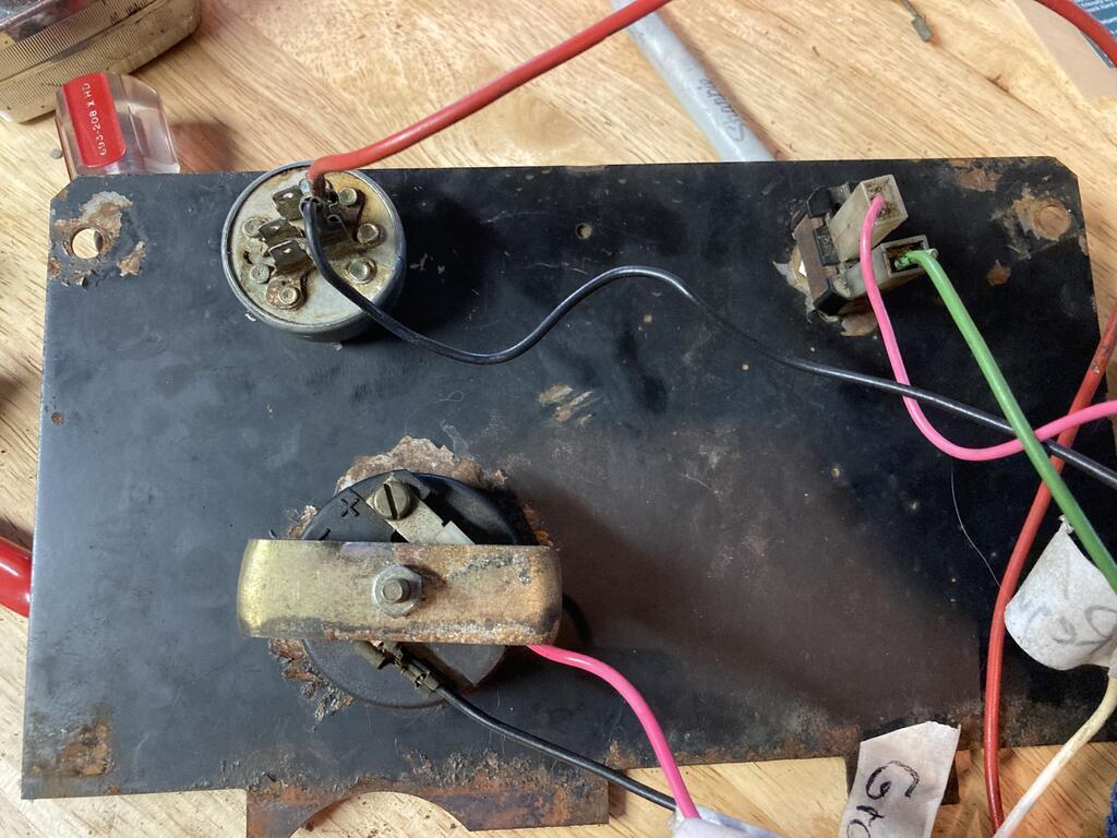

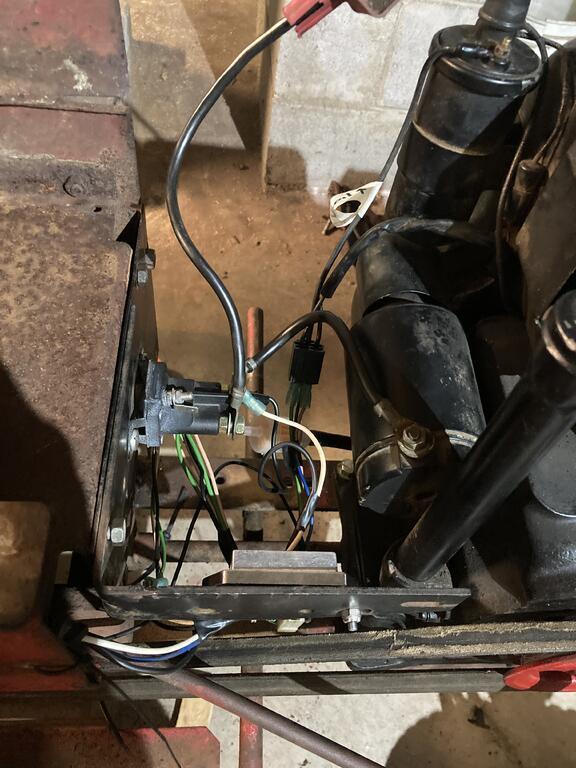

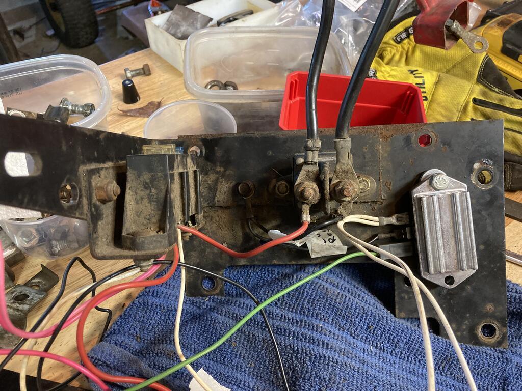

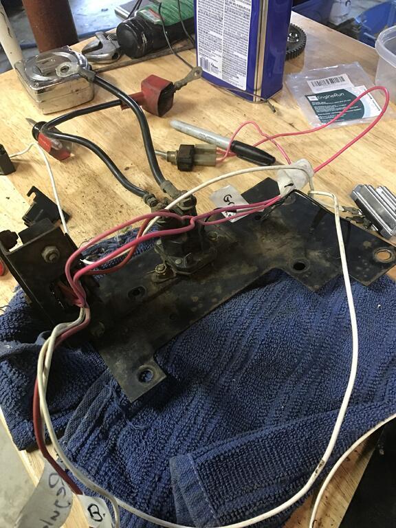

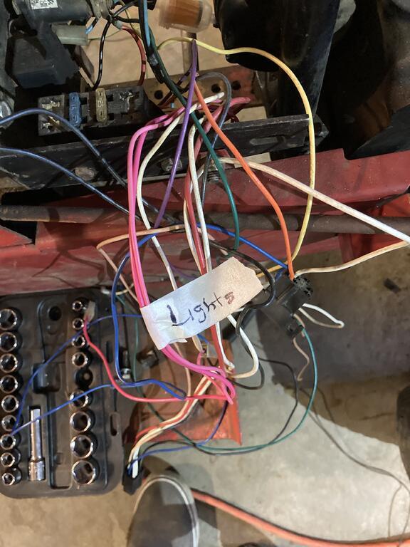

MainelyWheelhorse 2,796 #13 Posted June 19, 2025 (edited) Then came the monstrosity of wiring. I used a good chunk of a 94/95 312-8 wiring harness tailored to the K321's points ignition to wire the C-141 up to at least run for now I'll add in the extras later. Thanks to @953 nut, @pfrederi and @ebinmaine for the guidance on it it was a learning experience. Edited June 19, 2025 by MainelyWheelhorse 1 Share this post Link to post Share on other sites

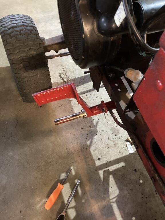

MainelyWheelhorse 2,796 #14 Posted June 19, 2025 While I had the grease and paint out, I ground the CLUTCH lettering off, painted and installed the brake pedal. 1 Share this post Link to post Share on other sites

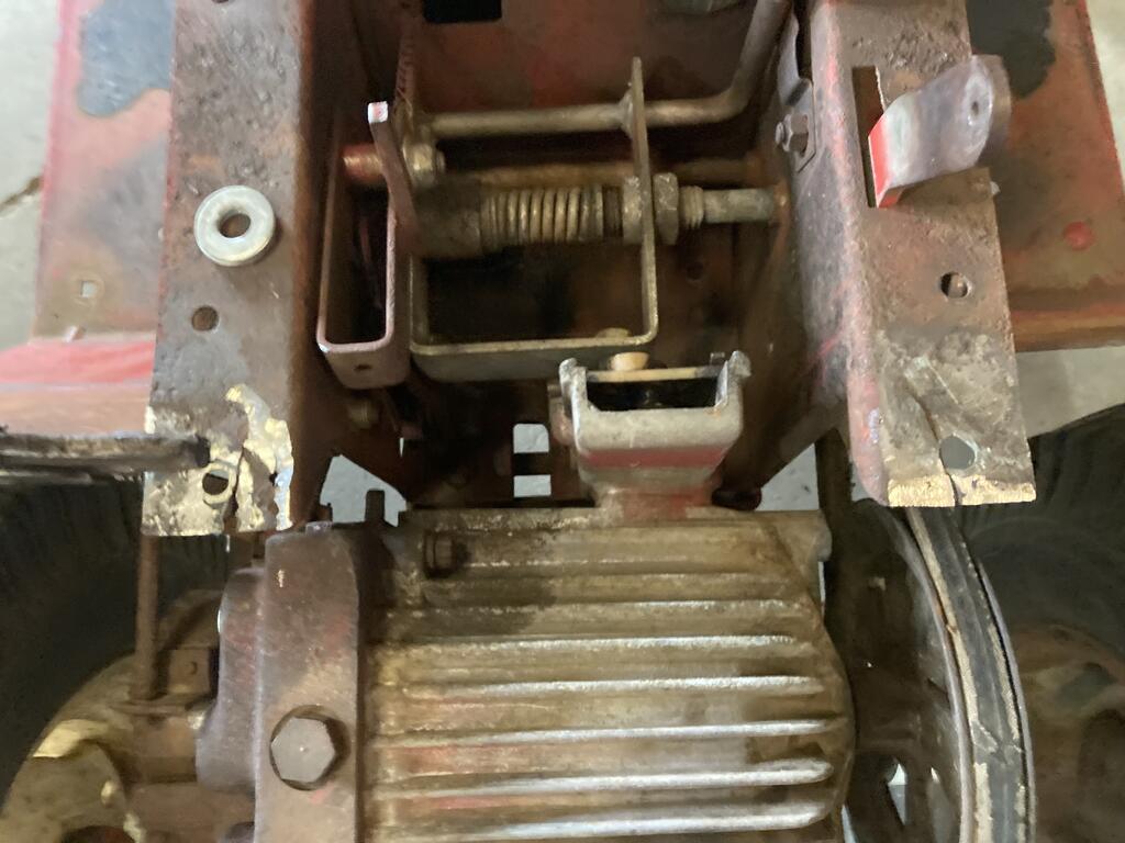

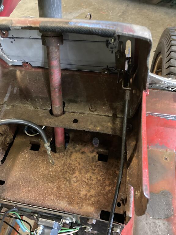

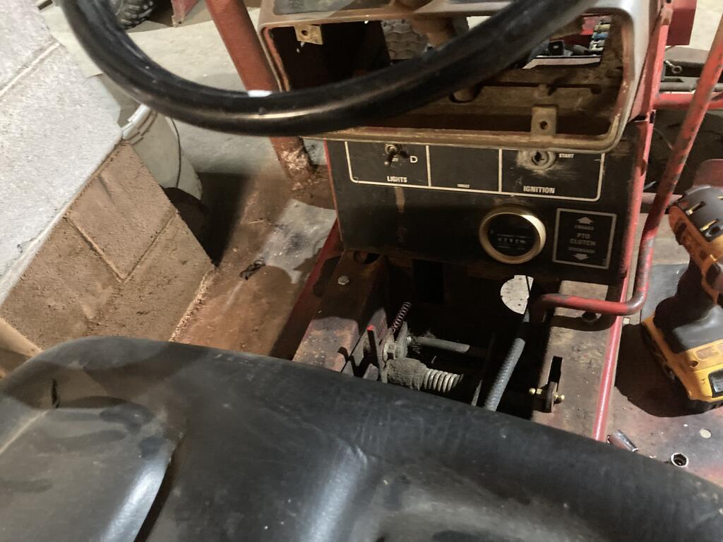

MainelyWheelhorse 2,796 #15 Posted June 19, 2025 (edited) At this point I started fitting, and grinding the slots for the throttle and choke. The ends of the frame were prepared to be welded as they had cracked and broken off. Once the frame was welded it was assembly time. Edited June 19, 2025 by MainelyWheelhorse 2 Share this post Link to post Share on other sites
MainelyWheelhorse 2,796 #16 Posted June 19, 2025 While waiting for the frame to be welded. I worked on the throttle and choke slots the upper dash. Just primer, paint and fine tuning left. This is where I stopped on my last free day. 3 Share this post Link to post Share on other sites

ebinmaine 79,503 #18 Posted June 19, 2025 6 hours ago, MainelyWheelhorse said: I also secured the K321 engine down with two bolts through the frame like my 308 and 312 These engines have four bolts. Two you can see. Two you can't. There are two that go up through the bottom of the frame into the engine base. Look at your 312 to see them. Then duplicate them to the 14. 1 Share this post Link to post Share on other sites
MainelyWheelhorse 2,796 #19 Posted June 19, 2025 9 hours ago, ebinmaine said: These engines have four bolts. Two you can see. Two you can't. There are two that go up through the bottom of the frame into the engine base. Look at your 312 to see them. Then duplicate them to the 14. Ok, I’ll check that out. 1 Share this post Link to post Share on other sites

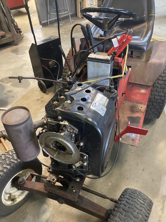

MainelyWheelhorse 2,796 #20 Posted June 19, 2025 More progress today, I got the fender on with a bit of massaging from a RUBBER BFH. I also got the choke on and working. I also checked out the fuel pump on the K321 and after cleaning it out it does pump. I’ll have to hook it back up to see how well. That’s where I stopped as of now. Getting closer…. The fuel pump in question…. 2 Share this post Link to post Share on other sites

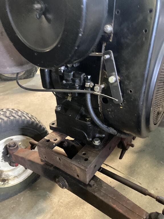

MainelyWheelhorse 2,796 #21 Posted June 27, 2025 Today’s update.., for the C-141, I built the cantilever and rod for the throttle. Then attached and fished the throttle cable and choke by the engine. the starter turns if you jump the solenoid, The battery in it is weak. I’m going to swap the battery tomorrow for the one in the 308 and see what happens. BUT…No magic smoke so at least there’s that.😁 2 Share this post Link to post Share on other sites

MainelyWheelhorse 2,796 #23 Posted July 11, 2025 (edited) After some electrical education and troubleshooting, it was ready for a test fire. During the test fire the engine smoked a bit through the shroud. After a thorough investigation, must have been trash on the stator. Nothing else had burnt. In the interim, I painted the shroud IH Red, and painted the exhaust BBQ black. reassembling the sheetmetal on the engine after the paint dried. I also started attaching the body panels and buttoning things up. Edited July 11, 2025 by MainelyWheelhorse 1 Share this post Link to post Share on other sites
