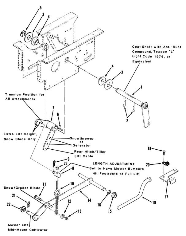

Retired Wrencher 6,902 #4 Posted June 4, 2025 (edited) @Wheelhorse4me There should be a manual for that. I am sure some one will chime in to help. Not my area of expertise. Enjoy the site . Much help and manuals to look at. Thanks Garry for the diagram. Edited June 4, 2025 by Retired Wrencher Share this post Link to post Share on other sites

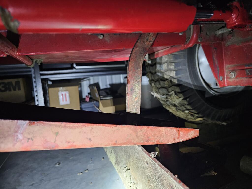

squonk 47,731 #6 Posted June 4, 2025 (edited) 7 hours ago, Wheelhorse4me said: I'm installed a belly grader on a new to me 418C. I thought I had the arm installed correctly, but it does not go up and down. I have one end of arm connected to the grader. The other end is on the right arm of the rocker shaft (1st hole). Any help would be appreciated. Turn the arm around so the bend goes forward Edited June 4, 2025 by squonk 3 1 Share this post Link to post Share on other sites
peter lena 9,993 #7 Posted June 4, 2025 @Wheelhorse4me , often refer to OPPORTUNIC AREAS AS A GOLD MINE , FOR FUNCTION , first was , lift arm reversal , the schematic drawing from @gwest_ca shows you all the regularly never serviced , bronze mounting movement points , penetrating oil makes the RUST RUN OUT , then a red aerosol spray grease , extension tube , for functional verification of movement ease . lower dash face and shifter plate , removal is very easy . typically anything I see is frozen in rust , usually a rusty related trail , how about cables that don't move ? have spring assist on mine , smooth / easy. pete Share this post Link to post Share on other sites

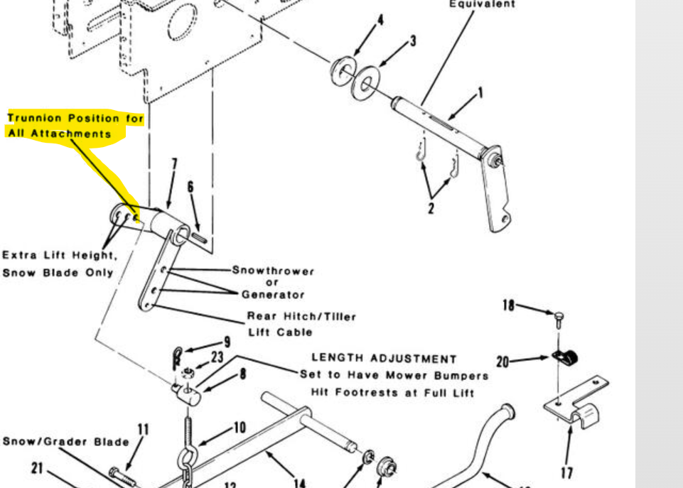

Wheelhorse4me 4 #8 Posted June 4, 2025 Thanks to everyone for your input thus far. @squonk Thank you! The picture tells the story. I wondered if I had the arm turned the wrong way... @peter lena do you have a photo of the spring assist? I'm curious what size spring and how/where it is attached. I was told by someone with a lot of experience to use the first rocker shaft hole highlighted in the drawing below. Thoughts? Share this post Link to post Share on other sites
gwest_ca-(File Mod) 12,416 #9 Posted June 4, 2025 The closer to the pivot point of the shaft you are the more leverage you have. You can go farther out but will get heavier to lift. 1 Share this post Link to post Share on other sites
squonk 47,731 #10 Posted June 4, 2025 Those blades are pretty light but use that hole closest to the center. 1 Share this post Link to post Share on other sites
Wheelhorse4me 4 #11 Posted June 4, 2025 You are right, the grader blade is light so I will use the hole closest to the rocker shaft. Lifting the grader blade is one thing. However, downforce is required to make the blade work, right? Thanks everyone for your input! 1 Share this post Link to post Share on other sites
