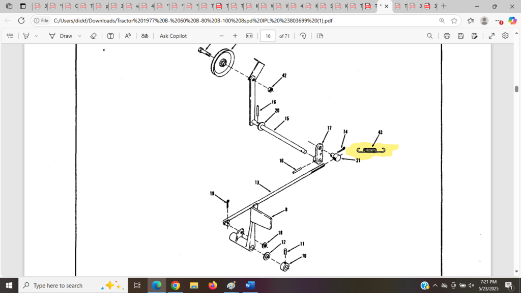

953 nut 69,345 #5 Posted May 23, 2025 Lowell @wheelhorseman has the spring for $ 12.00 plus shipping. https://wheelhorsepartsandmore.com/product/1014-spring-for-wheel-horse/ 4 Share this post Link to post Share on other sites
TC10284 121 #6 Posted May 23, 2025 Is it just the spring I need, or do I have to make any modifications or have other parts for the spring to attach, or just use the existing holes? 1 Share this post Link to post Share on other sites

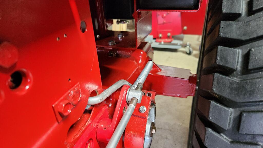

953 nut 69,345 #7 Posted May 23, 2025 Spring attaches to the eye of the cotter key on the clutch linkage and the other end connects to the little ear on the rear axle. 4 Share this post Link to post Share on other sites

953 nut 69,345 #10 Posted May 24, 2025 11 hours ago, JoeM said: if you eliminate the dampener shock, there is less control with the clutch engagement Don't have to remove the shock, just add the spring so the clutch will tension the belt better. 2 Share this post Link to post Share on other sites
Racinbob 13,193 #11 Posted May 24, 2025 (edited) 17 hours ago, TC10284 said: Is it just the spring I need, or do I have to make any modifications or have other parts for the spring to attach, or just use the existing holes? Just the spring. Holes are there and no other parts needed. Do a search on the Flea for 108035. These tractors have worked fine for decades with just that spring and they still do. Edited May 24, 2025 by Racinbob 4 Share this post Link to post Share on other sites
