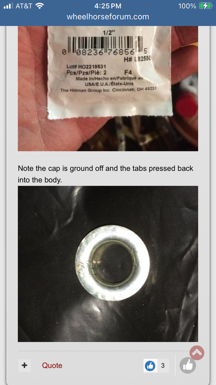

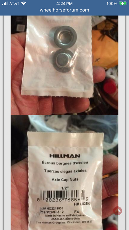

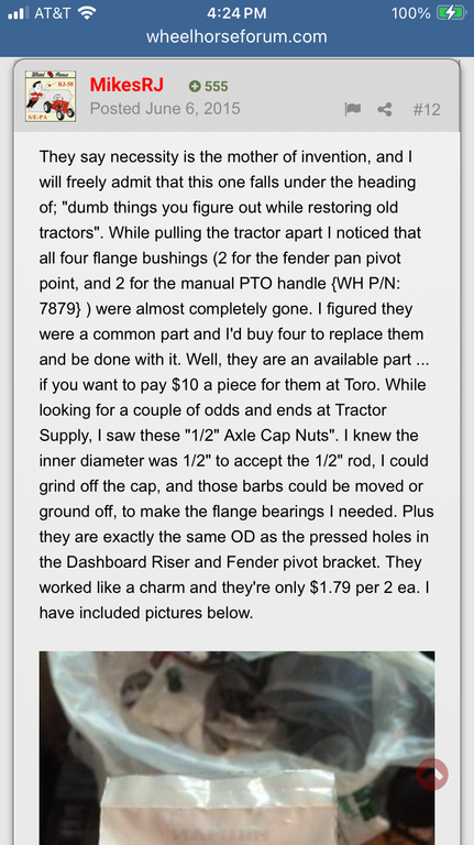

Moohampshire 11 #6 Posted May 20, 2025 DCklarke: Went to Ace hardware and got a 1/2 axle cap and group off bottom and then did some grinding to get off tabs and it worked great. Cost $1.19. This forum is great. 1 1 Share this post Link to post Share on other sites
dclarke 4,117 #7 Posted May 20, 2025 2 hours ago, Moohampshire said: DCklarke: Went to Ace hardware and got a 1/2 axle cap and group off bottom and then did some grinding to get off tabs and it worked great. Cost $1.19. This forum is great. Glad it worked out. @MikesRJ came up with that idea and shared it. Thanks, Mike! Share this post Link to post Share on other sites
