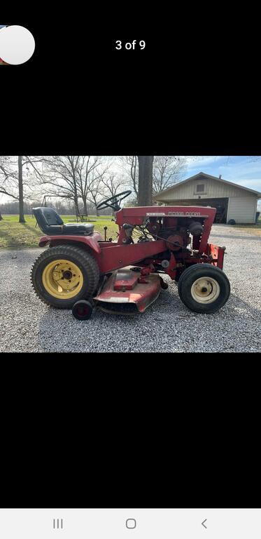

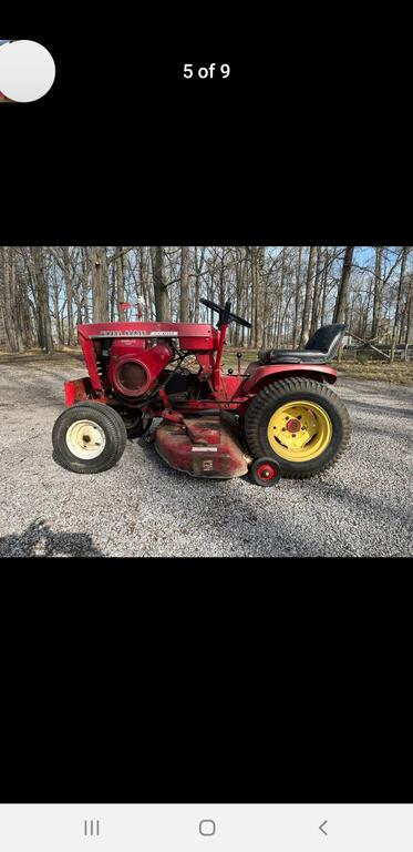

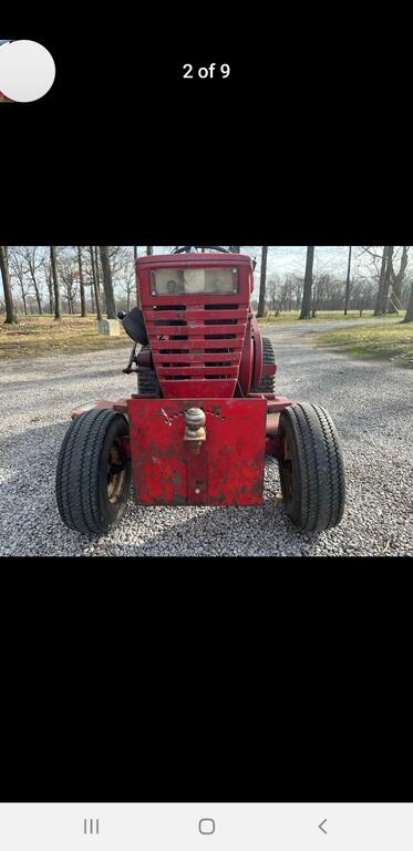

Espiritus 7 #1 Posted May 15, 2025 Hi, all. I tinker alittle but my age is starting to slow me down. I've been wanting to leave John Deere behind as I've decided I've been more faithful to him than he to I. I only mow about three acres, and occasionally pull a trailer around to dump barn clean out compose. I found a 1267 not too far from me with a disc, plow & mower. Everything is original. They say it was the sellers' grandfathers' machine, always barn kept. I tend to believe them. They said everything works. It's too far for me to casually go look. My one concern from the photos is it appears to toe out. I need to know how big of a problem this is. Also, are parts for these still available or do people buy "parts machines" to scavenge? 3 Share this post Link to post Share on other sites
Pullstart 71,561 #2 Posted May 15, 2025 That front attachment is not original, but looks fun. I would be Leary of the front axle/spindles being worn. Longer or adjustable tie rods are an option, but not likely the fix. 1 Share this post Link to post Share on other sites
Espiritus 7 #3 Posted May 15, 2025 10 minutes ago, Pullstart said: That front attachment is not original, but looks fun. I would be Leary of the front axle/spindles being worn. Longer or adjustable tie rods are an option, but not likely the fix. I can remove this as I have no need for a bumper hitch! My concern is the toeing out. I doubt if they'll pull a tire so I can see the extent of wallowing. Can I assume there's bushings & bearings and there's replacement parts available? It just occurred to me that I have no idea what kind of steering mechanism is in these. Share this post Link to post Share on other sites

ebinmaine 81,282 #6 Posted May 15, 2025 1 hour ago, Espiritus said: are parts for these still available or do people buy "parts machines" to scavenge? Both. Here on Redsquare we have several great vendors. Also some of us keep our own Parts Departments. Don't be the least bit concerned about parts availability. The tow out IS repairable. How... is the question. Could be tie rods. Could be spindles. Could even be a worn axle or wheel hub. All repairable. Also. That picture MAY be misleading. The aspect angle may be misconstruing or exaggerating an issue. 1 Share this post Link to post Share on other sites

WHX?? 58,388 #13 Posted May 16, 2025 (edited) 6 hours ago, ebinmaine said: Don't be the least bit concerned about parts availability In fact EB & 953 nut nailed it all. One word of warning tho they all look better in pictures. Many times I have went to score and the the tractor had some serious deficiencies but looked good in pictures. A real downer especially when some travel time & gas money is in play. Only thing a guy can do is work on the selling price if not as advertised. The thing that would worry me is the front hitch. It possibly says farmer welding with other possible molestation & cobblements. Rims another one. My guess is the hitch monkey business was also used as a push bumper. Might explain the missing headlight lens and the toe out. The deck belt tensioner has also been altered. Trouble is one cannot tell just from pictures. Unlike others here I am a true orginal freak and make no apologies for being one. Not trying to burst your bubble, especially when trying to convert you from the dark side, just my On the other hand I picked up a orginal unmolested 1267 for @Mike'sHorseBarn and it was indeed as good as pics suggested. Edited May 16, 2025 by WHX?? 2 Share this post Link to post Share on other sites

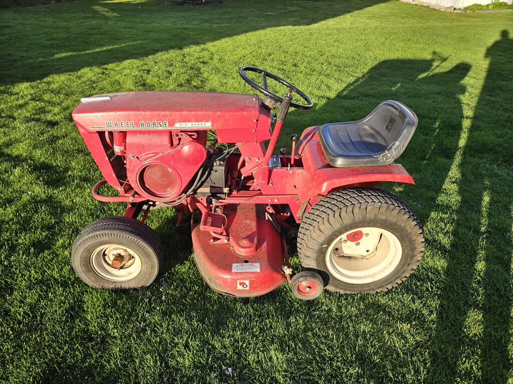

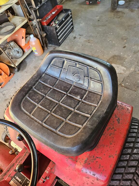

Mike'sHorseBarn 3,712 #16 Posted May 16, 2025 Hey nice 1267! As jim said he rescued one for me last spring and mine has a pristine original seat to boot! Don't be concerned at all about parts availability, we wheel horse nuts keep our own hoards and swap the stuff around quite often lol 1 Share this post Link to post Share on other sites

Handy Don 17,735 #19 Posted May 16, 2025 Yep, from the pictures, that is a nice looking unit. @ebinmaine and @953 nut have good points. A wide-angle lens used close to the subject can distort the heck out of the image. If you can get the seller to shoot from 20’ away and then use the camera’s zoom to tighten the shot you’ll get a much better idea of the alignment. If there is heavy wear on the axle and spindles, fear not, replacements are readily available. My sense, though, is that there is only a little toe-out (most likely the due to tied rod end wear) being camera exaggerated. IMHO new adjustable tie rods are a worthwhile, and modest, investment--they relieve anxiety and let you dial in exactly the alignment you want. Share this post Link to post Share on other sites
