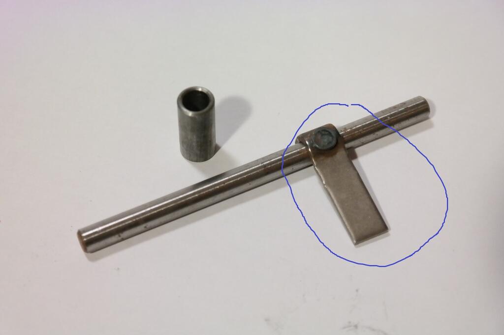

squonk 48,207 #2 Posted May 15, 2025 I think we need a video of the governor shaft movement. I'm thinking either it's still out of adjustment or that tab on the Governor shaft (which I have seen a lot of) is broken. Share this post Link to post Share on other sites

1968Commando 189 #4 Posted May 15, 2025 3 hours ago, squonk said: I think we need a video of the governor shaft movement. I'm thinking either it's still out of adjustment or that tab on the Governor shaft (which I have seen a lot of) is broken. Well it turns and stops so I assume it’s still there correct or could it be jammed in there? Share this post Link to post Share on other sites

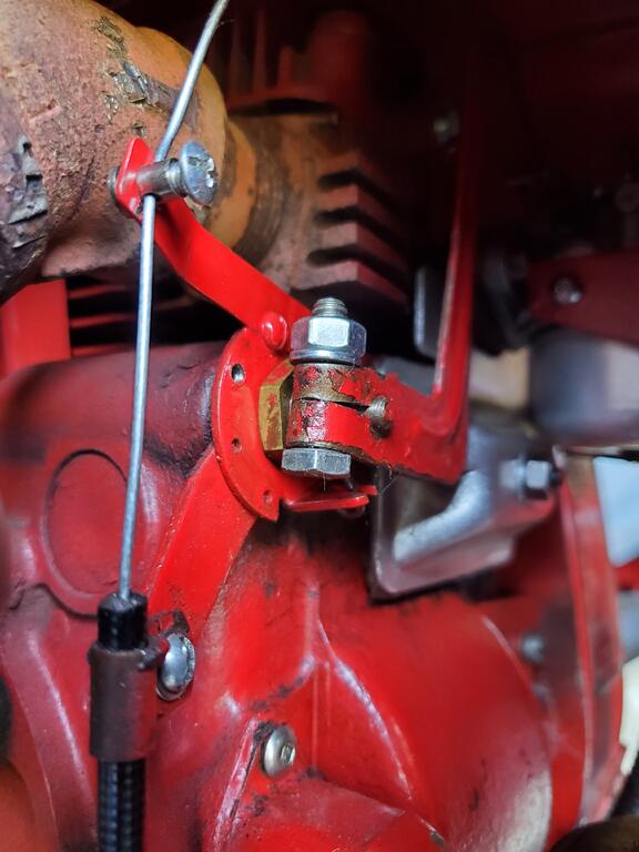

Racinbob 13,210 #10 Posted May 16, 2025 Throttle response throw on every small block K I've had has received this modification. I've posted this picture numerous times. Assuming you have the governor properly adjusted and everything is connected correctly this will do wonders for the tiny throw. Share this post Link to post Share on other sites
1968Commando 189 #11 Posted May 16, 2025 3 hours ago, Racinbob said: Throttle response throw on every small block K I've had has received this modification. I've posted this picture numerous times. Assuming you have the governor properly adjusted and everything is connected correctly this will do wonders for the tiny throw. How did you attach that piece is it welded can I figure out someway to do this without a welder? Currently I have no arm and the wire connects right into the holes on the disc Share this post Link to post Share on other sites
1968Commando 189 #12 Posted May 16, 2025 3 hours ago, Racinbob said: Throttle response throw on every small block K I've had has received this modification. I've posted this picture numerous times. Assuming you have the governor properly adjusted and everything is connected correctly this will do wonders for the tiny throw. Last year when the throttle cable my uncle had on this tractor broke it was aftermarket because the original broke, I put a new push pull throttle on it and I honestly didn’t then read the manual I just hooked it back j the bolt that is on the governor arm that the spring goes into and I got way better throttle response then what I have now, should I go back to that or does that make the governor not work right? Share this post Link to post Share on other sites
Racinbob 13,210 #13 Posted May 16, 2025 52 minutes ago, 1968Commando said: How did you attach that piece is it welded can I figure out someway to do this without a welder? Currently I have no arm and the wire connects right into the holes on the disc I tapped two of the existing holes in the round disc. I don't remember if I used 6-32 or something a fuzz smaller. You have to be very aware of clearance. I ground some to clear the brass nut. Share this post Link to post Share on other sites

1968Commando 189 #15 Posted May 16, 2025 8 hours ago, Racinbob said: I tapped two of the existing holes in the round disc. I don't remember if I used 6-32 or something a fuzz smaller. You have to be very aware of clearance. I ground some to clear the brass nut. A 6.32 tap, so it’s bolted on? Share this post Link to post Share on other sites

Racinbob 13,210 #17 Posted May 16, 2025 Yes. I also used JBWeld. No nuts on the backside. It needs to be ground smooth. Share this post Link to post Share on other sites
1968Commando 189 #18 Posted May 16, 2025 Just now, Racinbob said: Yes. I also used JBWeld. No nuts on the backside. It needs to be ground smooth. Ah ok, so tap the holes in the disc, cut a piece of metal and attach it, cut the bolts to fit, and then hookup and go Share this post Link to post Share on other sites
Racinbob 13,210 #19 Posted May 16, 2025 Yup, that's it. I just run the bolts thru and let it sit until the JB sets up and then carefully grind the bolts flush. Share this post Link to post Share on other sites
