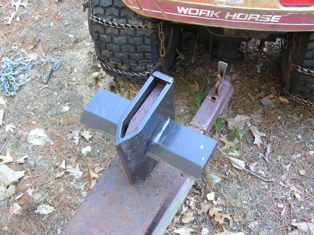

Achto 32,510 #26 Posted April 9, 2025 18 minutes ago, c-series don said: I want one of those!! I would have a 4 way wedge on it though. They thought of that. Later in the video they show where the wedge moves up to expose the cross wedge, aka 4 way. 2 Share this post Link to post Share on other sites

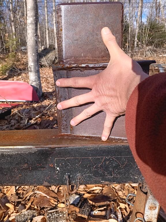

ebinmaine 80,463 #30 Posted April 9, 2025 @c-series don @Achto That 4 way will be part of the additions to ours for sure. Likely I will have our fabricating friend do a proper welding job to it. This is thicker steel than I've ever even thought about trying to deal with. 2 Share this post Link to post Share on other sites

Wayne0 1,631 #35 Posted April 9, 2025 44 minutes ago, ebinmaine said: @c-series don @Achto That 4 way will be part of the additions to ours for sure. Likely I will have our fabricating friend do a proper welding job to it. This is thicker steel than I've ever even thought about trying to deal with. Question. Is the wedge on the ram or the beam. If on the beam, Northern sells a slip on 4 way that works awesome. 1 3 Share this post Link to post Share on other sites

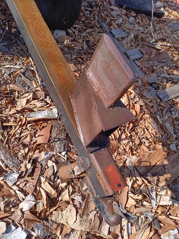

ebinmaine 80,463 #41 Posted April 9, 2025 3 hours ago, Wayne0 said: Question. Is the wedge on the ram or the beam. If on the beam, Northern sells a slip on 4 way that works awesome. Ours is on the beam like that one. But ours has an extension on the top. This looks awesome. I'll have to see if it's something we can use. Save me the trouble of having someone else do the work for me too. Share this post Link to post Share on other sites

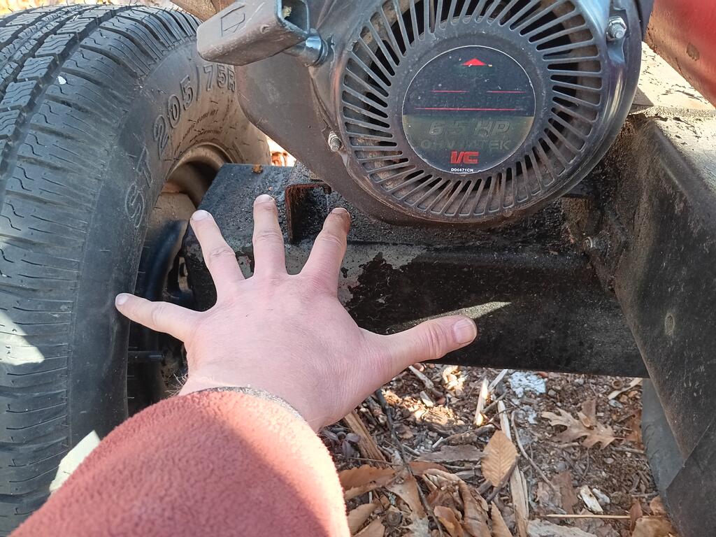

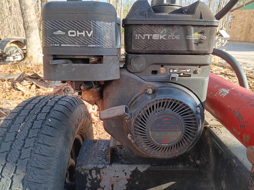

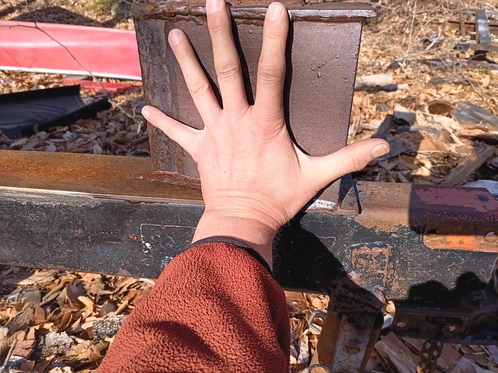

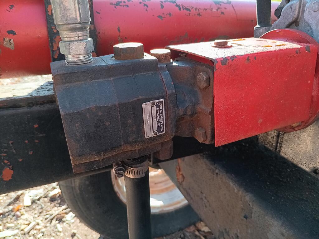

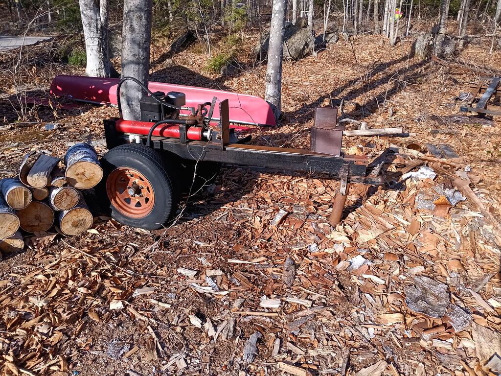

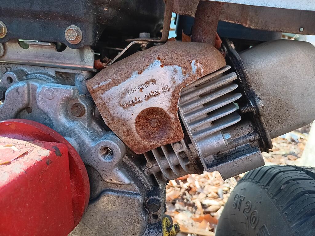

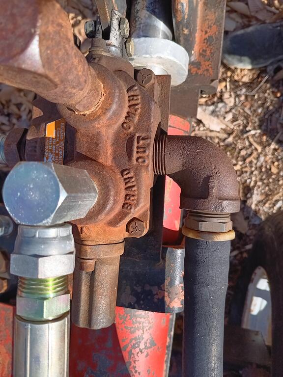

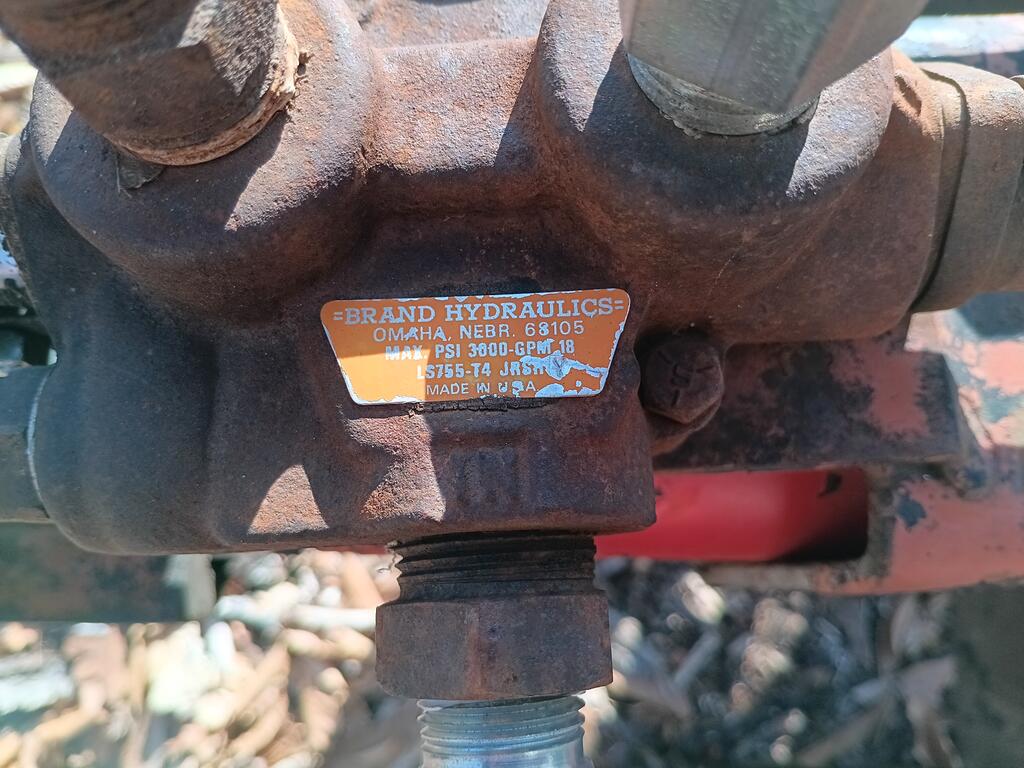

ebinmaine 80,463 #46 Posted April 9, 2025 Cylinder outside diameter. 3.75 Piston diameter 1.75 Stroke appears to be about 24 but the collar eliminates some of that for the auto return so it comes out about 22.5? Poking around online I'd GUESS this is a 12 to 14 ton push at 3000 PSI. Full view. Pics of splitting wedge. My hand for size reference is 10" across thumb to pinky. Valve Pics. Pump. As you can see the current engine is a Briggs 6.5 HP. It runs fine but I believe will be underpowered for what I want to accomplish. I have several Kohler big block engines that could potentially be used. 14 and 16 HP. A Tecumseh 10 HP. And a Briggs V twin cylinder 20 HP. Space would obviously be a consideration but a higher mount could be made to clear the tires. OR wider wheels with spacers. Or both. 2 Share this post Link to post Share on other sites
ebinmaine 80,463 #47 Posted April 9, 2025 7 hours ago, 8ntruck said: Need a starting point, though Do the pics above with ID tags help? 1 Share this post Link to post Share on other sites

Wayne0 1,631 #50 Posted April 9, 2025 (edited) 1 hour ago, ebinmaine said: Do the pics above with ID tags help? You could try to cross the numbers on your pump to the Northern pumps which are re branded Barnes to find your gpm. Also, the jungle has wide 4 way wedges for your type of wedge. I edited my previous post, as I had the GPM wrong. It's a 16 GPM pump. Also, my valve has an auto trip at the end of the return cycle. Edited April 9, 2025 by Wayne0 1 Share this post Link to post Share on other sites
