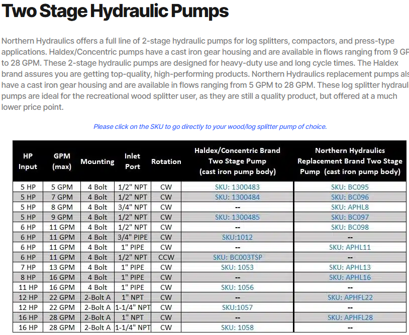

ebinmaine 81,282 #3 Posted April 8, 2025 9 minutes ago, 953 nut said: Two ways to do it. A smaller diameter cylinder will move faster but not be as strong. A higher GP{M pump would sped up the cylinder you have. How do I determine what size/speed pump is on there now? Share this post Link to post Share on other sites
ebinmaine 81,282 #4 Posted April 8, 2025 https://www.surpluscenter.com/Brands/MTE-Hydraulics/16-GPM-2-Stage-Hydraulic-Pump-MTE-Hydraulics-S21707-5185-9-7972-16.axd Just a note... Share this post Link to post Share on other sites

Achto 32,963 #7 Posted April 9, 2025 If you do not already have a 2 stage pump, you will find that one will increase your speed. A 2 stage pump travels fast with no load but does slow down under a heavy load. Engine size matters, but not as much as you think. A 6.5 Predator on the right combo is very effective and almost unstoppable. 9 Share this post Link to post Share on other sites
ebinmaine 81,282 #8 Posted April 9, 2025 2 minutes ago, Achto said: If you do not already have a 2 stage pump, you will find that one will increase your speed. A 2 stage pump travels fast with no load but does slow down under a heavy load. Engine size matters, but not as much as you think. A 6.5 Predator on the right combo is very effective and almost unstoppable. So maybe the current powerplant is adequate. We believe the cylinder is good. I'd likely replace the pump and perhaps the control valve/lever. Is the auto-reverse type lever still available? Share this post Link to post Share on other sites
WHX?? 58,388 #9 Posted April 9, 2025 Bigger motor means more force. A 6.5 will push 22 tons. a 8 will do around 30. Motor size won't matter at all on cycle times. 2 1 Share this post Link to post Share on other sites

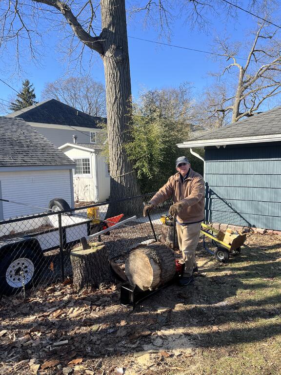

Achto 32,963 #21 Posted April 9, 2025 9 hours ago, WHX?? said: Dan Got a pic of the one in you yard? Not a good pic & it left yesterday. Here is a pic of a similar set up. Having a log cradle on one side keeps you from doing a lot of unnecessary lifting. I don't care for the factory ones that bolt on though. The one that my dad made for his splitter is held on with a couple of pins so it can be quickly removed when needed, like when you are using it in the vertical position. 1 1 Share this post Link to post Share on other sites
ebinmaine 81,282 #22 Posted April 9, 2025 3 minutes ago, Achto said: Having a log cradle We're considering all options here but leaning towards having the splitter become part of a more permanent setup that utilizes large pallets as "slider tables". One would receive a log. Chain saw pivots in the that table. That cut piece falls or slides 🛝 to the splitter table. If the splitter had tables on both sides then no wood can fall to the ground. Once all split the pieces would slide off into a trailer for transportation to the stacking/seasoning area. Issue there is making the table location user friendly and ergonomic. Share this post Link to post Share on other sites
Achto 32,963 #23 Posted April 9, 2025 11 minutes ago, ebinmaine said: One would receive a log. Chain saw pivots in the that table. So something like this?? 2 2 Share this post Link to post Share on other sites

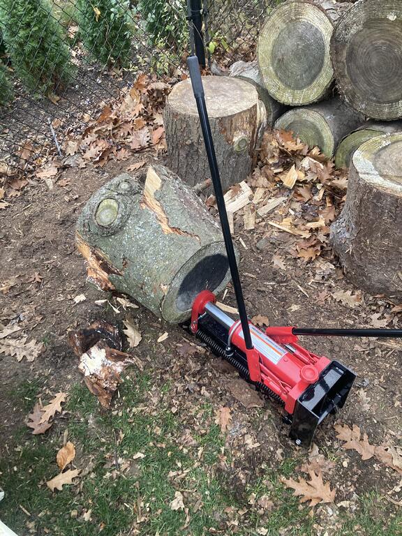

SylvanLakeWH 32,921 #25 Posted April 9, 2025 I sent this to BBT as a possible solution to her problem... HF hand powered splitter... slow, quiet, keeps @ebinmaine outside and out of her hair for days, weeks even... comes highly recommended by Mrs. Sylvan... 1 2 1 Share this post Link to post Share on other sites
