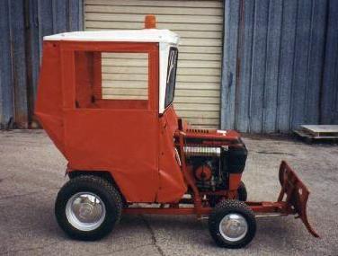

Ed Kennell 46,465 #2 Posted February 20, 2025 2 hours ago, JCM said: . I am reluctant to sell it for that reason and a few others Same here. I don't remember the year, but I bought my cab at the first big show that I attended. I saw the parts cab laying in the corner of one of the barns. I found a young GUY at the other end of the barn and he said it belonged to his brother and he would sell it for $100. Took it home, made a couple of the missing pieces and installed it on my 520H. Several years later at a different tractor show where I had the 520 on display, a tall lanky guy walked up and asked where I got the cab. He informed me he was the original owner. That was Jay Meyers and I had bought it from his brother Guy Meyers. So, I also have a reason to never sell Jay's cab. Rest Easy My Friend @roadapples 3 9 Share this post Link to post Share on other sites

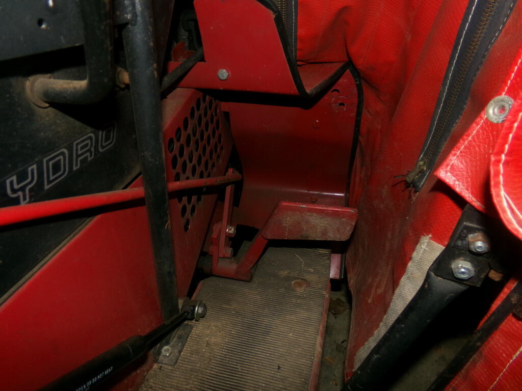

JCM 11,250 #3 Posted February 20, 2025 Thanks Ed. Do you have any info other than in your mind on how you heated your cab ? I have a spare right hand side belt cover that i could alter and save the one on there now. Not sure if you would do a short write up and some pictures on your invention. I am jealous when I see your thermostat in the cab with a 60 degree temp Always admired it, genius . @Ed Kennell Share this post Link to post Share on other sites

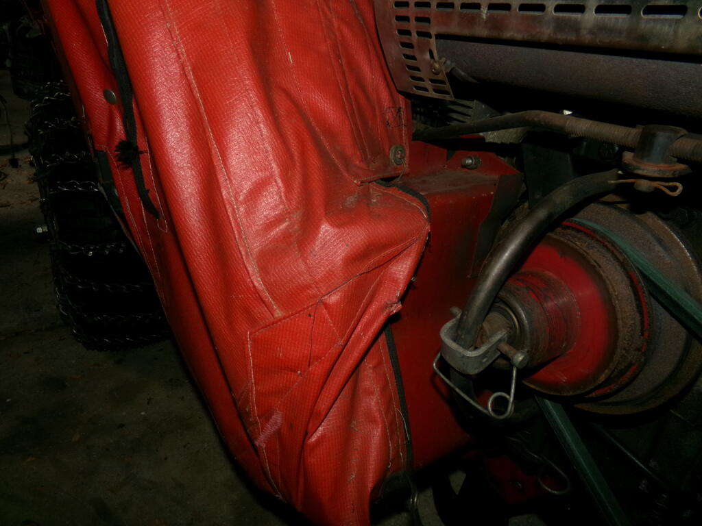

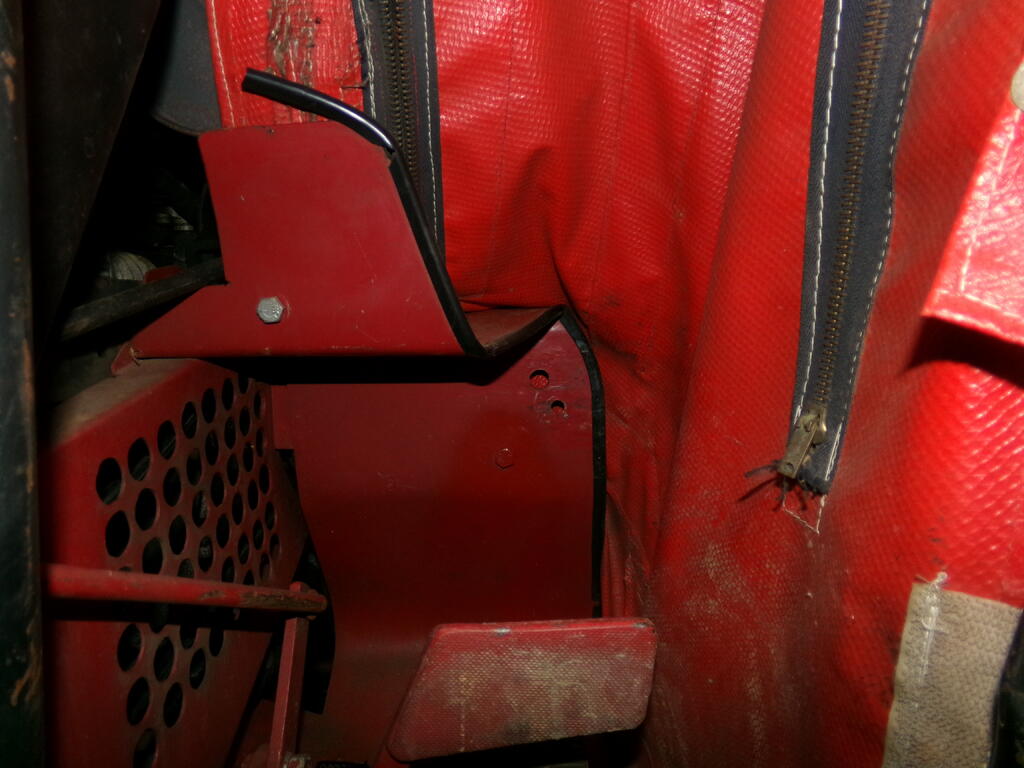

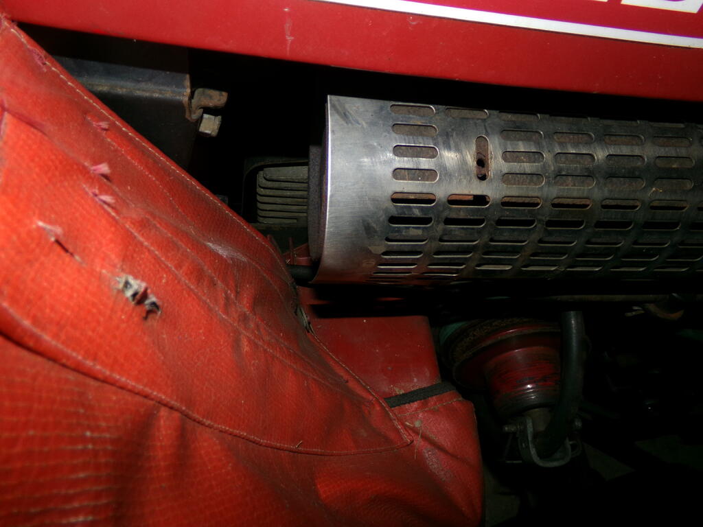

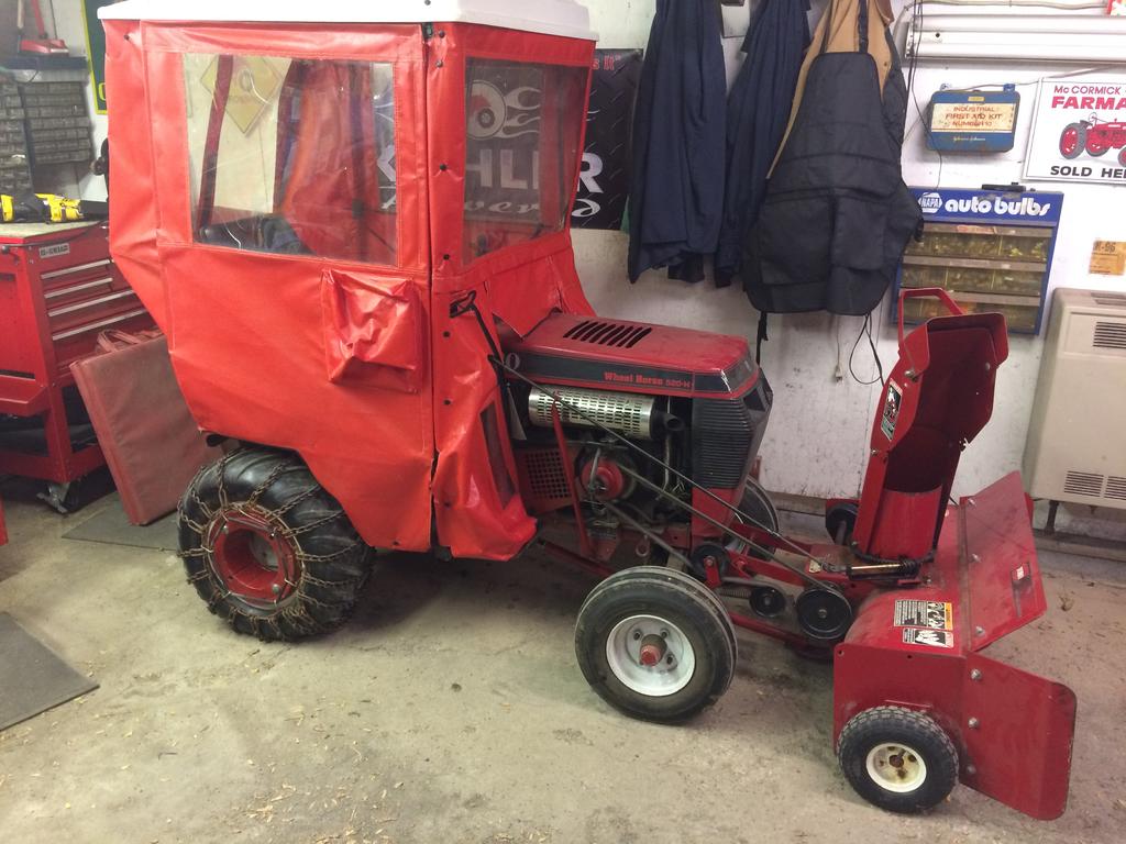

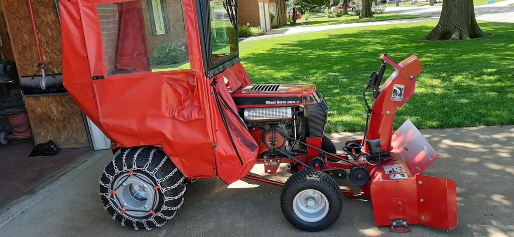

Ed Kennell 46,465 #5 Posted February 21, 2025 (edited) 13 hours ago, JCM said: Do you have any info other than in your mind on how you heated your cab ? There are some pictures somewhere on here Jim. I'm not sure I'll be able to find them. Basically I vented the belt guard and made a sheet metal housing around the area. Then did some nip and sewing to the cab to fit over the housing. The cab was damaged in this area from the muffler heat. I did find this pic. The canvas was altered to attach to this housing. I could get some pics tomorrow. The canvas has grommets that fit over the two 1/4" hex bolts to attach the two. hard to see in these pics. Edited February 21, 2025 by Ed Kennell 9 Share this post Link to post Share on other sites

JCM 11,250 #9 Posted February 21, 2025 Thank You Ed for the additional pictures, much appreciated. @Ed Kennell 1 Share this post Link to post Share on other sites

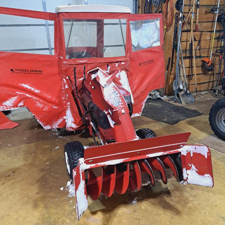

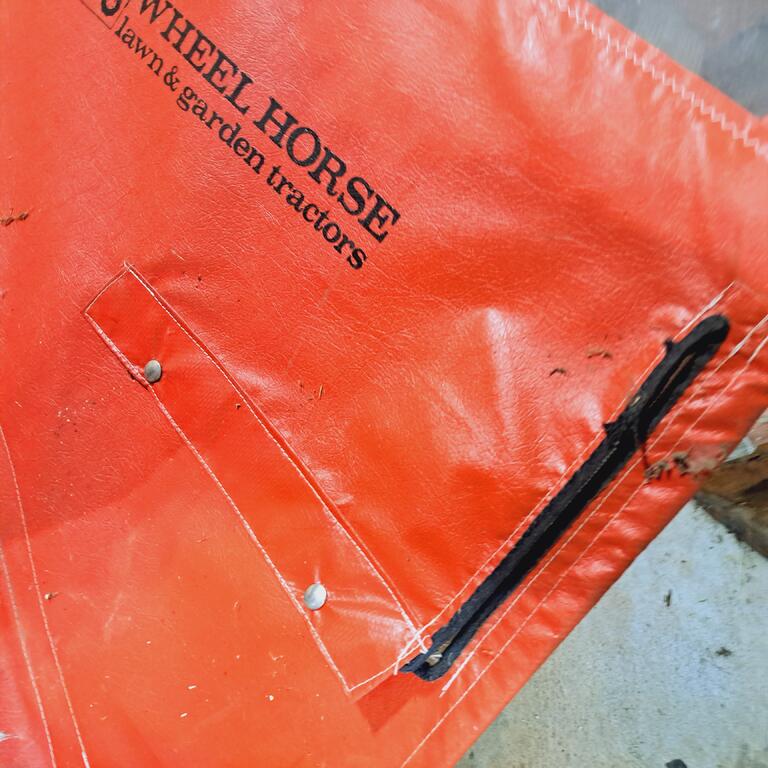

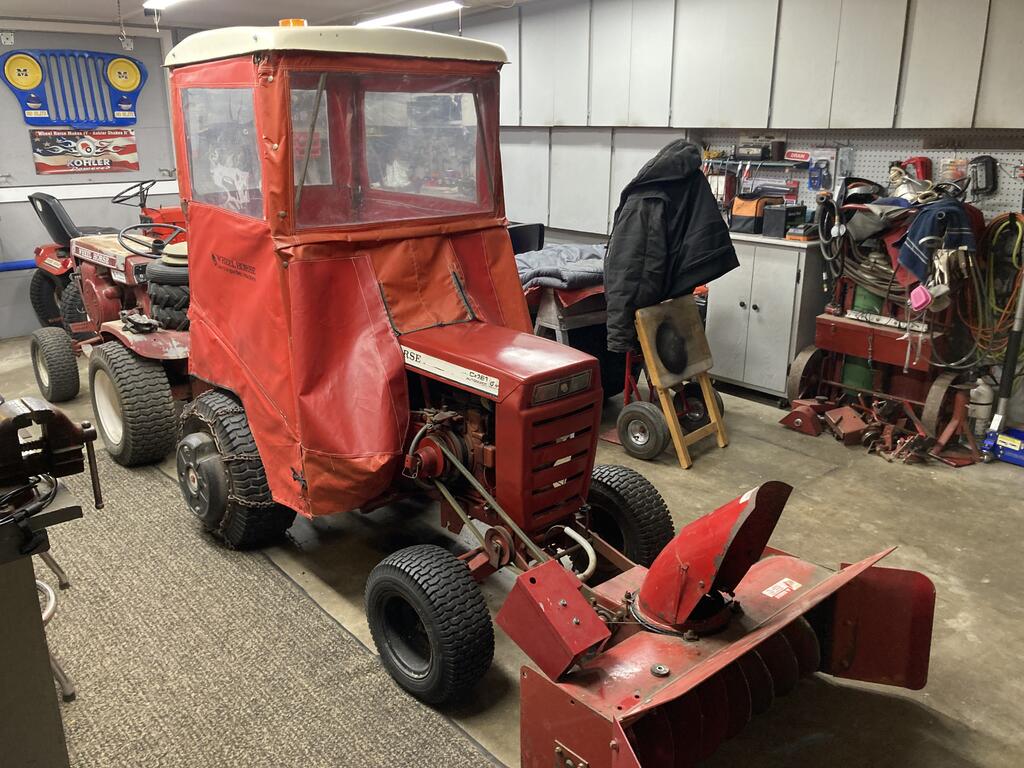

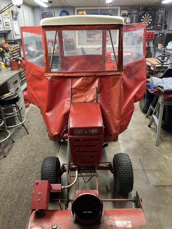

WHX?? 57,278 #16 Posted March 6, 2025 (edited) 10 inches of powder and blowing like a $2 lady of the nite at the love shack. Not even close to the right cab for a 520. As mentioned supposed to be for a C series but better than a poke in the eye with a dull stick and actually fit fairly decent. Price was decent too. Biggest problem is it does not have the bump out for the chute turner. The crank hits the door and a real hassle with gloves on. I have a door that was given to me by @dclarke and no idea what this flap is for ... access to a blade lever maybe? Doesn't really work either. Any ideas? Edited March 6, 2025 by WHX?? Share this post Link to post Share on other sites

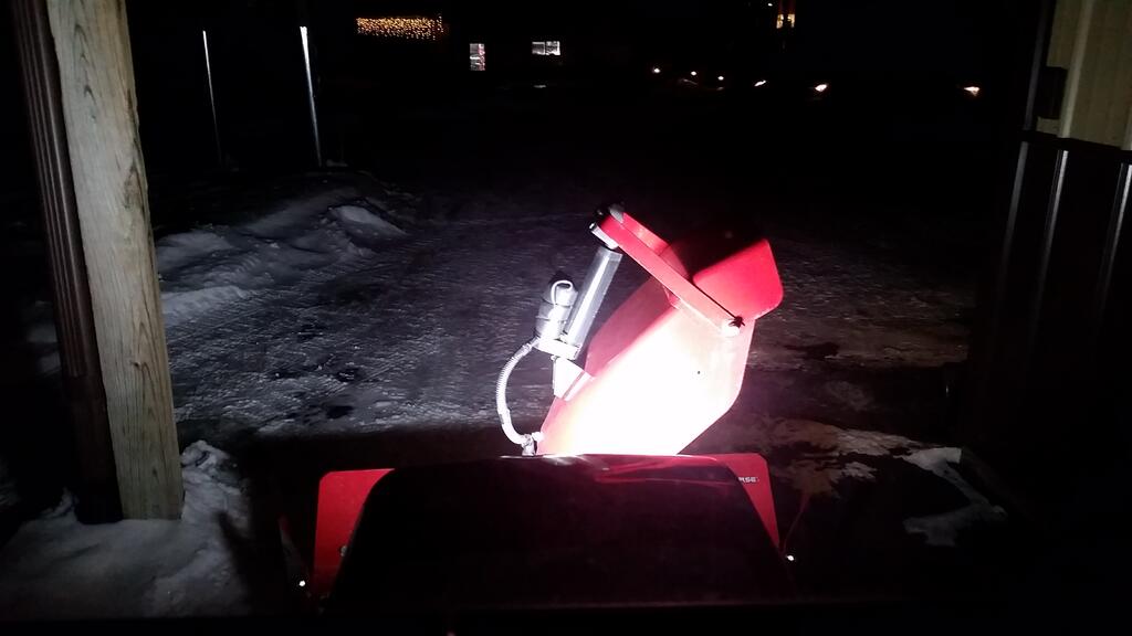

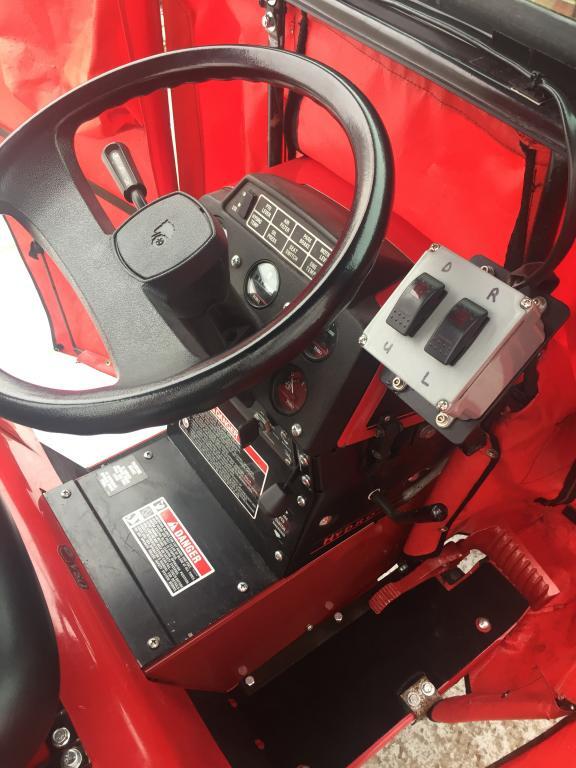

Blasterdad 3,167 #17 Posted March 6, 2025 7 hours ago, WHX?? said: Biggest problem is it does not have the bump out for the chute turner. The crank hits the door and a real hassle with gloves on. Get rid of it! I made mine electric with a car window motor for about $30, works great. It's fairly easy to do & easier to service/store the blower without having to mess with the crank & brackets. I mounted the switch in the dash for a nice OE look. Your blower has the worm gear to turn the chute which might be even easier to fab up than the cable system on mine. 2 3 Share this post Link to post Share on other sites
WHX?? 57,278 #18 Posted March 6, 2025 30 minutes ago, Blasterdad said: electric with a car window motor No doubt Blaster ... I have one set up with that plus a deflector actuator. Is the cat's meow. Trouble is this one gets used less than than that one so it just don't pay. Seems like one wants to keep a low hour tractor just turn it into a dedicated sno tractor! 1 4 Share this post Link to post Share on other sites
Blasterdad 3,167 #19 Posted March 6, 2025 NICE! Well then, I do have some extra front cab panels, I made my cab out of 3 different ones, one might have the bump out, I'll have a look & let you know... The flap on the door is to vent the aftermath of the big pot of winter chili. 3 Share this post Link to post Share on other sites
WHX?? 57,278 #20 Posted March 6, 2025 Lol or any of Pullstart's cooking!!! 3 minutes ago, Blasterdad said: panels, I made my cab out of 3 different ones, one Yep I hear ya there... may see about swapping the door panel off the electric but the door latches are all different. Permanent mods would be required. Will look at modding the chute crank. 1 Share this post Link to post Share on other sites

Ed Kennell 46,465 #23 Posted March 6, 2025 11 hours ago, WHX?? said: Biggest problem is it does not have the bump out for the chute turner. Mine has the bump out on the left door for the left side dually crank. I actually prefer the hand crank....much faster than the lectric. I do need to add an in cab chute control. I used a cable throttle lever on one of my singles. It worked great. 1 Share this post Link to post Share on other sites
JCM 11,250 #24 Posted March 6, 2025 Does anyone know if OTC still offers the glass windshield and top in BLACK like yours @WHX?? Jim ? I always thought it looked way better than the white. The one on the JD 3320 is all black, roof and panels. It is amazing how warm it gets in there without a heater just from the sun and of course out of the wind is a huge difference. Nice looking 520 Jimbo, hydro foot pedal and all. Your Styling. 1 Share this post Link to post Share on other sites
