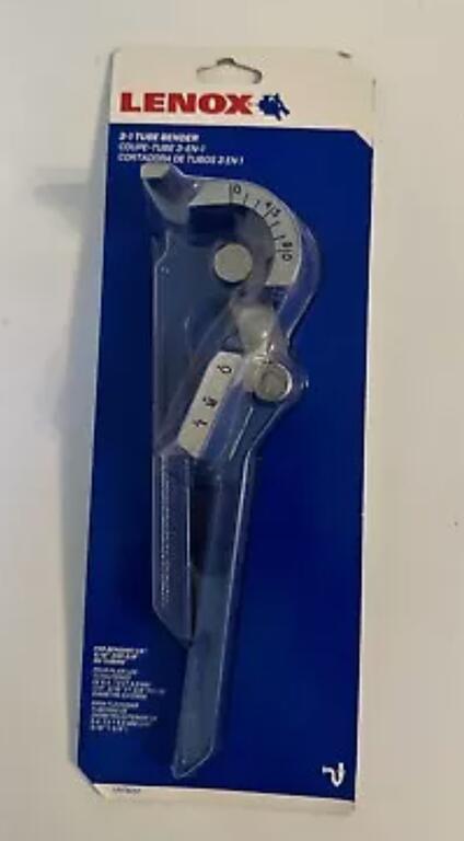

ebinmaine 80,754 #4 Posted January 11, 2025 1 hour ago, JCM said: tubing benders 1 hour ago, peter lena said: tube bender I've used this type for many years. They take some patience and strength to manage. As I age and can't/ don't wanna do certain things anymore I've switched to Lenox Brand like these. Mine are an NOS set I picked up a few years ago. Absolutely excellent tool. Definitely a game changer. 'Bout time I got a matching tubing cutter... 1 Share this post Link to post Share on other sites

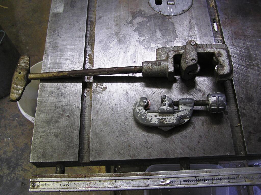

ebinmaine 80,754 #7 Posted January 11, 2025 10 hours ago, ebinmaine said: tubing cutter @JCM @peter lena I ordered this vintage piece from a place right near here in Cape Neddick Maine. Part of the town of York. Lotsa years ago I used one just like this. 1 Share this post Link to post Share on other sites
JCM 11,415 #8 Posted January 11, 2025 That cutter is probably fine for non professional use. I prefer the Ridgid cutters from Plumbing and Heating supply houses. They take a wicked beating for years and years with an occasional cutter wheel change.With parts to rebuild if needed. IMHO 2 Share this post Link to post Share on other sites
ebinmaine 80,754 #9 Posted January 11, 2025 8 minutes ago, JCM said: That cutter is probably fine for non professional use. I prefer the Ridgid cutters from Plumbing and Heating supply houses. They take a wicked beating for years and years with an occasional cutter wheel change.With parts to rebuild if needed. IMHO This one has a replaceable cutting wheel as well. I'll likely never use it enough to get there though. 1 Share this post Link to post Share on other sites

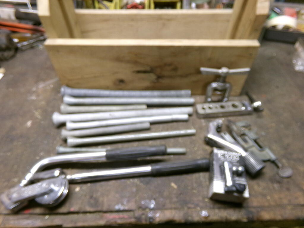

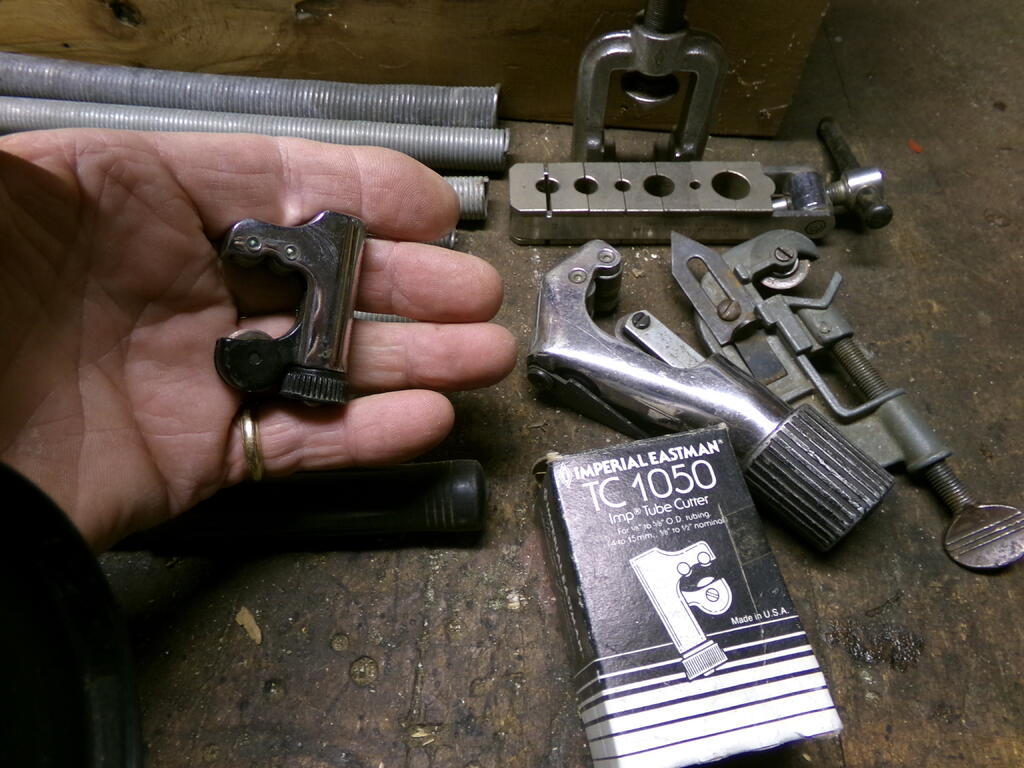

Ed Kennell 47,384 #13 Posted January 11, 2025 These Imperial Eastman tubing tools have served me well for many years. Probably time to give them to son Mike. This little IMP cutter has come in handy many times. 4 Share this post Link to post Share on other sites
JCM 11,415 #14 Posted January 11, 2025 Imperial - Eastman, great quality. I started out with those spring benders, never really had a lot luck with those. 1 Share this post Link to post Share on other sites
ebinmaine 80,754 #15 Posted January 11, 2025 28 minutes ago, JCM said: spring benders, never really had a lot luck with those. Same here. 1 Share this post Link to post Share on other sites
Wayne0 1,634 #16 Posted January 11, 2025 (edited) 9 hours ago, ebinmaine said: @JCM @peter lena I ordered this vintage piece from a place right near here in Cape Neddick Maine. Part of the town of York. Lotsa years ago I used one just like this. Vintage you say. Still working hard! That big cutter was my Grandfathers! (I'm 70) Edited January 11, 2025 by Wayne0 1 Share this post Link to post Share on other sites

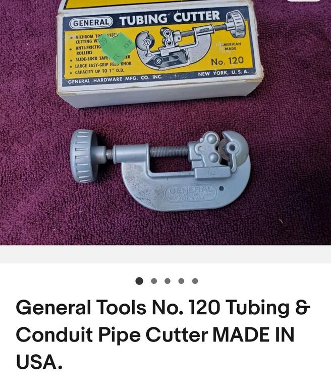

lynnmor 9,042 #17 Posted January 11, 2025 I see that the General No. 120 is still available but it is now made in China. If anyone wants a good old one they can be found on the popular auction site. 1 Share this post Link to post Share on other sites
ebinmaine 80,754 #18 Posted January 11, 2025 1 minute ago, lynnmor said: I see that the General No. 120 is still available but it is now made in China. If anyone wants a good old one they can be found on the popular auction site. Yessir. Where I got mine. I buy vintage tools and supplies whenever possible and practical. Share this post Link to post Share on other sites
