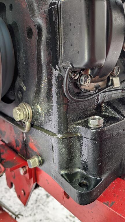

Alrashid2 476 #1 Posted January 6, 2025 (edited) Hey guys. I've discussed a bit of this before on here but today was a real doozy. I bought my 312-8 with a K301 engine back a few months ago, and have just been using it to pull firewood around the property so far. Today was the first time i got to use it to plow the driveway. Took about 45 minutes but it worked beautifully, all without tire chains on a steep hill too! Finished up and popped the hood to find just a ton of oil pushing out from every gasket on the front of the engine, and dripping down from the frame... such a bummer. I have pulled the breather components apart before and I thought they all looked good, but I'm curious if specifically I can look for. Yes, it is put together correctly and in order... While running I put a piece of tissue paper over the breather cover hole. Hard to tell but air was pushing out... I think that is how it's supposed to work (push air out, not in, create a vaccuum...) So much oil was pushing out that it was spewing up onto the exhaust muffler connection and burning... No hour meter on this so who knows how much it has been used. I suppose it could be blow by from worn rings but the engine runs fine, no smoke at all in the exhaust fumes, and when I pop the oil dip stick I'm not getting a ton of oil pushing out. Air movement, yes, but nothing insane... Any ideas here? I'm going to pull the breather again here shortly. Unfortunately rebuilding the engine is not in the cards for me, so if this is blowby I guess I'll just deal with engine oil leaking and topping her off... I'm wondering if there is some sort of "fix" that isn't technically correct but could help? Like what if I allowed the blowby to escape from the dip stick tube, so that it isn't pushing oil out every gasket instead? Any thoughts on that? Thanks guys... Edit: uploaded a photo to show the amount leaking after just 45 min of running. No I have not done a leak test as I have read it's quite difficult on these engines due to some sort of bypass mechanism on the Kohler k series, and I do not have the equipment/expertise to do it... Edited January 6, 2025 by Alrashid2 Share this post Link to post Share on other sites

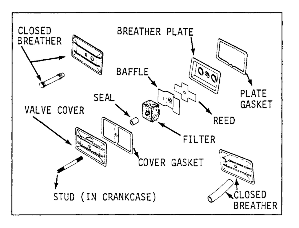

OutdoorEnvy 1,817 #4 Posted January 6, 2025 check if oil is on the sparkplug? Verify breather inner plate was put on with the top up and the hole down. It's odd that you have oil by the muffler connection. Are you able to wipe off and run it and watch to see where the leak is coming from? If it's one area like the camshaft cover the gasket might be bad. But if it's inside the head and exiting in or by the exhaust then either the valve train is pushing it up, like if it's not draining right. Or the rings are so far gone oil is just pushing past the piston and rings easily. I have the same rig you do and the breather tube has a noticeable gust of air when turning the engine over. You might remove the dipstick so the crankcase is open and try blowing through the breather tube to make sure it isn't blocked at all. 1 Share this post Link to post Share on other sites
Alrashid2 476 #5 Posted January 6, 2025 (edited) Spark plug looked fine? Dark color but not wet... Just tore apart the breather components and everything was in order. Filter intact and clean, the reed component intact and perfectly flat and flexible... The exhaust oil looks to just be from near the governor area and I think it's just bouncing some drops up onto the exhaust is all. When you say breather tube, are you talking about the dip stick tube? I don't think I have a breather tube, just the breather component on the front of the engine under the carb. I guess my real question is, if I'm not going to rebuild/replace the engine to properly fix the blowby, is there a work around? I know this wouldn't be correct, but I feel like I have two options at this point: If the blowby is happening no matter what, can I allow the excess crankcase pressure to vent out the top of the dipstick tube, so it isn't pushing so much oil out the gaskets on the face of the engine? Or could I just open up the breather apparatus to allow more pressure to come out? I just keep driving it anyway. Blowby still happens but the pressure is escaping through the gaskets, pushing oil with it, instead of at the breather or the dip stick tube... Edited January 6, 2025 by Alrashid2 Share this post Link to post Share on other sites
oliver2-44 11,767 #6 Posted January 6, 2025 There are some Kohler breather covers that have a rubber tube coming out of them instead of just the stamped vent opening. Some just had a tube pointed down and some later models had a tube that vented to the carburetor. (all modern engines vent the valve cover to the air cleaner box) This is a Magnum 12 which has the same size cover as yours. See hose #11 https://www.psep1.biz/arinet.asp#/Kohler_Engine/M12-471508_BASIC/Breather_%26_Vent_3-10-12_Created_4%2f%2f3%2f%2f2006/10959/CATALOGS|~35563 For a work around, you could tap the valve cover 'slit opening" closed. Clean the metal very good and put a dap ove JB weld over the closed slit. Buy hose #11 from above and drill hole in cover for hose to snap into. (I've also seen these hoses with a build in 90 degree fitting to point it downward) Extend the hose with some tubing from the hardware store to extend below the tractor or into a collection container. If you didn't want to modify your original vent cover, a new one would be a very simple part to make. You could get a piece of flat steel from the hardware store. 1/4" thick would be thick enough to tap for a pipe 90. It could be a little wider if that's how standard metals sizes fit. Drill the center hole for the rod, and a hole for the vent tube. tap for a 90 deg street ell. Add a hose barb fitting and run hose as above. Share this post Link to post Share on other sites

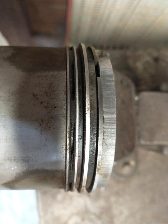

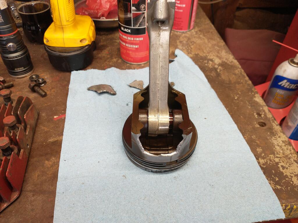

squonk 48,207 #10 Posted January 6, 2025 When an engine does this it's usually something major. I said this in one of your first threads. Excessive blow by at the rings. Top of piston eroded away or even could even be as bad as a broken piston. 1 Share this post Link to post Share on other sites
oliver2-44 11,767 #11 Posted January 6, 2025 Yes you could install something at the dip stick tube. But I suspect it might be hard to get a good seal. it it does seal around the dipstick tube, that's a new place for dirt to get into the engine. Any chance you have a machinist friend. It sure would be nice to measure the cylinder top and bottom after you finished with snow and firewood season. That could help determine if there a possibility of reringing it vs a full overhaul. But if it has that much blowby I suspect the cylinder would be worn slightly egg shaped which means a rering wont help. 1 Share this post Link to post Share on other sites
Alrashid2 476 #12 Posted January 6, 2025 @squonk thanks for the photos. Yes hoping it isn't something too major - had I never popped the hood I would never even know the engine isn't pristine. Despite all the leaking of oil, I did check the dipstick after and I wouldn't have noticed that it went down... @oliver2-44 good points. Maybe I could go along the route you were saying and make a second Breather cover and put on some sort of air filter component... On the flip side, the pressure is so strong that I doubt dirt would be making it into the engine! I'll do some thinking. I'm with you on the egg shape, simply because I know my luck and if I was adventurous enough to get in there, I could see that being the result! I actually do have a machinist friend who I talked to a bit ago about this. He himself has some tractors, including a WH as well as some old Ford N series tractors from the 1950s. He said all his have blowby, with various levels of oil leaking out, and he won't fix them himself! "Too much work" and he said he just lives with it. Told me to "invest in paper towels and keep it topped off!" Share this post Link to post Share on other sites

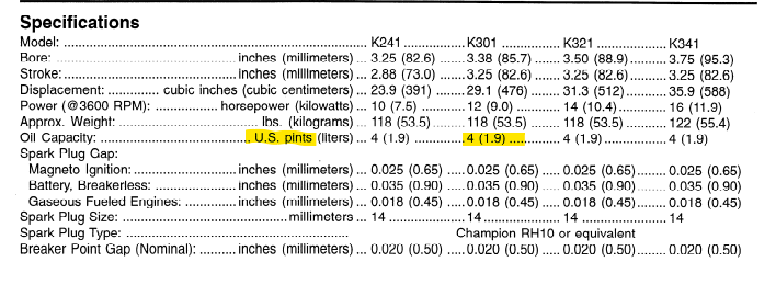

oldlineman 1,814 #20 Posted January 7, 2025 your 3rd post you stated you put 2 quarts of oil in this k301 I believe it only holds 1 quart of oil if I am correct and I think I am there is your problem, maybe you have the wrong dip stick in this engine. Garry what say you? Share this post Link to post Share on other sites
Bar Nuthin 3,339 #21 Posted January 7, 2025 11 minutes ago, oldlineman said: your 3rd post you stated you put 2 quarts of oil in this k301 I believe it only holds 1 quart of oil if I am correct and I think I am there is your problem, maybe you have the wrong dip stick in this engine. Garry what say you? My owners manual states 4 pints (= 2 qt) Share this post Link to post Share on other sites

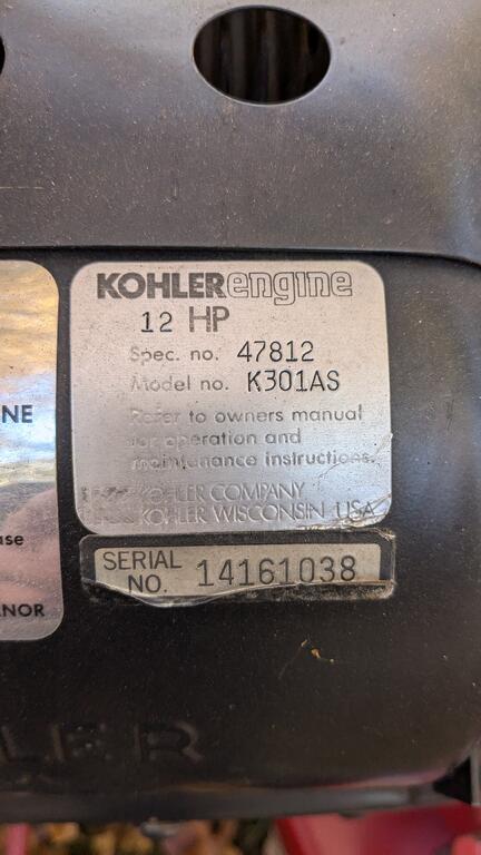

rmaynard 17,612 #22 Posted January 7, 2025 (edited) K301S 2 quarts K301AS 1 quart I still think the reed valve is installed wrong. Edited January 7, 2025 by rmaynard 2 Share this post Link to post Share on other sites
oldlineman 1,814 #23 Posted January 7, 2025 my bad I guess I was thinking of the k301AS Share this post Link to post Share on other sites
Alrashid2 476 #24 Posted January 7, 2025 @rmaynard does the actual reed itself only have one direction? My engine does say AS on it though I think someone said that it was probably reworked by Kohler prior to being thrown on a wheel horse. Share this post Link to post Share on other sites
rmaynard 17,612 #25 Posted January 7, 2025 (edited) Let's see a picture of the oil pan. The reed needs to be in the correct location. Plate gasket goes against the block. Breather plate against the gasket with the recessed part facing the block. Then the reed, followed by the baffle, the filter, the rubber seal, the other gasket and finally the cover with the vent hole up, just like the diagram shows. Edited January 7, 2025 by rmaynard Share this post Link to post Share on other sites
