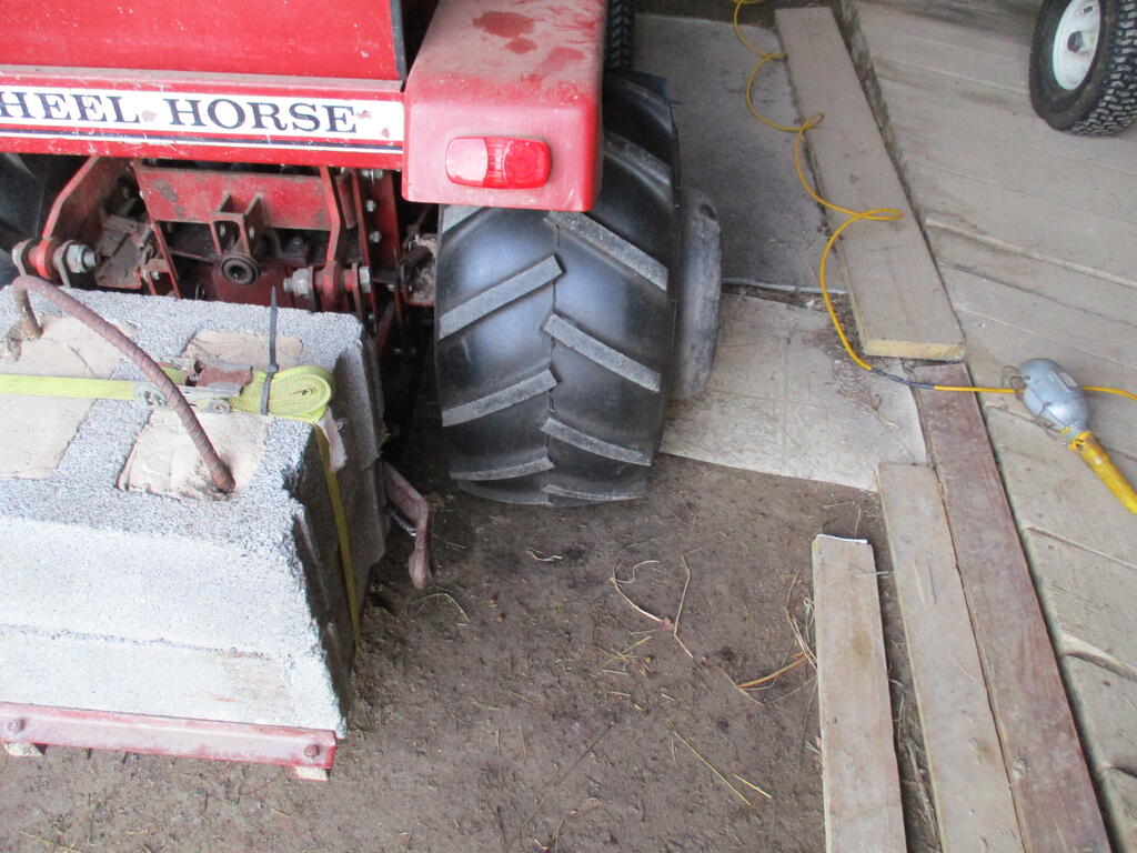

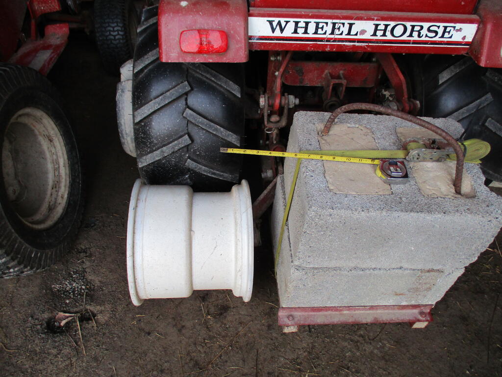

Lee1977 7,813 #4 Posted December 31, 2024 (edited) 57 minutes ago, ebinmaine said: Does anyone know of a technical reason why the rear wheels on a 520 are wider? Just because of the 10.5 wide tire? Were there any other models that used a 10.5 wide? Not all 520's had them the 1988 and 1989 didn't have them. The main reason was the 23x1050x12 tires, but they were using 2 ply tires and they rounded up like a beach ball on the 7" rims. Some of the gray Work Horses had 8 1/2" rims. I put 24x950x12 on my 1989 520-H on the 7" rims. The receiver braces down to the hitch pin had not been added in this picture. Here is one of the braces, they are not welded to the hitch. Edited December 31, 2024 by Lee1977 1 1 Share this post Link to post Share on other sites

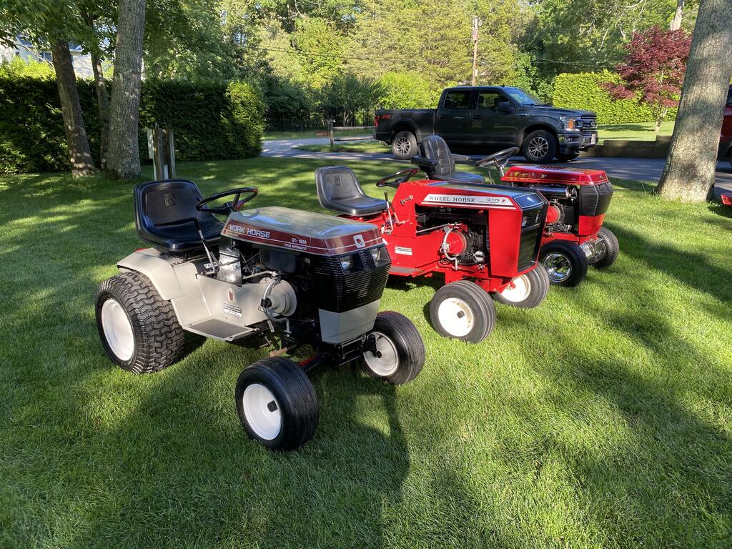

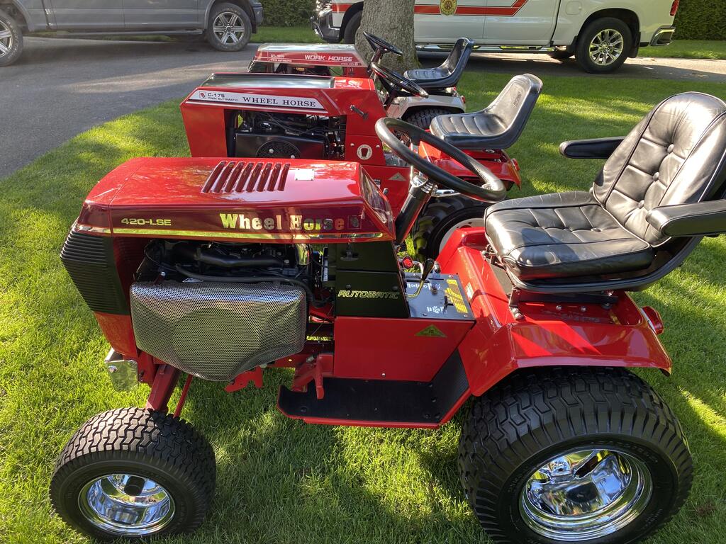

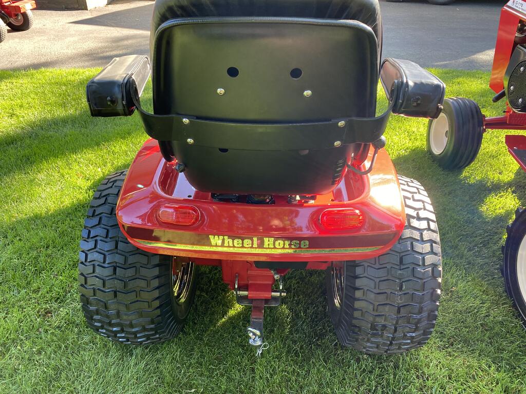

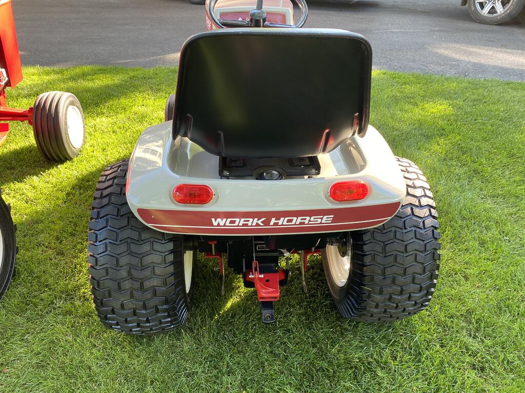

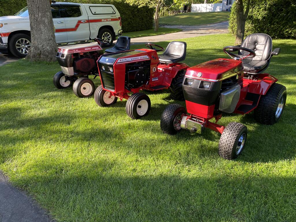

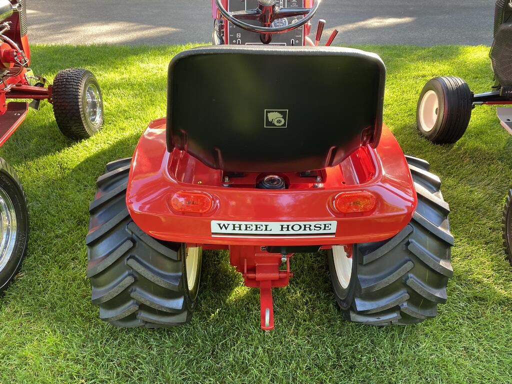

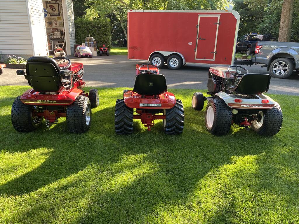

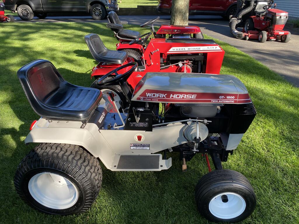

c-series don 12,752 #15 Posted December 31, 2024 I believe the Work Horse GT-1800 was the first to come with 23x10.50-12’s The GT-1600 came with 8.50’s Other than that the largest tire on the C-Series was a 23x9.50-12 that came on a C-175. Let’s look at some pictures, I know you guys like pictures! Note: The C-175 in these pictures has 10.50’s on it. The 420-LSE came from the factory with 10.50’s 3 6 Share this post Link to post Share on other sites
JCM 11,470 #16 Posted December 31, 2024 Did you change the seat back hardware on the 420 to chrome/ stainless or is that OEM Don, Looks nice. @c-series don 1 Share this post Link to post Share on other sites
c-series don 12,752 #17 Posted December 31, 2024 @JCM That’s the way it came from the factory Jim. 1 1 Share this post Link to post Share on other sites
ebinmaine 81,282 #18 Posted December 31, 2024 7 minutes ago, JCM said: Did you change the seat back hardware on the 420 to chrome/ stainless or is that OEM Don, Looks nice. @c-series don Agreed. I like the chrome plated on black look. 26 minutes ago, c-series don said: Note: The C-175 in these pictures has 10.50’s on it. What are those Don? Firestone 23⁰ ? Share this post Link to post Share on other sites

c-series don 12,752 #20 Posted January 1, 2025 @ebinmaine Those are Galaxy Super Trenchers 1 Share this post Link to post Share on other sites

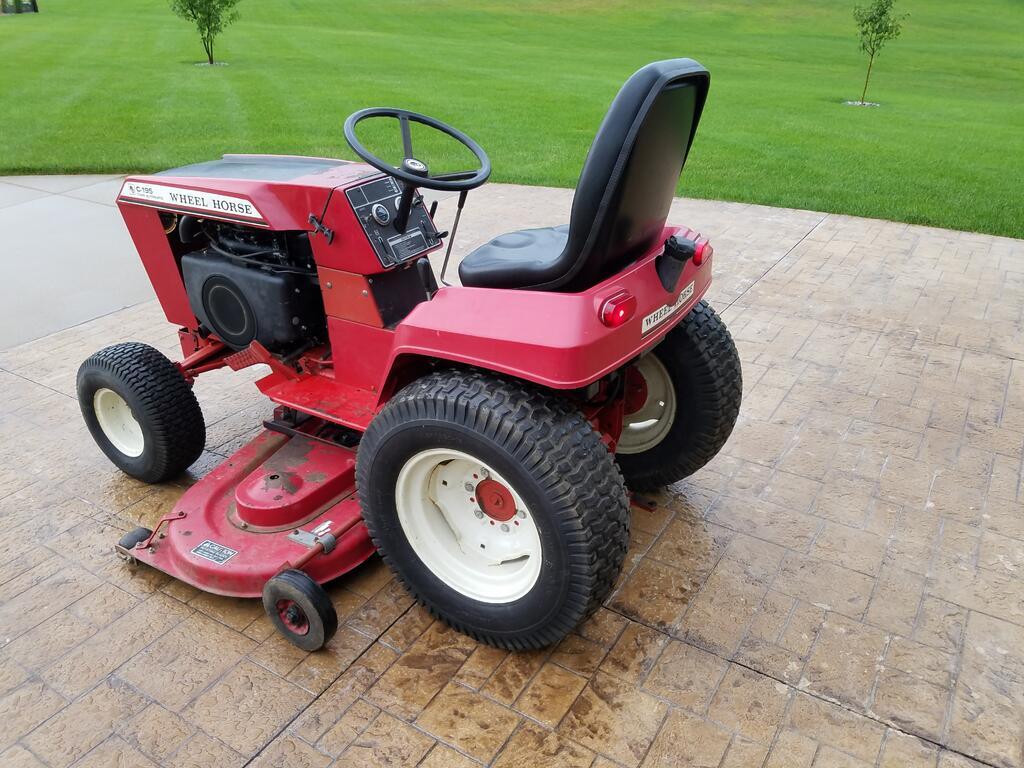

bds1984 1,519 #21 Posted January 1, 2025 19 hours ago, c-series don said: I believe the Work Horse GT-1800 was the first to come with 23x10.50-12’s The GT-1600 came with 8.50’s Other than that the largest tire on the C-Series was a 23x9.50-12 that came on a C-175. Let’s look at some pictures, I know you guys like pictures! Note: The C-175 in these pictures has 10.50’s on it. The 420-LSE came from the factory with 10.50’s My C195 would like to have a word with you... 27x9.5R15 1 1 Share this post Link to post Share on other sites
c-series don 12,752 #22 Posted January 1, 2025 (edited) Damn it! Right after I posted that I remembered the Super C, The C-195! Then I wondered how long it would take for someone to catch that, and here we go! But…. They are still 9.5’s not 10.5’s! Edited January 1, 2025 by c-series don Share this post Link to post Share on other sites
