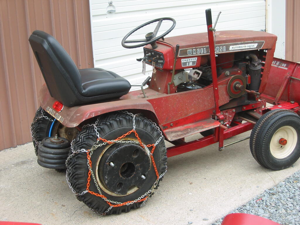

mrc 1,122 #2 Posted December 31, 2024 2 link means that there is a cross chain every 2nd link on the diameter chains. 4 link means there is a cross chain every 4th link on the diameter chains. 4 link yields a bumpy ride because there is such a big gap between cross chains. 2 link are generally a little more money but, worth it in my opinion 3 Share this post Link to post Share on other sites

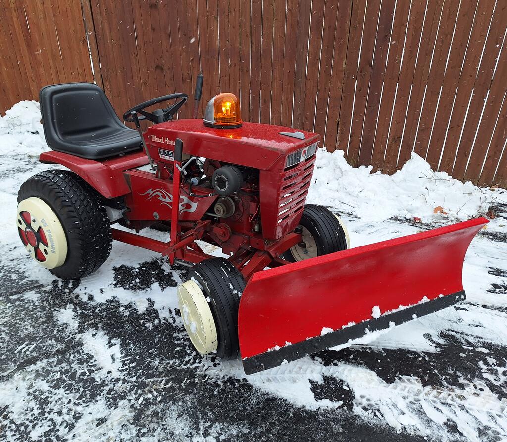

Racinbob 13,290 #7 Posted December 31, 2024 I've always used 2-link steel until a few years ago but I've switched to rubber to save our asphalt drive. They work as good or better than the steel in the snow. The blade stays on the 76 for summer use and I'd say the same for the rubber in the dirt. As far as the difficulty installing them it really isn't bad. he first time with new chains I fit them to that particular tire and from there on out that's the only tire it gets used on. Any extra links are removed and they are tagged when I remove them. I let the air out and get them tight then reinflate. I have never needed those spring tensioners. I'd say 10-15 minutes per set max. after the first install. I've never seen two link rubber chains. You could add the extra links but because of the surface area I don't think it would do well. Look closely at the two different brands I have. The ones on the left have bolt on links. 1 Share this post Link to post Share on other sites

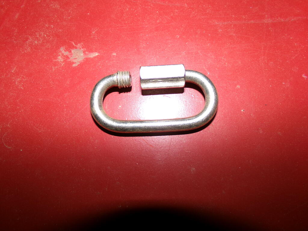

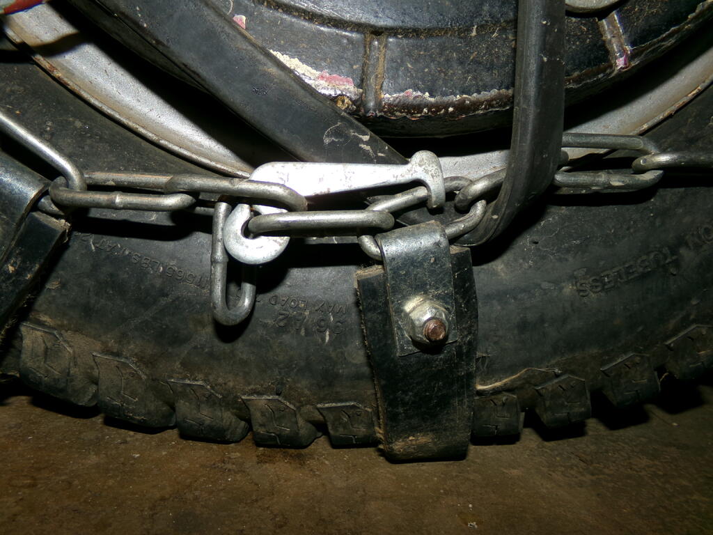

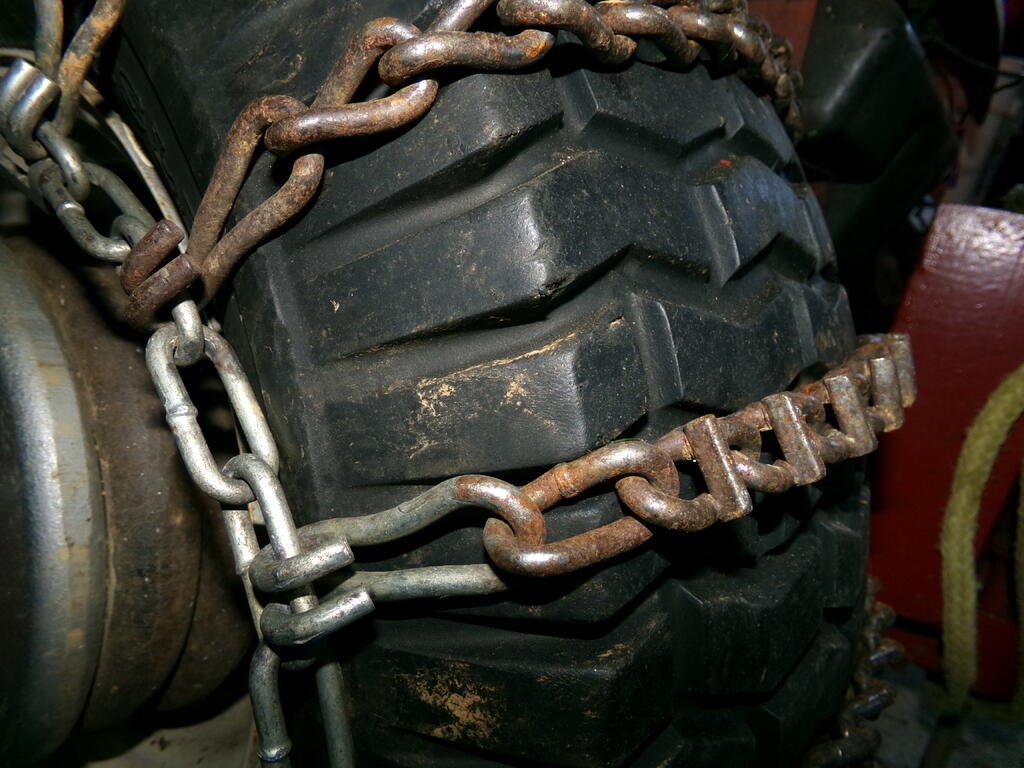

Ed Kennell 47,946 #11 Posted December 31, 2024 11 hours ago, Alrashid2 said: Do they make tire chains that are easily removeable? Installing or removing chains is a 15 minute chore. I lay both chains over the top of the tire, then pull forward till the end of the chains are at the bottom rear of the tire where they are easy to reach. Then I connect the inside chain using one of these threaded connector links. Then I connect the outside using the tightener hook. The size is determined by the width of the tire. Each link is 1" in length. I like one link plus the connector hook to be on the side if the tire. So if your tire measures 7.5" wide, i would use a 9 or 10 link cross chain. The side chains are easily adjusted to fit the tire by cutting to length or extending with the threaded connector links. 1 Share this post Link to post Share on other sites

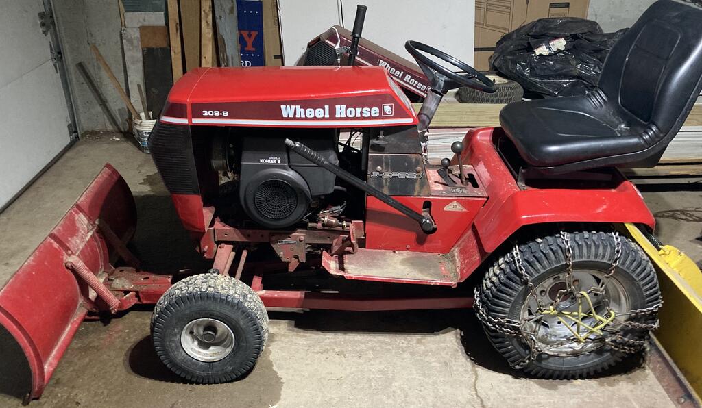

MainelyWheelhorse 3,208 #12 Posted December 31, 2024 I’ve got chains that I use on my 308 to plow my dirt driveway. I got them with my 312 and they are supposed to fit the wider tires of the 312. I put them on the narrower 308 tires that are the size of yours. Besides running a bungee cord for tension though them and securing down the extra length. They have been fine and the difference between with and without is very noticeable. Share this post Link to post Share on other sites
